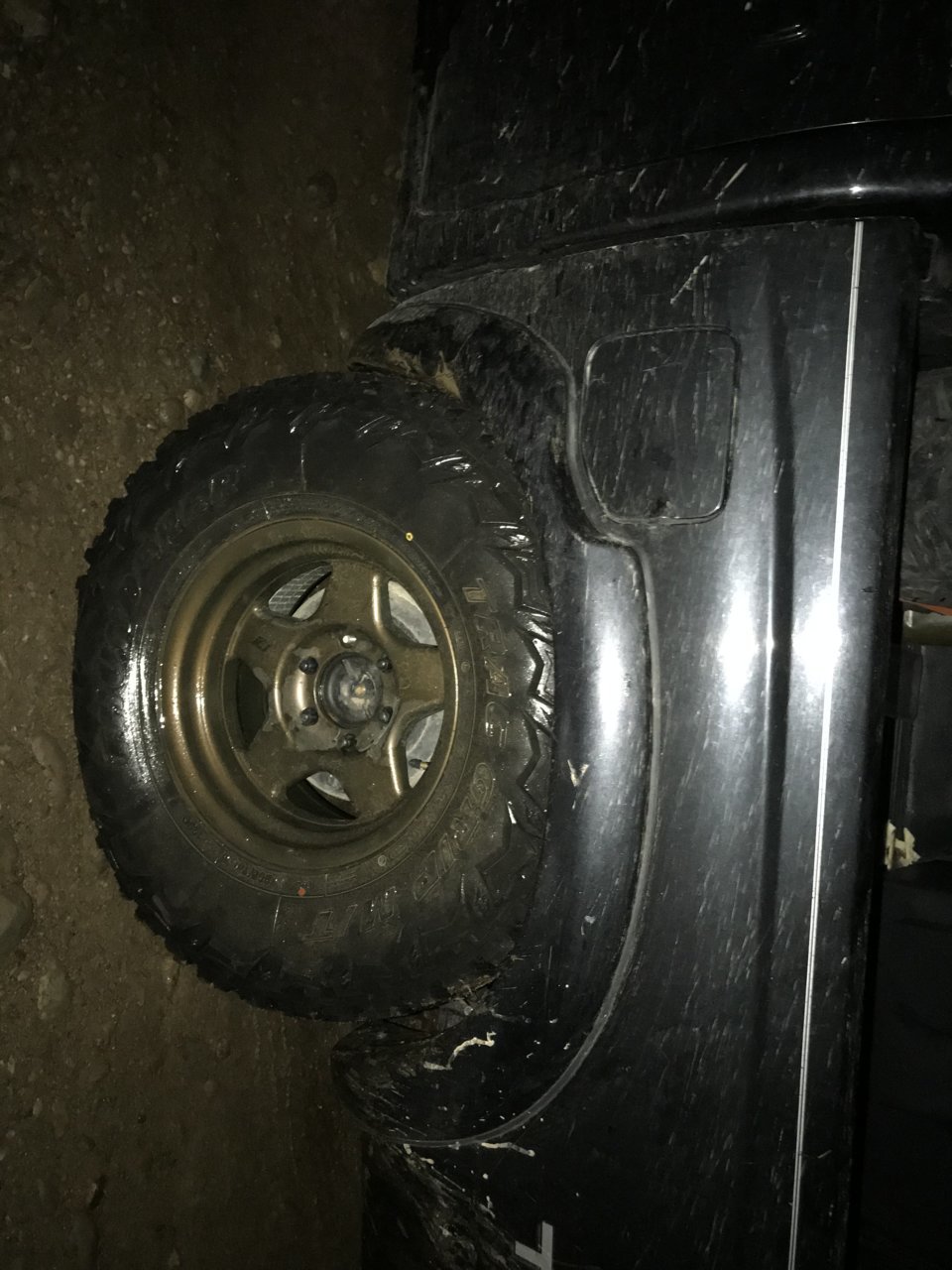

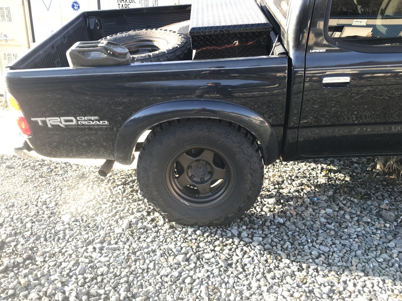

    It all depends on if you wheel or not. Driving it around was fine but off road the rear would rub a lot. Here is a picture of the full flex, I’m also not running any bump stops.

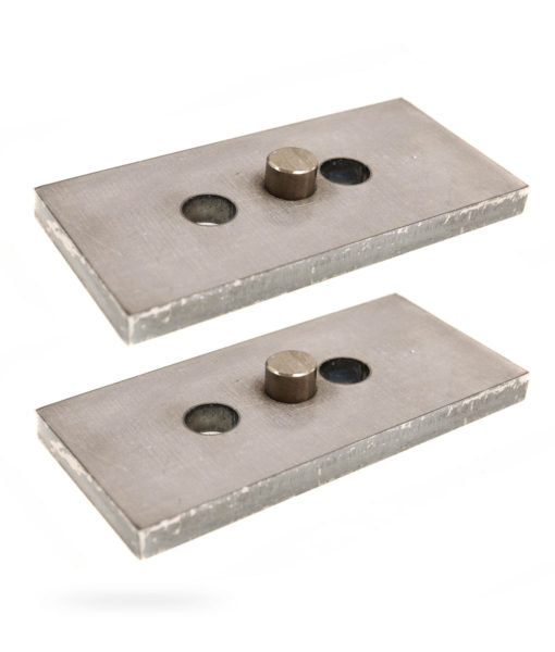

    The plate comes with 2 holes. If I remember correctly first hole moves axle back 1/2'' and second one moves it 3/4''

    I used all pro. probably forgot to mention it in the build but here is a link to the ones I got:

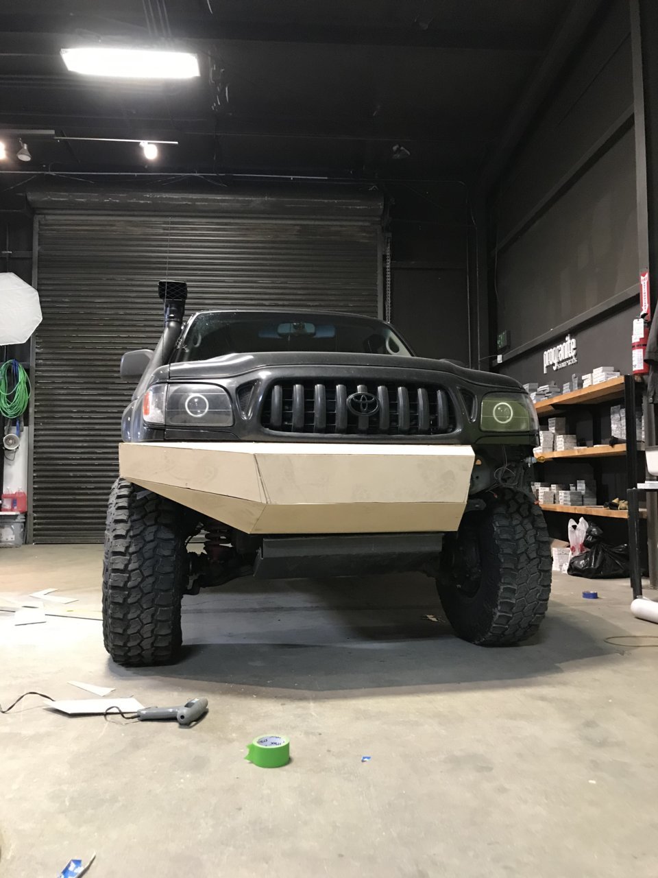

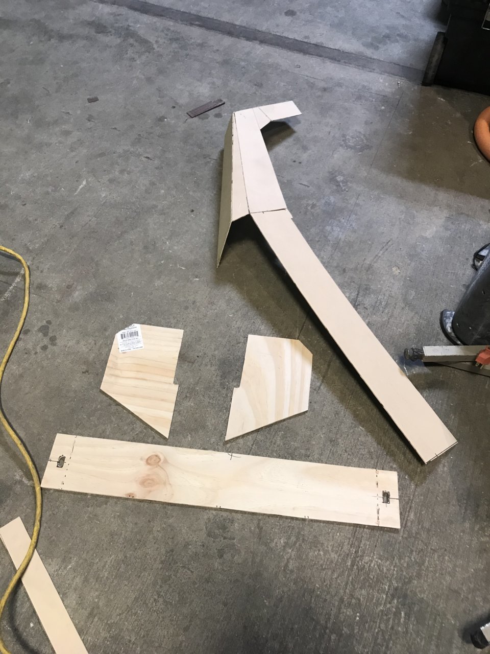

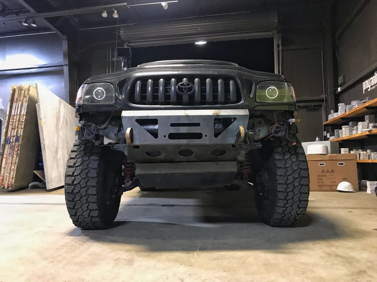

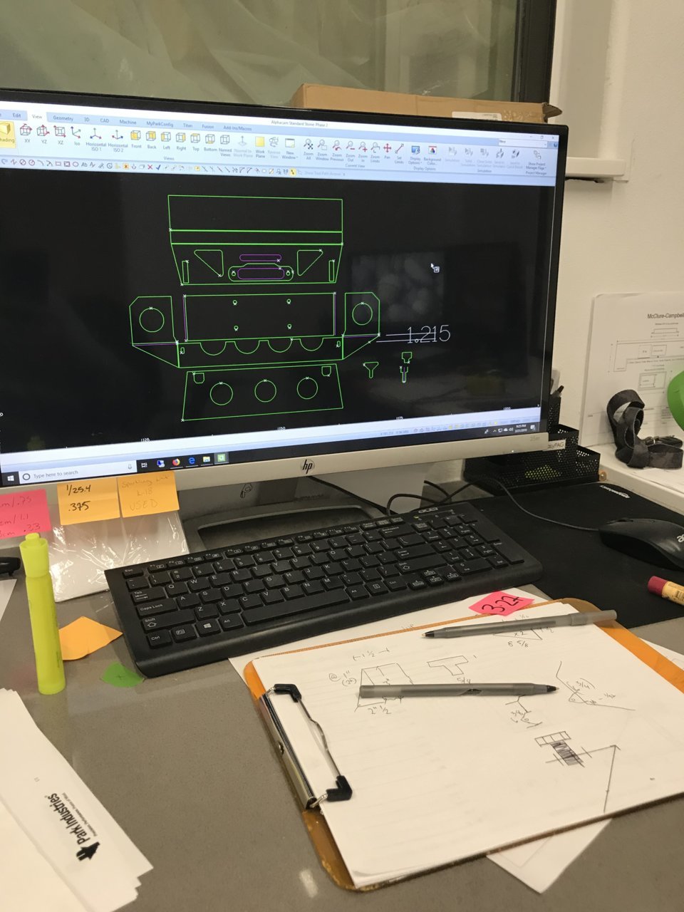

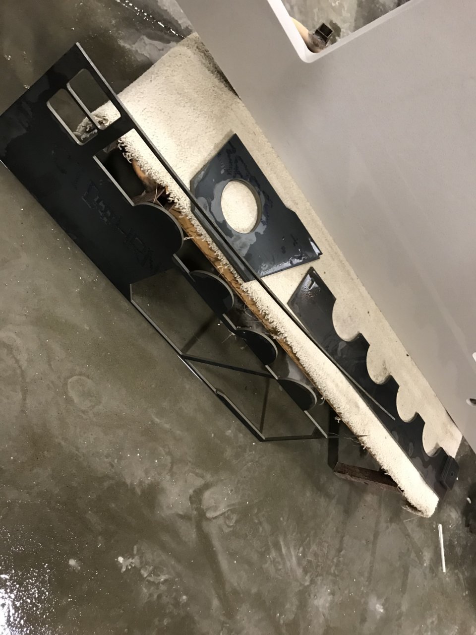

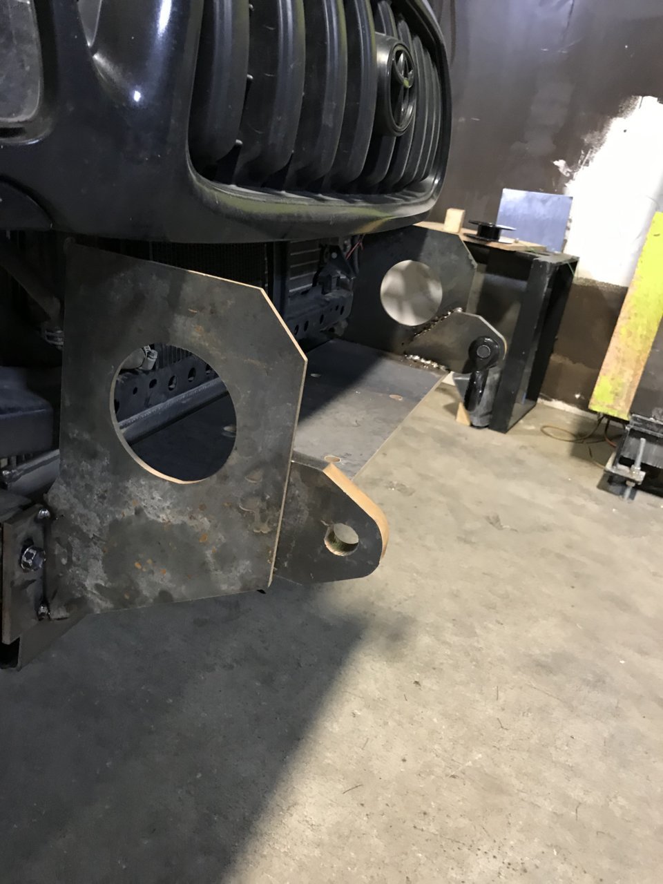

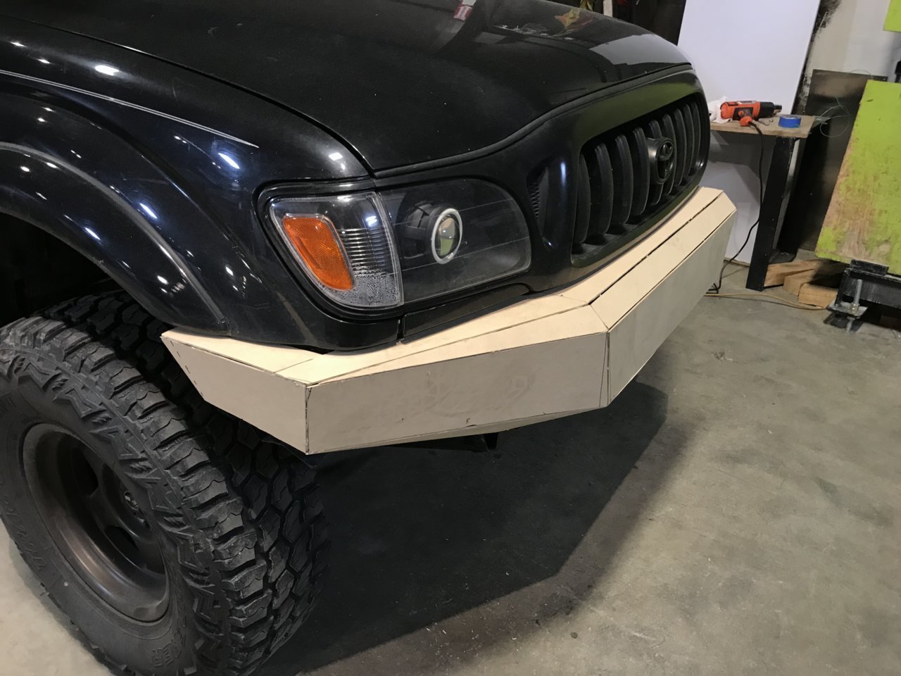

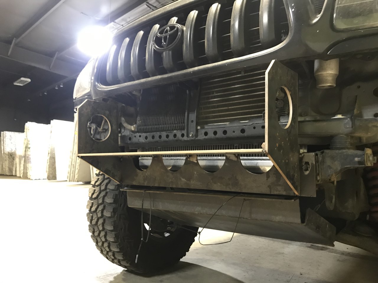

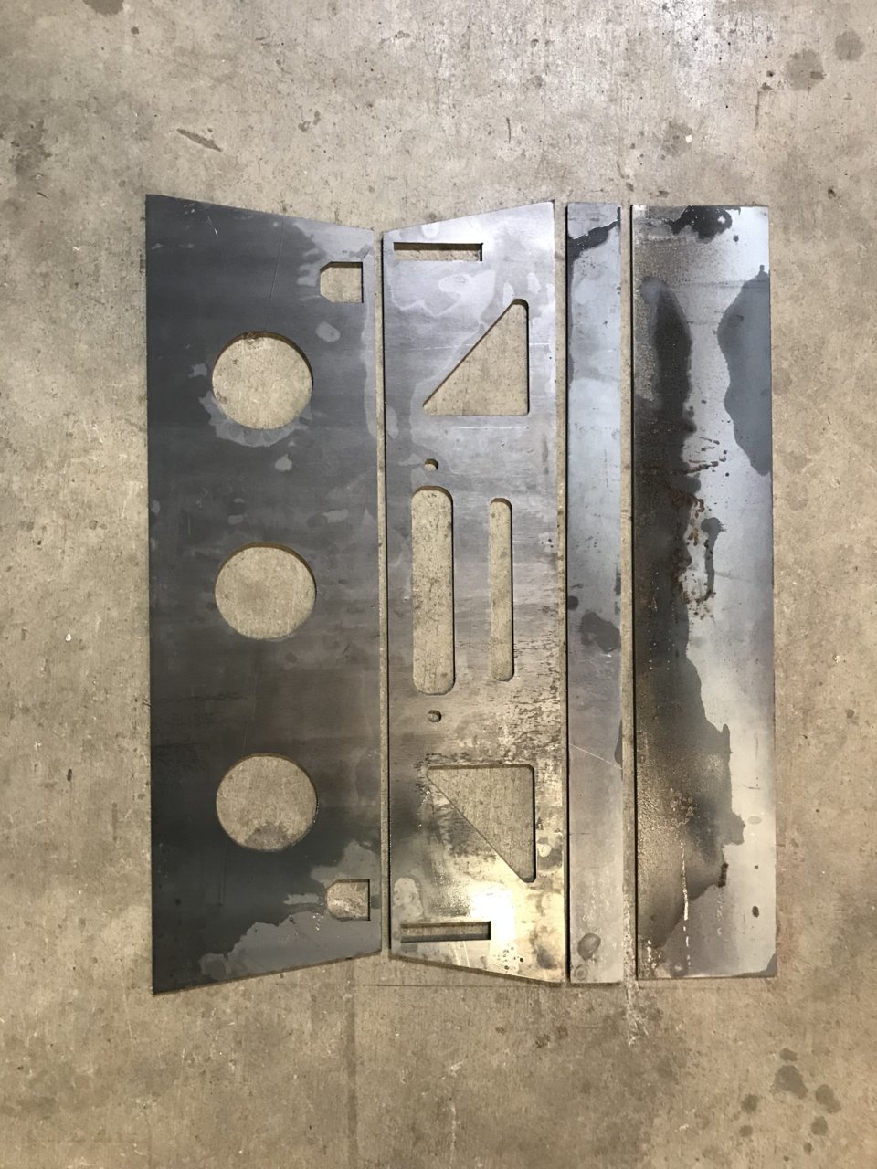

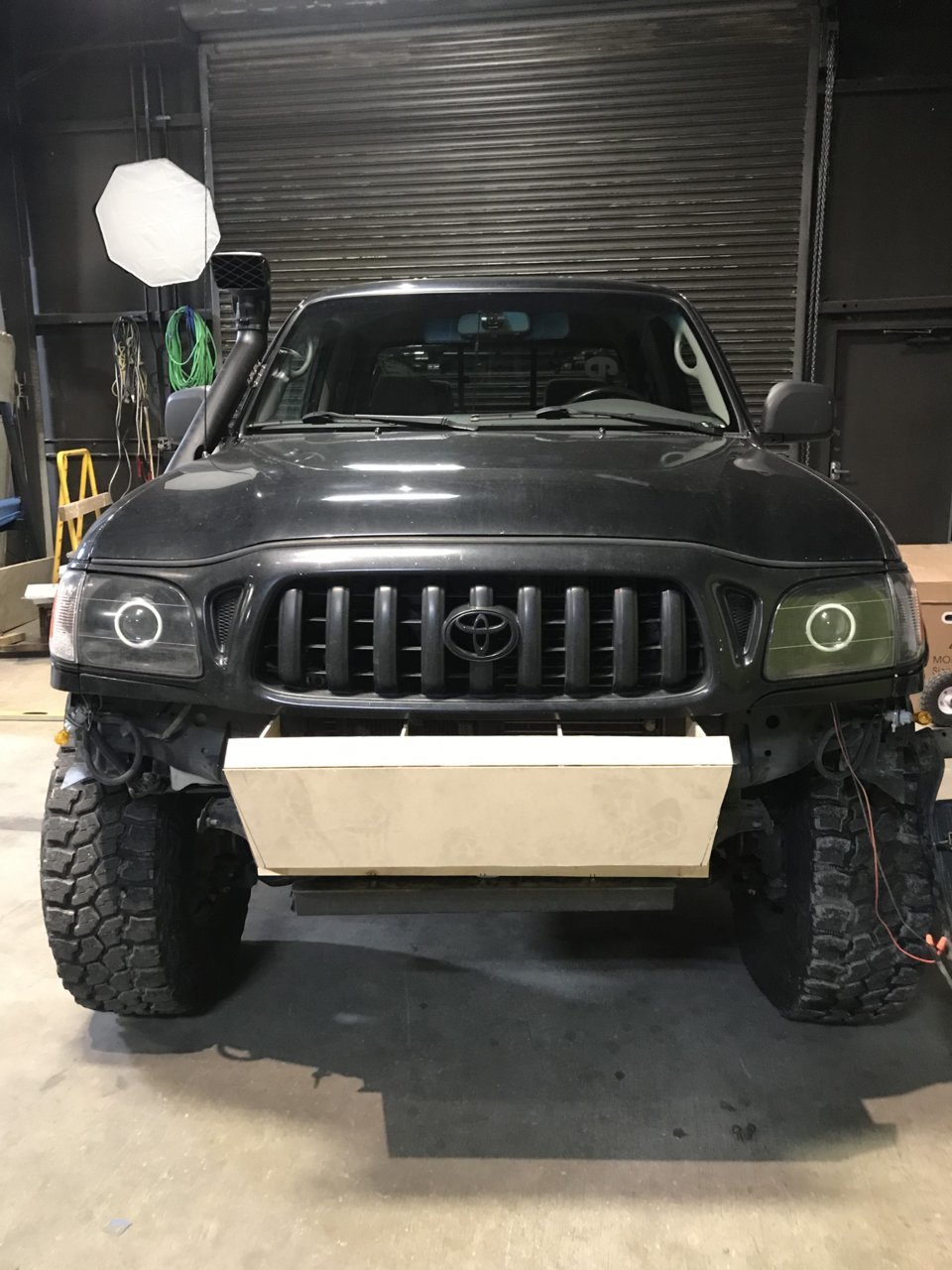

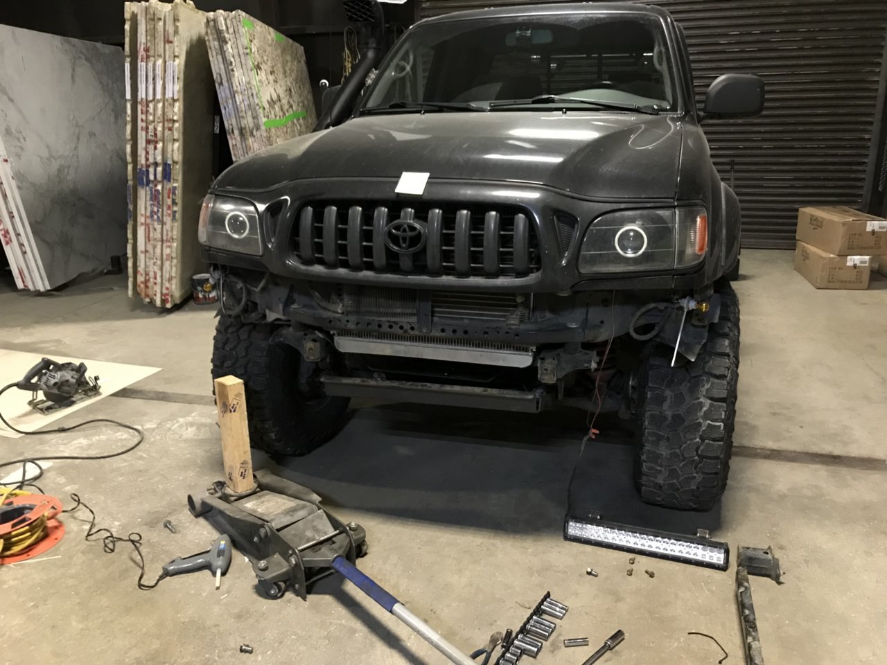

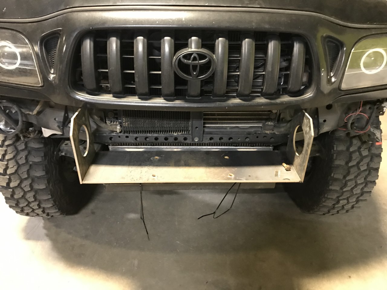

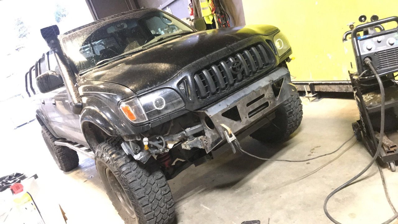

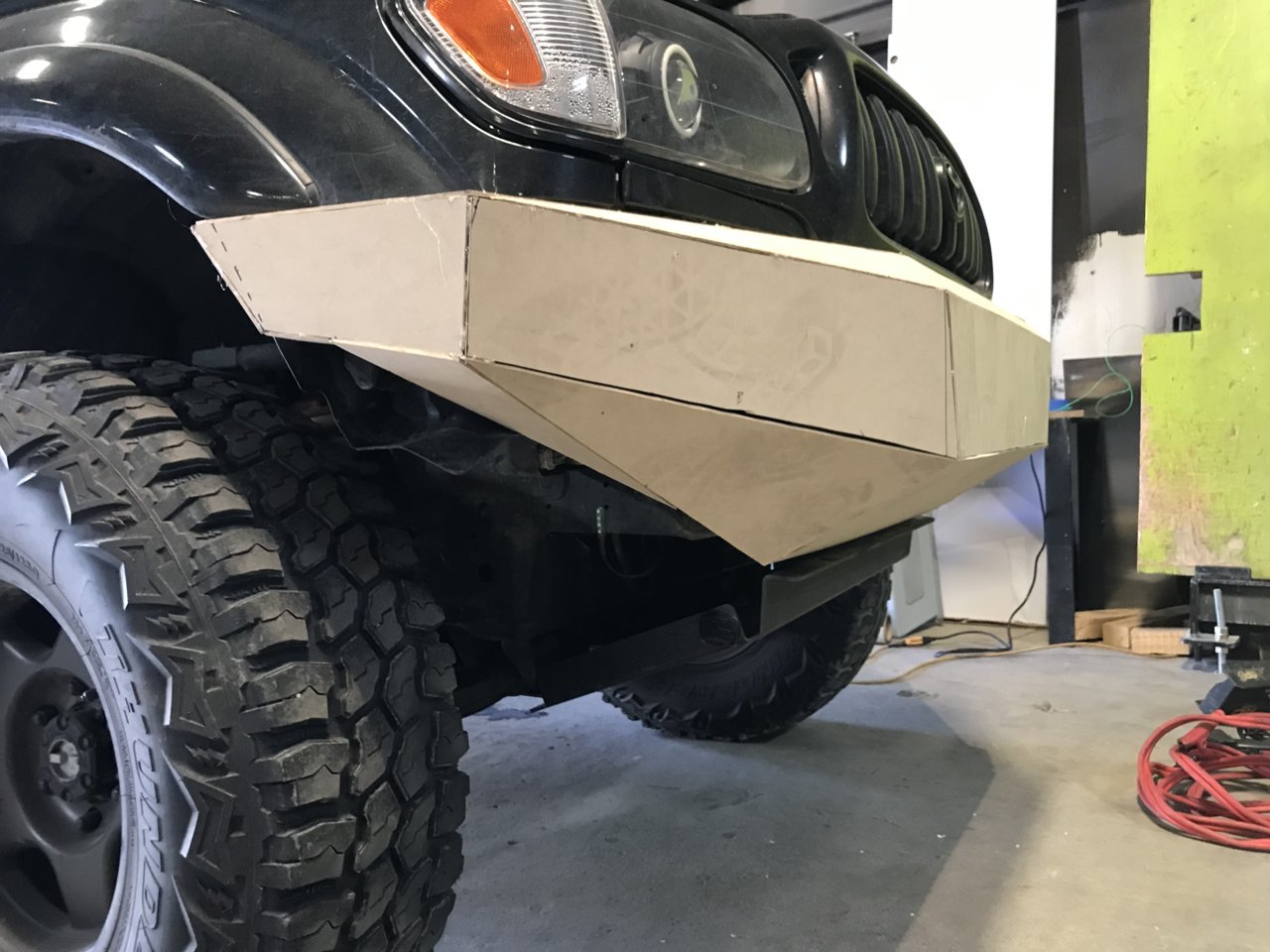

    Time for an update.
    Lately I’ve been working on a front winch bumper for my truck. I’ve done a lot of reasearch before attempting this. At this point I’ve gone there the following process, made a wood template that had to be altered a few times. Then after I was happy with the overall design I went to cutting and building the frame box that will hold the winch. Yesterday I dry fitted the winch to make sure it all fits and has enough room for the clutch lever to move around. Sure enough I have 1/8” space as planed. Next will be to build the sides. I have ordered some Baja design squadrant fog lights and will probably wait until I get them to set up the light location and hole size.
    Here are some pictures of the build in progress.

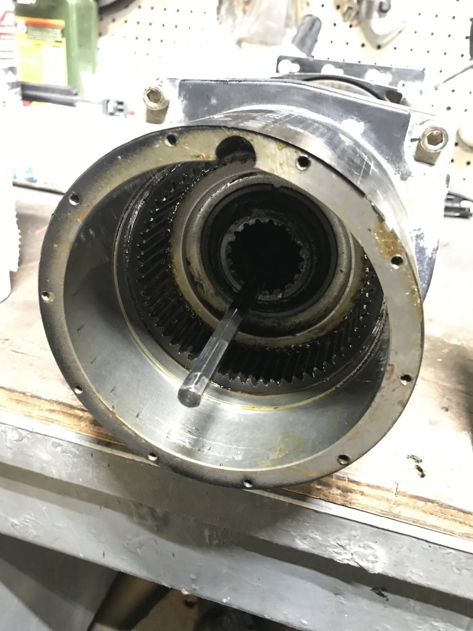

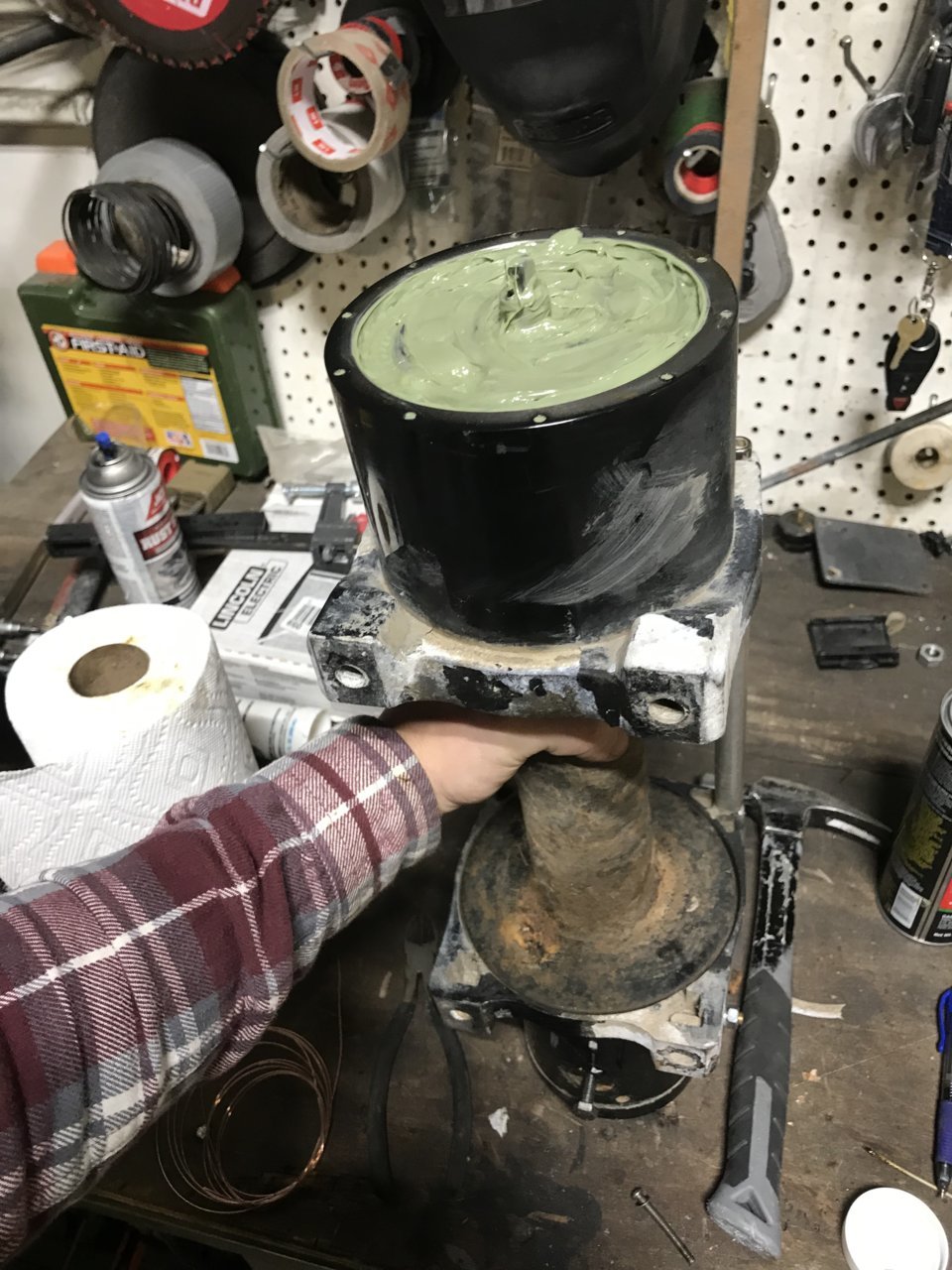

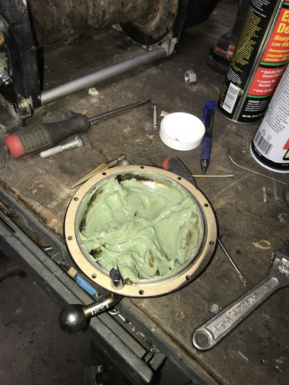

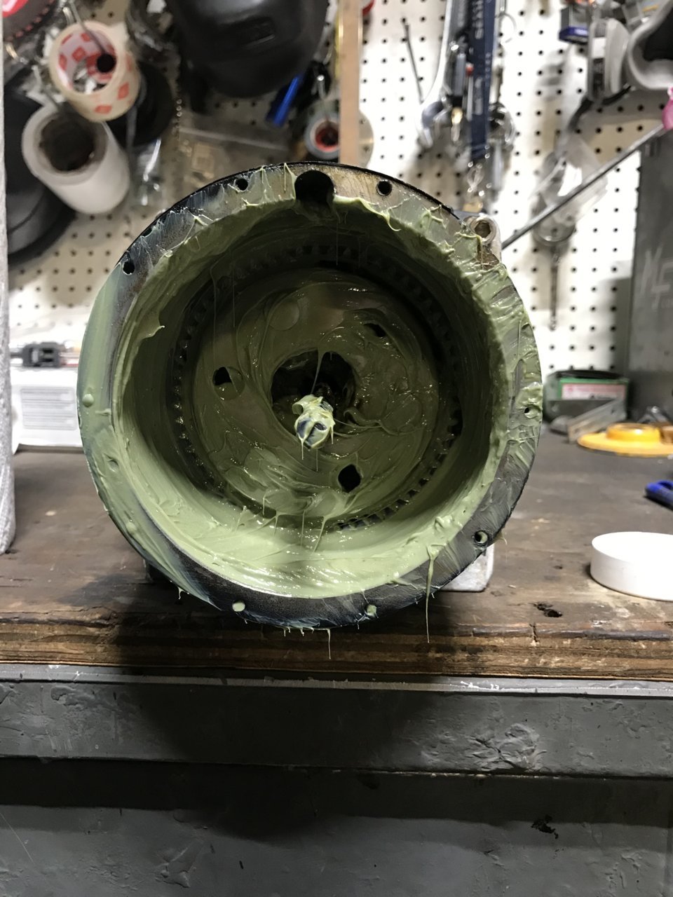

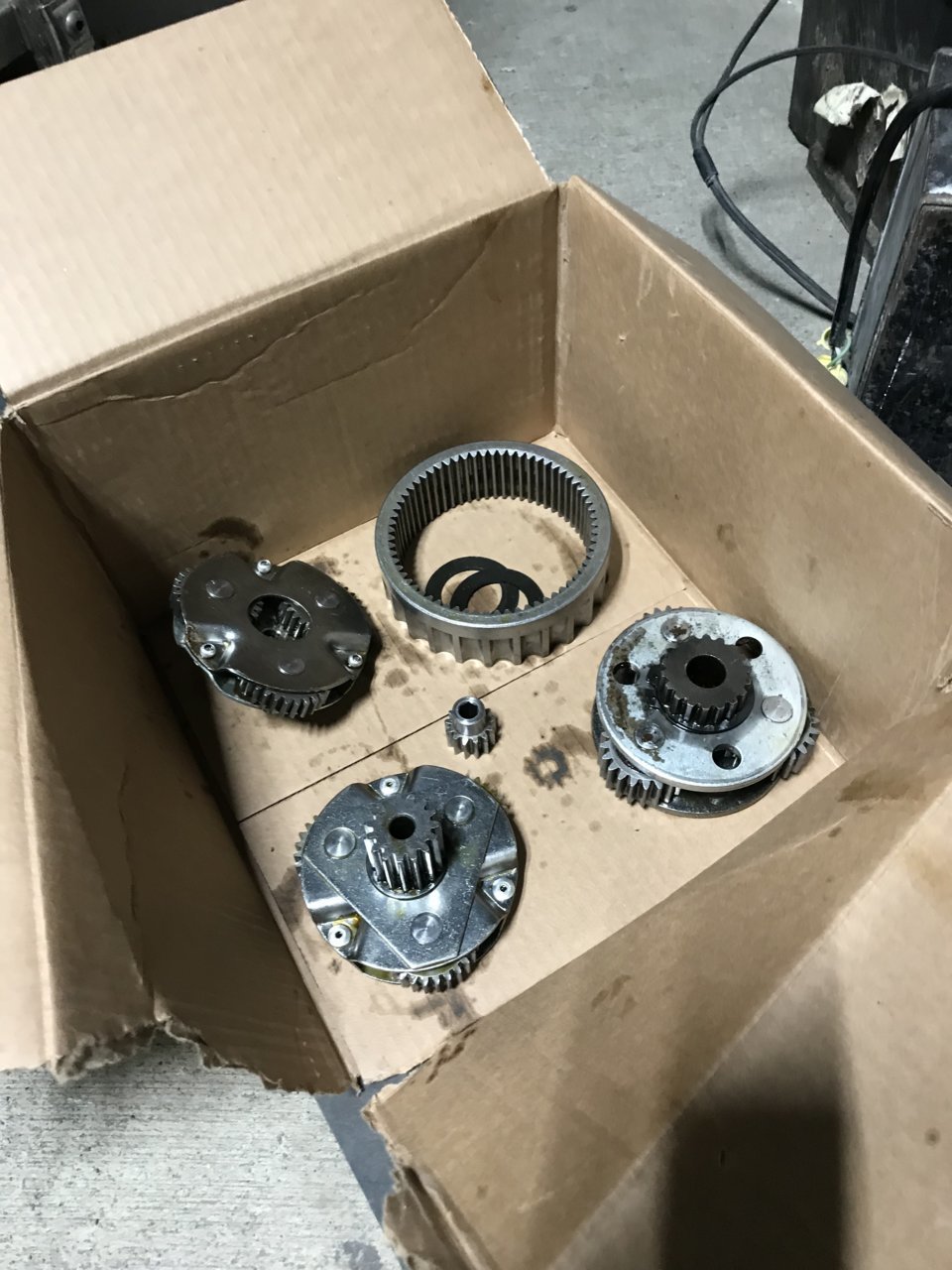

    Also did some service on my XRC8 winch, repacked it with new grease, swapped out the solenoid box, new ground. Still need to change out the rusty bolts but the big part of repacking grease is out of the way. Also mounted it up in the winch bumper to make sure it all fits as planed.
