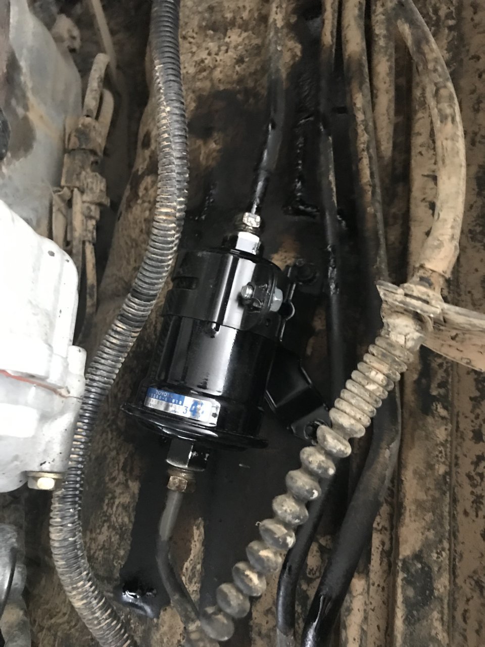

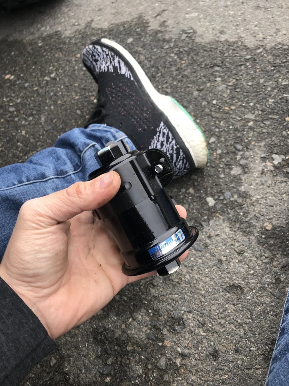

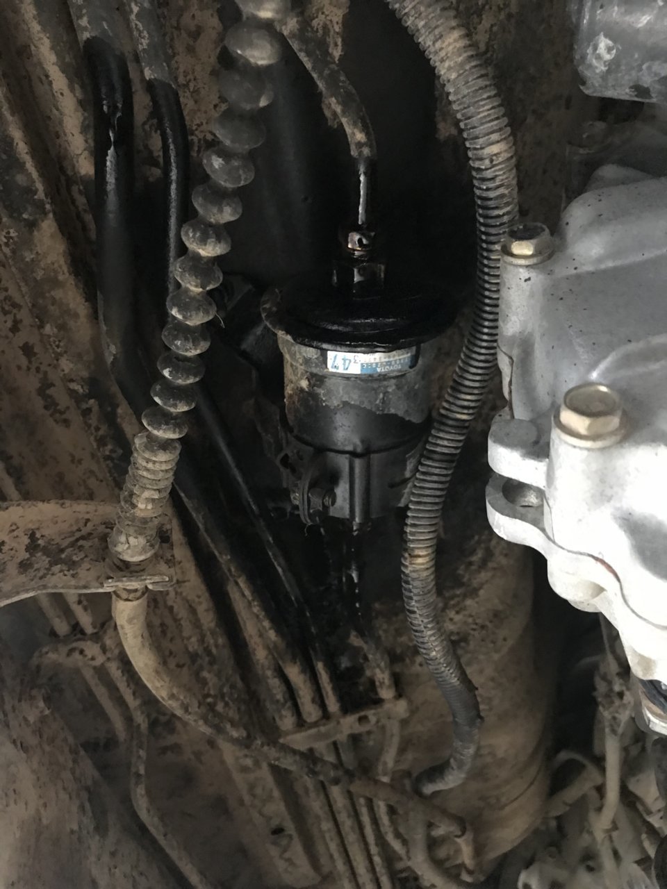

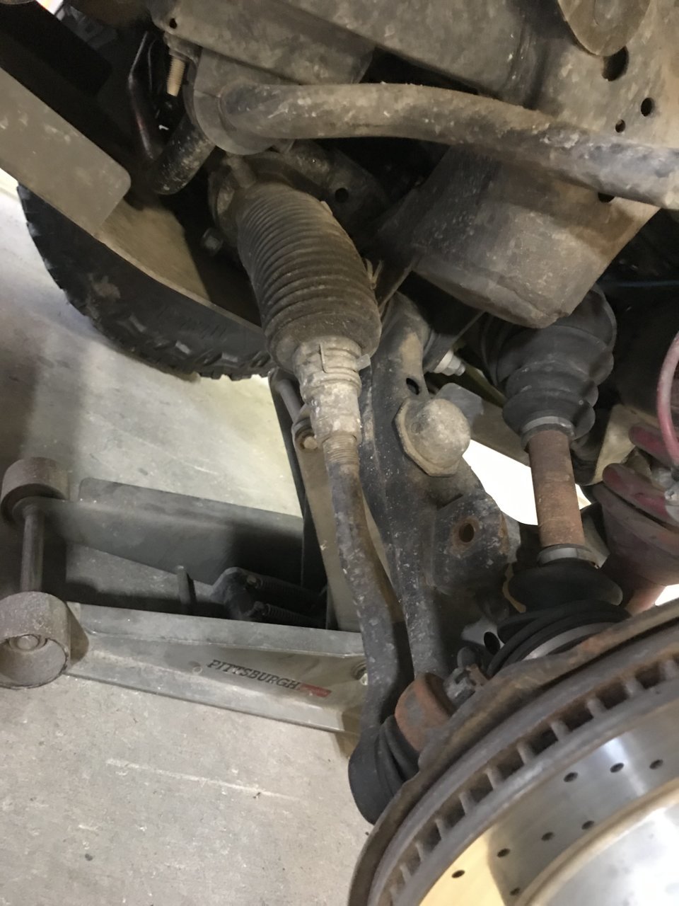

    Changed my fuel filter, looks like it was original. Very dirty.

    Whoa gas everywhere. Did you not depressurize the fuel system before removing? When I replaced my filter, I only had a little trickle of fuel from the lines.

    No I depressurize it. Took out the EFI relay and cranked the engine for a few seconds.
    All that wet area is actually liquid wrench, there was very little gas leak.

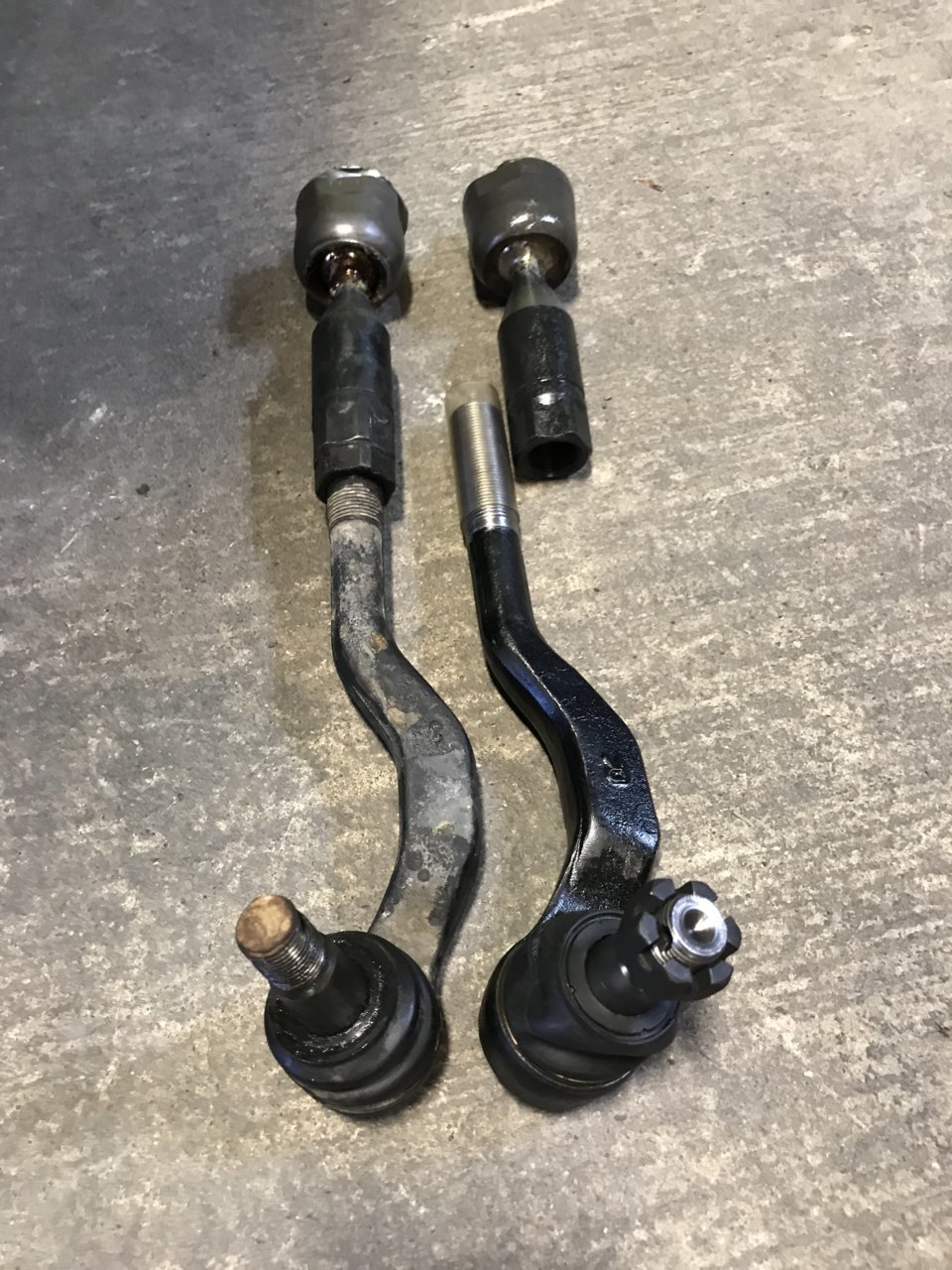

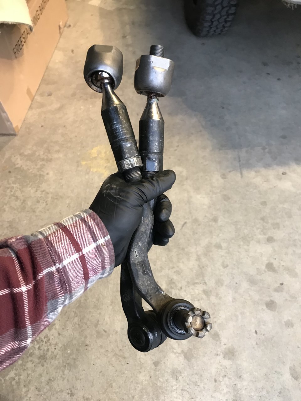

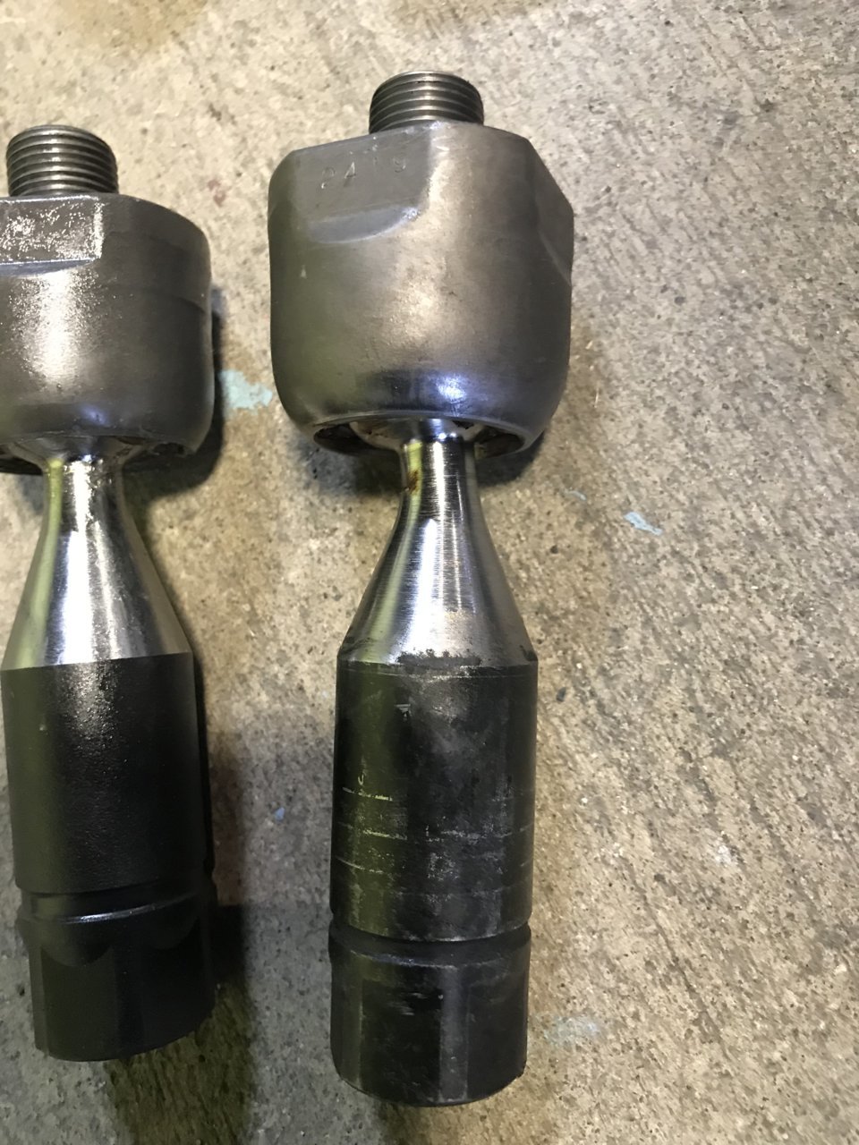

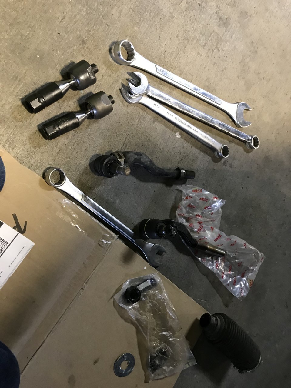

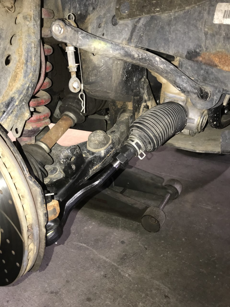

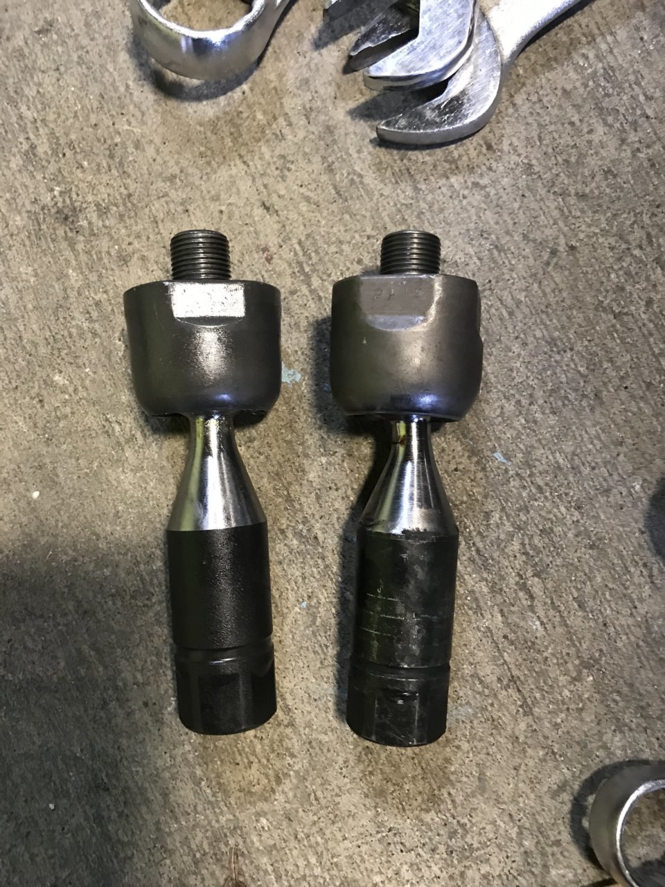

    Had to change out inner and outer tie rods.
    One of the old one was bent and all where really loose. Now time to get another alignment.

    What brand TRI's did you go with?
    I went with moog, and one is already bad, (6mo/10k mi) :bananadead:
