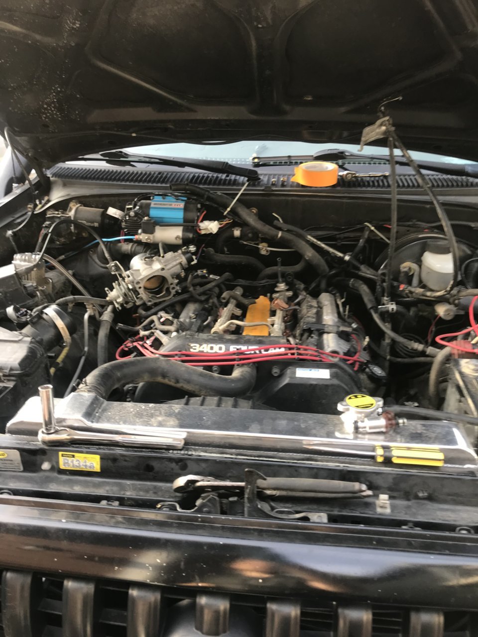

    Swapped out my coil wires today.
    Easy swap. Took about 15min.

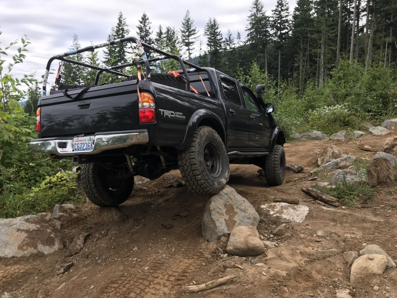

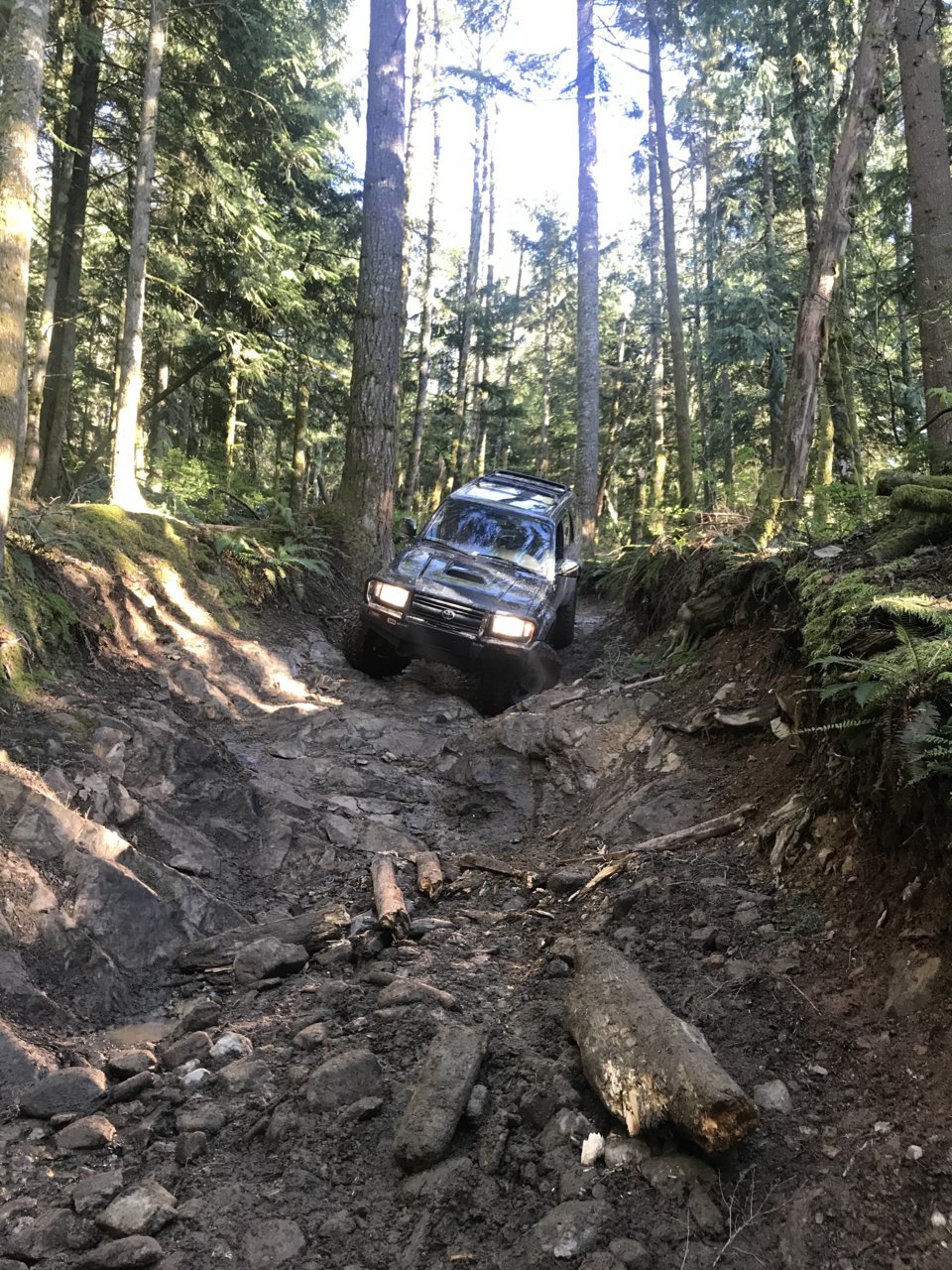

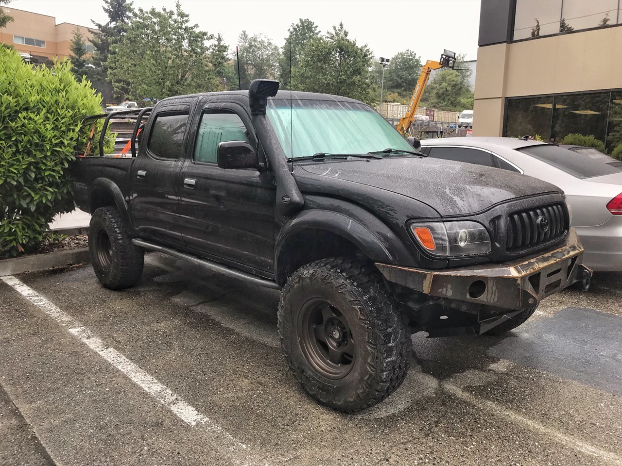

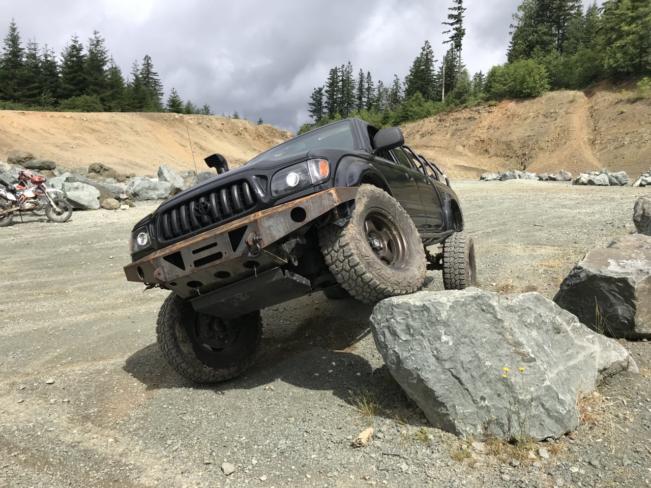

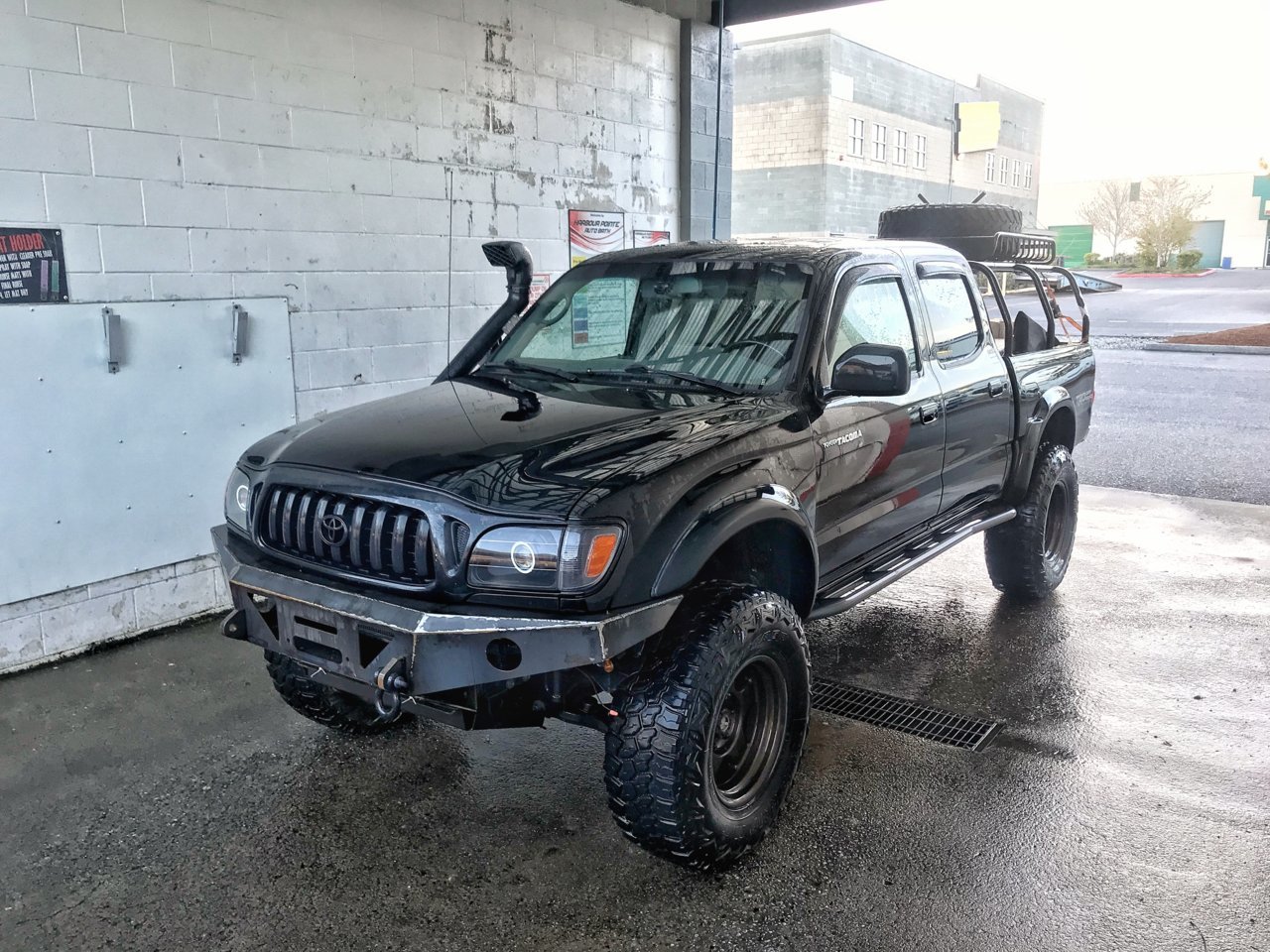

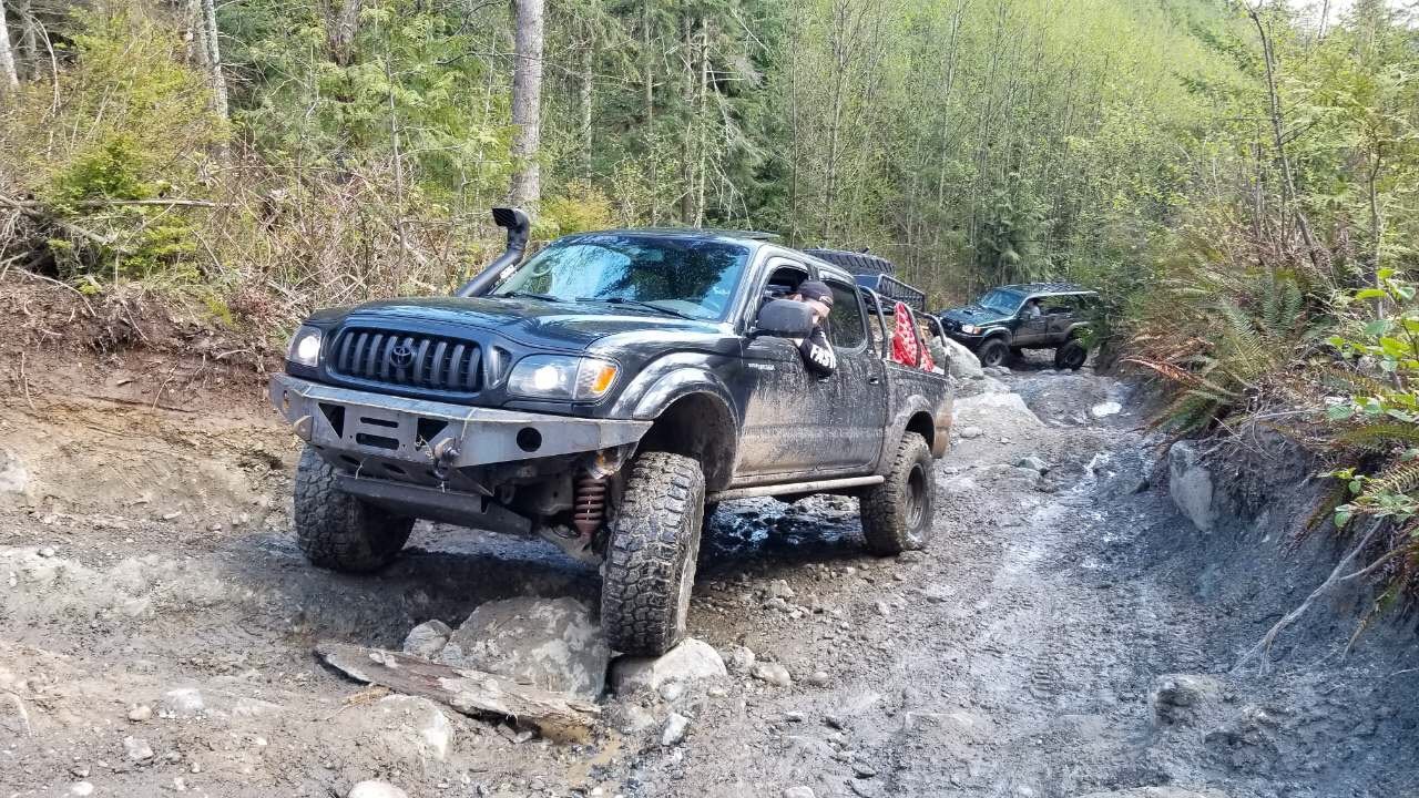

    Also here is last weekends trip to Walker Valley. And first wash of this year.

    ARB front locker, Custom high clearance rear bumper, Custom plate front bumper, mile marker winch PE8, safari snorkel, Deck Plate Mod Fox 2.5 rr DSC, Camburg UCA, squeaky Dakar leafs, 5125 10" and custom 7.5" shackles, thee finest PNW pinstripes, MT-R, Nissan crew cab roof rack??? wtf is that about??? Allpro skids, Rigid duallys President McKinley CB with PA Recaro SRD with Wedge Engineering Morimoto retrofits Champion Rad - Failed Tundra brakes
    Lol on the wash!
    I had to break down and wash also as the fine dust and 1M painted lady butterflies in Death Valley impaled themselves on my windshield, bumper, headlights, skid plate, etc.
    It took $35 at the local spray/wash and about 45 minutes...
    Amoore131 and BlackPearl[OP] like this.

    I did a quick wash on mine. probably 20min. sure beats doing it at home and having to wash the drive way after.
    One of these days ill finish up the bumper and after I plan to detail truck inside and out. Give it a good wax too. That will be nice.

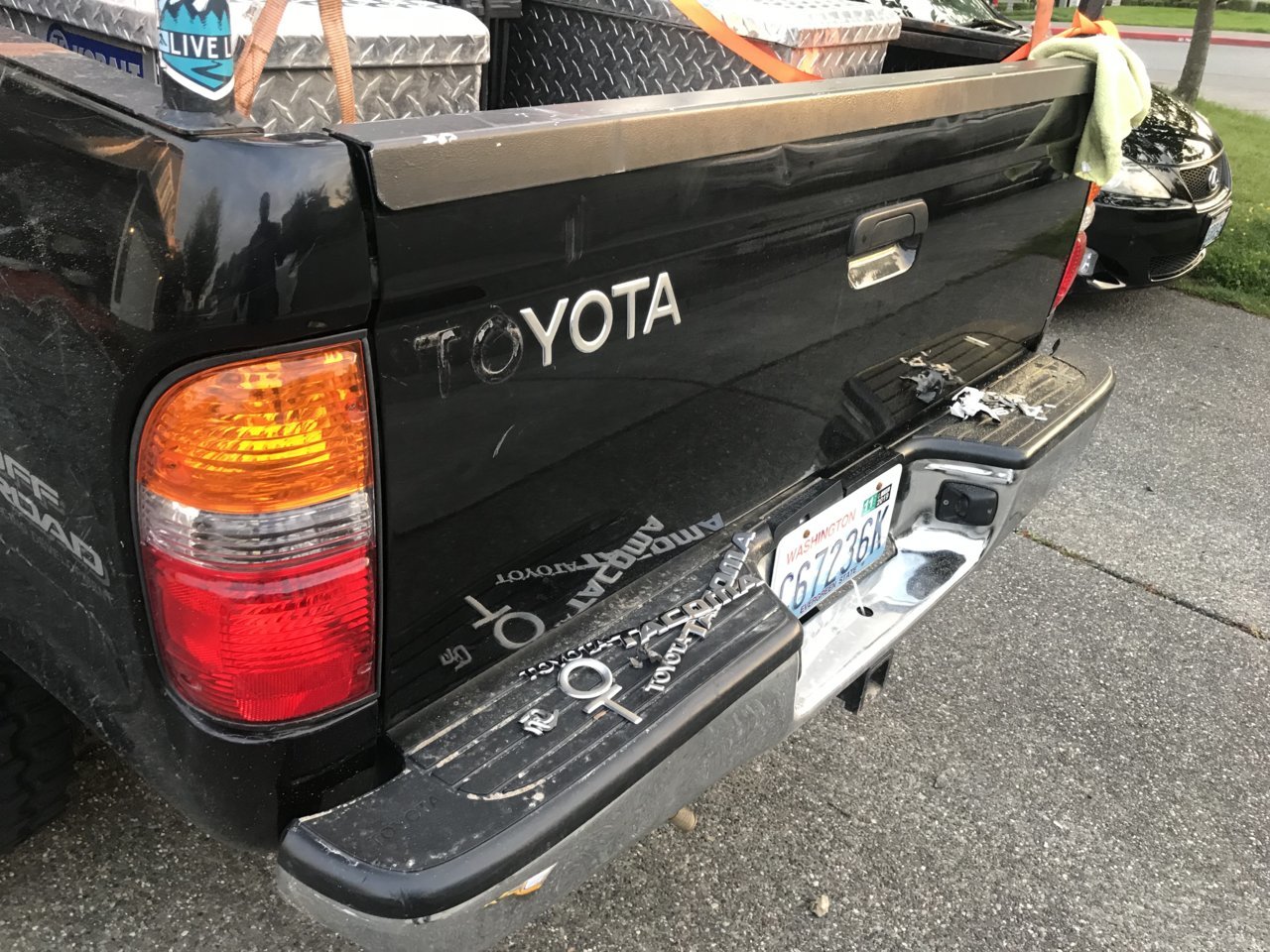

    Finally got around to de-badging the truck.
    Last of the chrome to go will be the rear bumper and door handles on passenger side. But that’s for another day.

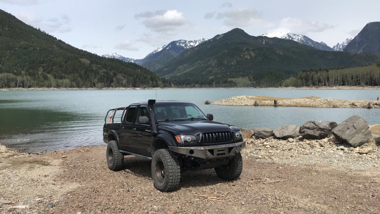

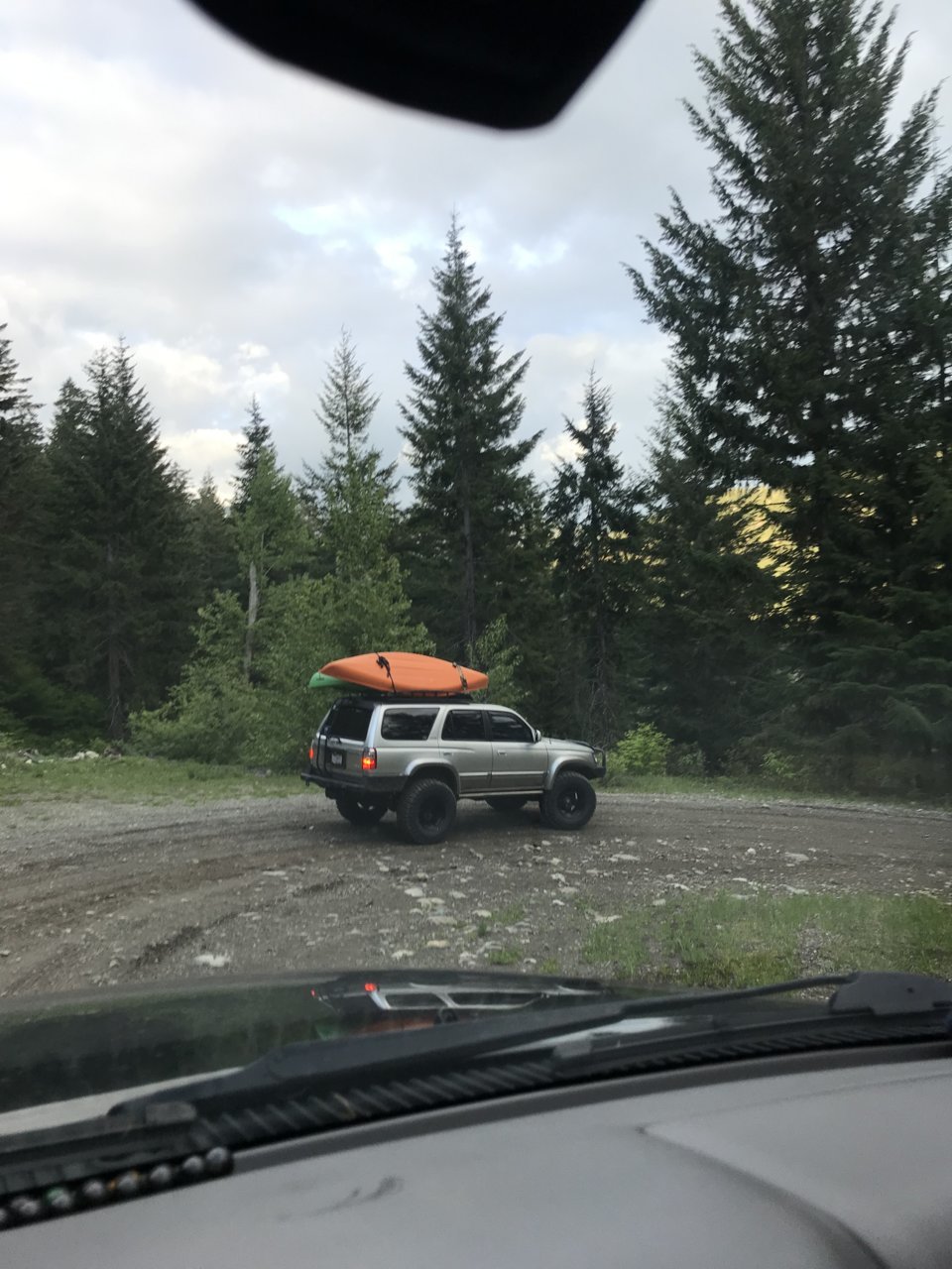

    Another trip today out to Kachees Lake. Found some snow at the top. Good times.

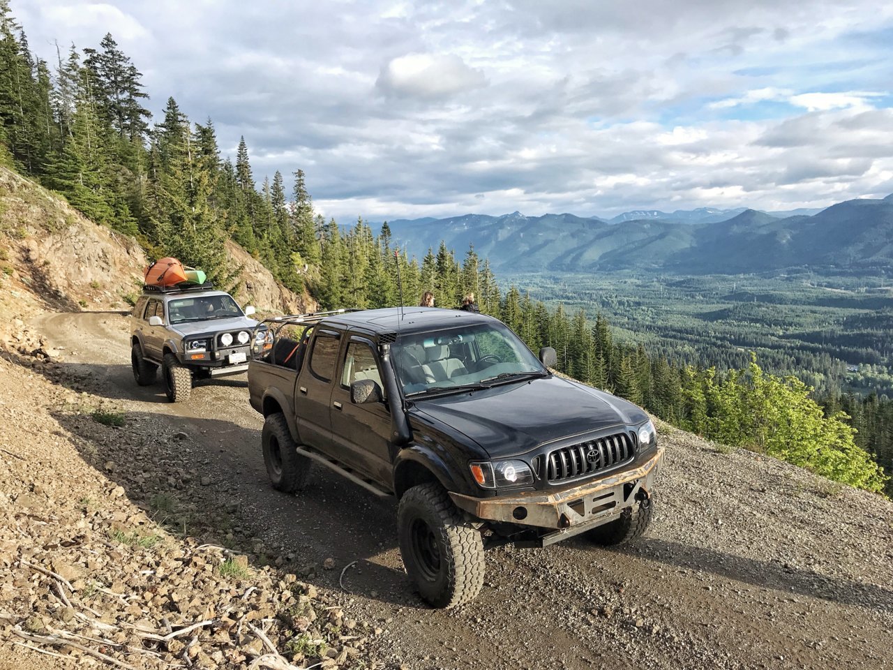

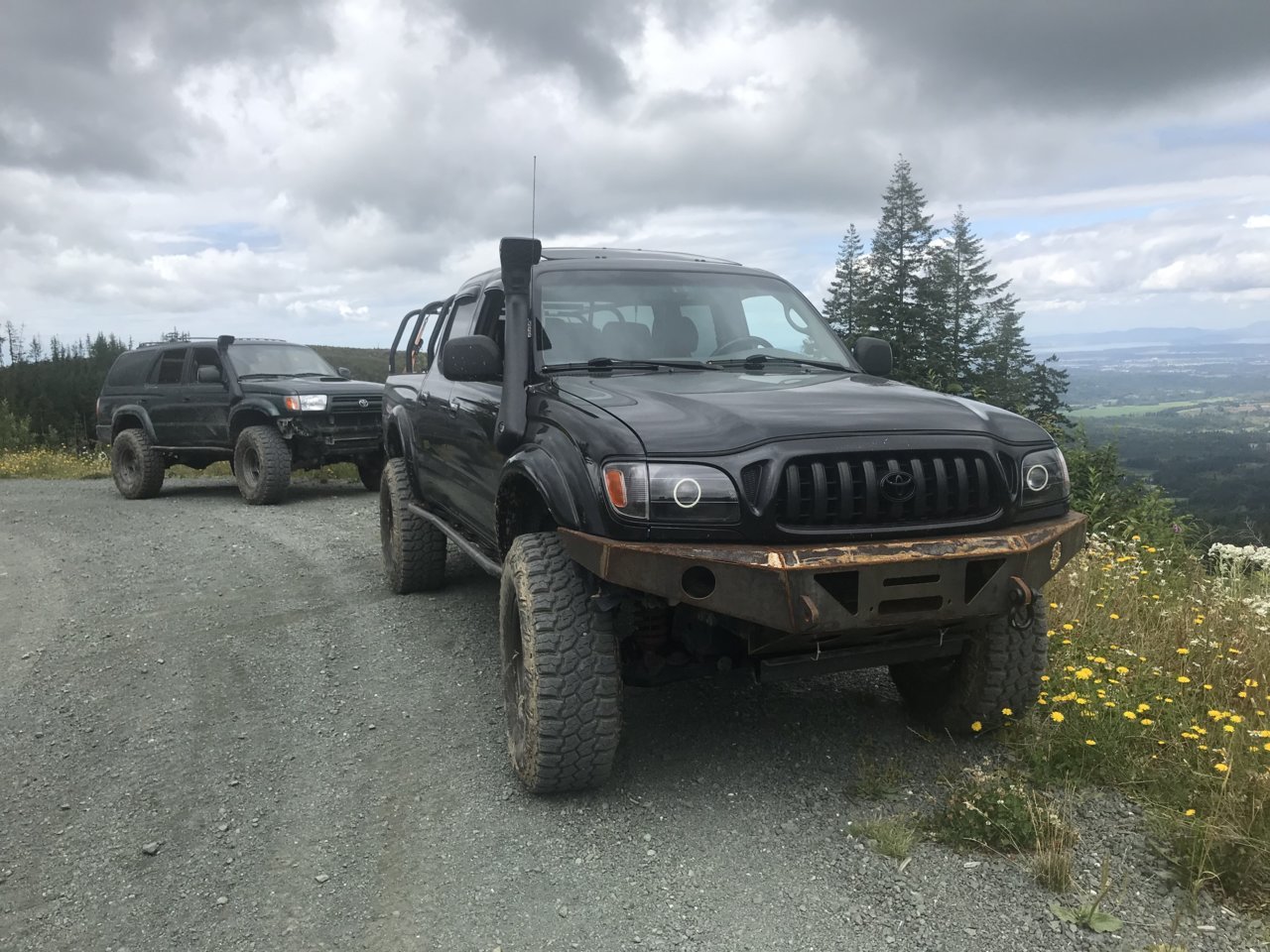

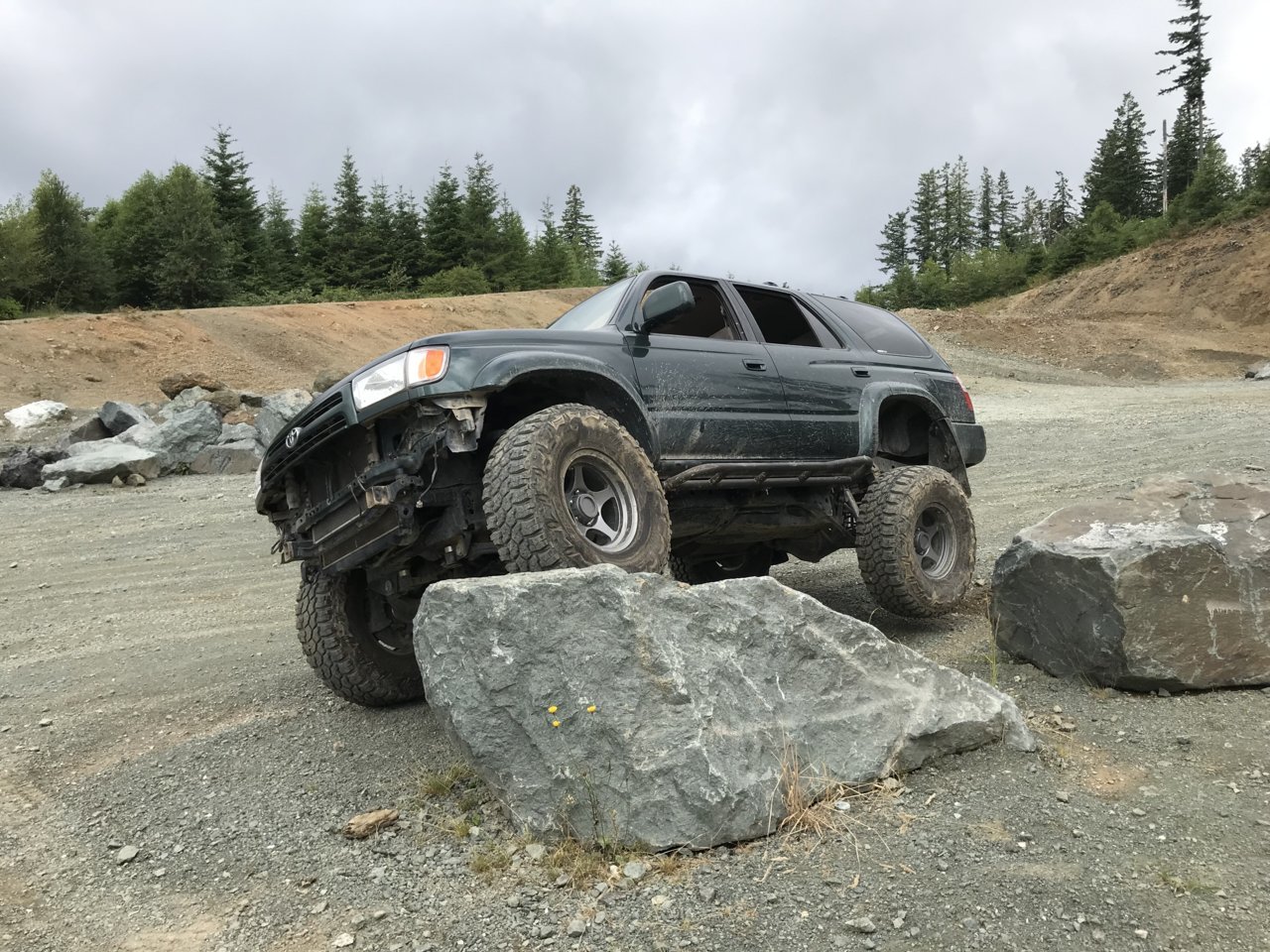

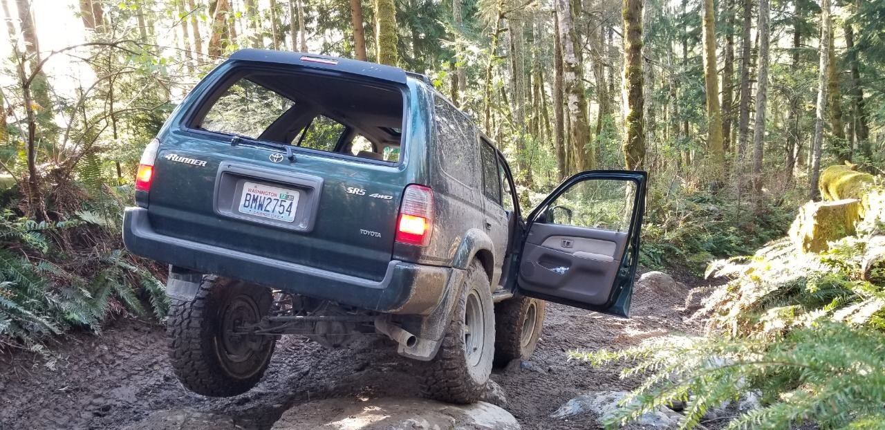

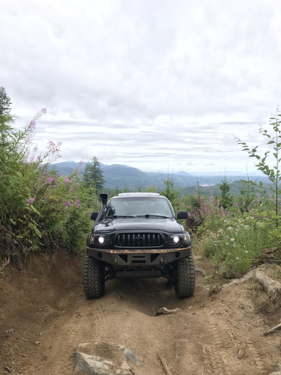

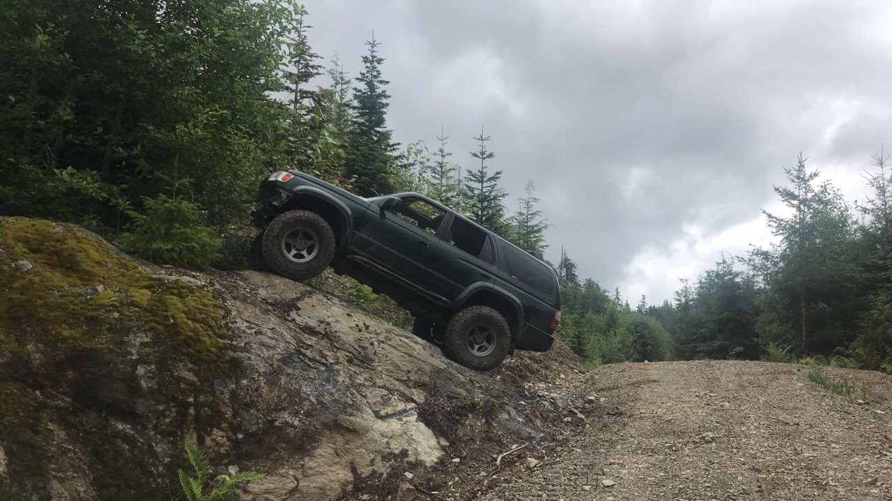

    Alright it’s time for an update, and a pick dump.
    Last weekend went to Walker Valley with a 3rd gen 4runner. Had a good time running the trails. Only damage was a slightly dented drive shaft. Starts vibrating hard at about 65mph. Will need to have that fixed.

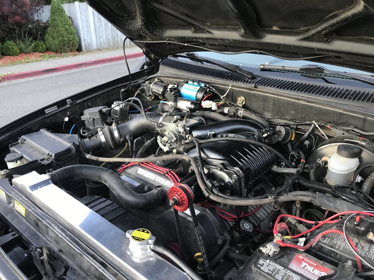

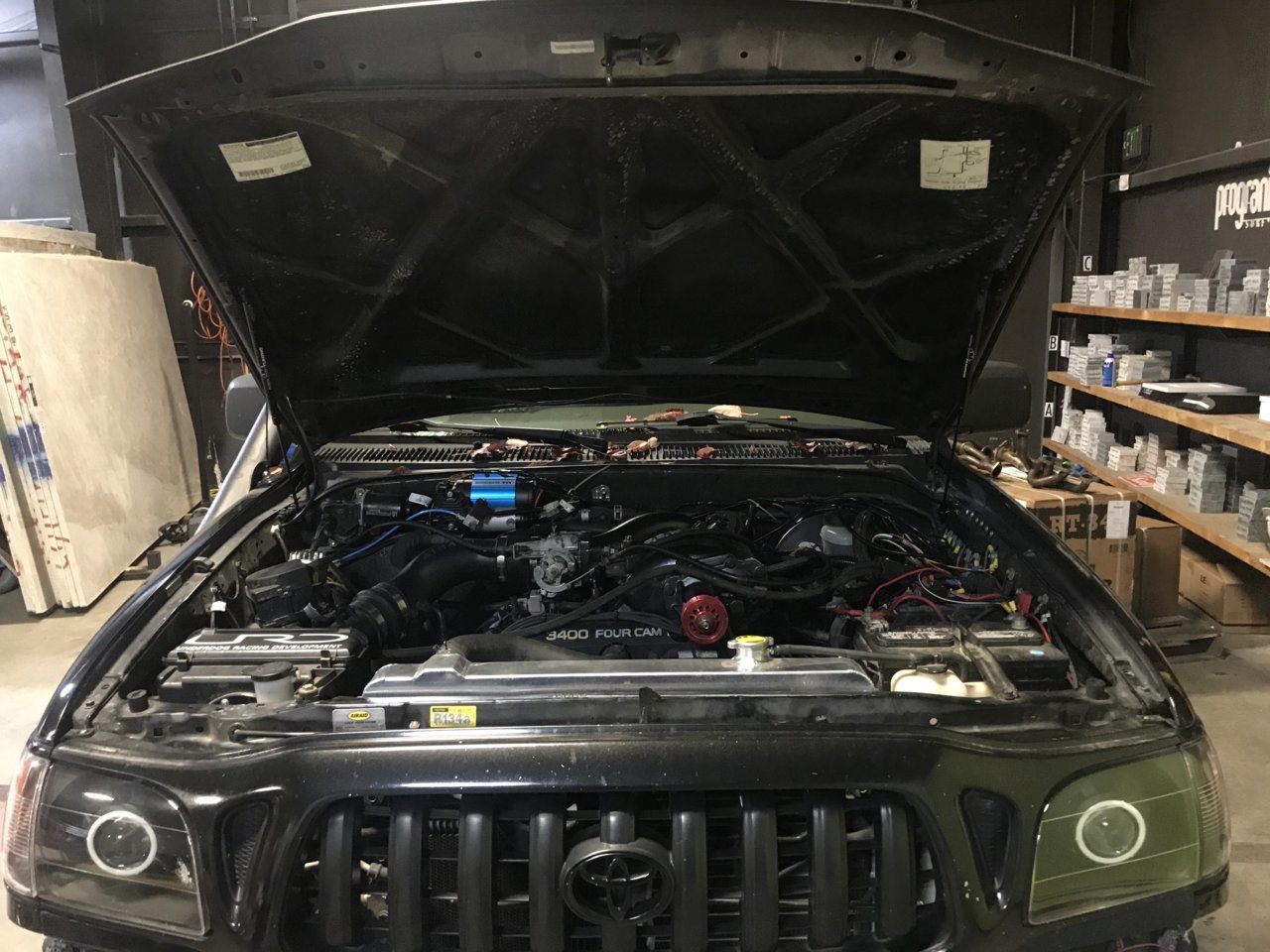

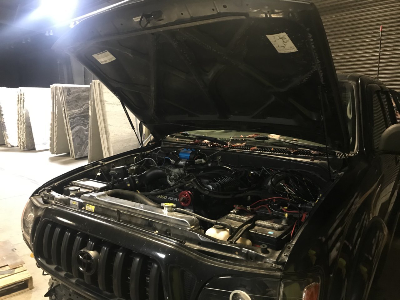

    On another note, also swapped in my s/c.
    Currently still need to swap in the urd fuel pump and figure out what to use for tuning it. Leaning more towards the urd mas air flow fuel & timing calibrator.

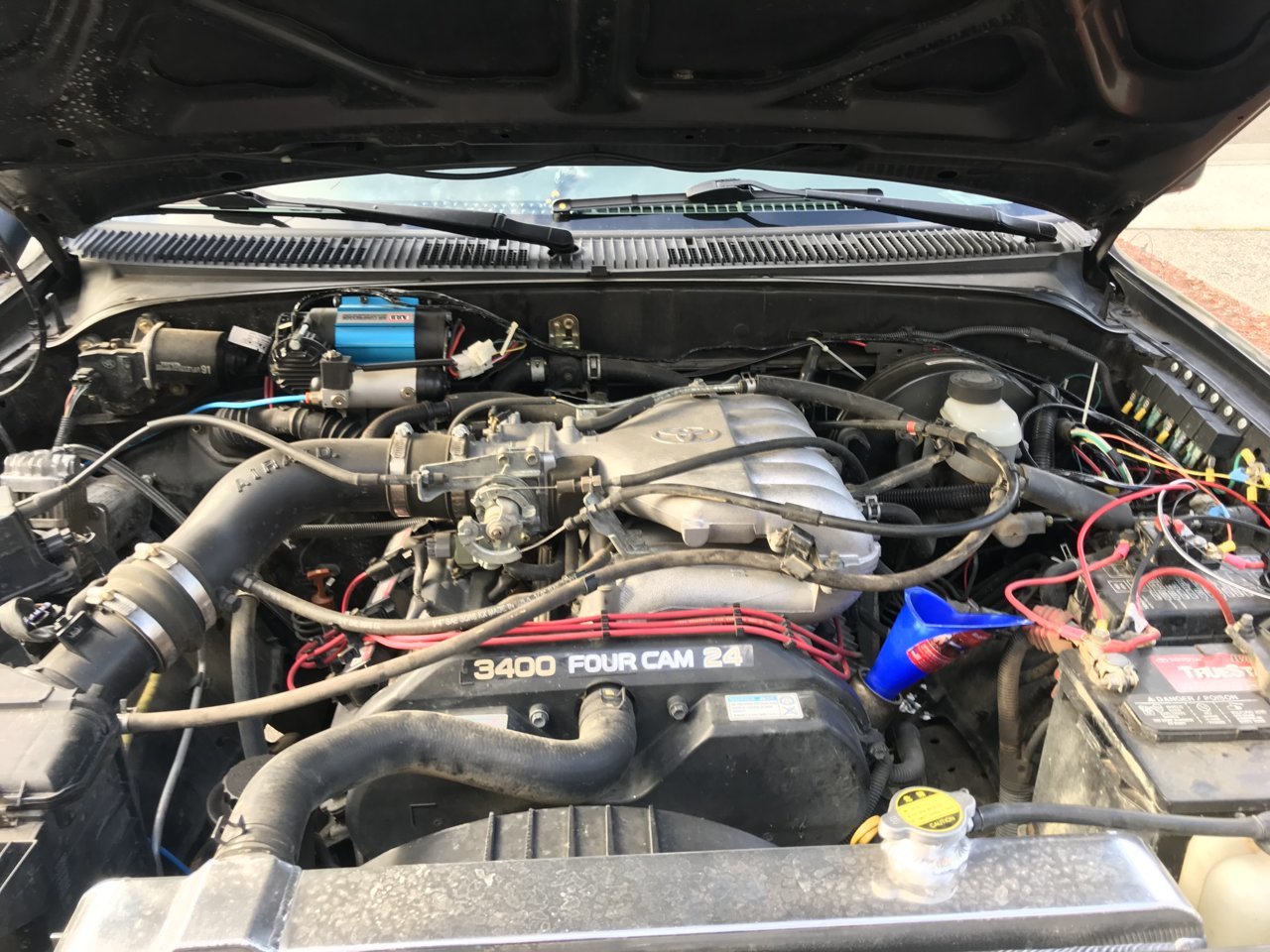

    Make sure to do a lot of research as it wont be an easy swap. I'm currently chasing down 2 codes. P0300 & P0306, basically a multiple cylinder misfire. I'm hoping a bigger fuel pump and a piggy back will help me get rid of these issues.

    did you switch to 93?
    also did you check your plugs when you installed?

    Yes, running 93 and I installed a 3 prongs sparks with .032 gaps

    I feel like thats a bit large on gap? (would only cause misfires at higher load, probably you'd notice a stumble or hesitation)
    What heat range are they? (could cause intermittent misfire/detonation if to warm, probably you'd notice more than just a code, but no real pattern, would happen most after the truck is warm)
    And which pulley is that?

    Spark plug I'm using is BCPR7ET 2164
    also running bigger injectors 23250-46031 (305cc)
    The pulley is a 2.2
    I'm getting rough idle but when the truck is driving it seems to even out.

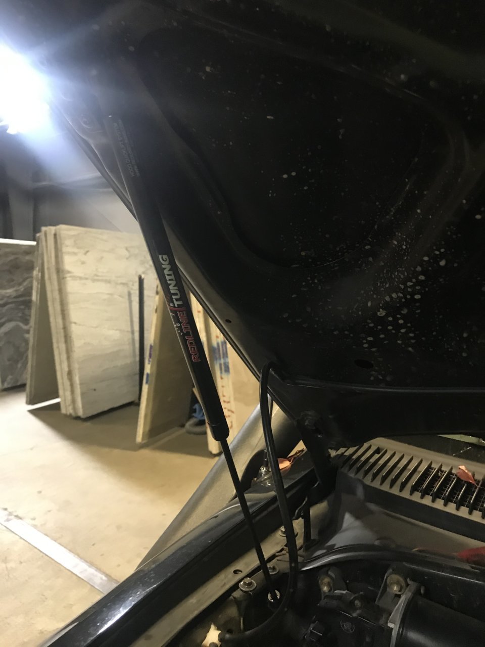

    Installed Redline Tuning hood struts today. Way easier then I thought it would be. They have very detailed instructions. Now my hood opens up more then before and I don’t have to use the stock stick to hold it.
