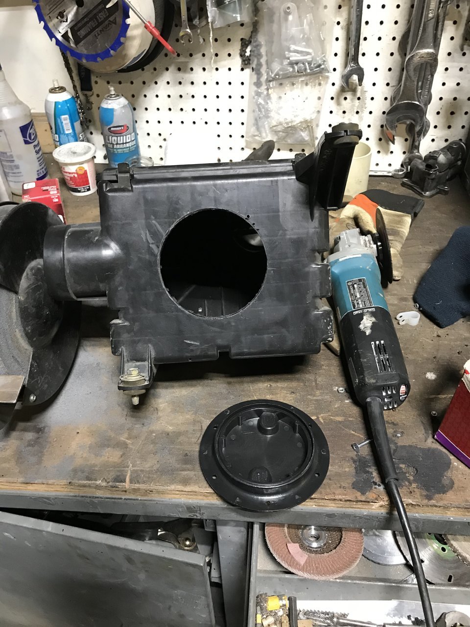

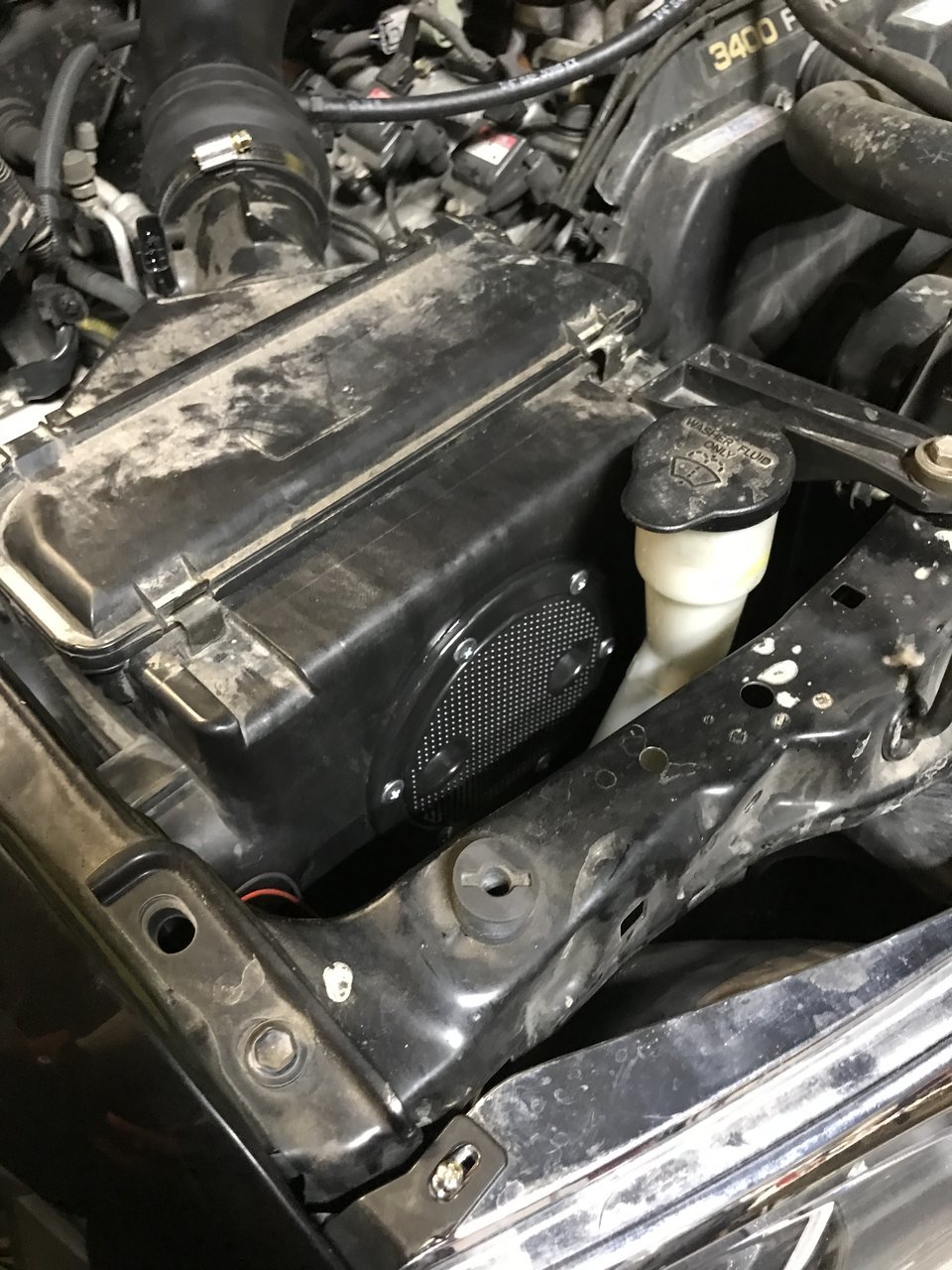

    any issues with the airaid? I keep throwing a check engine light after installing this past weekend
    Nice truck dude
    Ngneer and BlackPearl[OP] like this.
  6. Mar 6, 2018 at 4:46 PM
    #86
    BlackPearl
    BlackPearl [OP] Well-Known Member
    Apr 17, 2017
    #216527
    1,362
    Alex
    Toyota Tacoma TRD
    3” lift. Sway a ways 2.5 on 285 75 16 and much more
    Thanks,
    And I did get a check engine light about 300 miles after I installed it but I don't think its related to the intake. The code was for a vacuum leak. Probably gas cap was loose so I tightened it and re set to light. 200 miles late no check engine light. I did notice in idle with stock boot boot was around 1k RPM but with the air aid it went down to .7 RPMs. other then that it seems fine.

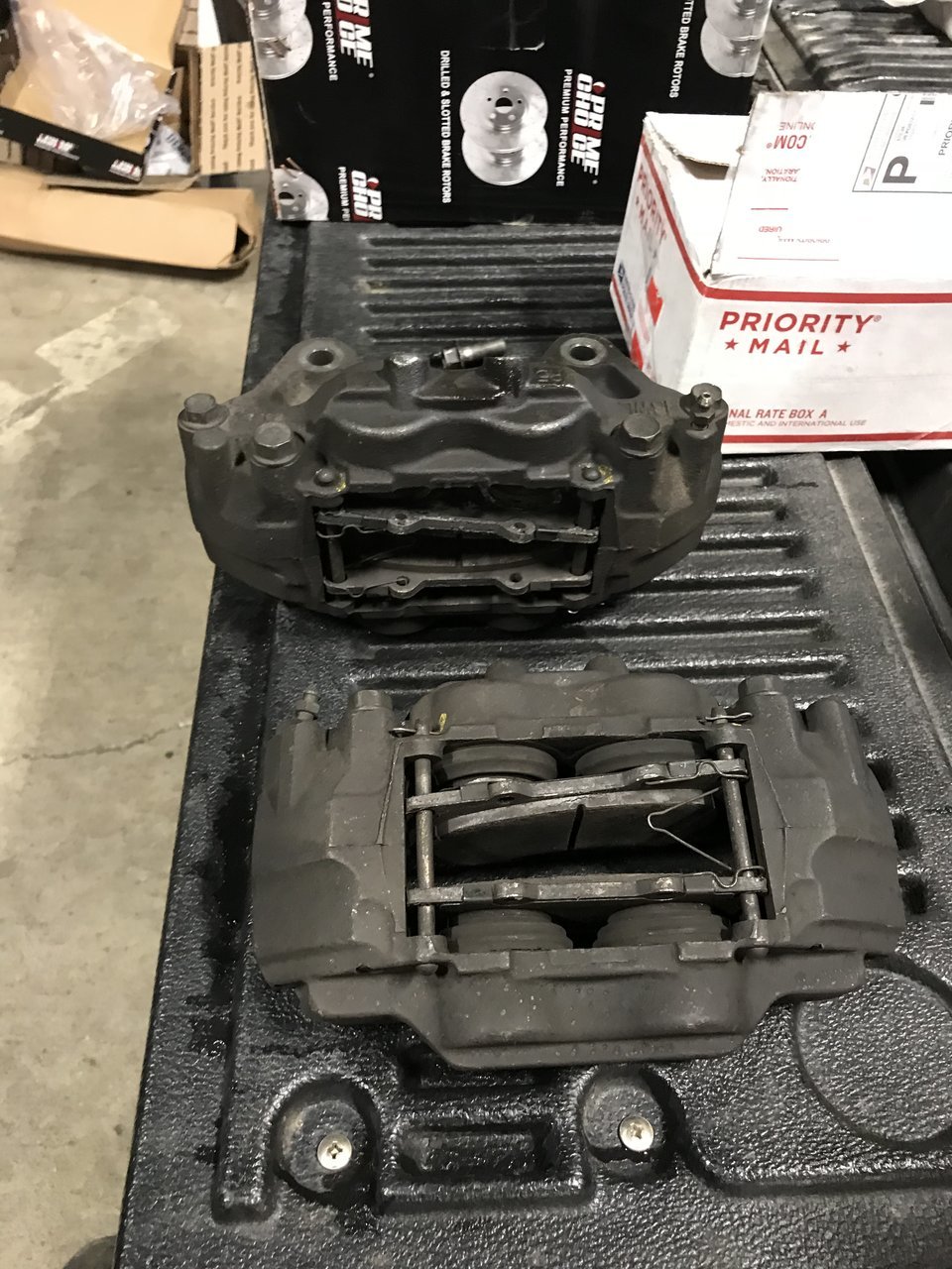

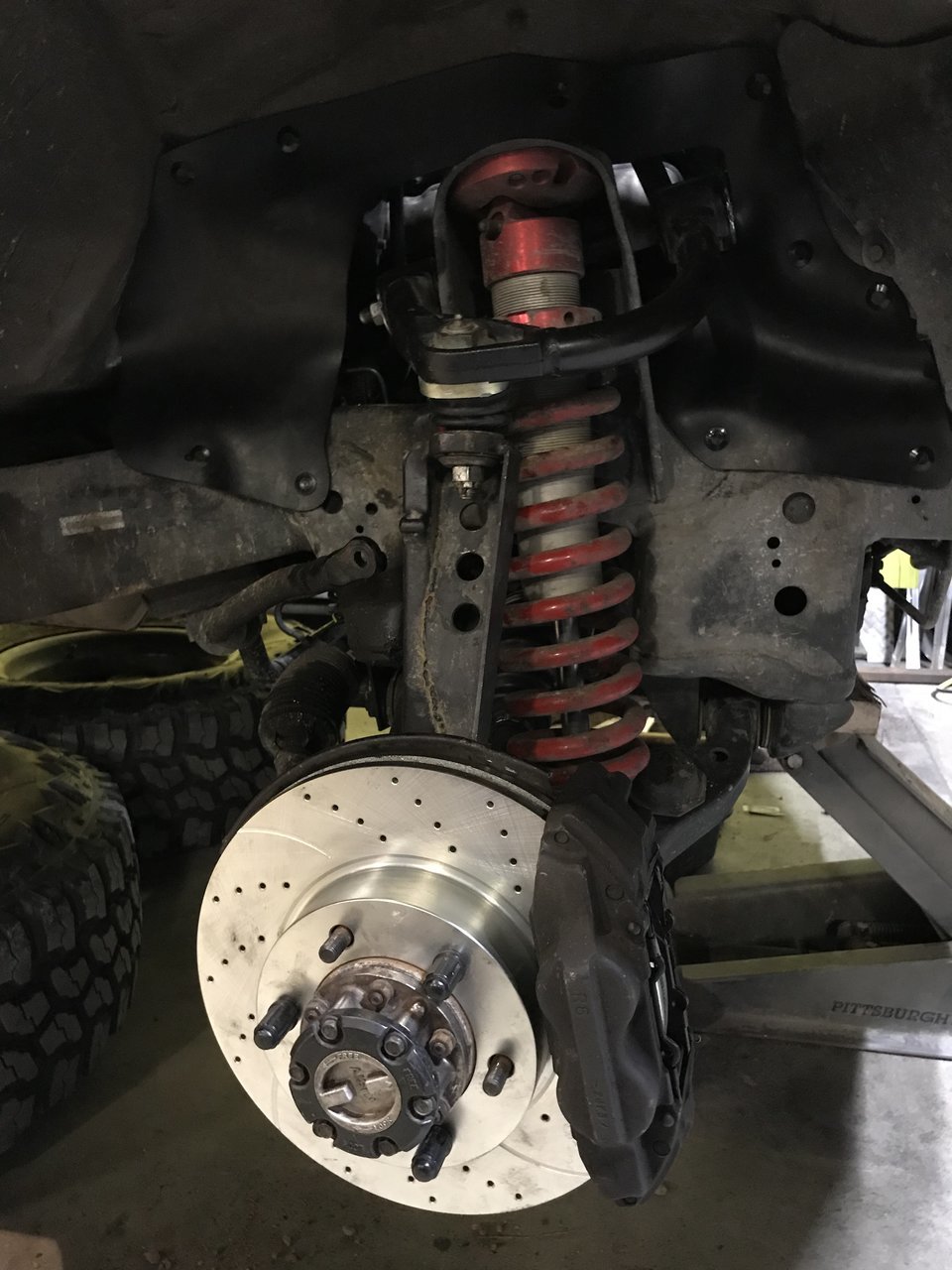

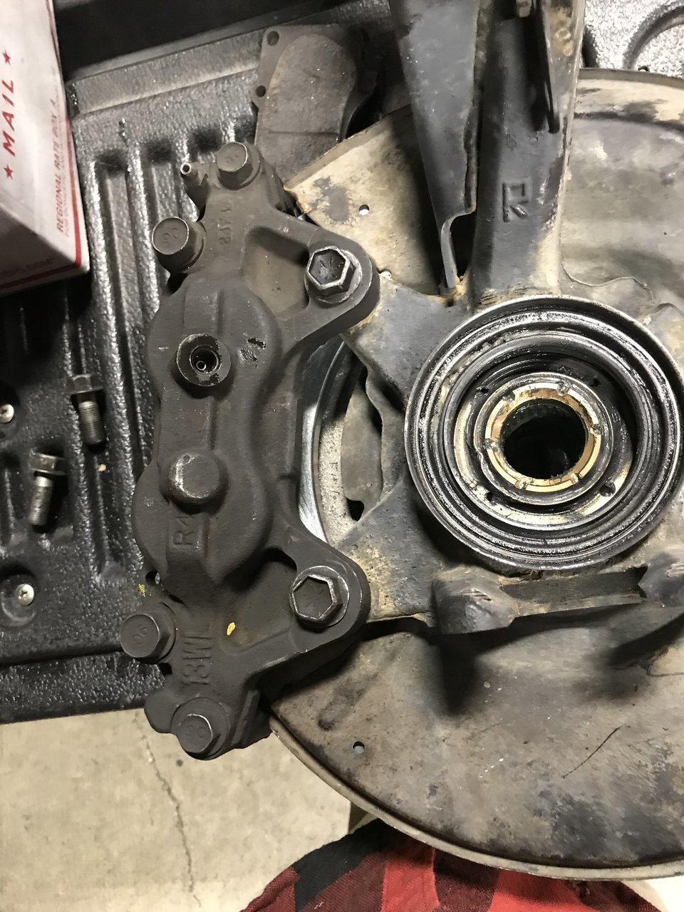

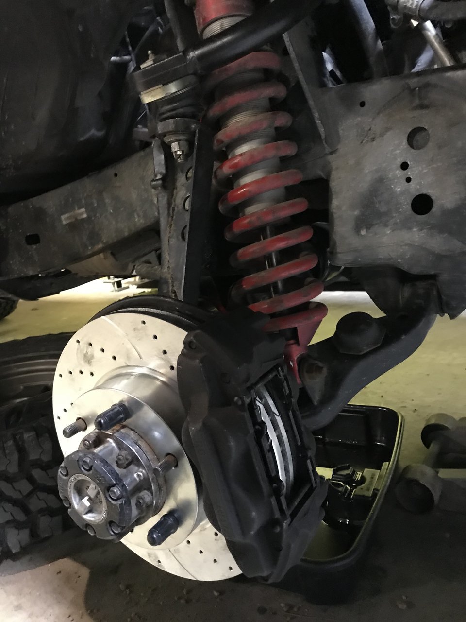

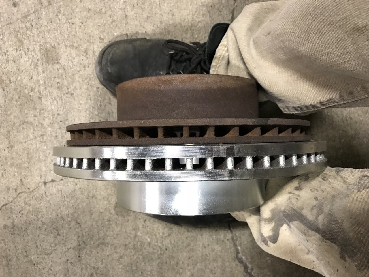

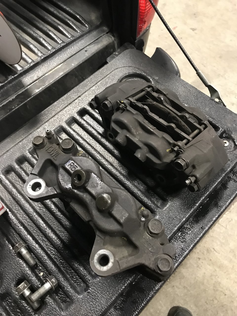

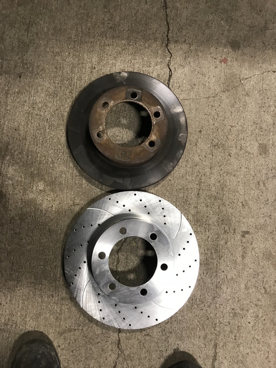

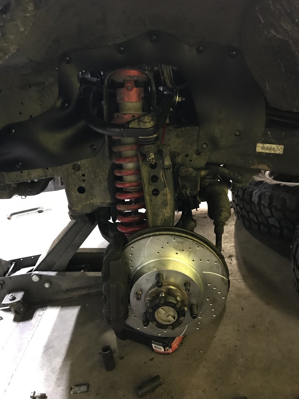

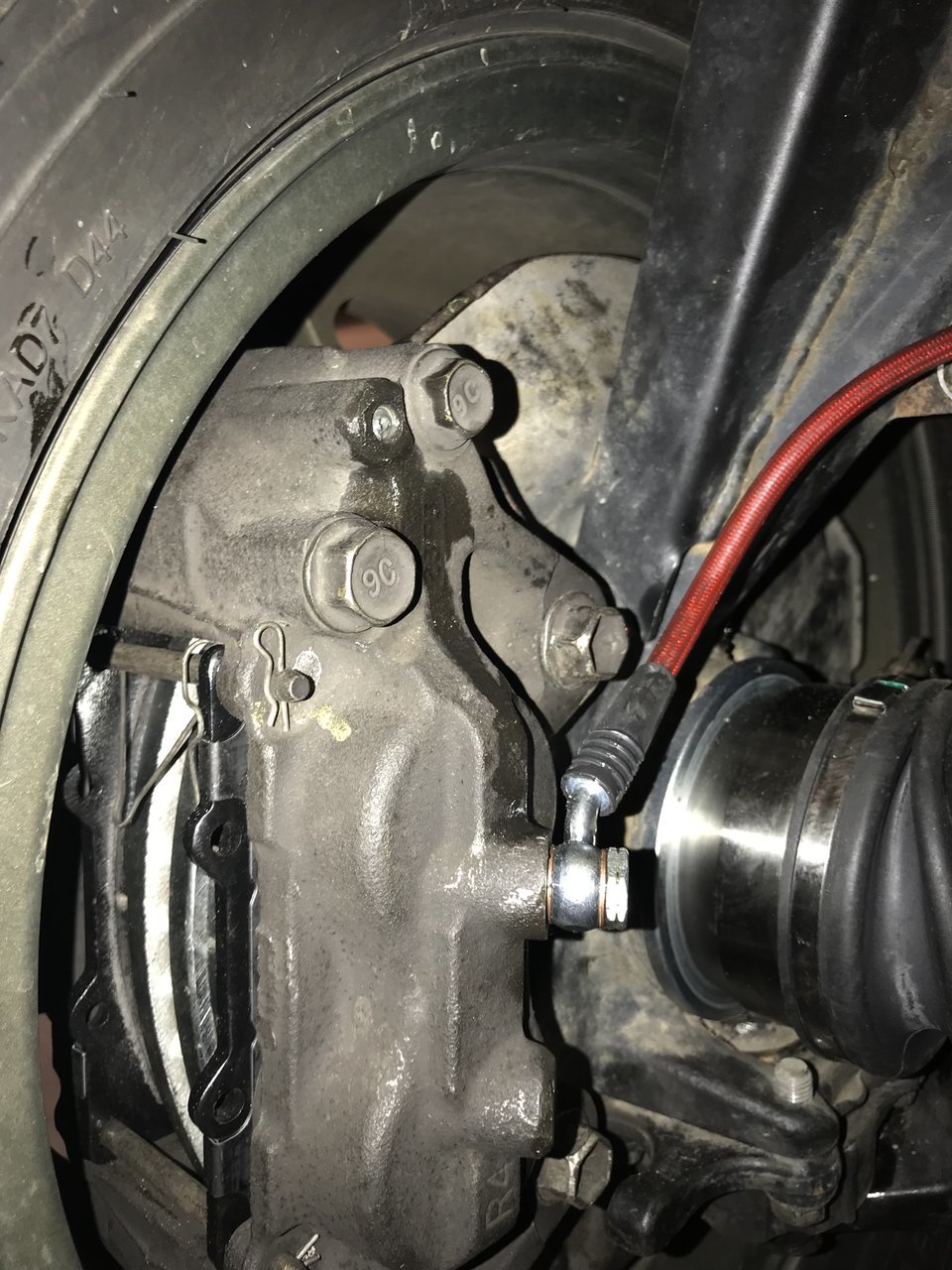

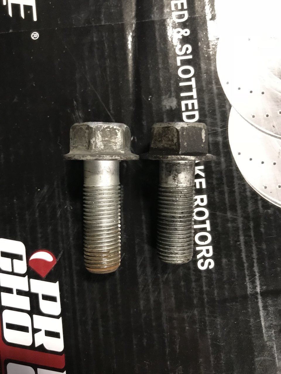

    Today’s mod was Tundra 13WL brake swap.
    And while I had the wheels off also swapped the cv axles and UCA washers.
    Brake swap was very easy and trimming the dust shield was very minimal.
    Tundra brake parts list:
    * OEM tundra calipers 231mm
    * Silver Preformance Drilled and Slotted rotors.
    * OEM Tundra caliper bolts (shorter than tacoma bolts, see picture)
    * Wheelers off road brake lines
    * Akebono ACT976 ProACT Ultra-Premium Ceramic Brake Pad Set
    At this time I’m still finishing up the driver side. Hopefully will be done tonight and can test my new brakes.

  9. Mar 11, 2018 at 12:14 AM
    #89
    BlackPearl
    Apr 17, 2017
    #216527
    1,362

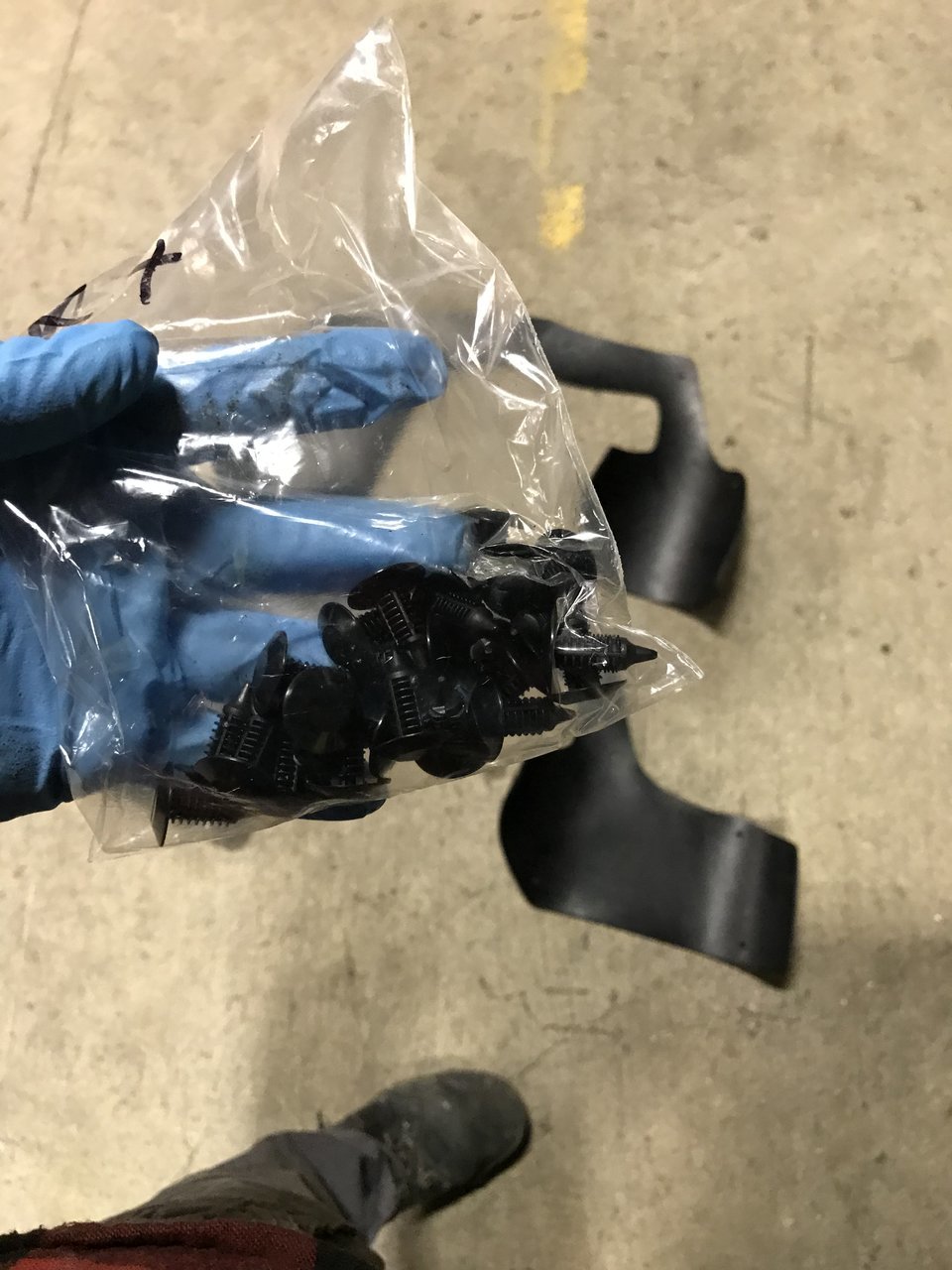

    Alex
    Toyota Tacoma TRD

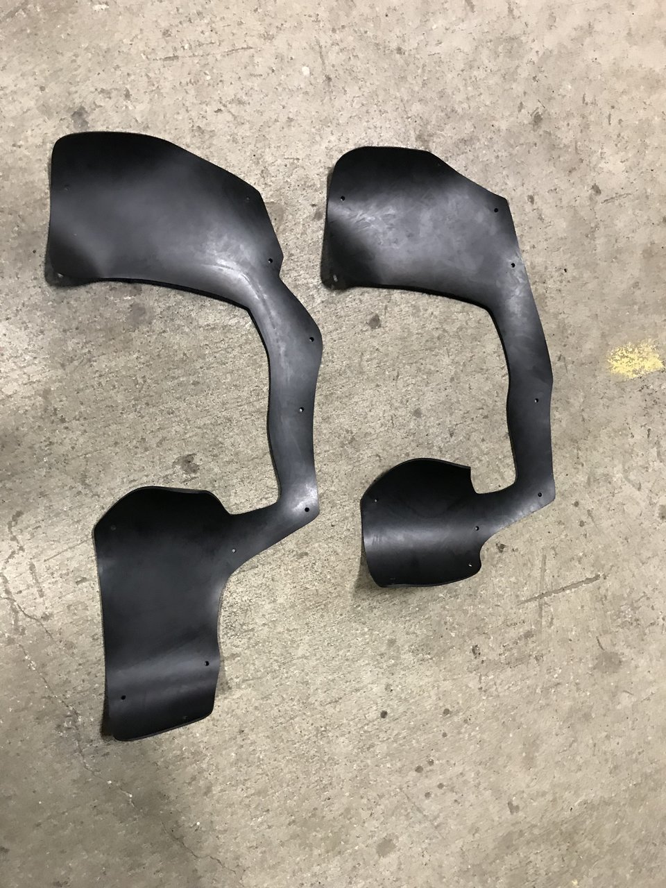

    Finished installing the tundra brakes also installed the splash guards from @cnote4l
    A few holes where off so I drilled new ones. Fast easy install. Oh and did the deck plate mod.

    cnote4l
    cnote4l Gear Tech Customs Vendor
    Jul 19, 2015
    #159851
    971
    Cody
    Evergreen, CO
    2016 TRD OR
    There should be 2 pre fab holes along the bottom row that are slightly offset (1/2" - 3/4") this is intended to force slack into the splash guards to accommodate for body/frame flexing offroad. Besides that the splash guards look very fitting :thumbsup:

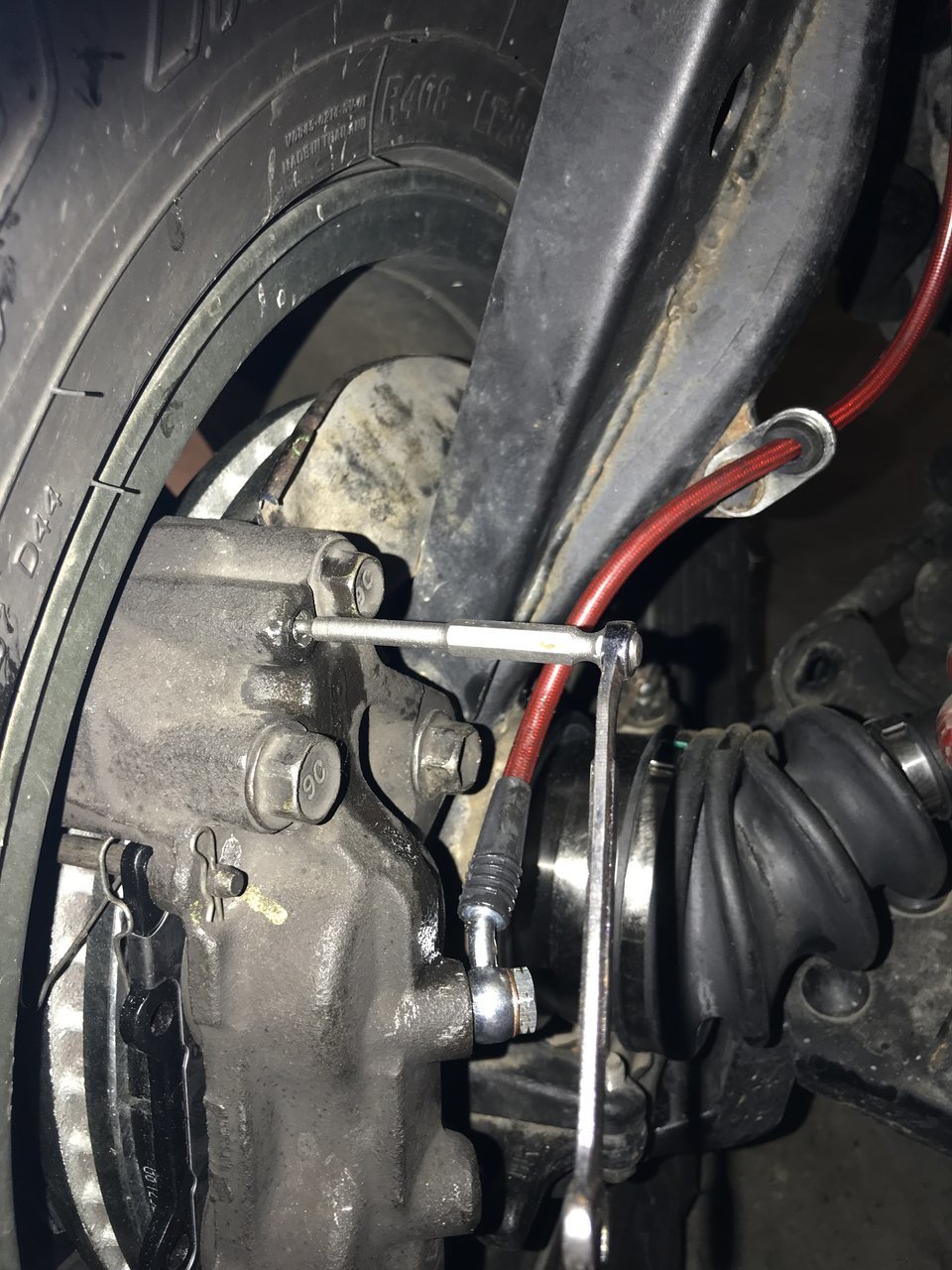

    Was bleeding my brakes and snapped the nipple :/
    Incase anyone else had this issue here is a simple way to get the rest of it out. Just beat a torx that’s a little bigger then the hole and unscrew it. Here are some pics.

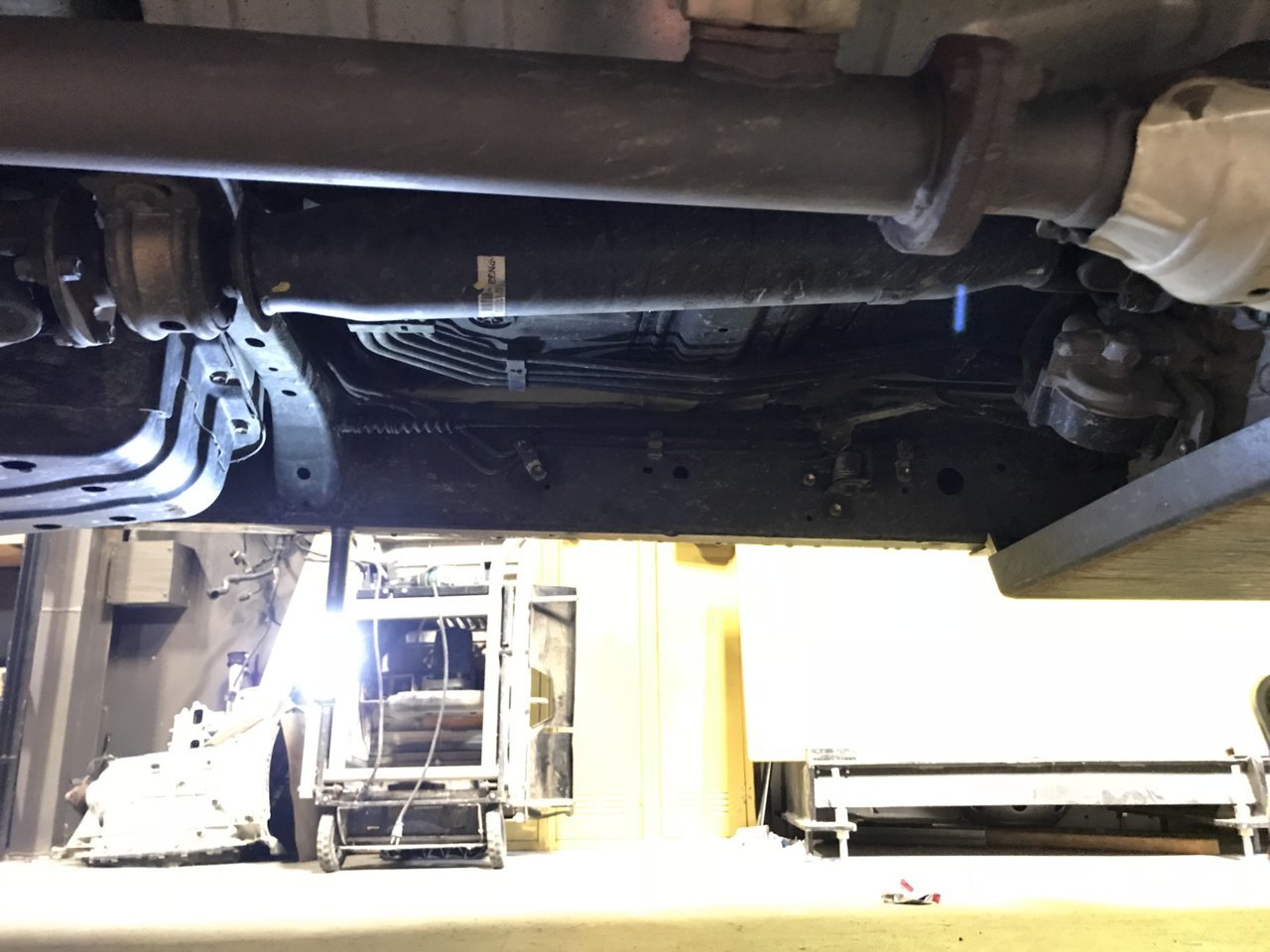

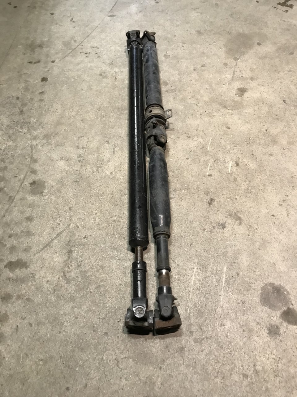

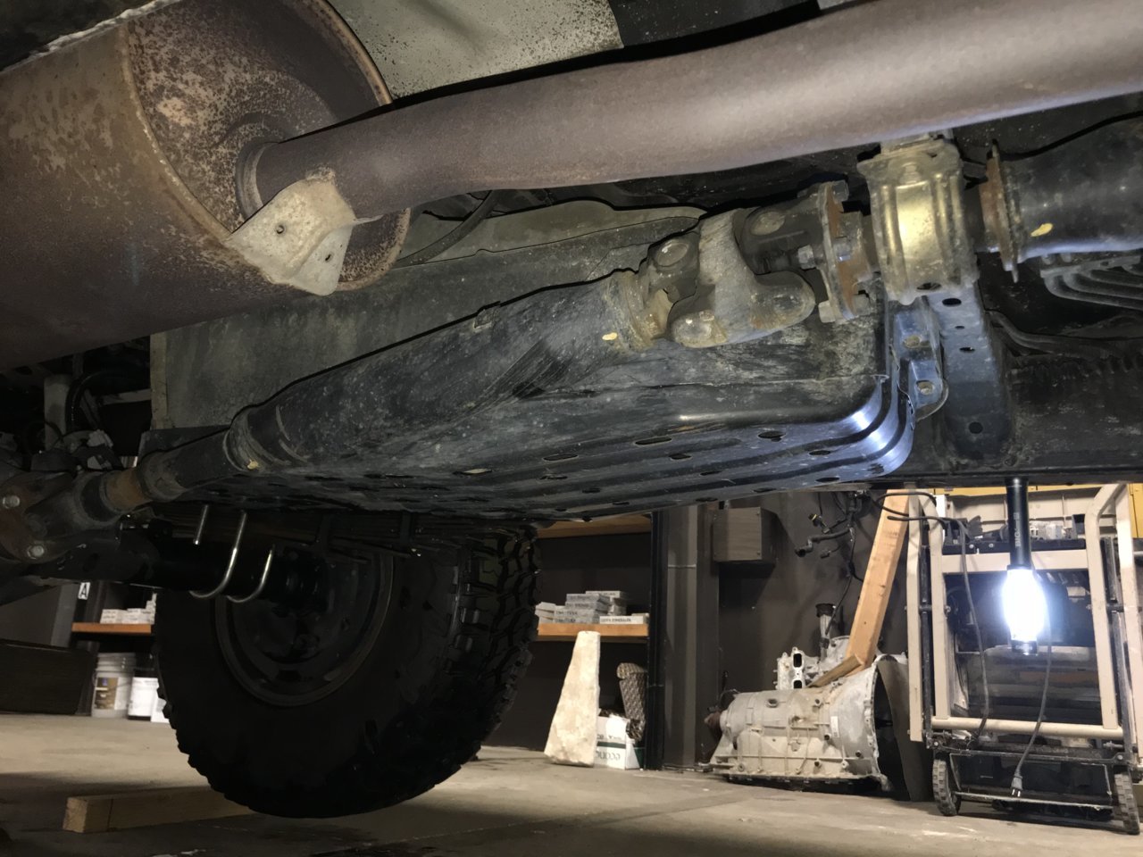

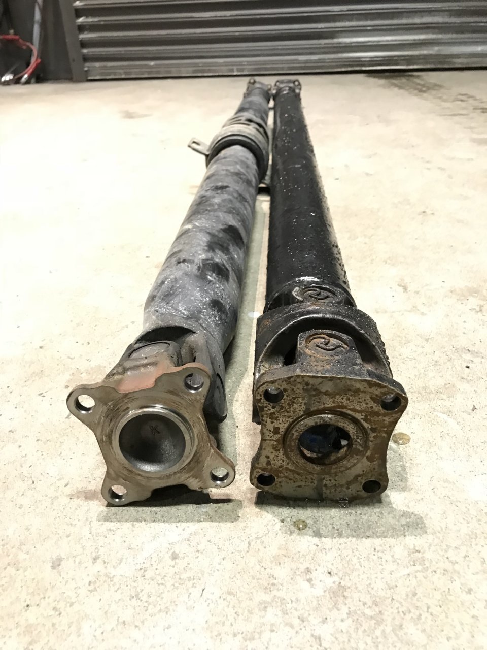

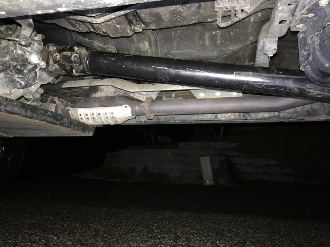

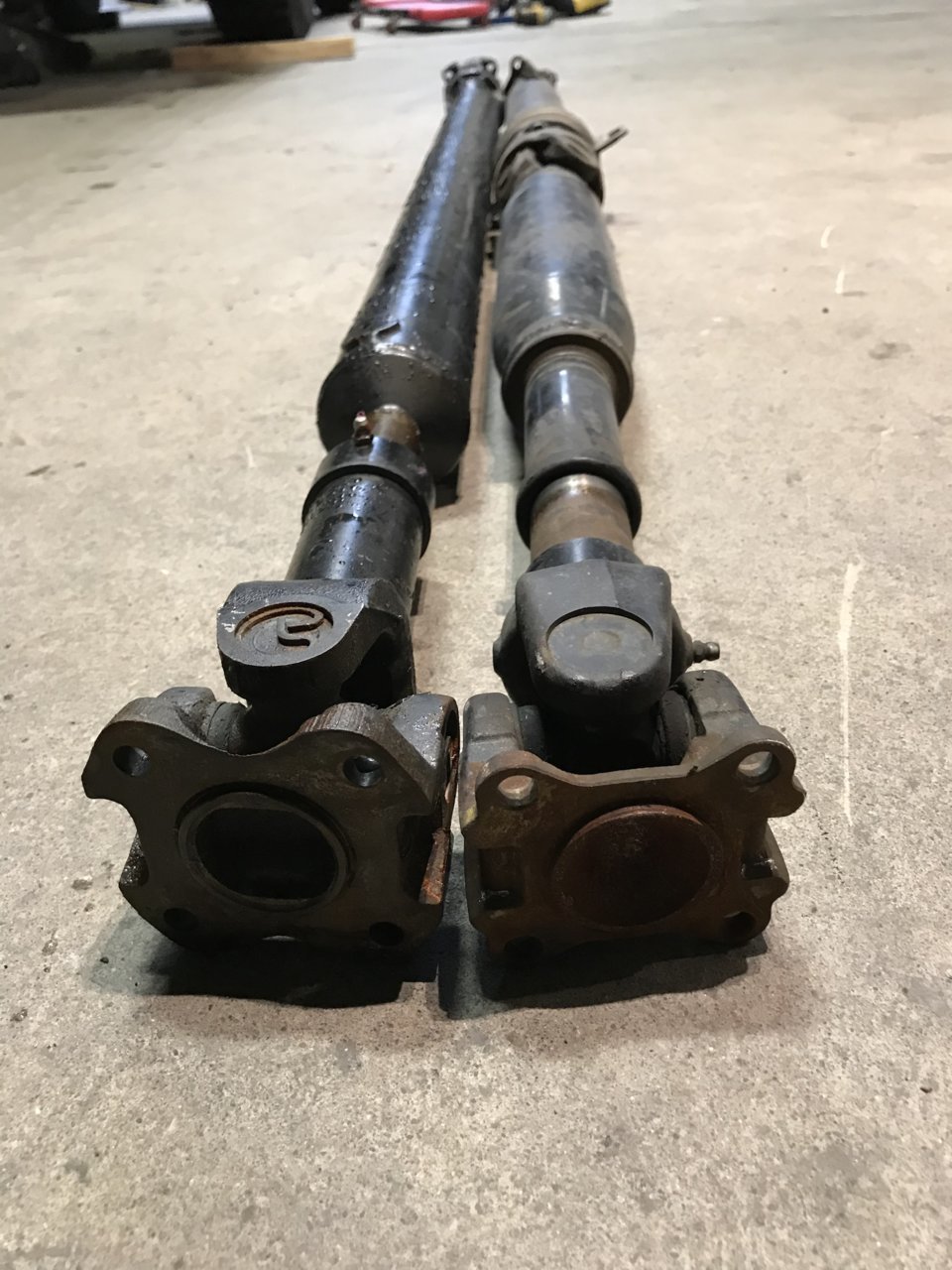

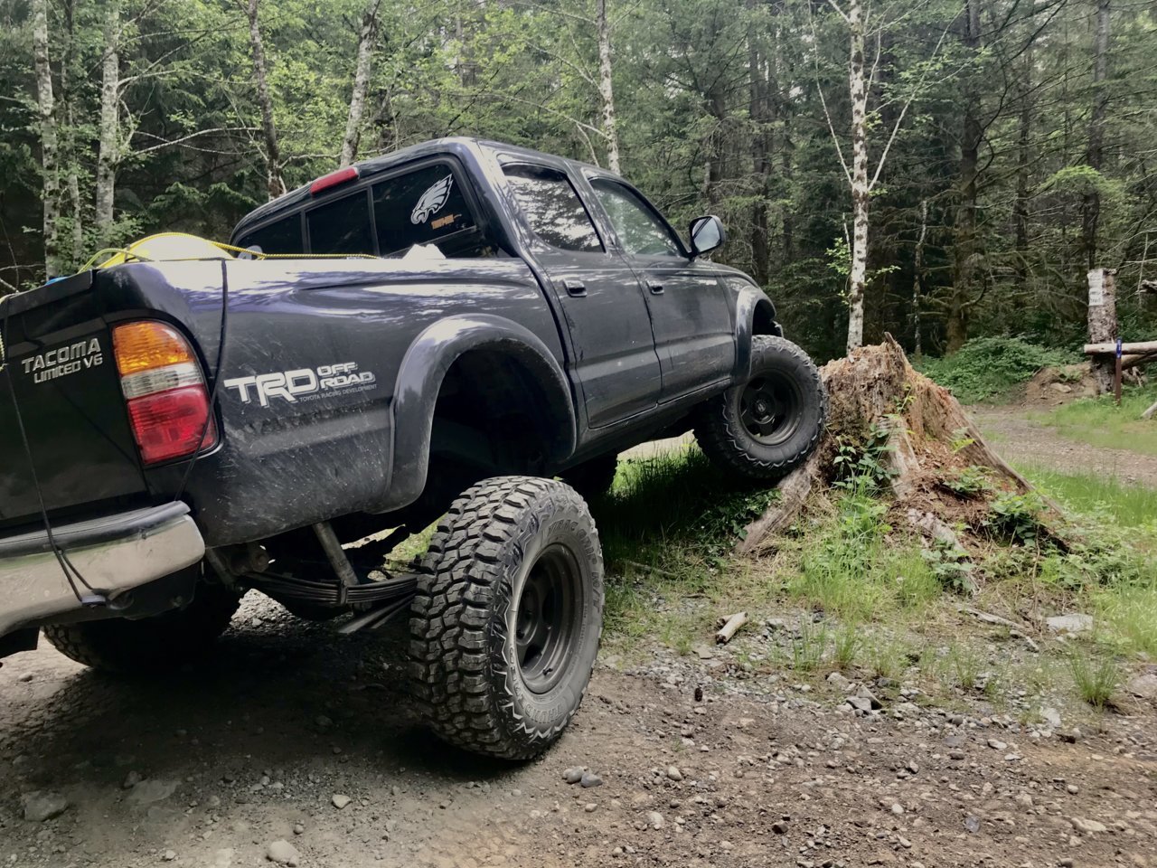

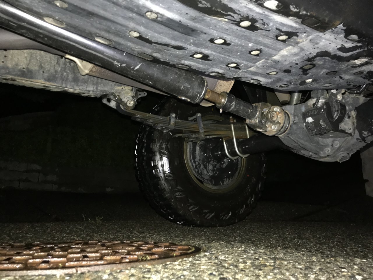

    Been working on my truck but keep forgetting to add to my build thread. Here is what I did today:
    I call this mod “clearance loss” lol
    Swapped stock drive shaft to a single. Took only 30 minutes to do. Seems to drive better.
    Still getting axle warp but not as bad as before. I’ll probably end up making a traction bar for it later.

    Aug 12, 2016
    #194389
    4,024
    Morgan
    Modesto, CA
    2019 Raptard 2001 TJ
    Dirt
    Nice shaft man:wink:
    I want to do a 1 piece on my 05, where’d you have that one made
    Trucks looking good
    Apr 17, 2017
    #216527
    1,362
    Alex
    Toyota Tacoma TRD
    I actually picked it up from a guy locally. But I was trying to have a shop make me one and they refused. Said to just order it online :notsure:
    I guess they didn’t want my business lol

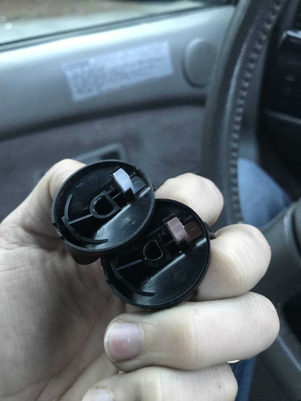

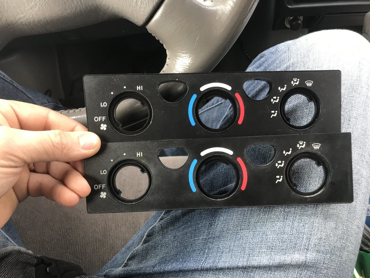

    Toyota Tacoma TRD

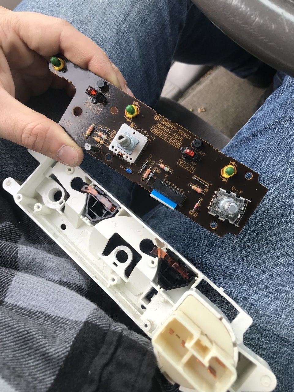

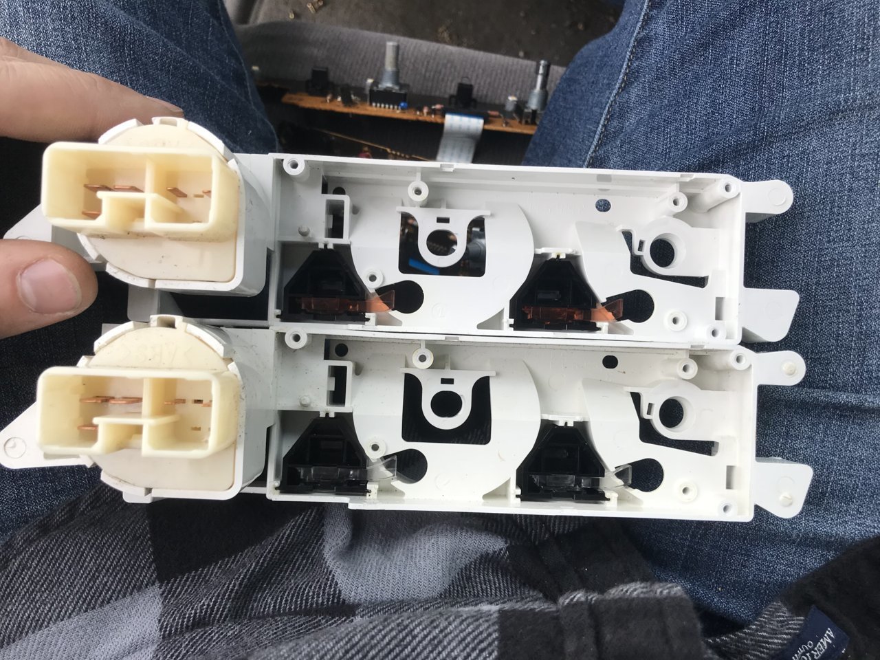

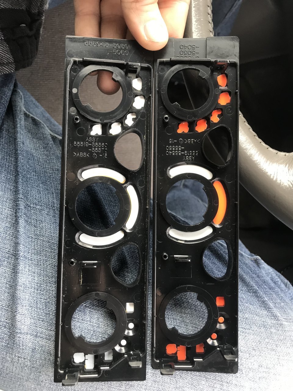

    Another update:

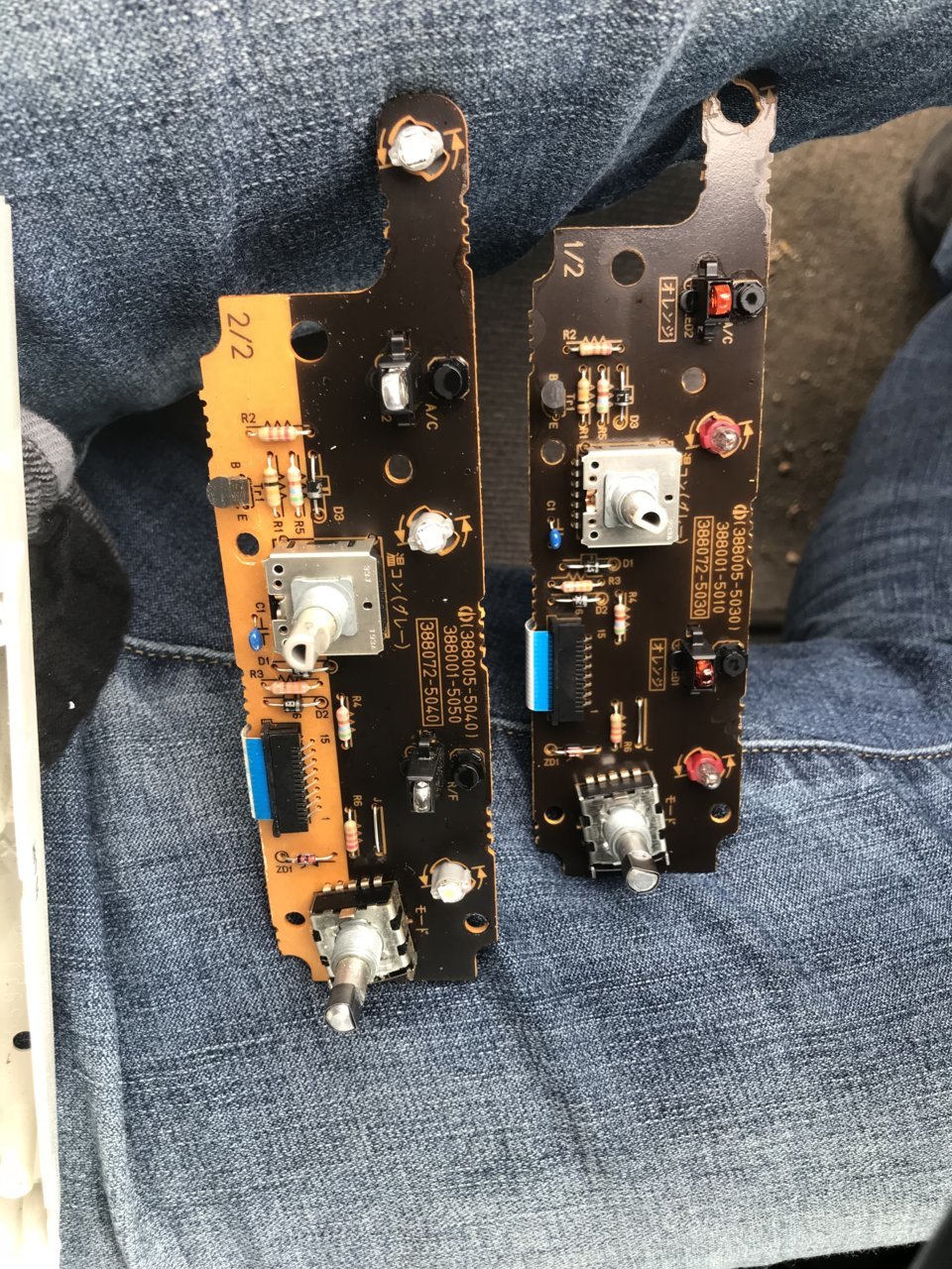

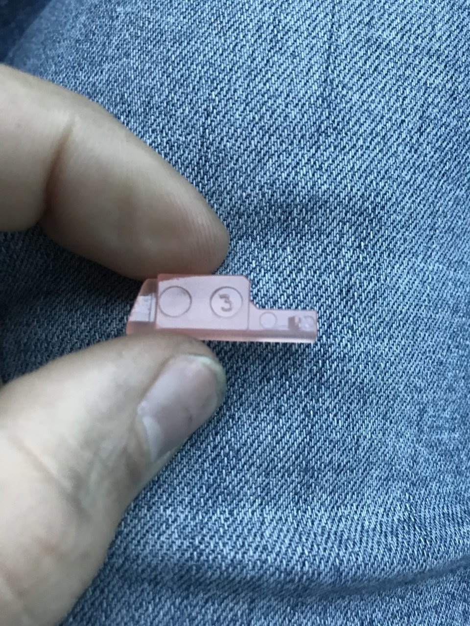

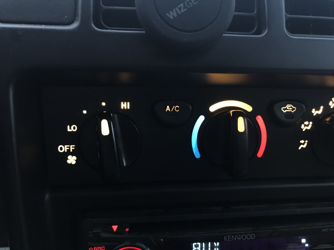

    My heater control was having a bad connection so I picked one up to replace mine. Here is a link to what was happening:
    https://youtu.be/1MbMC1E9CKU
    I think the one I picked up was actually from a 4runner. The reason is the face plate is not orange like my tacoma one is. So when I installed the new LED’s I didn’t have to worry about finding a new face plate with a white backing. Here are some pictures of the swap. Only thing now is I’m looking for 2 more knobs with white filler to complete my swap.

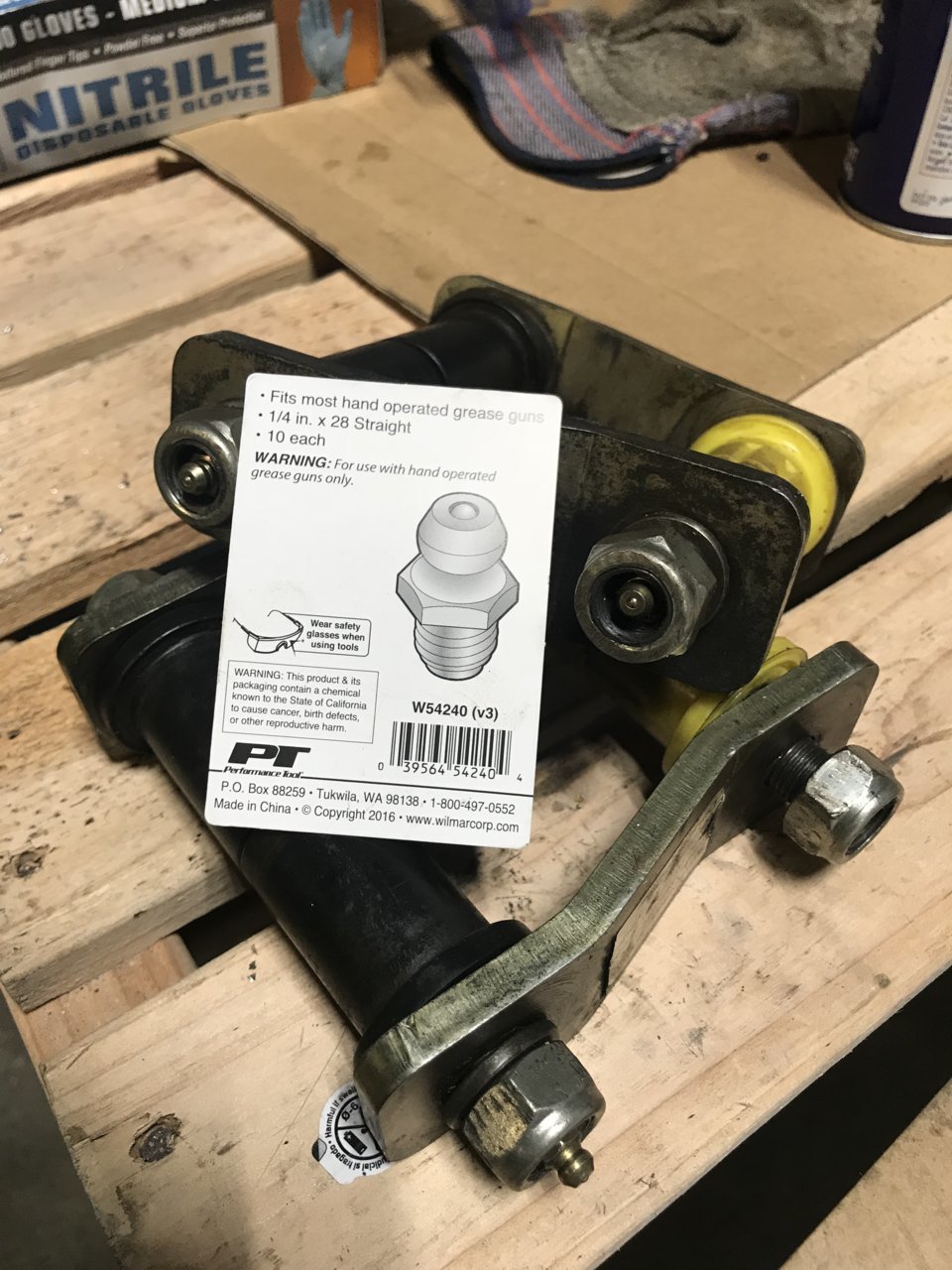

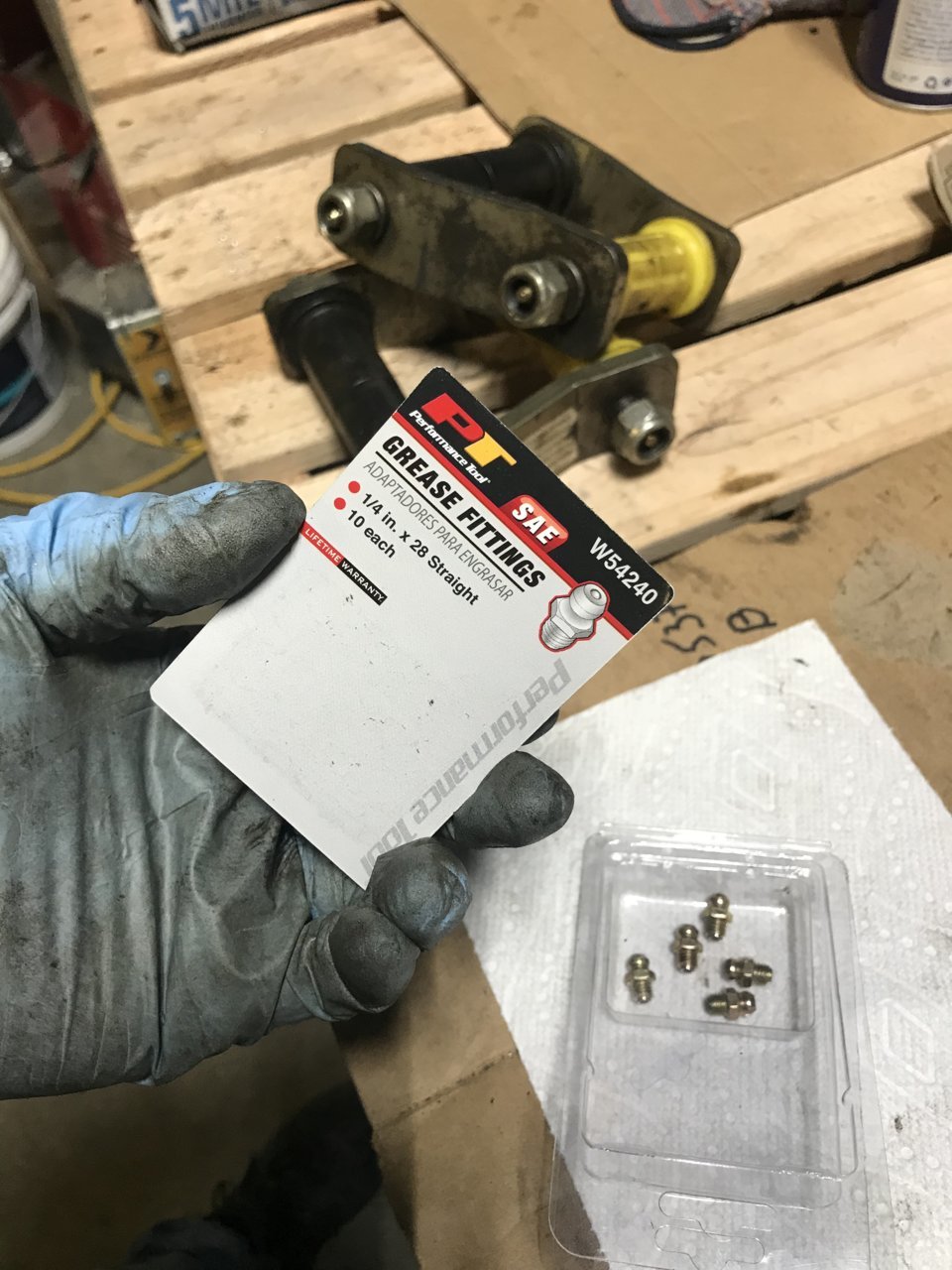

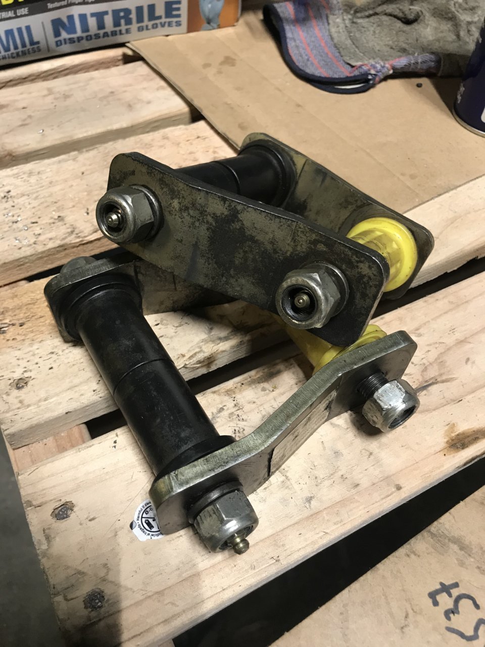

    Installed new zerk fitting on my OME greasable shackles. And just in case anyone needs specs for size and thread pitch here it is:
    And now to find time to install them on the truck.

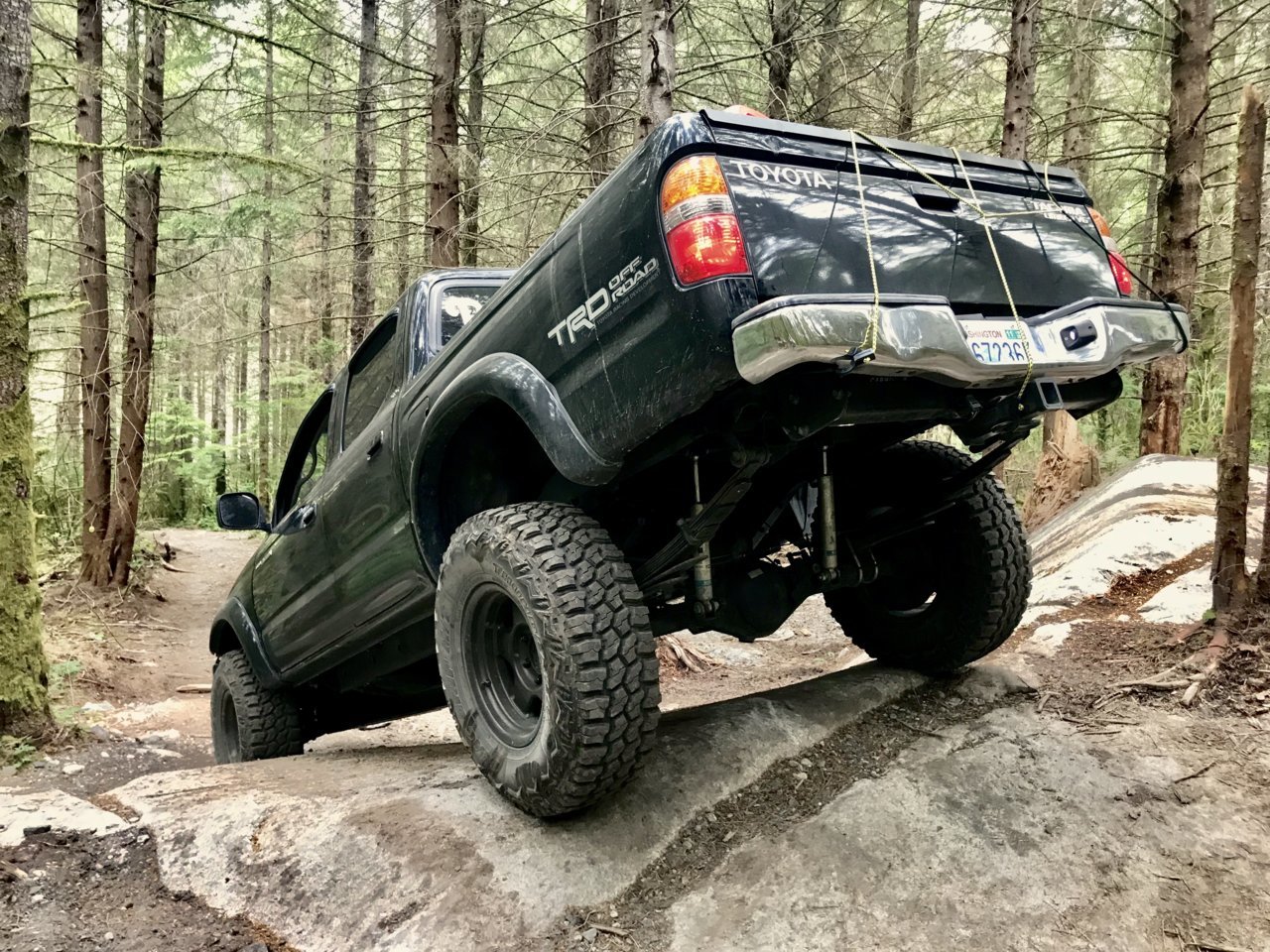

    It’s been a while I think now is a good time for an update:
    Haven’t worked much on the truck but did visit a few places. Here are some pics, enjoy.
