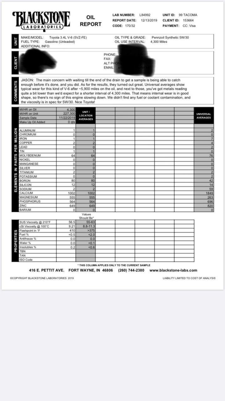

    Recently sent off a oil sample for my truck to Blackstone-labs. I’ve swapped to a full synthetic and only had about 4,300 miles since the latest oil change but fig what the hay.
    I was pleased to hear the results! Looks like very little wear is going on currently so I’ll stick to 5k mile oil changes from here on out.

    is your current mileage 153664?
    how much does that report cost

    No, at the time of testing it had 227k and change. It's $28 and if you want a TBN done its $10 extra. That's where they test to see how much additive is left in your oil in case you want to go longer in between changes. The mileage is listed in the test as "Mi/hr on unit"

    Almost all blackstone reports on synthetic usually tell the owner to man up and push further with intervals haha. This one doesn't really report that, but its nice to know you're in good shape.
