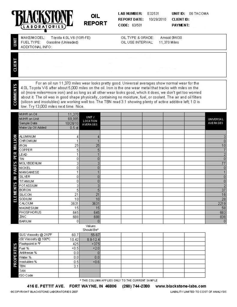

    I purchased my truck new with 278 miles on it. 1st oil change was with dino at 500, then again at 1500, then 3000 then switched to Amsoil 0W30. From there oil changes have been between 15k and 25k with filters at 7500. I say between 15k and 25k because I work out of country alot and change it when I'm home...or not. This report was done after my last oil change at 70,000 miles. I had 11,370 miles on the oil. The virgin TBN of Amsoil 0W30 is advertised as 13.2 and mine still had 3.2. Blackstone recommended the next change to go for 13,000. Amsoil states 35,000 under normal service and 17,500 for severe (city driving/lots of idling, etc.). So I'm thinking 13k - 15k is about all you can safely get out of Amsoil 0w30. My higher mileage changes came after lots of highway driving but now that it's driven mainly city and idles alot in traffic, I'm going to go towards the lower spectrum and the next test will be at 83k. Airfilter is a TRD cai and gets cleaned every 3 months. Anyways here's the results with nothing bad to report. Just thought I'd pass it along.

    Awesome info thanks! Good to know since I just put severe gear in my diffs and transfer case:D

    Good to know. That's what i've been planning to use on my truck. I figured i'd change it around every 10k or once a year, whichever comes first.

    Thanks for sharing! Great info and very interesting.

    I run the Severe Gear in all my vehicles, two being high horse power applications. Haven't had any gear whine or issues. Then again, didn't have any with the stock stuff either. Love their stuff.
