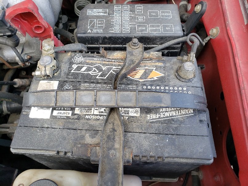

    Put a little water with baking soda on the terminal’s.

    Can someone show me a photo of what this should look like? I do better with visuals. (the battery not the baking soda)

    They make some stuff in a can that works even better. Have to disconnect both terminals and give them a good cleaning too.

    get some baking soda, vinegar and water. Mix it all together and use a toothbrush if you have nothing else, to give those terminals a good soak/clean

    Agree with the responses already.
    - Clean connections
    - Even though battery tested ok, it could still be weak under heavy load like starting.
    - Starter likely not the cause, but I suppose it could be.

    Might want to do a visual inspection of the wire running from the battery to the starter. It could have rubbed somewhere and is starting to produce a short.

    Found a receipt for a battery from the papers the previous owner gave me. Says the current battery is from 2013?? That seems long, but I don't see any other battery receipts so it probably is that one.

    You should be able to find a date on the battery somewhere to confirm that.
