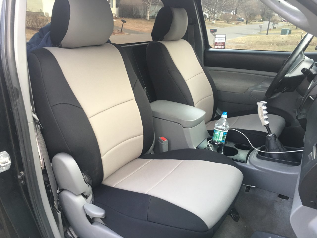

    Got my Coverking neoprene seatcovers on today. They look tan in the pictures but I assure you they are gray. Excellent fit!

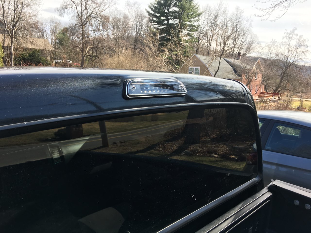

    This isn’t the top secret project but I did get a new third brake light to put on

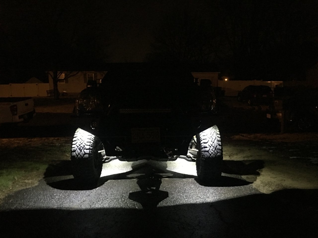

    Top secret project is done :spy:
    Thank you @pwalnut for your excellent write up and recommendations. :cheers:

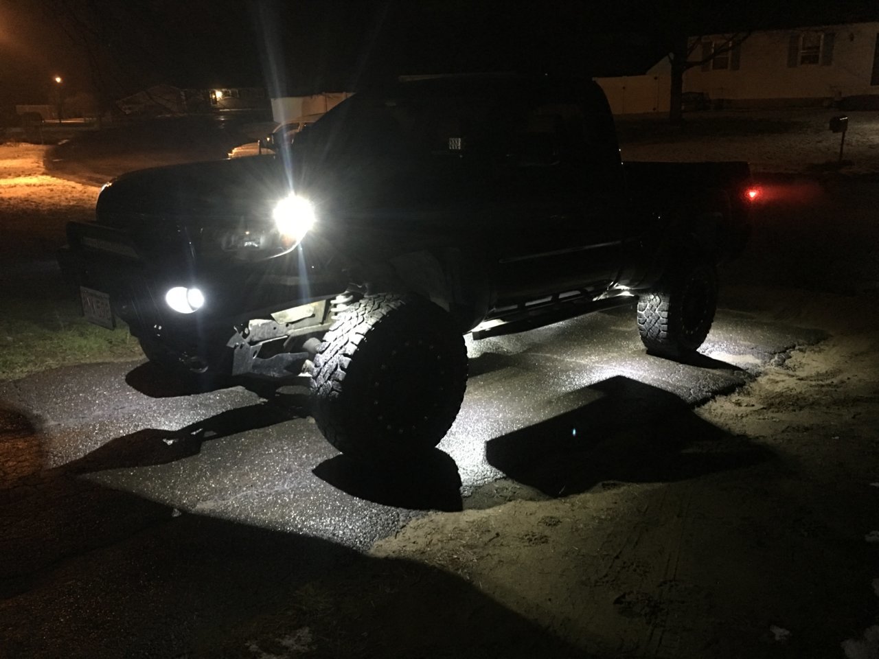

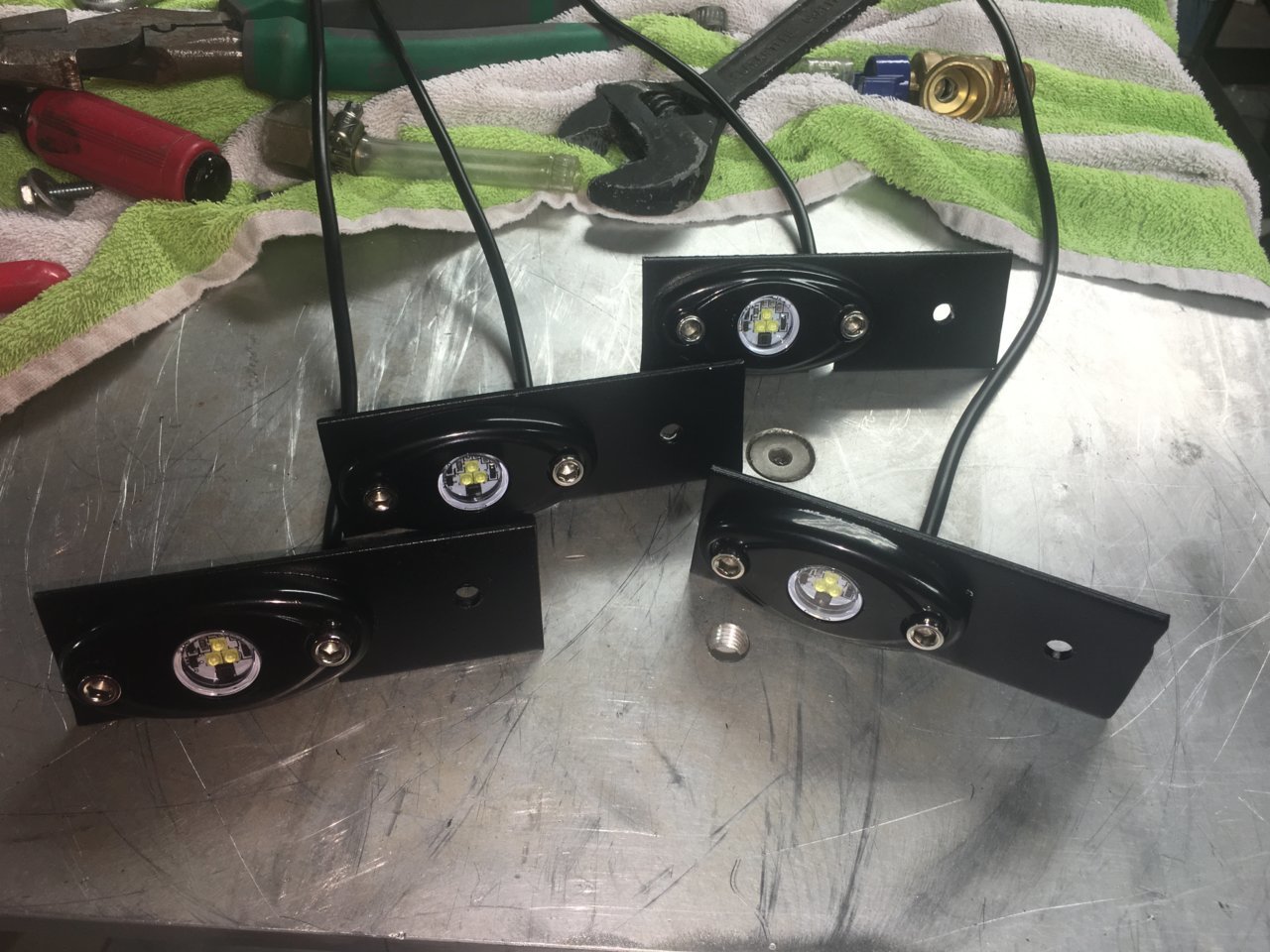

    Added rock lights last weekend!!

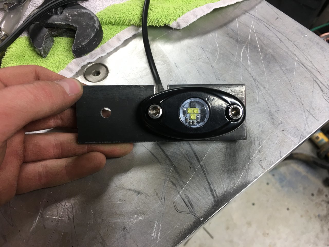

    There's 8 9watt pods total. Made my own mounts for the rear ones, just made of 1.5" flat stock steel, used the drill press and dremel, and a little primer, paint, and clearcoat.

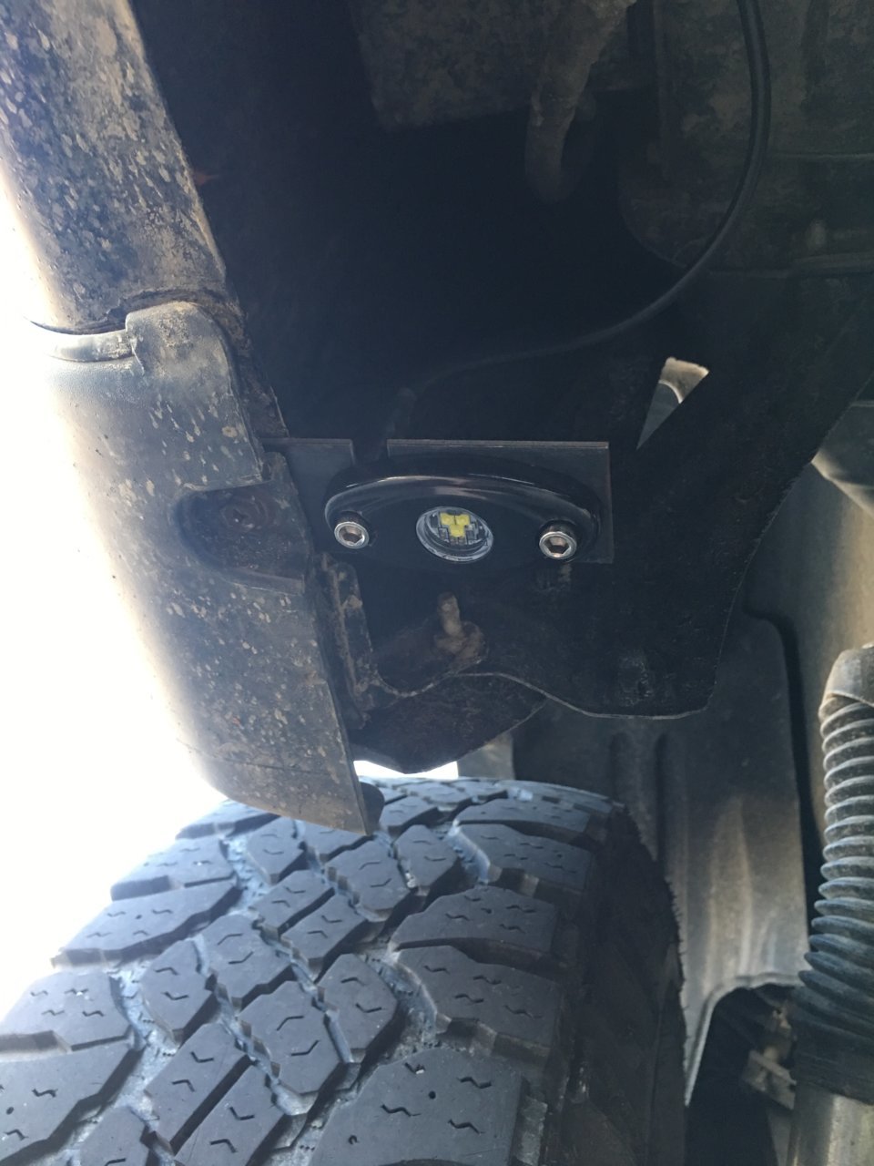

    I removed the screw that holds on the fender flare on each side, and used stainless bolts washers and lock nuts to hold these on. The front ones are screwed flush to the truck with stainless self drilling screws, wires go through the body under the headlight up front, and wires go through and out of the body using existing holes under the cab using a mechanical finger. Basically put 2 wiring harnesses together to make one for the 8 lights and each light has a 2 pin waterproof connector. All connections are heat-shrunk and taped. Wiring goes to my blue sea fuse block and an Oznium scion style amber lit switch.
    Here's the mount and test fitting
    after test fitting, I disassembled them, primed, painted and bolted the lights to the mounts with stainless hardware
    Mounted to the truck (again using stainless hardware) and wired up. little dirty from driving but here they are...
    and here they are lit up.

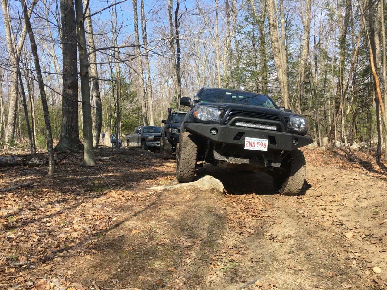

    Also, hit a few local trails with some guys from the Massachusetts Toyota Tacoma Enthusiasts Facebook page.

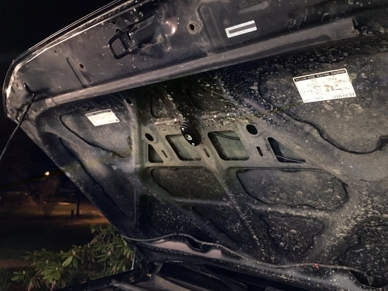

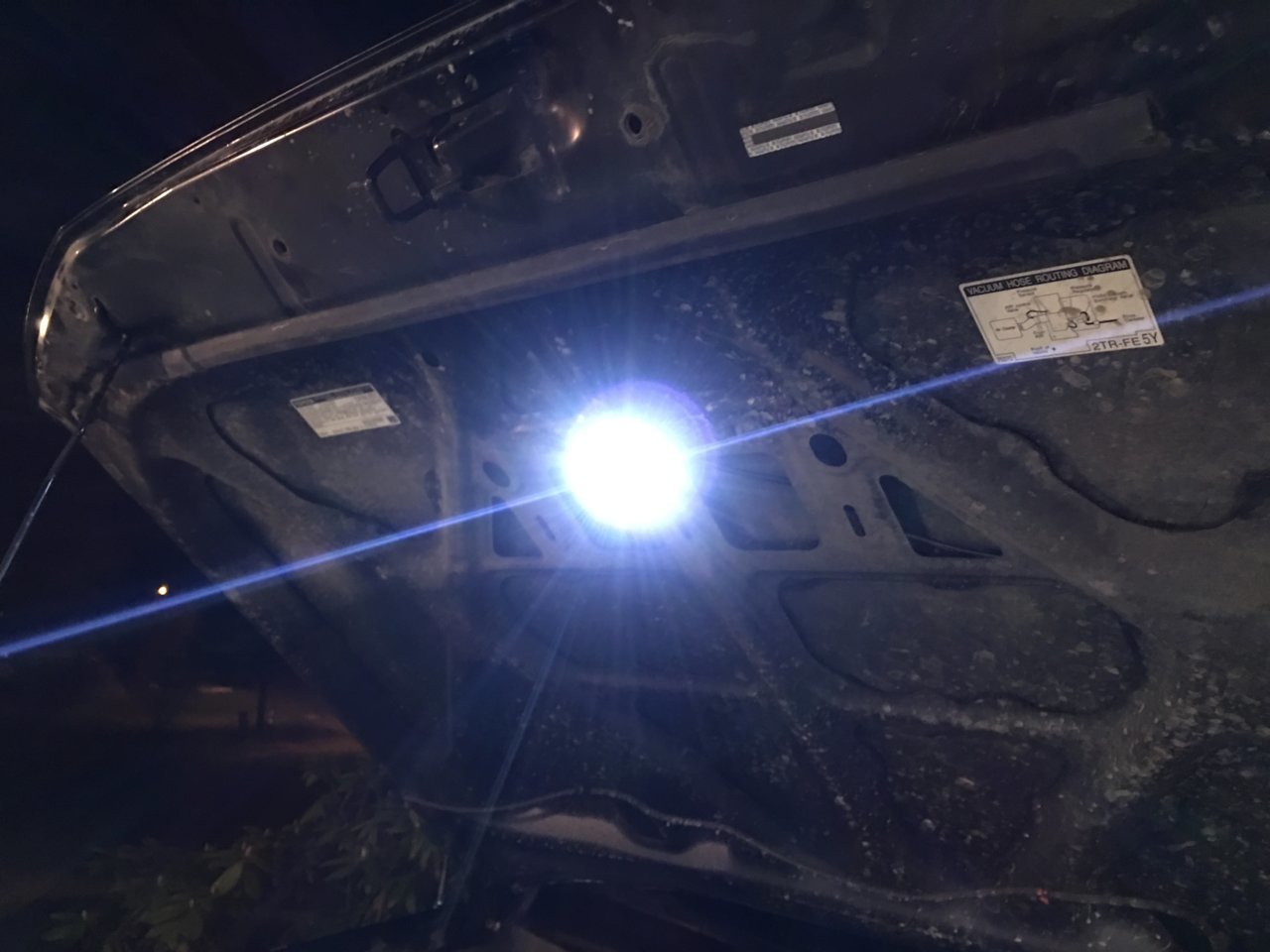

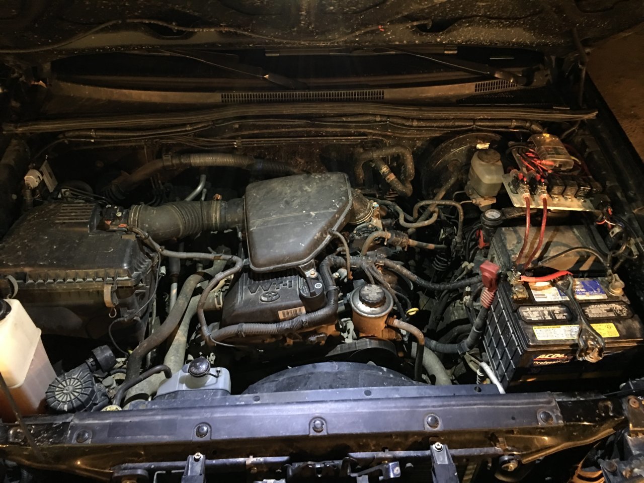

    Wired in a 9 watt led rock light under the hood with a pin switch.
    Don’t mind the extremely dirty engine bay
