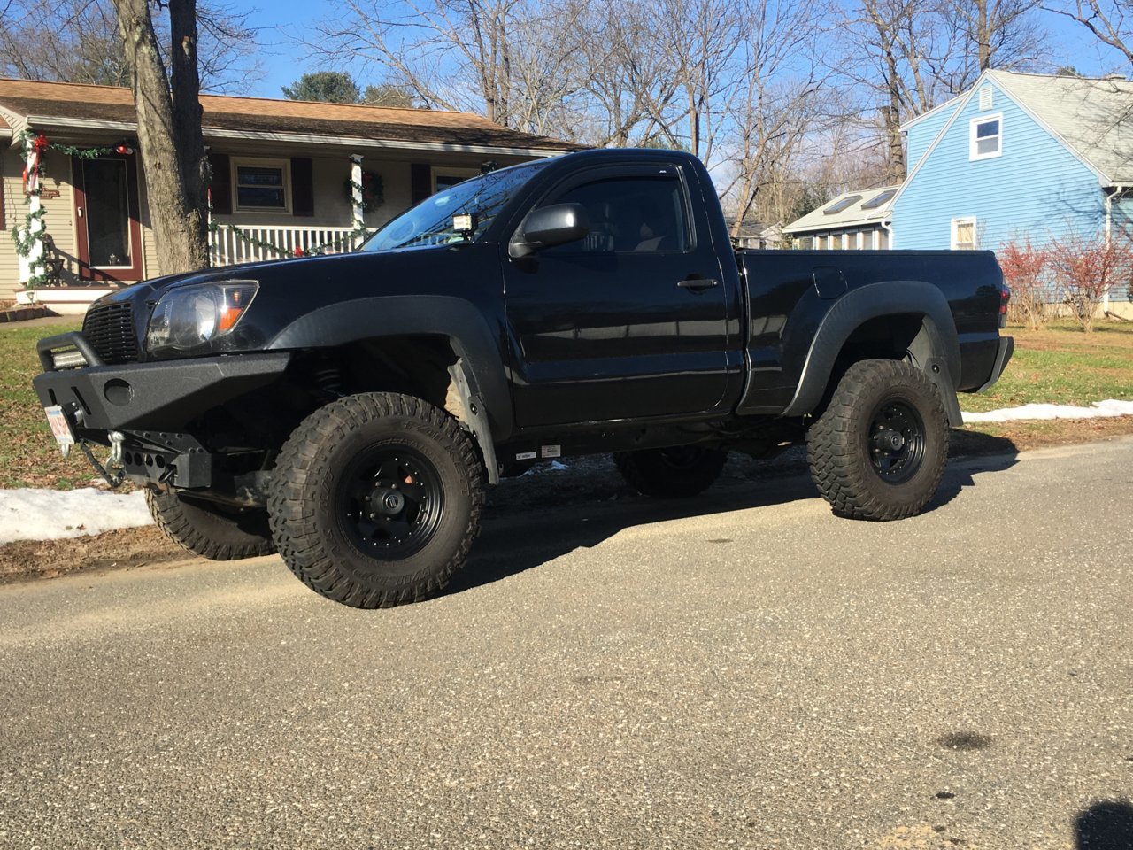

    New wheels and tires. American Racing AR23 16" wheels wrapped in 285/75/R16 Falken Wildpeak M/T tires

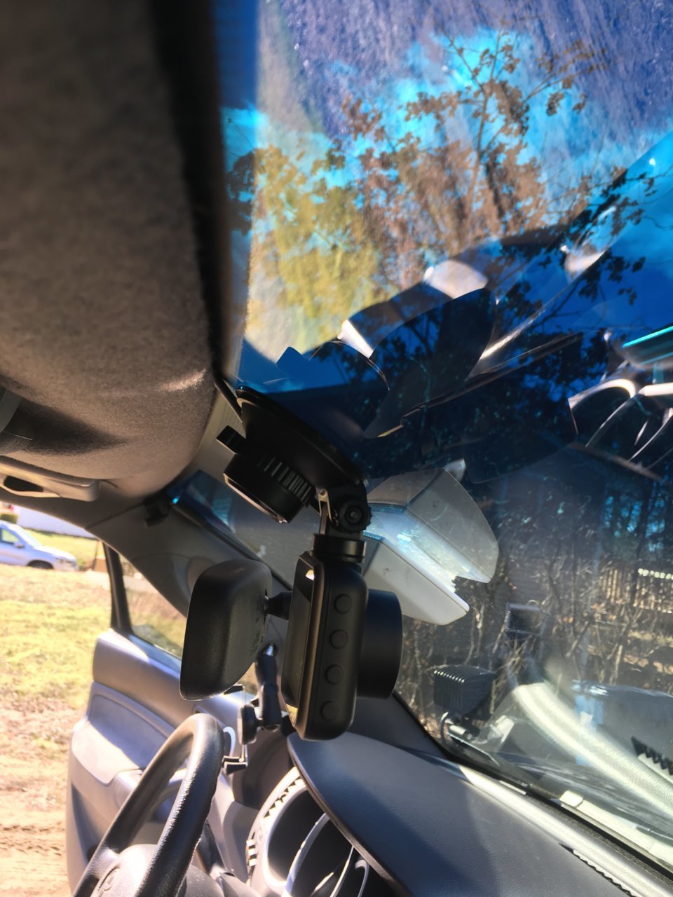

    Just mounted up my new dash cam! Just need to get an SD card for it. Ran the wires right under the headliner, down the pillar, and to the 12v outlet for now. In the future, I’m going to put a 12v outlet hidden under the dash for this so there will be no exposed wires. Thank you again @Texasdynaryder

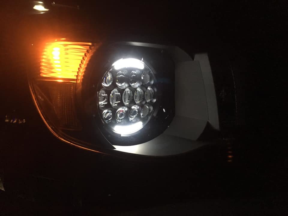

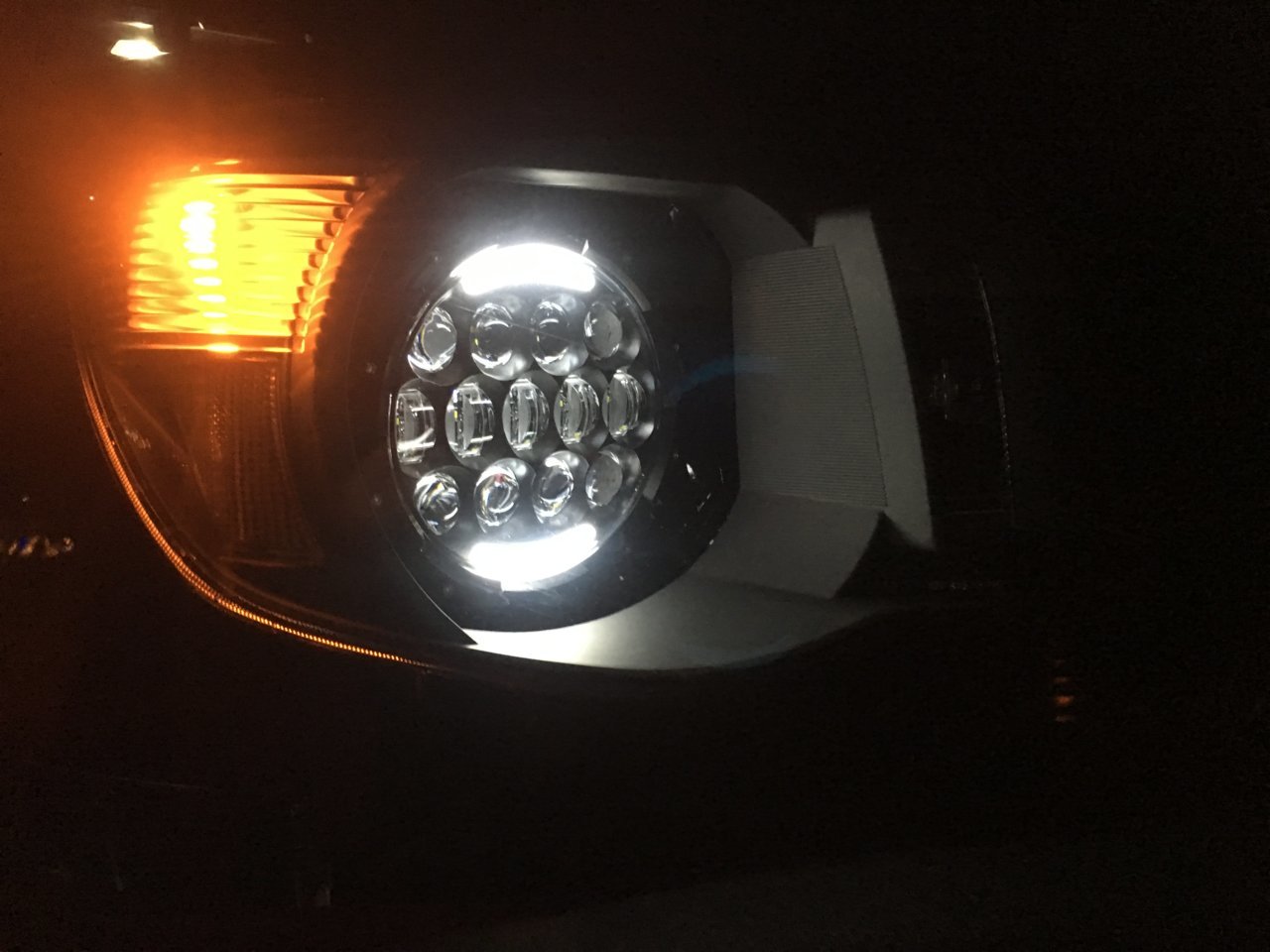

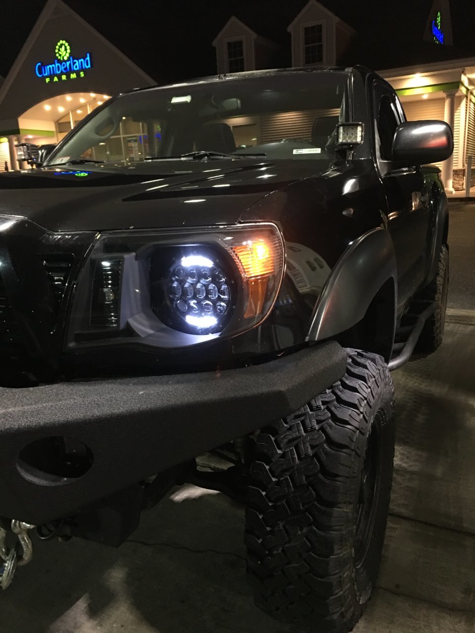

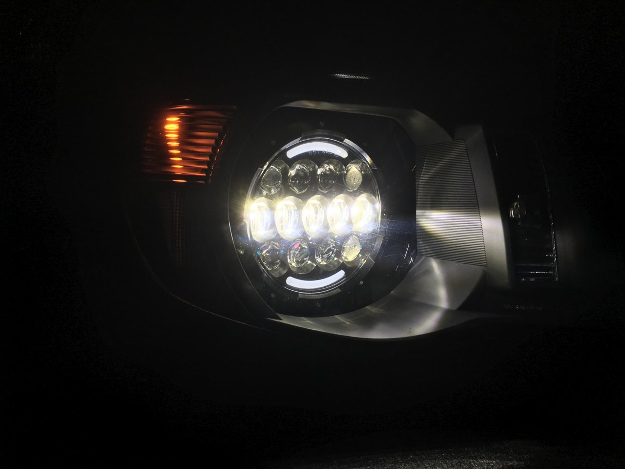

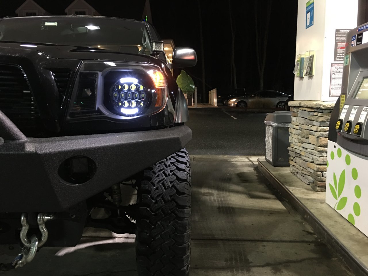

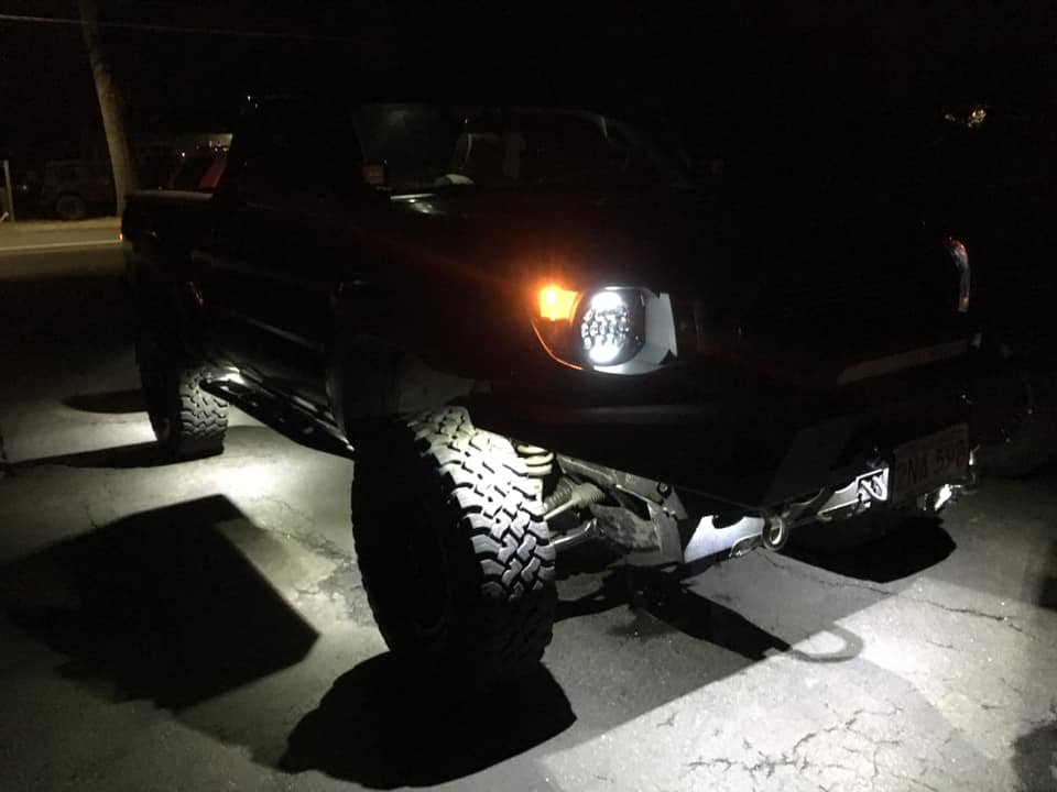

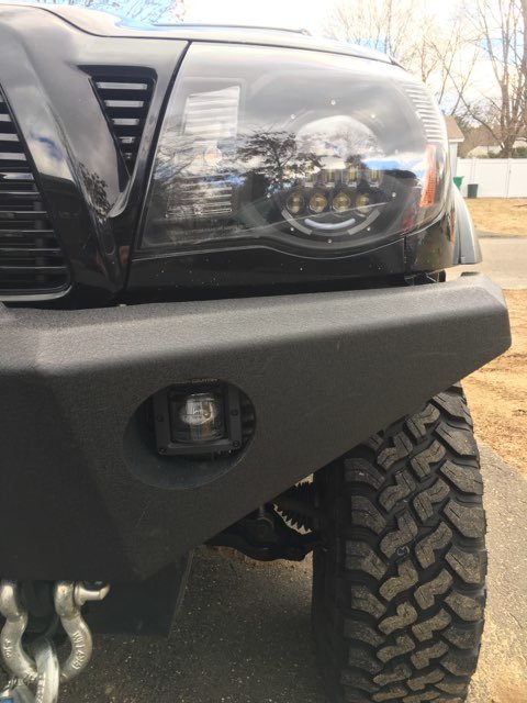

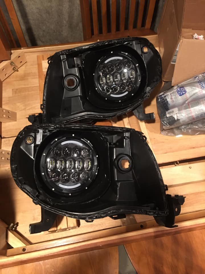

    Newest project. Jeep retrofits. @LivinLoud gave me a hand putting these together. Came out really cool I think.
    In this case... it was all about form over function. Cut off lines are excellent, however, in all honesty the light output itself is “meh” at best. Really just wanted something different than everyone else and I think I succeeded. If I need more light output I have fog lights, a light bar, and ditch lights so I’m not too worried.

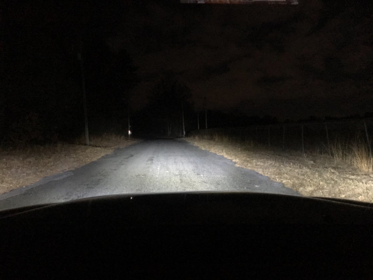

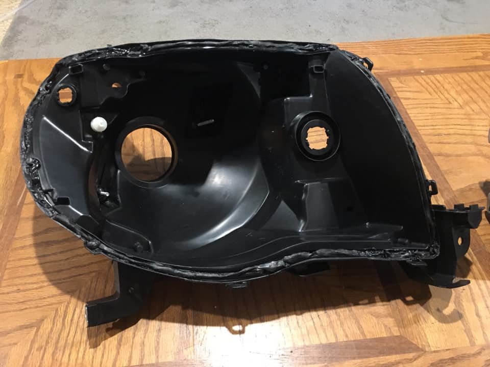

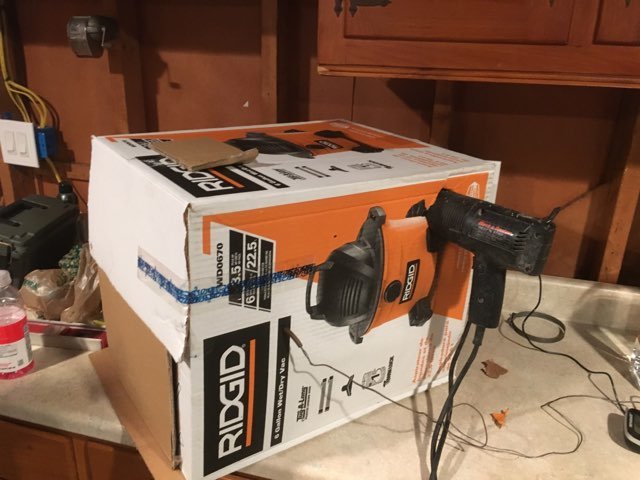

    Quick little write up on the headlights for anyone interested...
    maybe @LivinLoud can throw in some extra if he has any.
    This was my first time doing anything like this so dont judge. The goal was to make something different from everyone's regular projector retrofits. Ive only seen this done a few times. @5 Lug Fury @JezabelRed
    I will say a regular projector retrofit has better light output but for me, this was about form, not function. I have plenty of other lights if I need more. So here wen go...

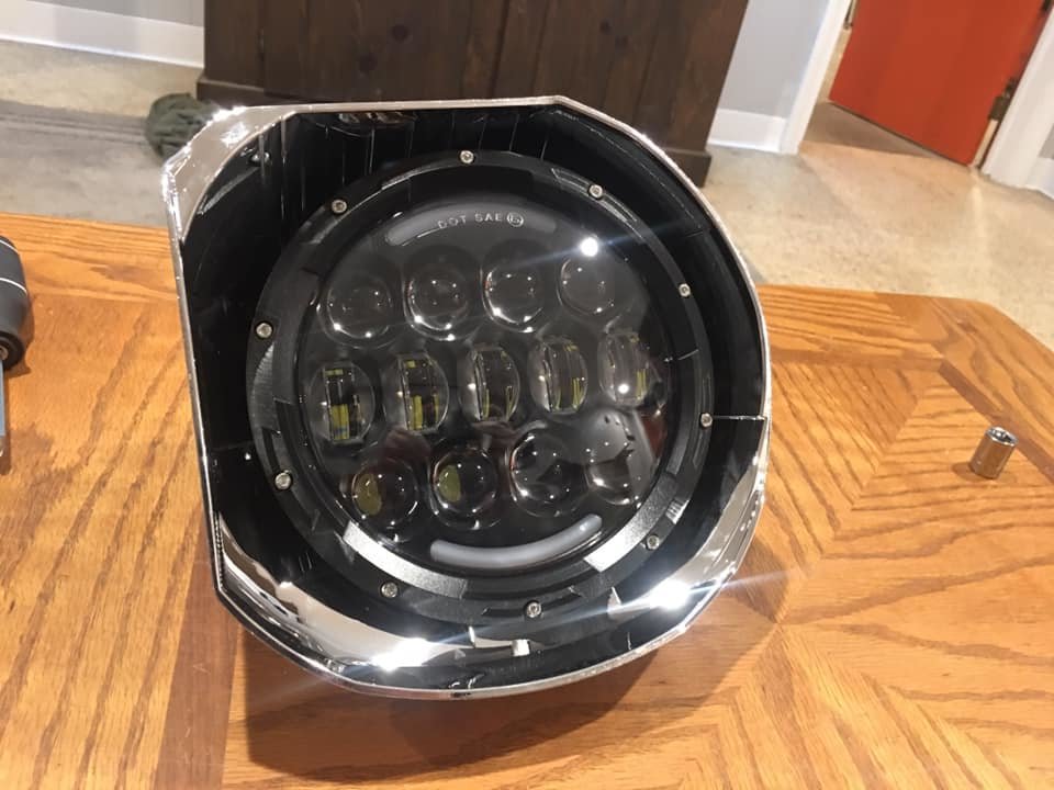

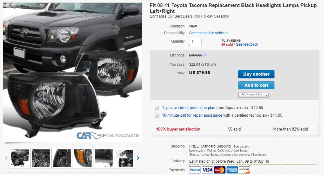

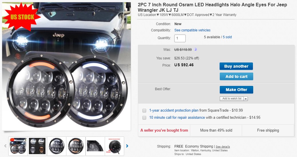

    First off, here's what I bought:

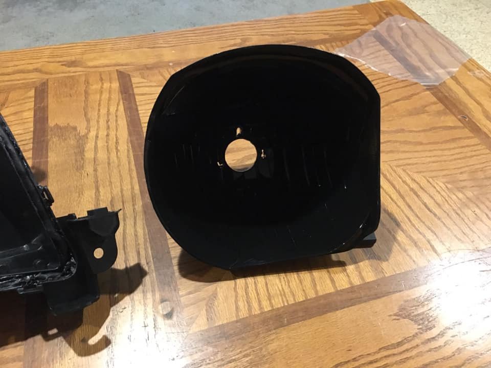

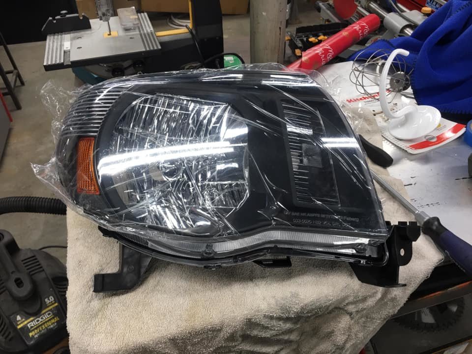

    Made a little redneck oven with a cardboard box and a heat gun:
    New housings:

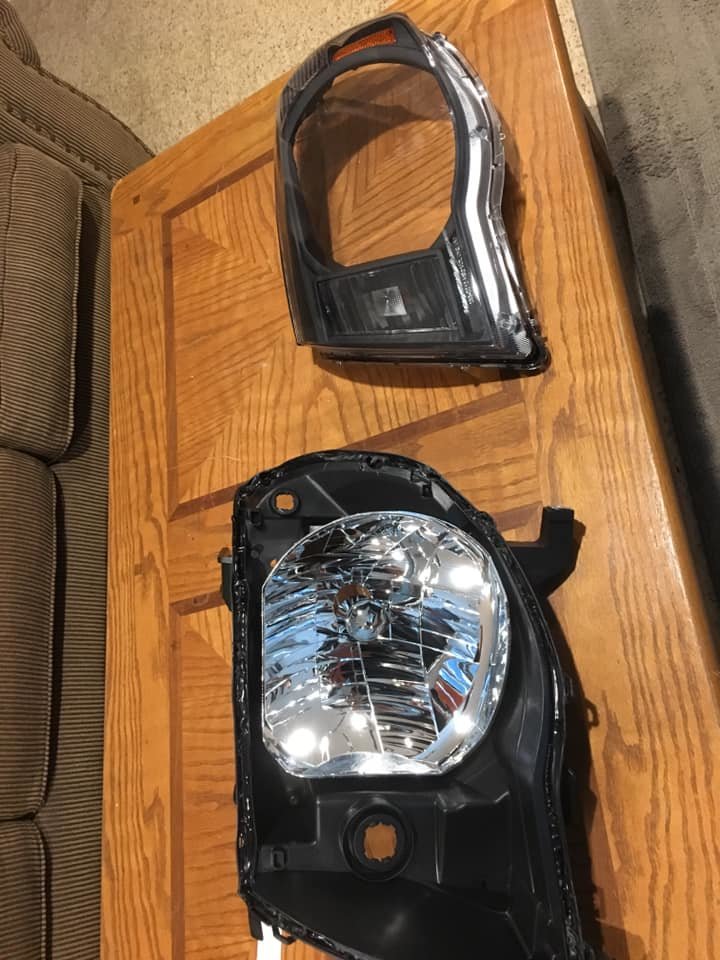

    I prepared the new housings by removing the film on them, and removing the 3 screws on each light. Put the heat gun on and popped em in the oven for like 10-15 minutes or so. took them out and pried them apart.

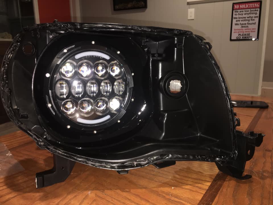

    I removed the reflector, and took our the shield. Here's test fit of the new light.

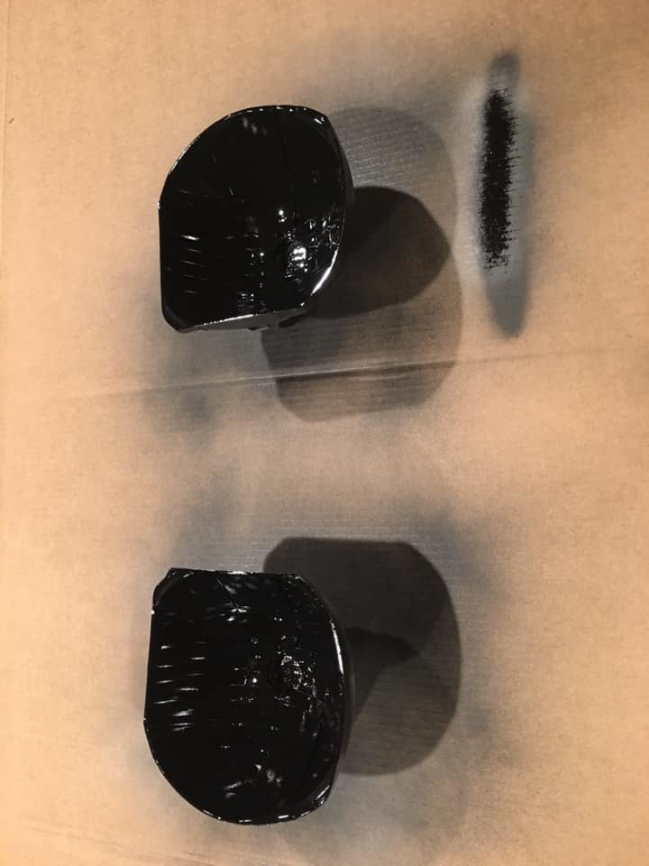

    Scuffed up, primed and painted the chrome reflector gloss black.
    popped the reflector back in...
    49013963_10218982103849990_1606584829770465280_n.jpg 49164594_10218982104450005_4836954939978678272_n.jpg
    test fit.

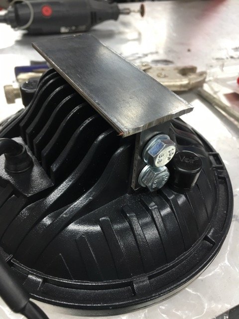

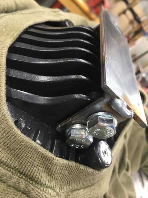

    Dont judge my fab skills here, I dont do this very often. but I made my own mounts out of some flat stock steel I had in the work shop. Cut off wheel on the dremal and angle grinder, drill press, vise, and small mig welder. about an hour or 2 later we had some mounts. IMG_7838.jpg IMG_7840.jpg
    No pictures of the finished mount but I drilled a hole in the center of the big plate and welded a nut to it. I then made some small plates out of the same steel with a hole in the middle for a bolt. here's the back view of the housing after mounting.
    and the front
    Now we placed the housing back in the oven for a few minutes and sealed the lens back on with 3M Windo-weld. It was late so no pictures before install.
    here they are installed.
    48967431_10218982101929942_763528619816386560_n.jpg 48986977_10218982102129947_1724142087571505152_n.jpg 49203192_10218982101689936_914625002353983488_n.jpg 49710280_10218982101329927_6751405688406147072_n.jpg

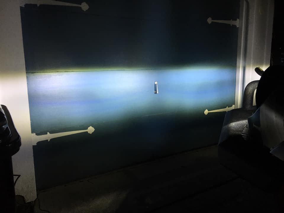

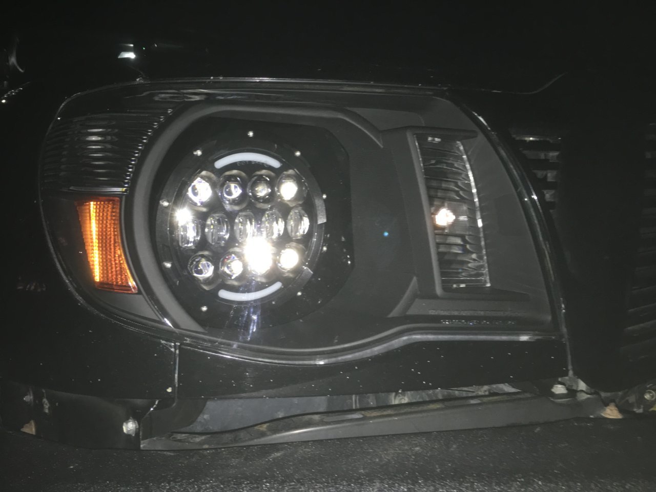

    Cut off lines on the garage:
    some lousy out put shots at night:
    low beam:
    high beam:

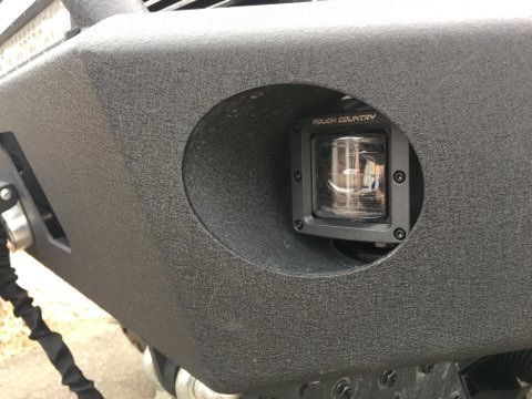

    Just added some DOT/SAE approved Rough Country LED fog lights yesterday!
