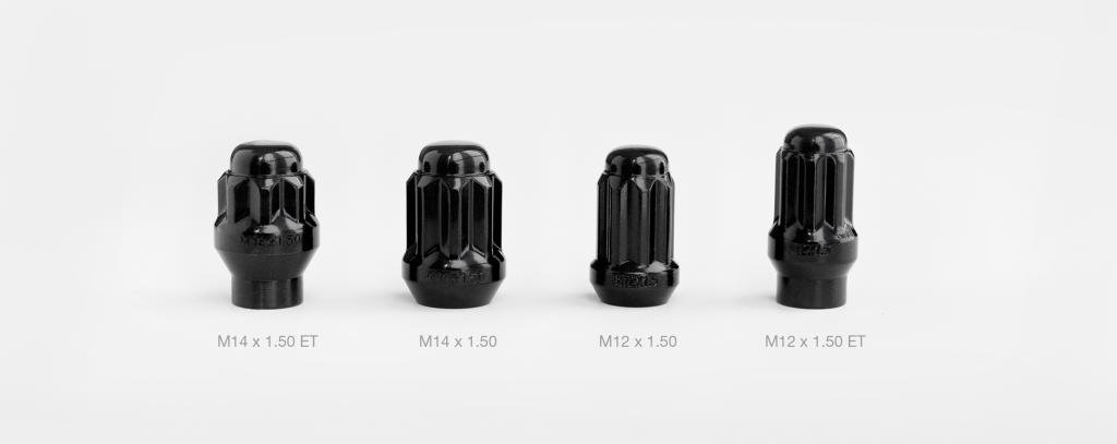

    ET=extended threads Still uses the acorn seat but has that .25" worth of extended threads to engage and not just a few turns
    Here is a comparison photo the ones on the rt are what our trucks are

    You need at least 7 full turns on the lug nuts as per all wheel manufacturers to not over stress the studs and torque properly. I have seen this a bunch on toyotas from not enough thread engagement.
