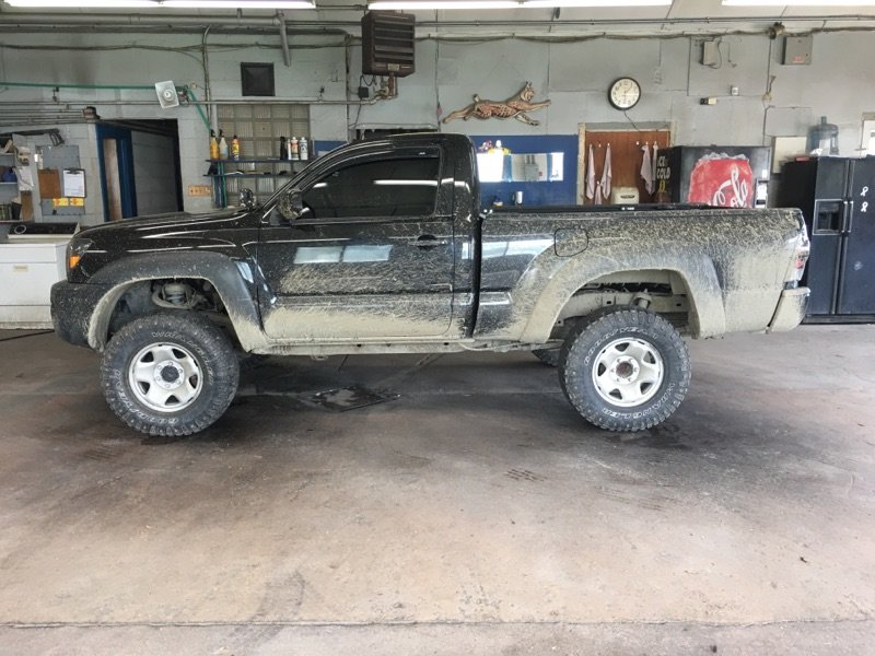

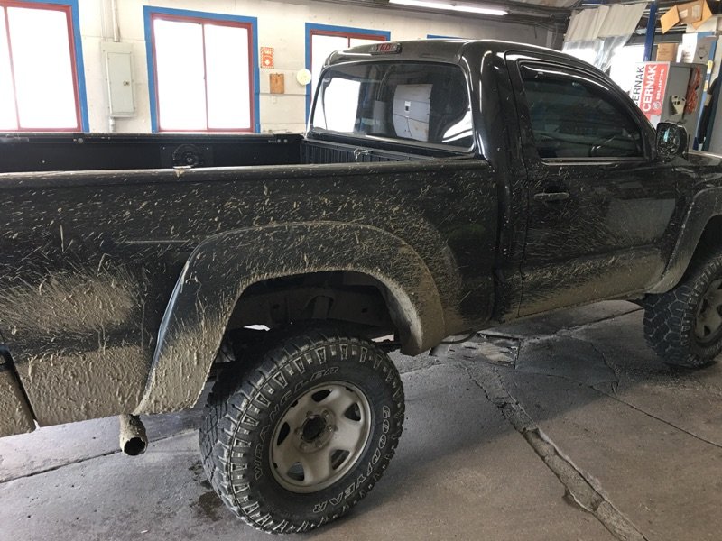

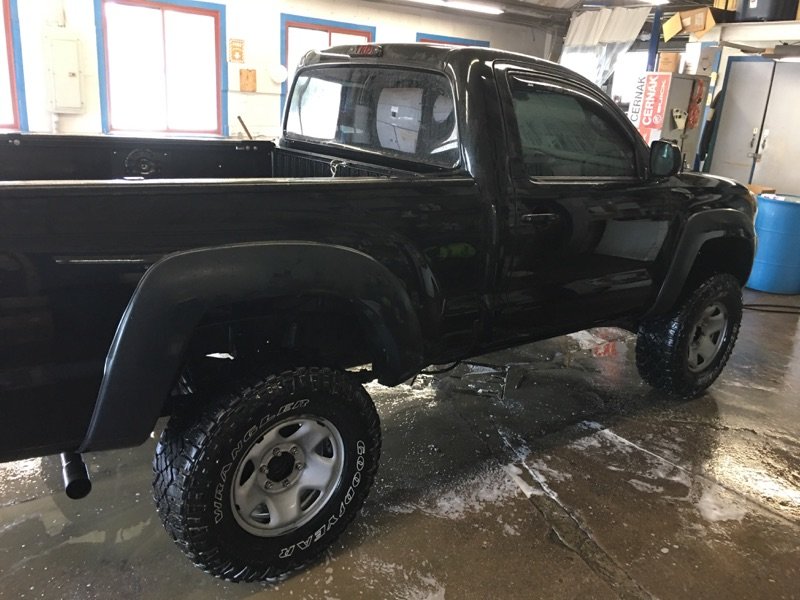

    Well the mud followed me home the other day.... not sure exactly how that managed to happen :spy:

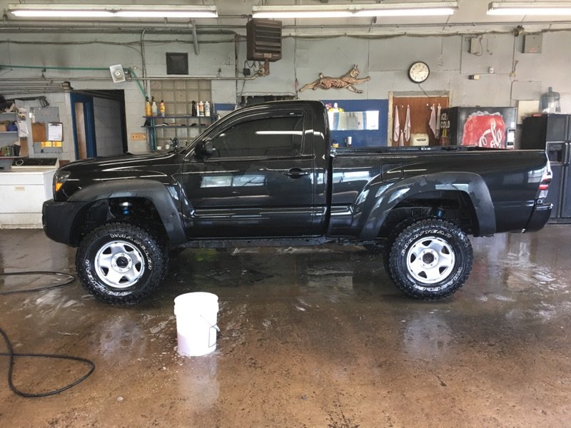

    Good thing no one wants to buy a car on a sunday! I made use of our detail bay at work!

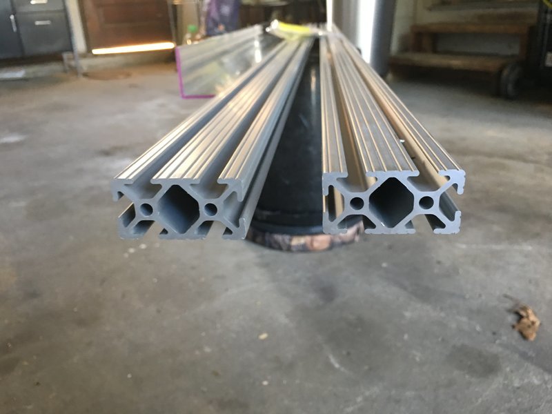

    Working on a new custom built project! Pretty excited for this one! Anyone have any guesses?

    Yes low profile all aluminum bed rack!I'm using t slotted framing so I can add accessories like tie down points anywhere. My main use for this rack will be for 2 kayaks.:woot:

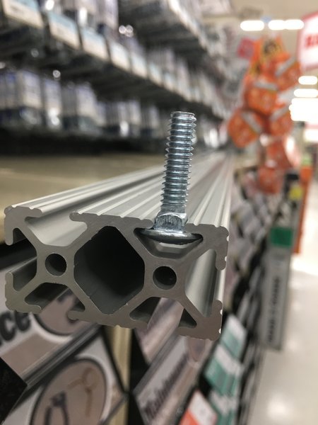

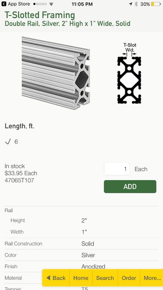

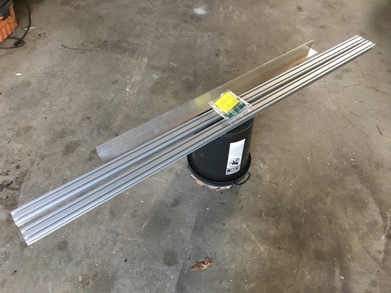

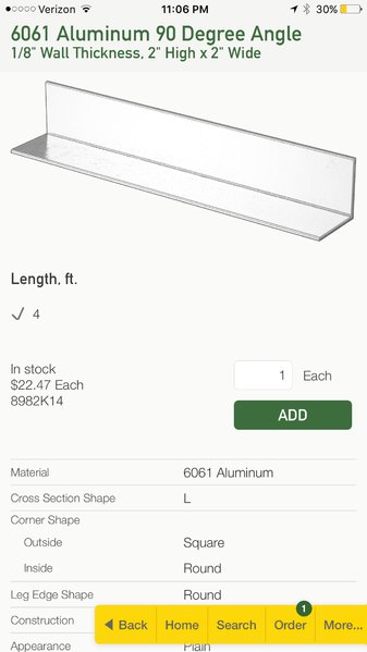

    IMG_0405.jpg Picked up some hardware today! Now to actually make the rack :transformer:

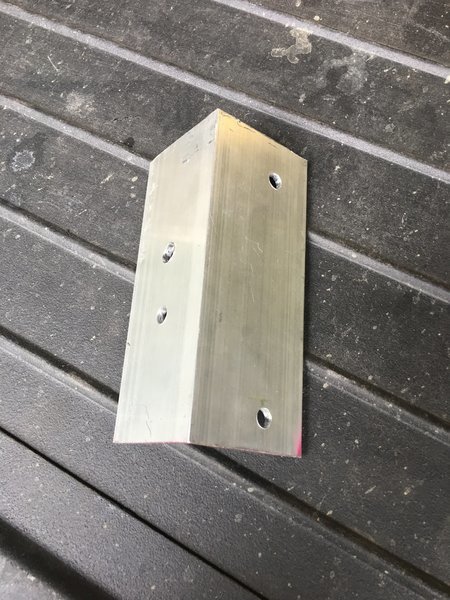

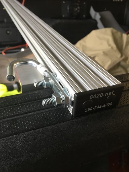

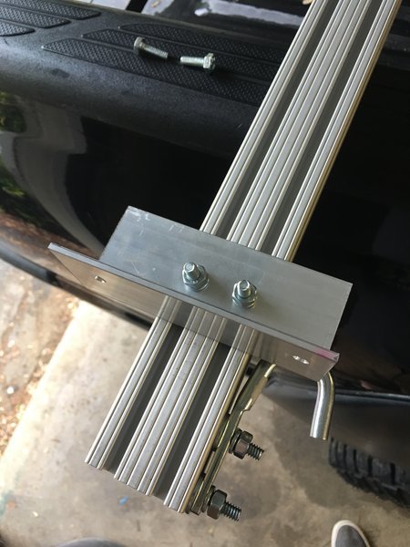

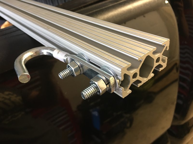

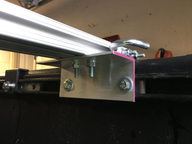

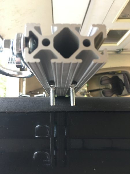

    Made 4 of these brackets with the 90 degree angled aluminum. Each are 5 inches long with 4 holes drilled in them.
    Added some j hooks for tie down points on the rails after cutting them to length.
    Inserted a couple carriage bolts and mounted the brackets.

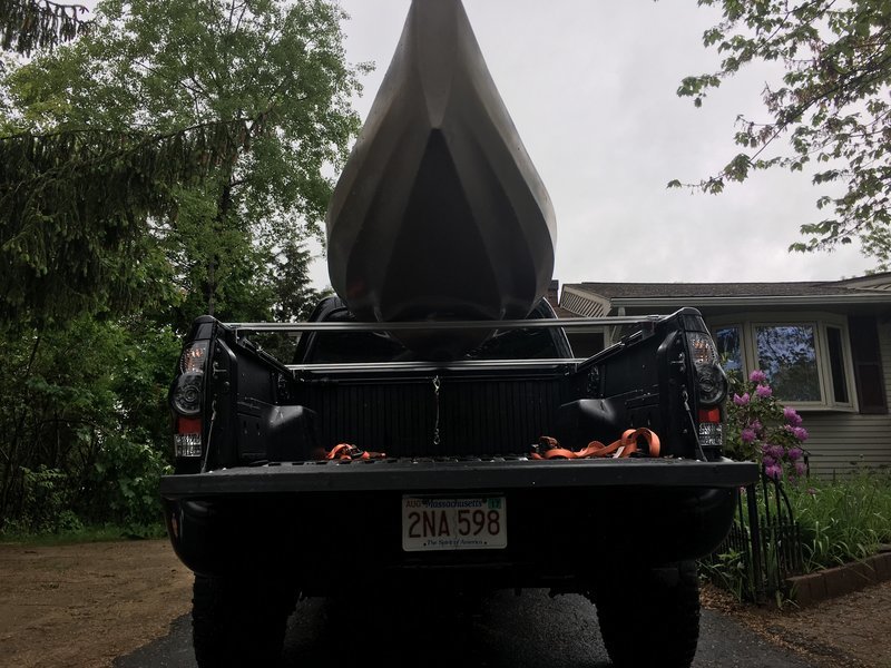

    Mounted to the trucks bed tracks.
    And finally added caps to the end of the framing rails.

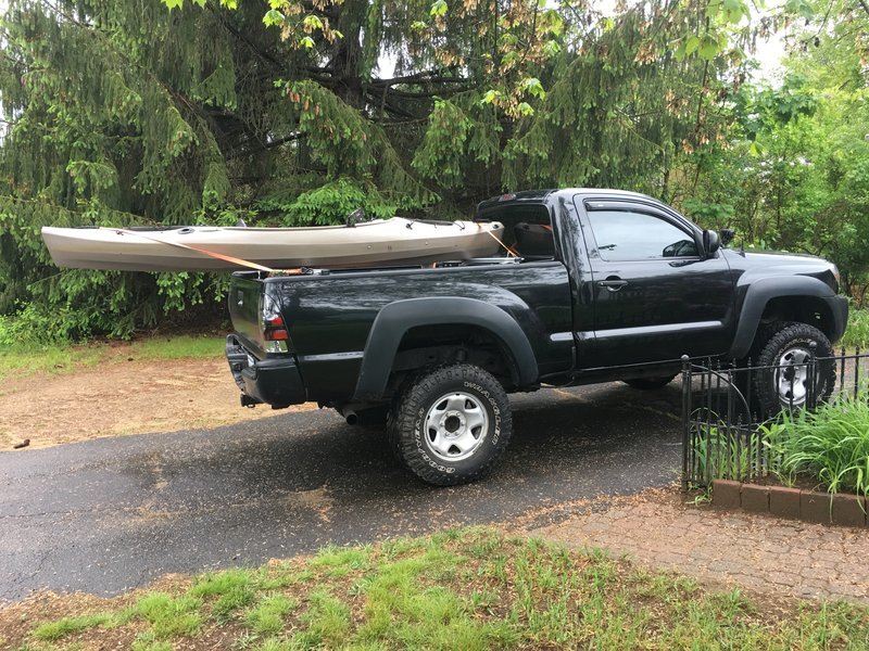

    I basically did that 4 times on all the ends of the rails and here's the finished product

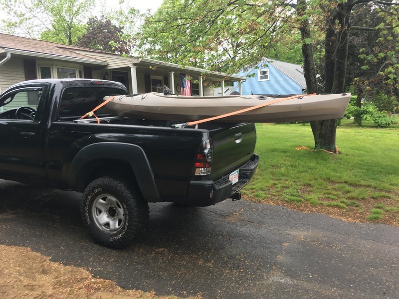

    And if anyone is curious, the kayak is a 10' trophy 126 angler sit in.
