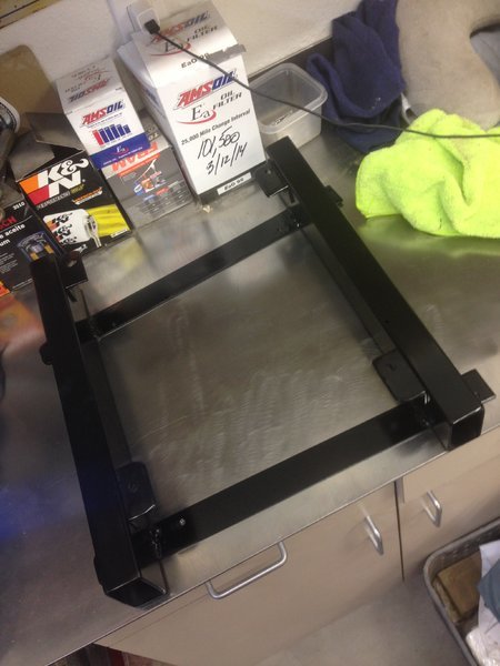

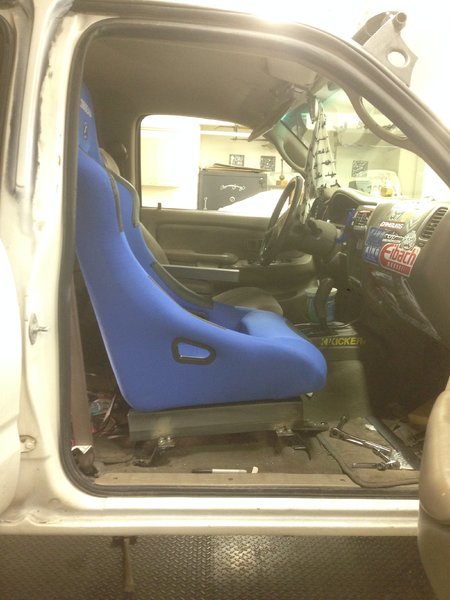

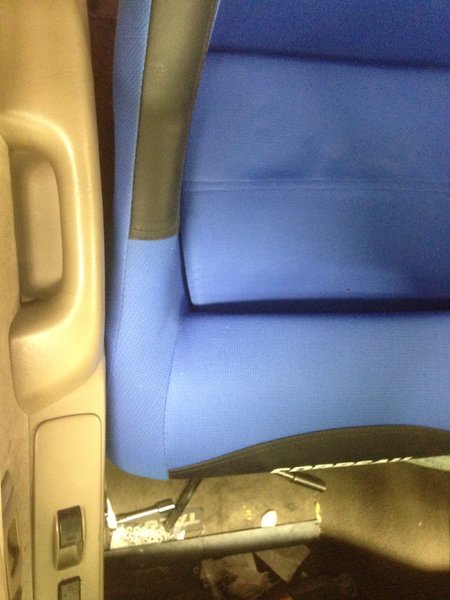

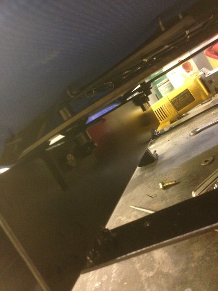

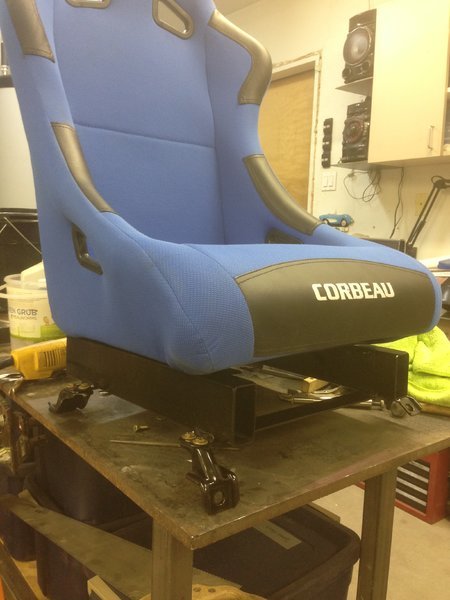

    So mocking up some seat mounts. Cut the actual mounts off the old seats them just bolted plate to it, Too me all day to figure out what I wanted to do, so the middle flat plate is gonna be replaced by 1.5"x3" square tubing. Seats sat way too low, but fit perfect in the truck. Driver side will have multiple holes for seat position for forwar or back, but I'm gonna get both to fit for how big I am and have them look good. Tuesday gonna go pick up some square tube and get a nice set up and template so I can knock the driver side out in one night.

    Yea I know it's a hack job but this is just a template so fuck off lol

    Last pic looks like the inside of a NM State Fair porta potty.
    Your Tacoma deserves better.

    Same mounts on the driver side, just mirrord. Need to pick up some square tube and it'll look a lot better and cleaner. Seats where way too low

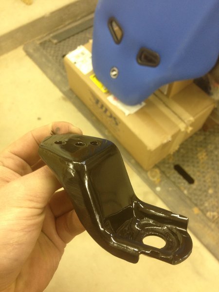

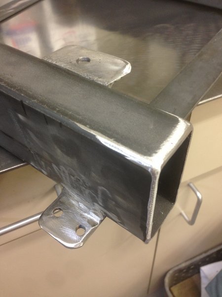

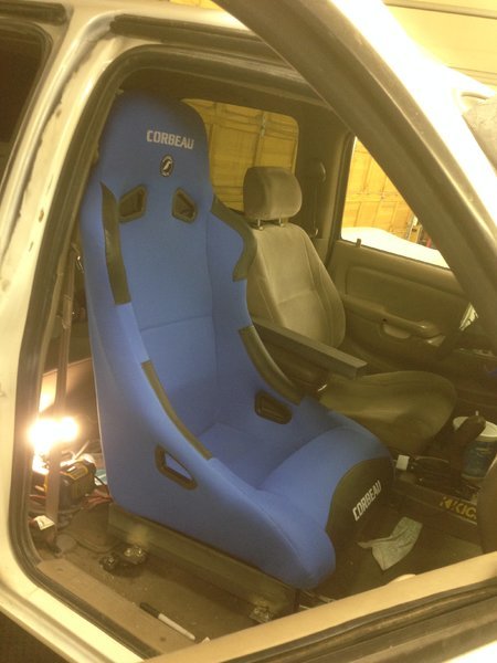

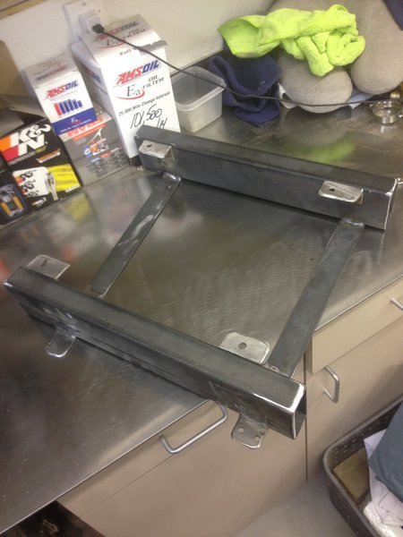

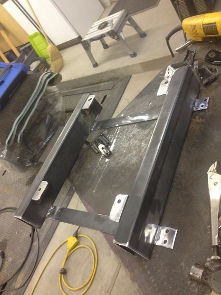

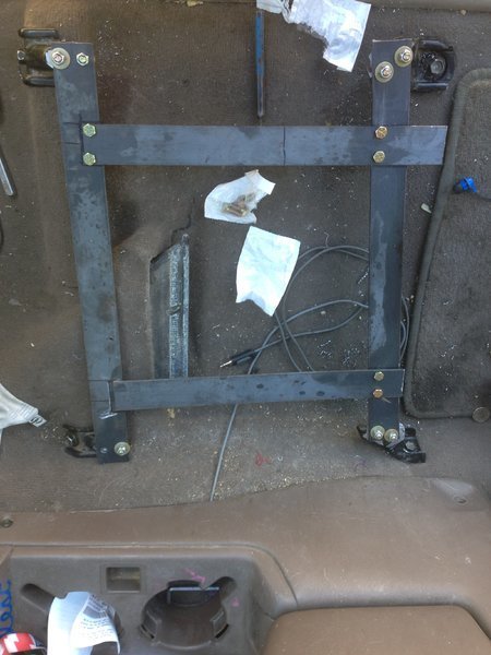

    So finished up the passenger side mounts. Used some 1.5x3 rectangular tubing. Some thick angle iron. I'll see how they do in the truck. Need to bolt the seatbelt clicker chinga to the side so I can use the stock belts till I get my pro armor harnesses. Have the driver side all cut out ready to be welded. Still need to drill some holes and other small things. Main thing is cutting off the mounts from the driver seat to bolt them to the mounts when I get them finished. Here's some pics

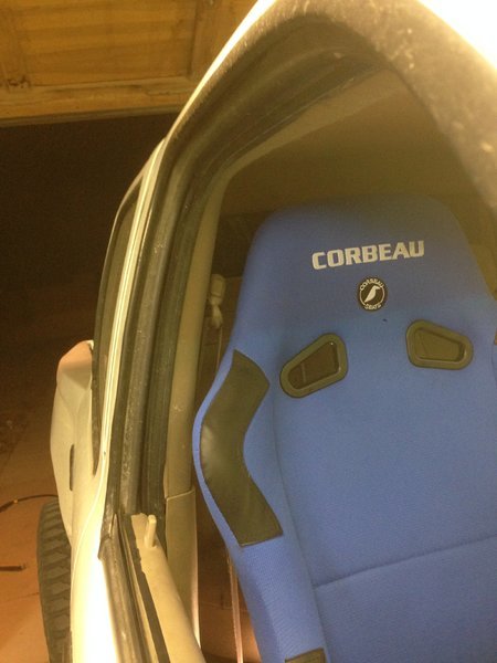

    Mock ups from 2 nights ago I think. Pretty tight
