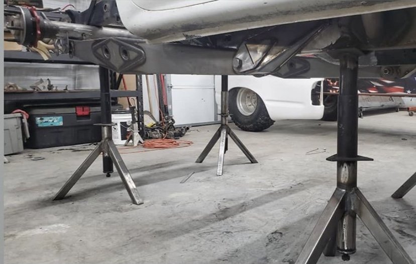

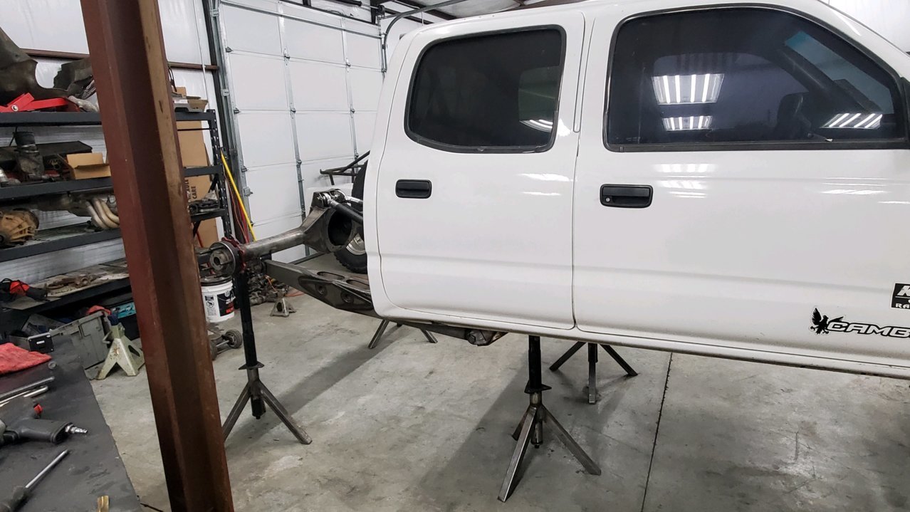

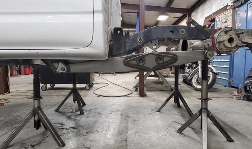

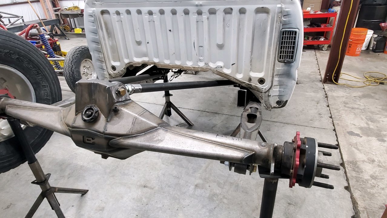

  12. Oct 28, 2020 at 12:27 PM
    #512
    FlapJack935
    FlapJack935 [OP] i member
    Nov 25, 2013
    #117294
    3,196
    Jack
    Abq New Mexico
    Wannabe Trophy Truck
    Sick Gnar Trophy Truck Tacoma and King Ranch Raptor Killer

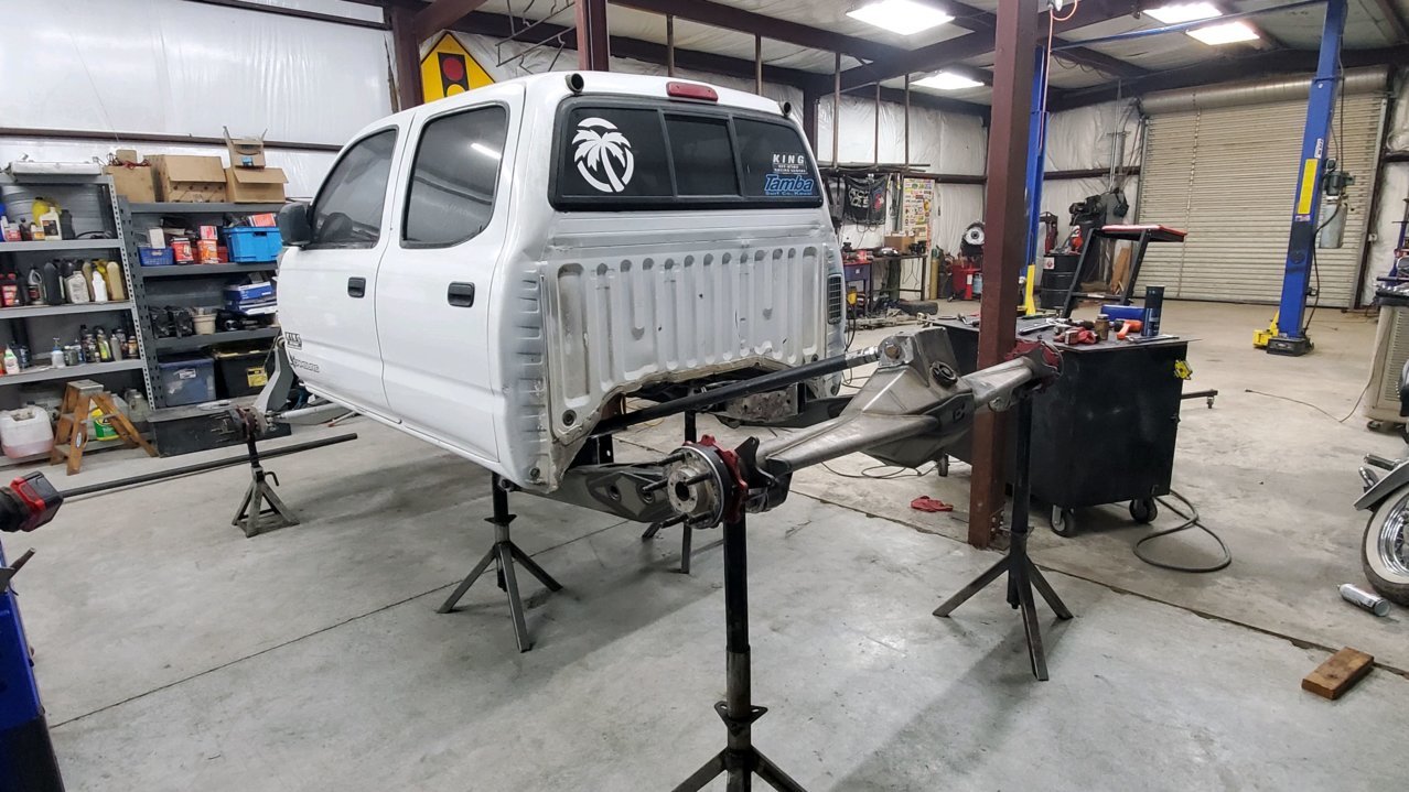

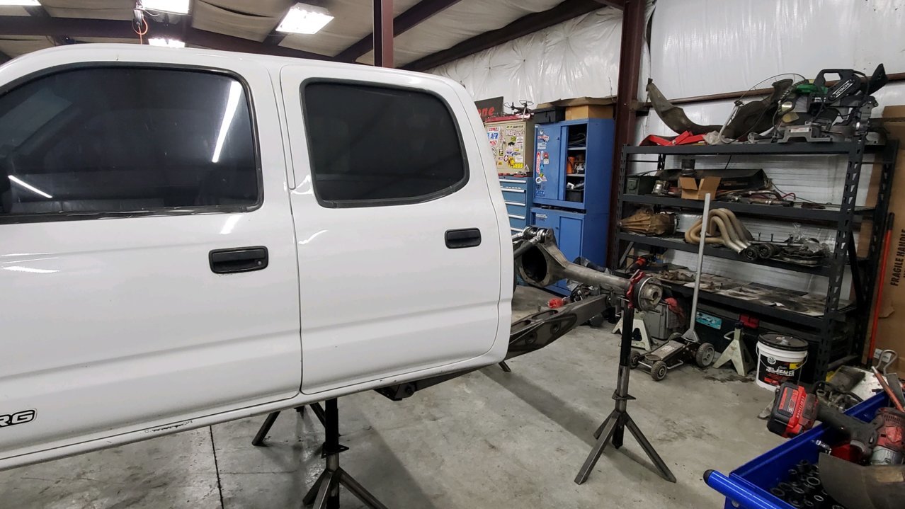

    Update, trucks in the shop, lower links are set, uppers are going on and the frame is getting chopped, Rear trunk is CNC lasered and together, walkers are mounted, finally getting it going after another year.

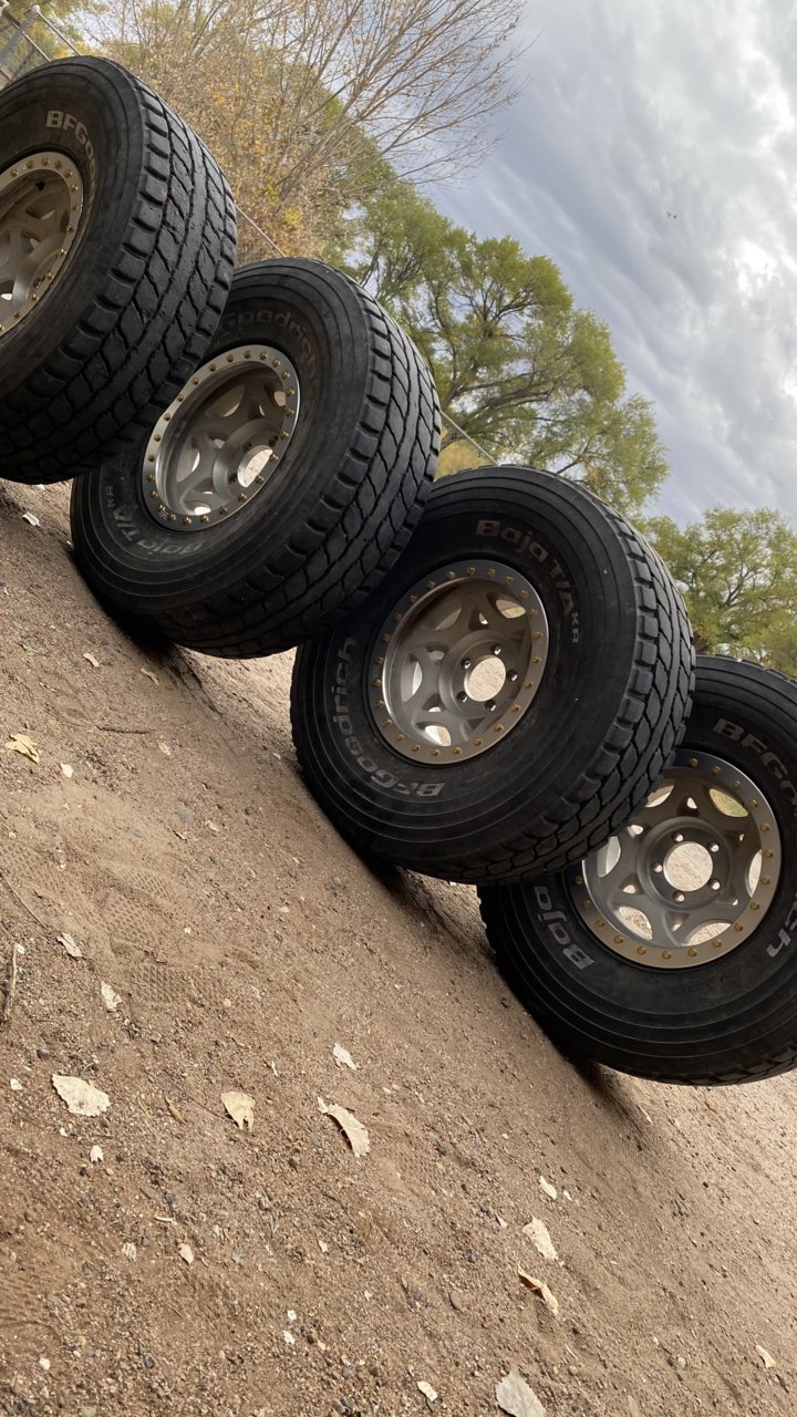

    playing around getting my wheels and then the TT bedsides and playing with color... Soon

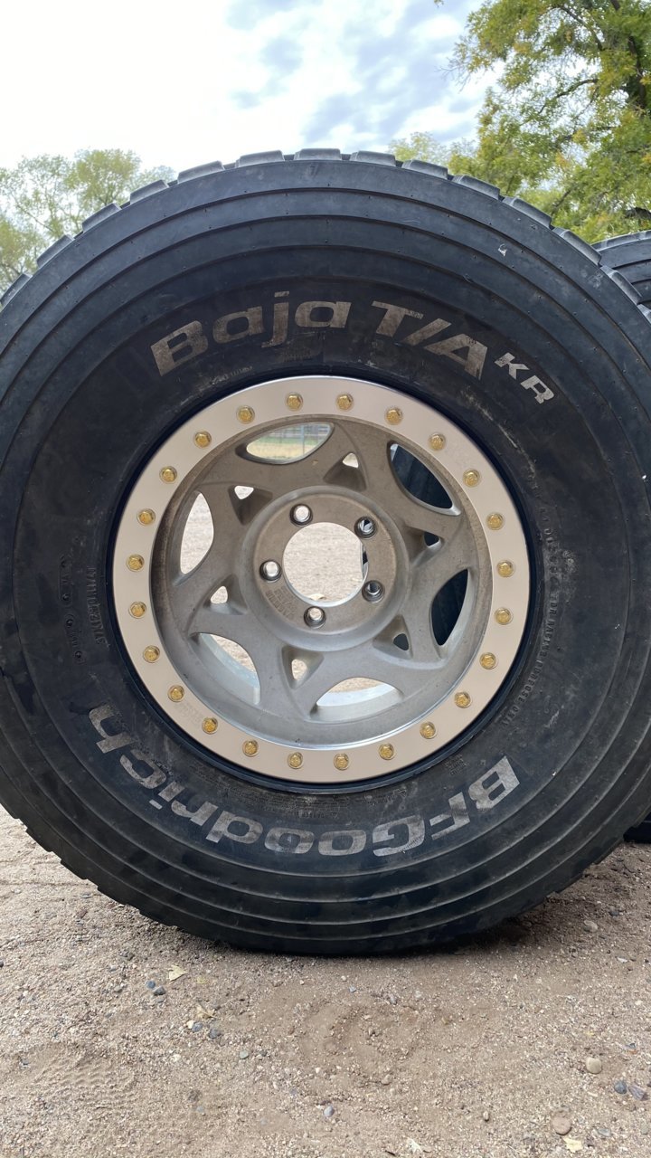

  13. Oct 28, 2020 at 12:36 PM
    #513
    betterbuckleup
    betterbuckleup Well-Known Member
    Jun 26, 2017
    #222483
    4,801
    Ian
    Concord, CA
    2000 Tacoma SC 2.7 4x4 5spd
    Looking good! Those walkers tho [​IMG]
  14. Oct 28, 2020 at 12:41 PM
    #514
    FlapJack935
    Nov 25, 2013
    #117294
    3,196
    Jack
    Abq New Mexico
    got two more polished ones on projects waiting for the 2 lay down spares :anonymous:

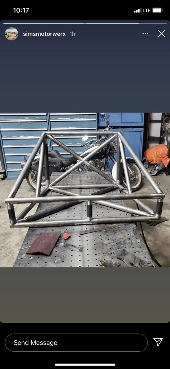

    Is the frame staying behind the cab or going all tube?
  16. Oct 28, 2020 at 10:27 PM
    #516
    FlapJack935
    Nov 25, 2013
    #117294
    3,196
    Jack
    Abq New Mexico
    All tube from the back of the C pillar, probably 5” in from the back of the cab. Going for having the axle in line with the rear door bevel you see that goes along the side of the truck at full bump.

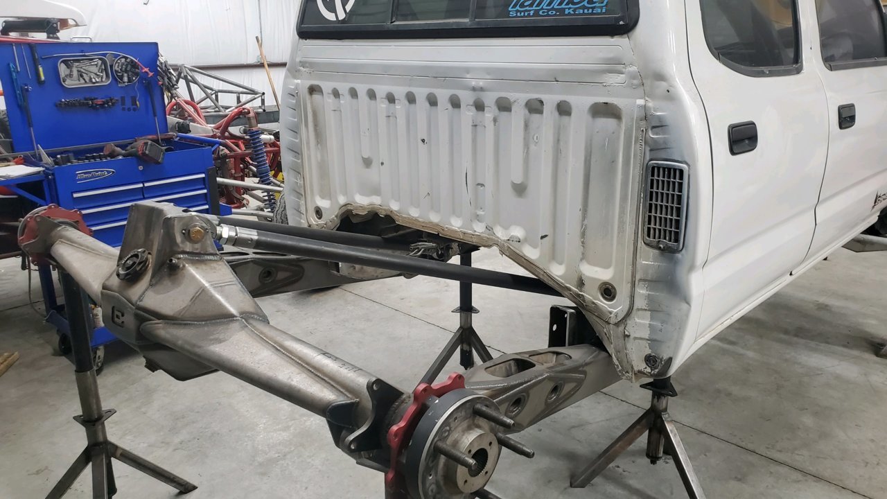

  17. Oct 30, 2020 at 11:21 AM
    #517
    FlapJack935
    Nov 25, 2013
    #117294
    3,196
    Jack
    Abq New Mexico
  18. Oct 30, 2020 at 10:34 PM
    #518
    J'sBeasTRD
    J'sBeasTRD Well-Known Member
    Jul 20, 2015
    #159922
    331
    Salinas California
    15TACOMATRDOR 4X4DCSB6SPD...
    I just saw this on your Instagram
    It’s fire
  19. Oct 30, 2020 at 11:43 PM
    #519
    FlapJack935
    Nov 25, 2013
    #117294
    3,196
    Jack
    Abq New Mexico
    This is the most current. Guy building it is making good progress, next step is to fully weld the back trunk then tie it all in. I’ll try to update this as much as Instagram now solid progress is being made

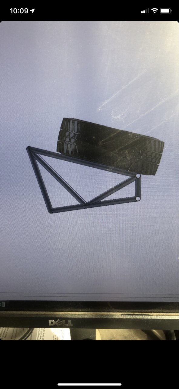

  20. Dec 17, 2020 at 1:18 PM
    #520
    FlapJack935
    Nov 25, 2013
    #117294
    3,196
    Jack
    Abq New Mexico

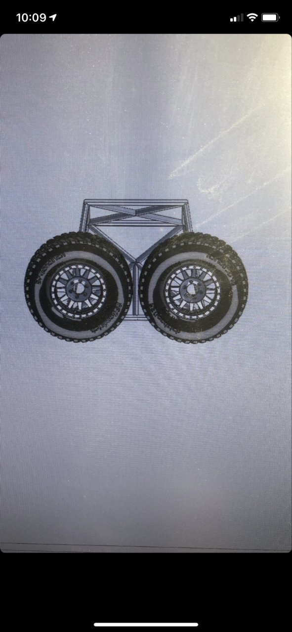

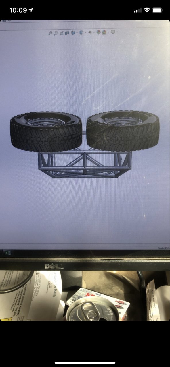

    About to jump back on my truck, seeing ideas on if I’m gonna shoot for dual spares or not. Rear glass might not fit or it might, who knows but the trunk is ready to be welded, then tubes ran from the cab. Currently sticking with the 3.5s, I want to jump to 4.0s or 4.5s.
