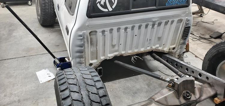

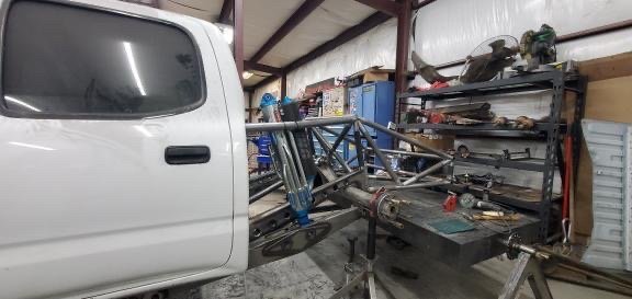

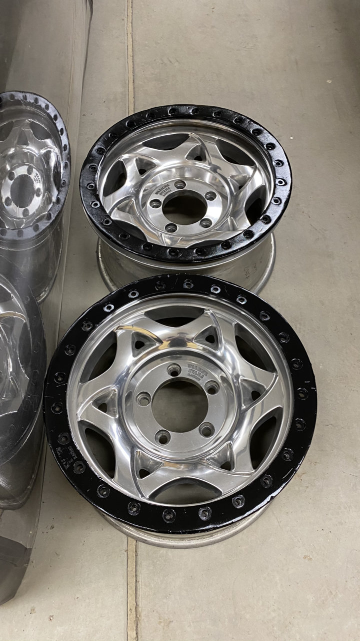

    Spares ready to mount. These came off the old fabtech ultra 4. Debating getting the other 4 polished and black rings. Just gonna be expensive.. waiting on a price from king for 4.0x18” 5 tubes with big finned resis. Then convert the coilovers to 16s to get some more travel. Also debating going to 12” shocks in the front as well once the rear is finished. The term buy once cry once is way too true. Anyway these get mounted tomorrow then dropped off at the shop this week. Link tabs and mounts are on the truck, next step I believe is to cut the back of the cab out and start running tubes.

    Update: Ditching the 2.5x14"/ 3.5x16" shock combo and going to 2.5x16"/4.0x18" coilover will just be a coil carrier with no valving and the 4.0 will do the work. 3 week build time for the 18s so for now, getting tubes run from the cab to the trunk and then bump stop mounts till the bypasses show up and then on to shock mounts.

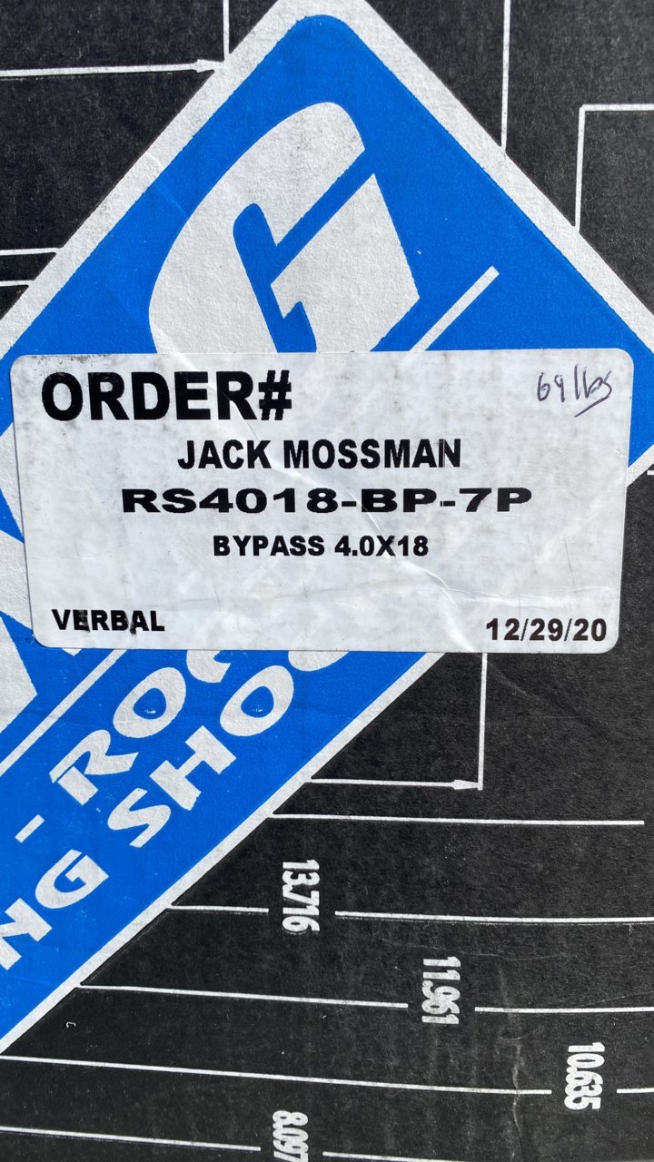

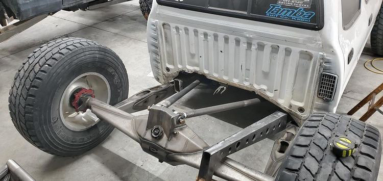

    4.0 18” 7 tubes came in. Pumped on only a 2-3 week wait time from ordering. Feel bad for the 24 week people lol dropped them off the next day, next step is mount the rear hubs back on, mount the wheels and then drop it to bump and take measurements and then set the axle at bump and then cut the rear wall out and start pulling tubes. Getting close for the next big steps, the buggy is getting center mounted so that has a dead line then this thing is next on the list. Sucks waiting but I don’t have a deadline and just let’s me save for the interior, engine, and everything else that will be going on after the rear is made.

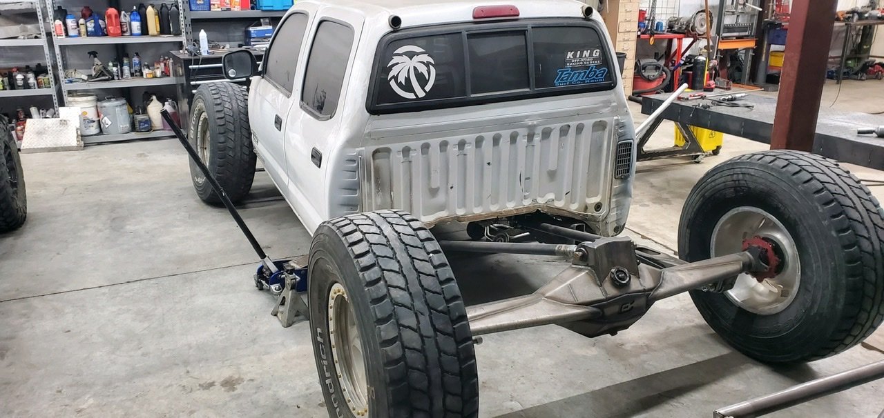

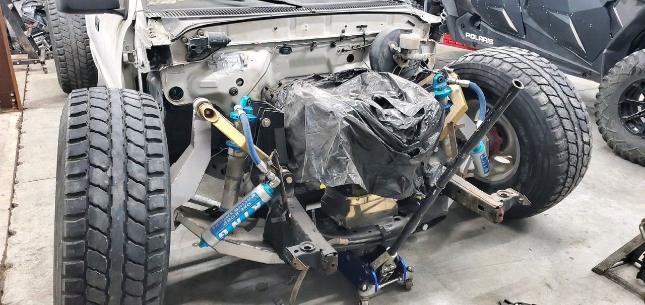

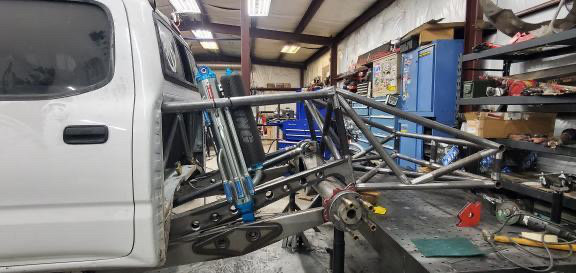

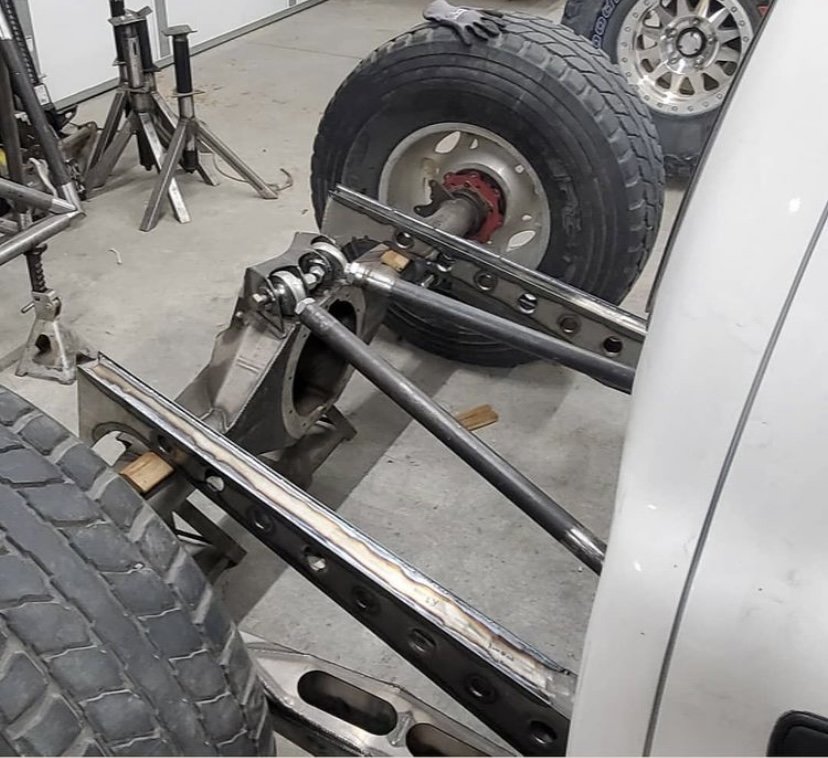

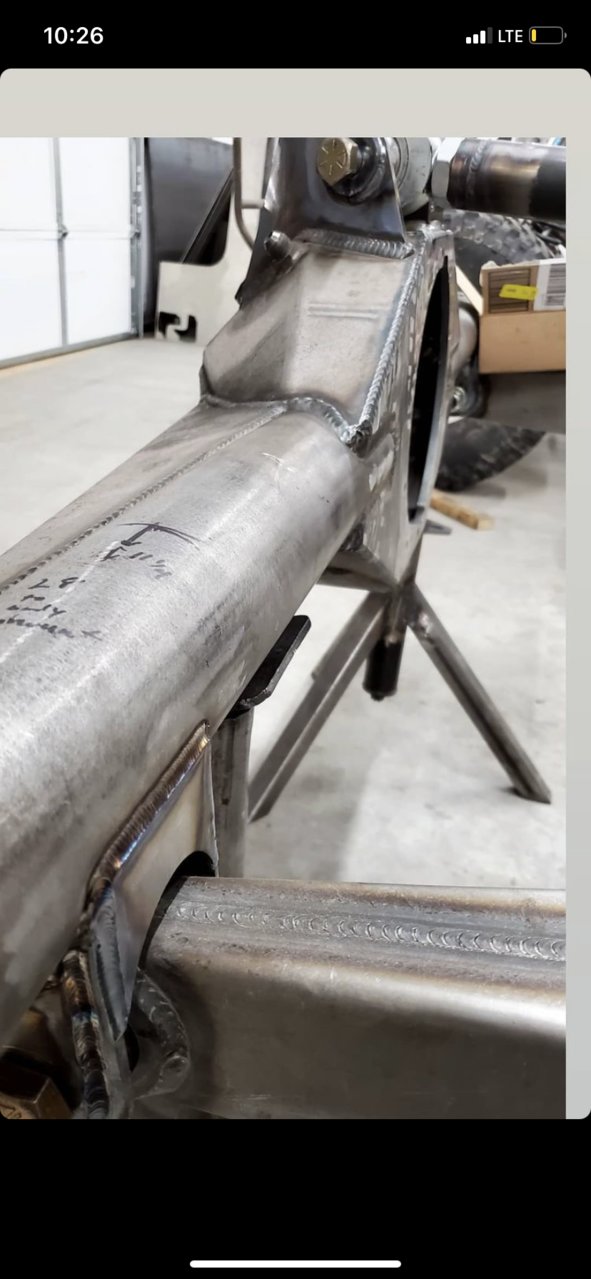

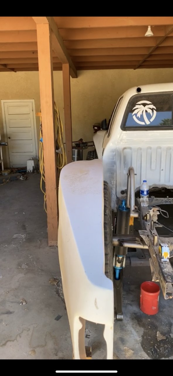

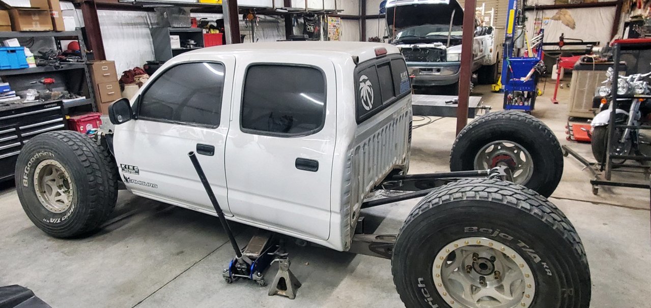

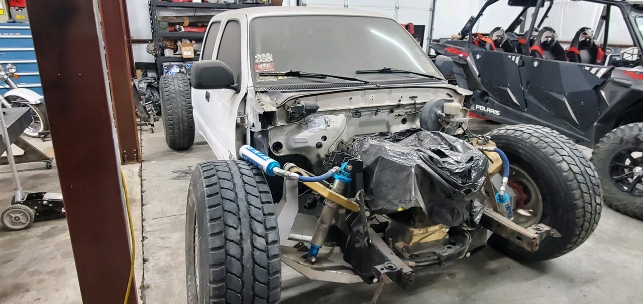

    Getting bump set up. Frame is 8” off the ground in the rear, front is currently 12” undecided what I want to do in the front. Either keep the 10” shocks and re do upper shock mounts to come off the engine cage and clear out the frame rails for the lower arms, or go to a custom upper arm to clear bigger 2.5/3.5 12s.. steering rack is another hurdle also but I’d like to max every inch of this truck out. Center mounting is a little more than what I want to do right now... but the truck is back on top of the list to get worked on so hopefully we see a lot more progress going!
    first 3 images are bump for front and rear before at 12” of frame flearence
    230a40bf-7db5-4a99-bb97-be990c06e4ed-jpe_8a925d1e46a884b026182efa33349431214bc2b8.jpg
    c012753c-fc44-433e-9480-870f130785e4-jpe_0280bdc4d23da5be9a6ded26255986072c762f80.jpg
    90d5fcde-1fa1-4cbd-a8e4-060a26606804-jpe_c7a4d02df8e861d28105f079aba778b27ced4e3d.jpg
    Then if we redid upper mounts to get more up travel at 10” front frame clearance and then 8” rear frame clearance.
    6223d637-8aff-4a2b-be39-2e9baa27fb43-jpe_0aa13422a6c12d1fac2d46d4f421ae46ec60992f.jpg
    fc2c1eb7-db93-401d-9861-3d3e766c1d69-jpe_5a7a1984a014afedf3ff6cbbfdfe24e1e6f0d0a7.jpg
    568a6781-67ba-4da7-b2d4-9f50ccba8a20-jpe_3acc6c62113ea30a23ed0dccbb1e0aef0a570caa.jpg
    8bfb5f0a-a629-4a8b-b68d-d51d8a4c1123-jpe_1ef78ad6f84b6e56a7943ecd78055ad1cc65195b.jpg
    SilverGhost, cbechtold and 2004Taco like this.

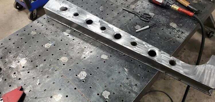

    Frame rails getting cut out today..

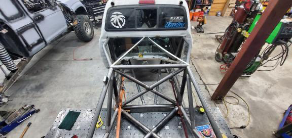

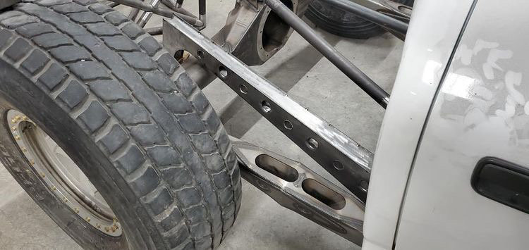

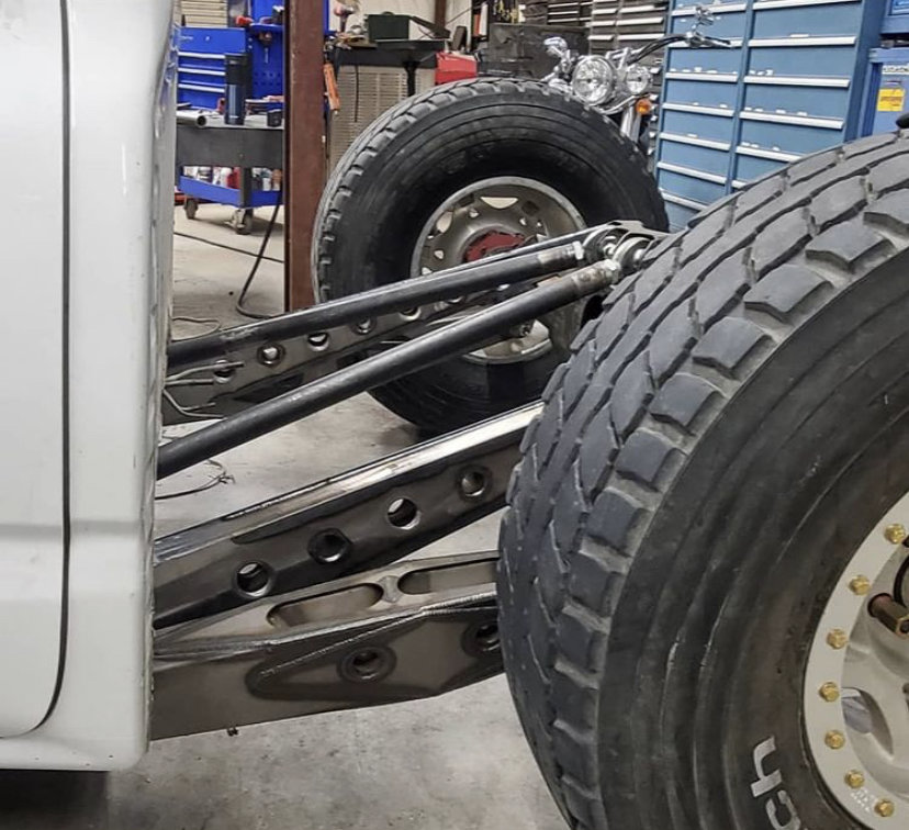

    Frame rails started, some through tubes then some dimple dies also, trucks the main one in the shop now so alot of progress is about to start. Rear trunk will then meet with these guys.

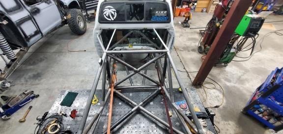

    Both frame rails ran. Whole back of the truck will be all tig welded I believe.

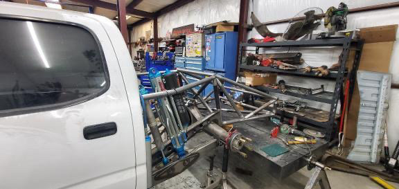

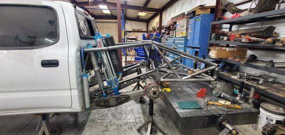

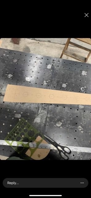

    Tubes getting drawn out

    Big doinks
    Slashaar, malburg114 and cbechtold like this.
  20. Mar 10, 2021 at 11:04 PM
    #540
    malburg114
    malburg114 Well-Known Member
    Dec 26, 2012
    #93766
    3,607
    Las Vegas, NV
    2001 Toyota Tacoma TRD
    What size coikovers you using and how long are the trailing arms? Looks tits
