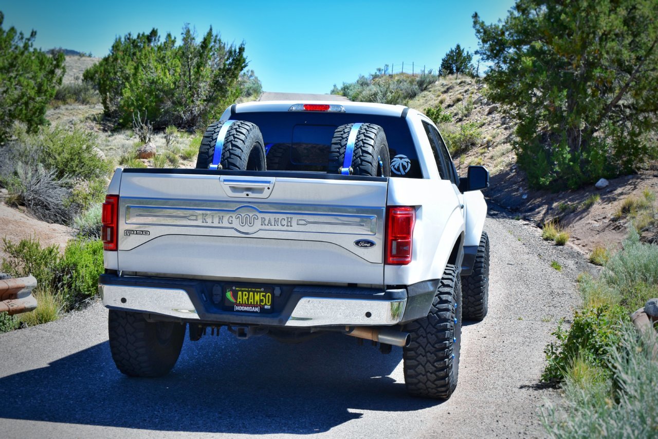

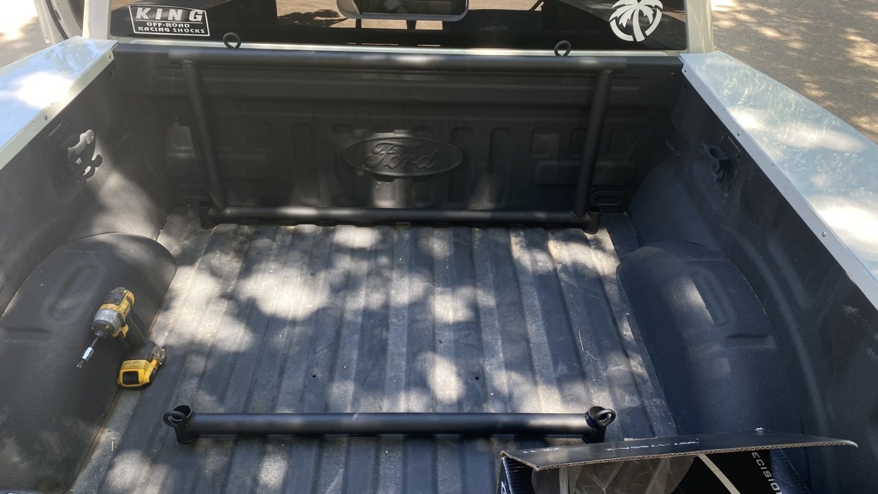

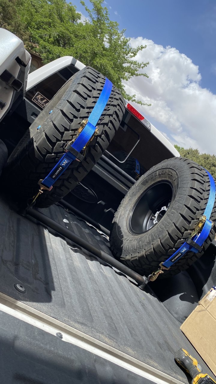

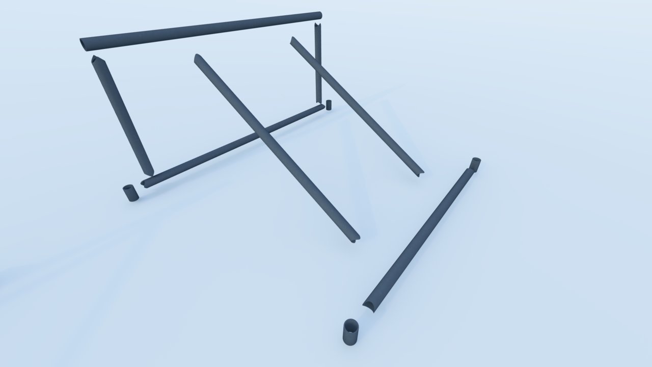

    no updates but decided to model up a dual spare cage for the daily. Cant justify spending 1500 on the ones out there... literally 120 bucks in tube and simple math.. waiting on tube caps and strap mounts from kartek. Have the spares and straps already, picking tube up today also.

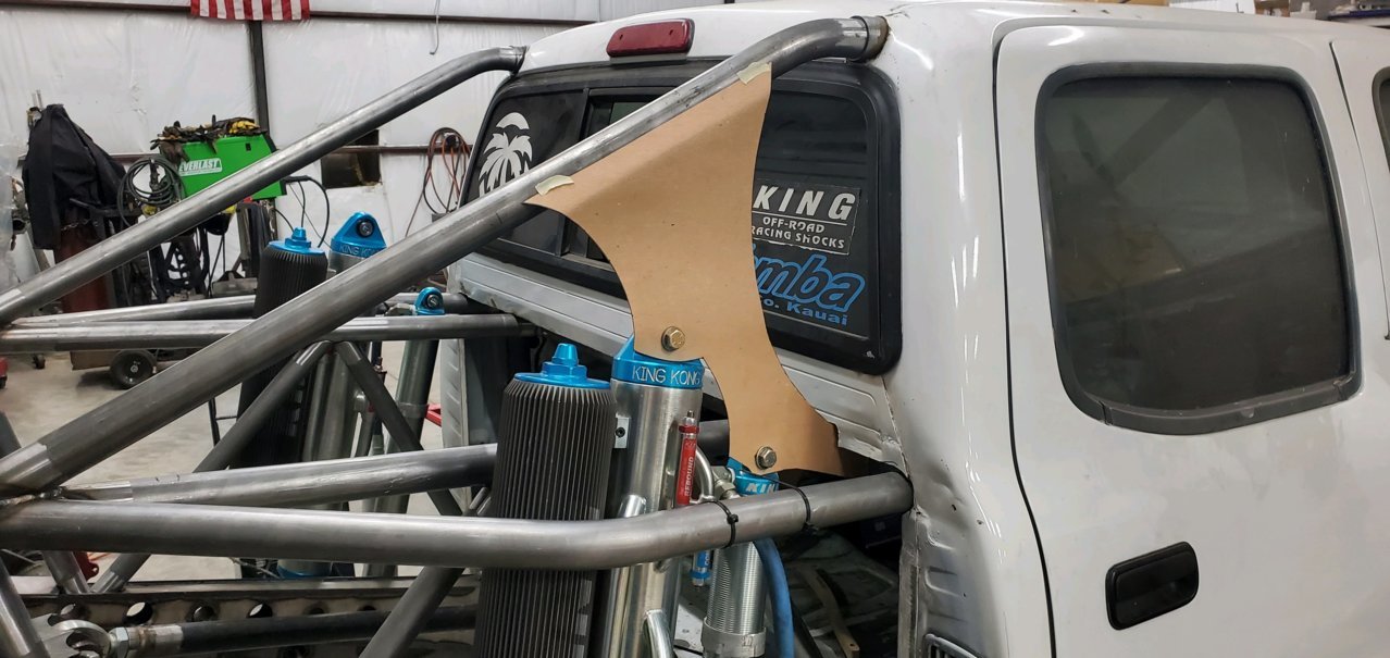

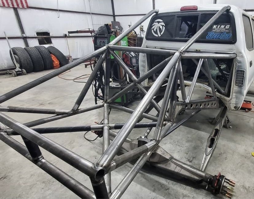

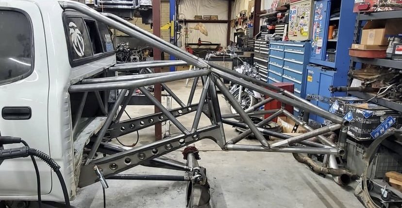

    Small update. Tubes getting dialed in.
    Getting closer to shock mounts and bump mounts after a couple tubes.
    Shops packed so my stuff on the slow side. Not rushing in my end.

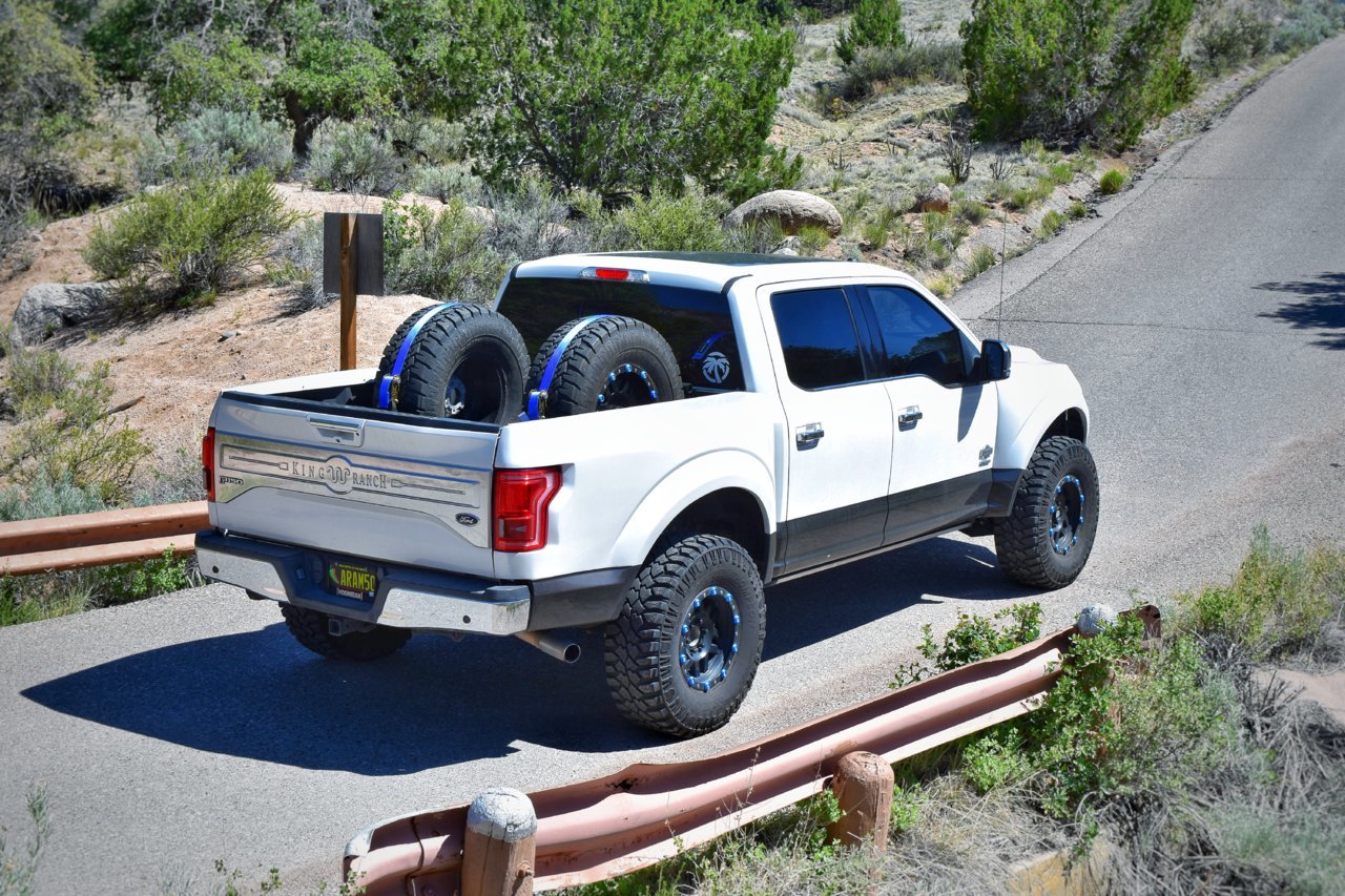

    No updates on the Tacoma as of right now but got dual spares set up on the daily

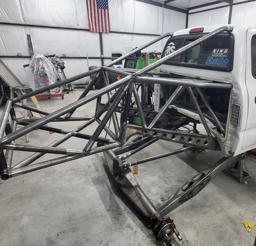

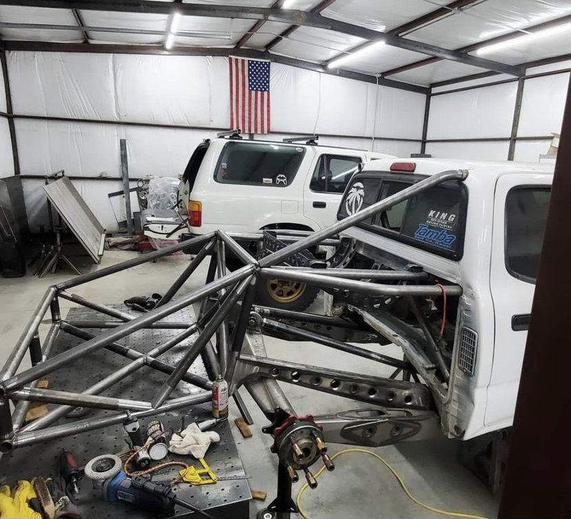

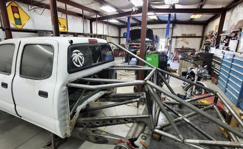

    Town tubes on, one side of frame rail tubes in, next is fuel cell mount, then bump stops and shocks mounts and the rear will be wrapped up.
    After that I’m not sure what direction the truck will go. I might pick it up and put it away for a while to focus on my degree and life priorities so not sure what’s next after the rear

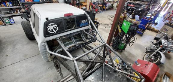

    Next up is fuel cell mounts and then bump and shock mounts

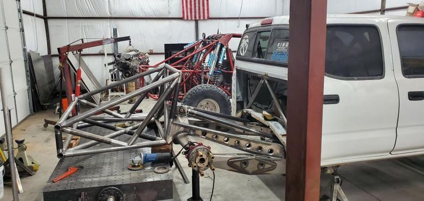

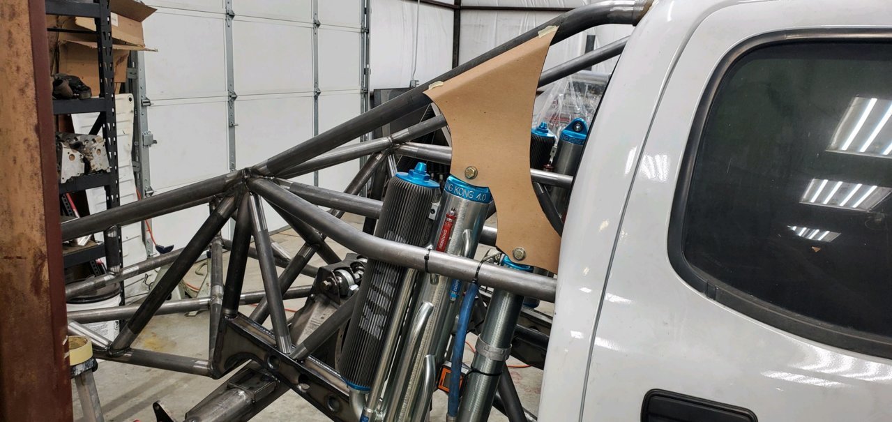

    Shock mounts getting laid out
