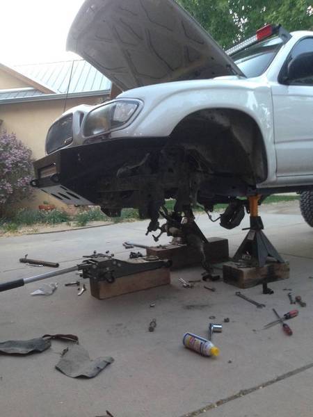

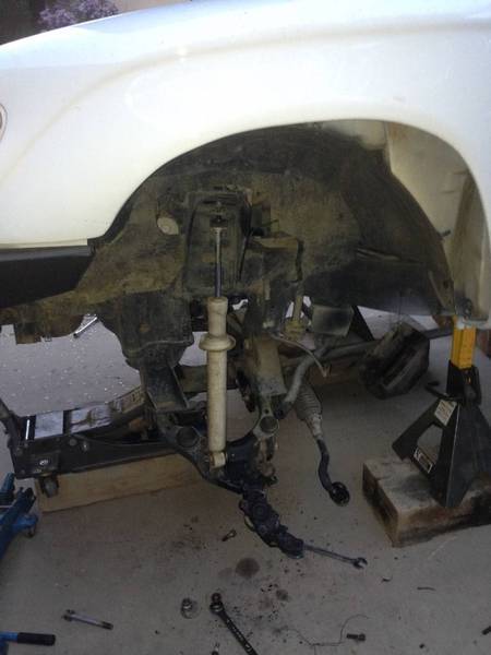

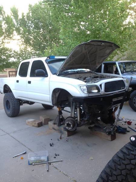

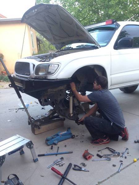

    so finally got around to taking this thing apart to get the long travel on, made a good dent today.. just some progress pics
    ball joints are a bitch btw lolol

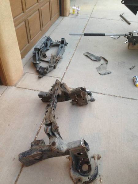

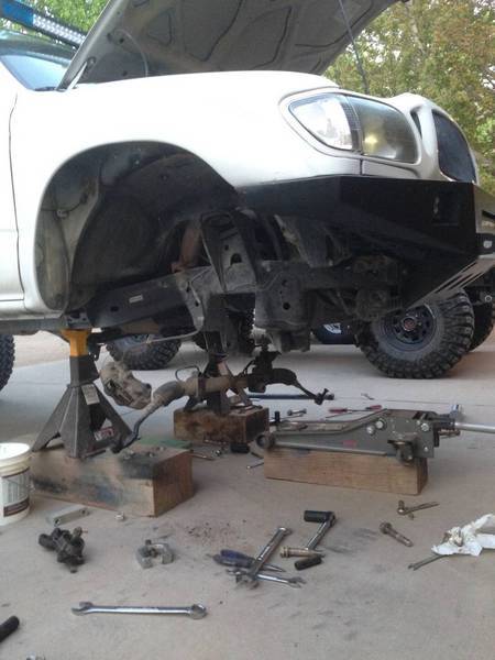

    made good progress this afternoon. got this drop bracket crap out, steering rack is hanging for alignment, all thats left to do is cut the doner crossmember out and weld it in, then the kit can be put on! too pumped on how its going

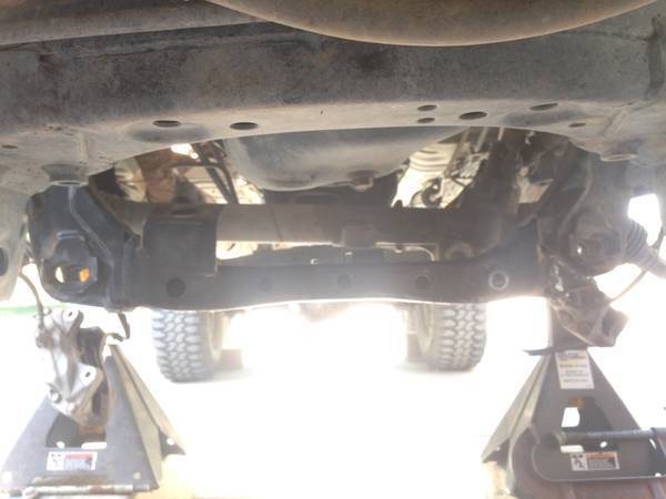

    got the crossmember cut to the best i could do, took 3 hours. only got one of them so its gotta be perfect. dudes at desert rat really fucked me over cutting this out when it didnt need to be cut out.. douches. gonna weld it in next weekend when i have more time to really focus on it. for now im gonna take the whole rear end out and put the new leafs in, and get the tundra axle under it and line up the perches and shock towers

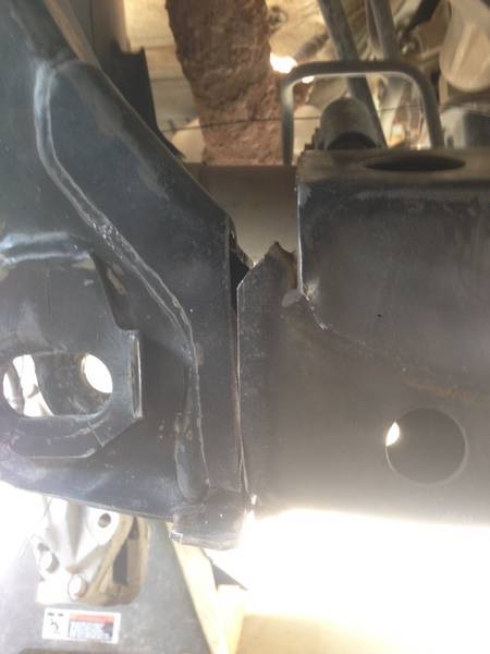

    made some steps today. got the cross member fitted up, still minor trimming. but all that hassle for a little critical piece. i could have had the front kit already done and on the truck if it wasn't for that piece cut out. THANKS A LOT DESERT RAT
    some pics
    made a boo boo on this one so just laid some lines down and re-cut it. still have to trim more off this
    driver side fit (not done)
    passenger fit, need some little fillers. some gaps are to big to fill with welds.
    overal fit. happy with the progress.
    sorry for quality of the images. iphone aint bad tho

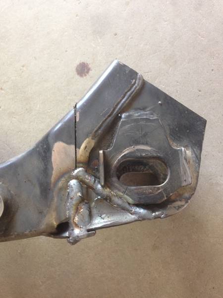

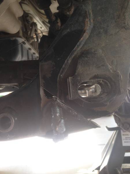

    just thought id share some pics of how i welded in the cross-member they cut out. pretty straight forward. glad how it turned out
    some spots got a little contamination but got good penetration and good material where it counts :welder:
