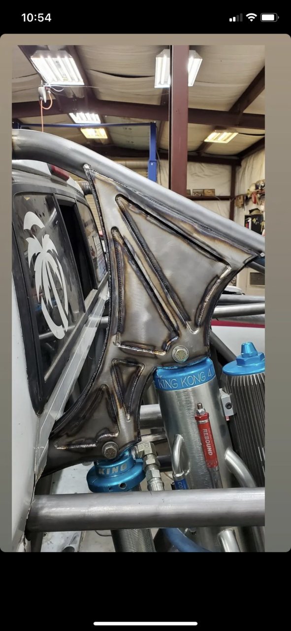

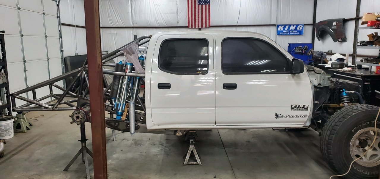

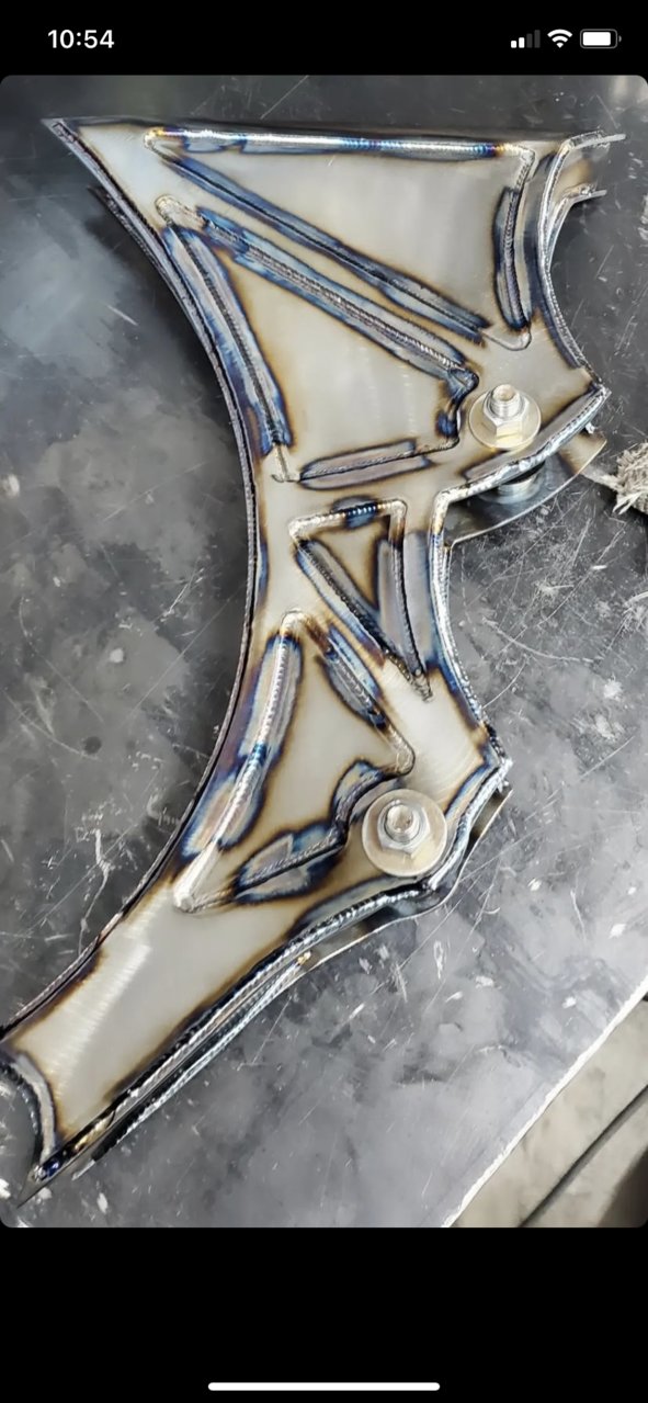

    Plate getting cut
    Slashaar, jubei, FishnTx and 5 others like this.

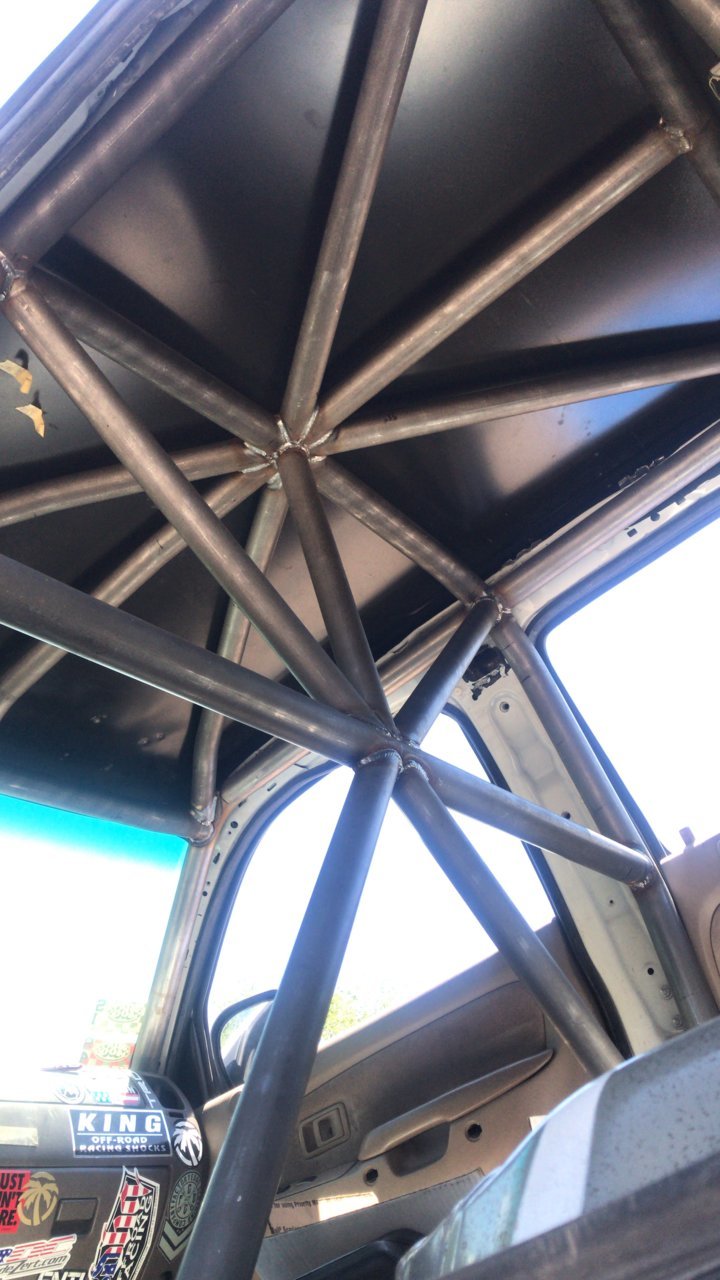

    How come they stepped down from 2" in the cab to 1.75" outside? Can't wait to 4 link mine!

    Most small trucks only do 1.75. I think 2.0 cab cage is good enough to race but overkill for the bed and engine

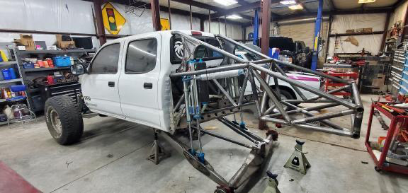

    Exactly what he said. Whole interior do the truck is 2”. Backhalf is all 1.75 and then the front engine cage will be 1.75 also. Door bars and V bar inside will be 1.75 too. If I were doing a full size like an f100 or raptor (shhhh… that’s next) I’d do all 2” throughout.

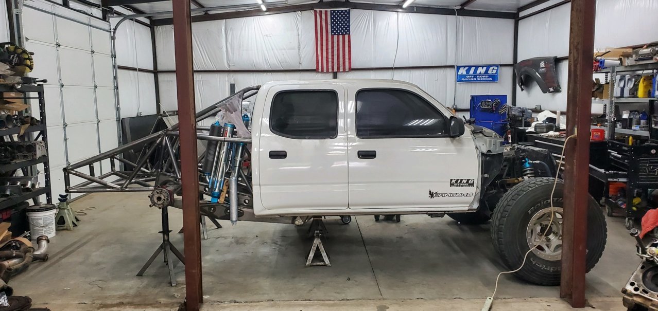

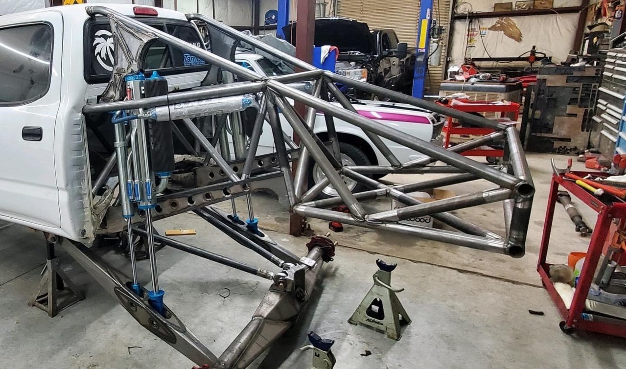

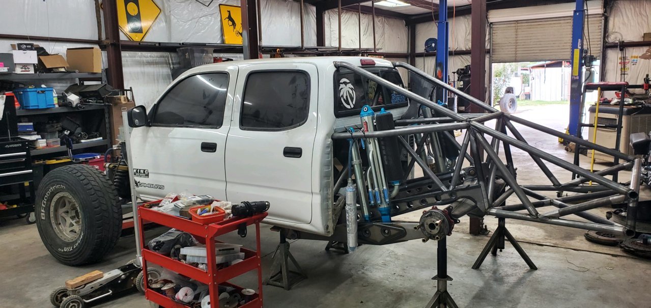

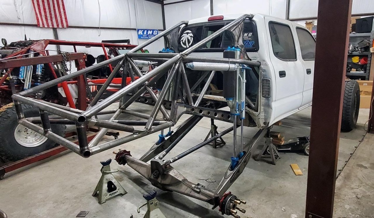

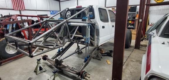

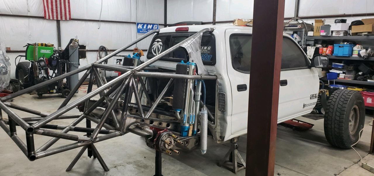

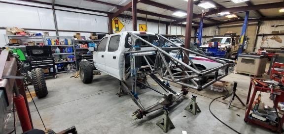

    Rear is coming together. Some overall shots to see the language the trucks gonna give. Just about at ride height also. Front end is gonna get the same 4.0/2.5 combo with the TT kit.
    Slashaar, FishnTx, DashMaple and 2 others like this.

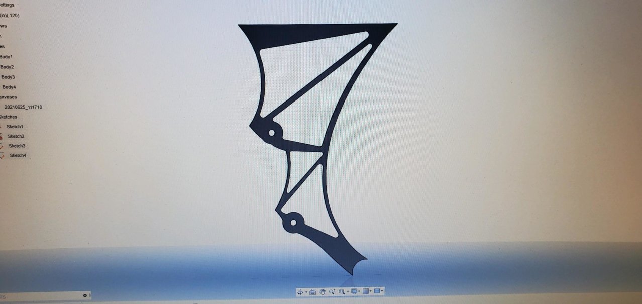

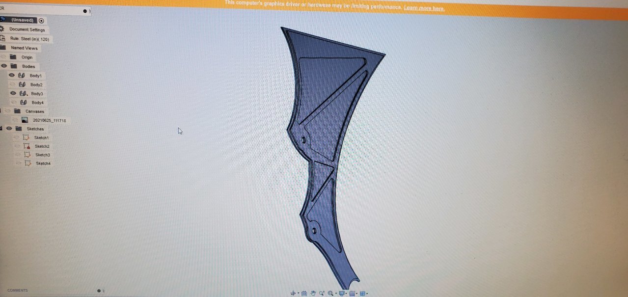

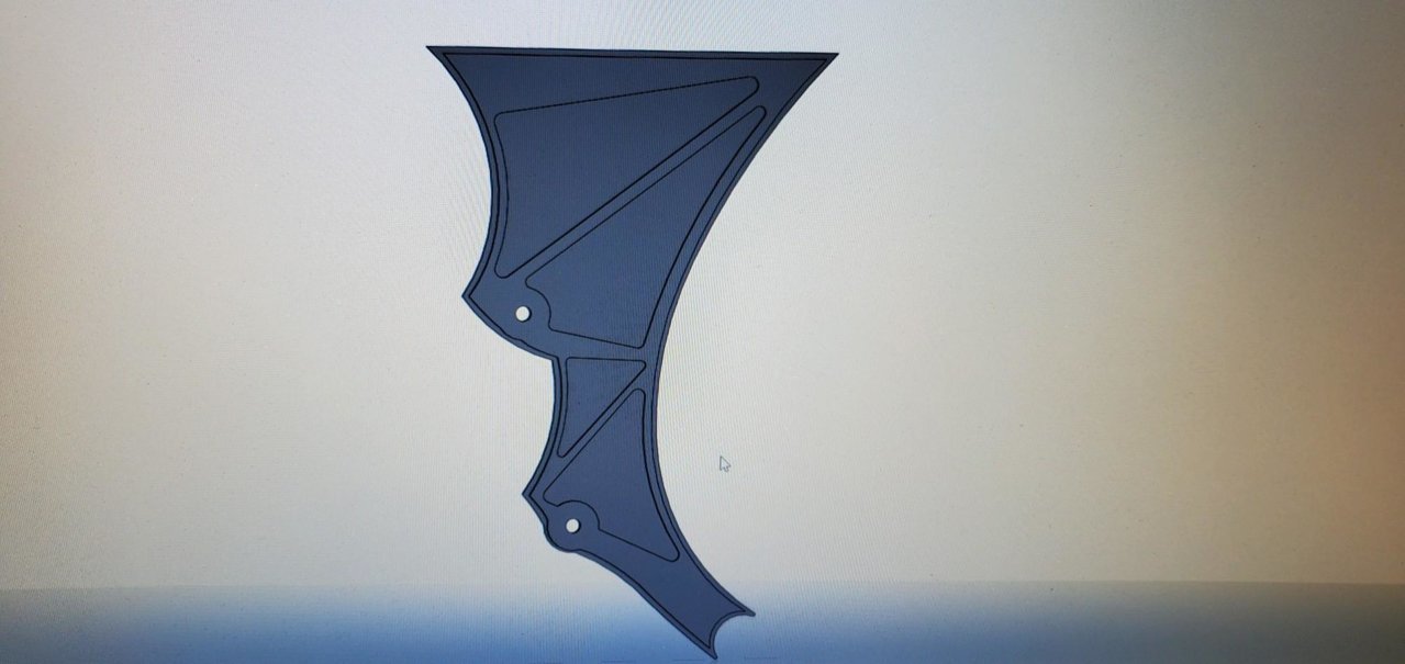

    Overlay plates drawn up. Will be bumped up a little so some of the plates aren’t as thin between
    cbechtold and Caboose117 like this.

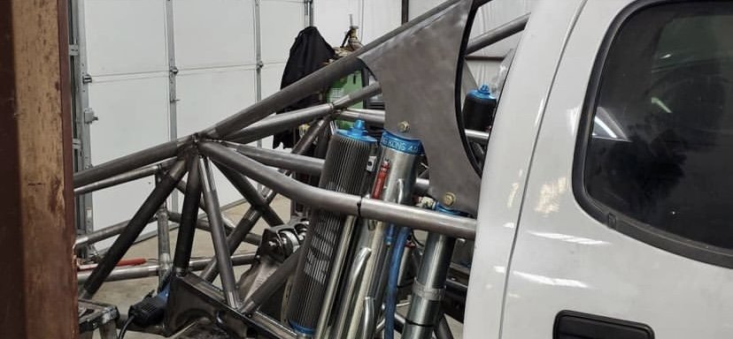

    One side finalized for design. Other side is next then bump stop mounts and fuel cell mount

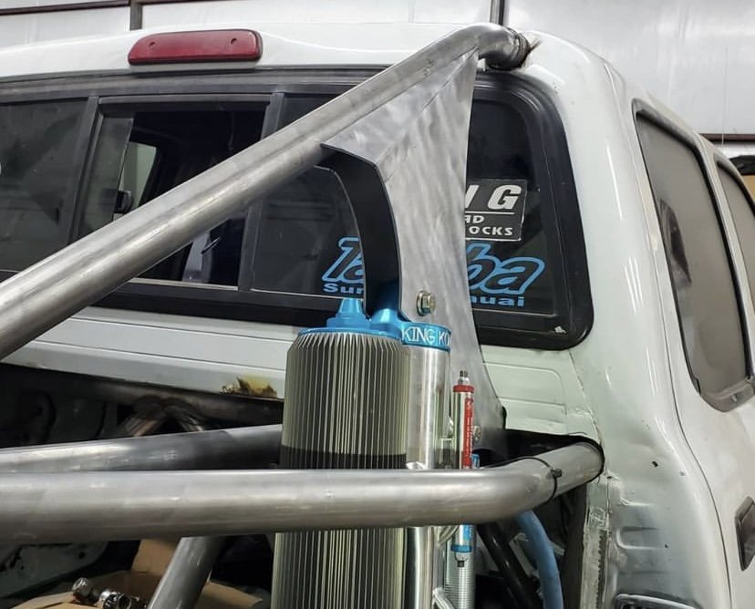

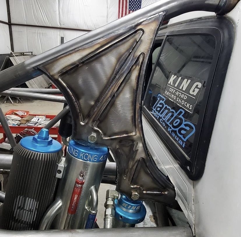

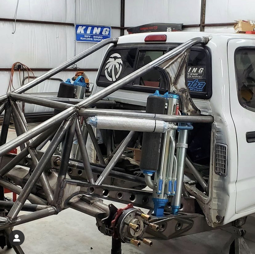

    Driver side shock mounts
    Slashaar, jubei, DocME and 4 others like this.

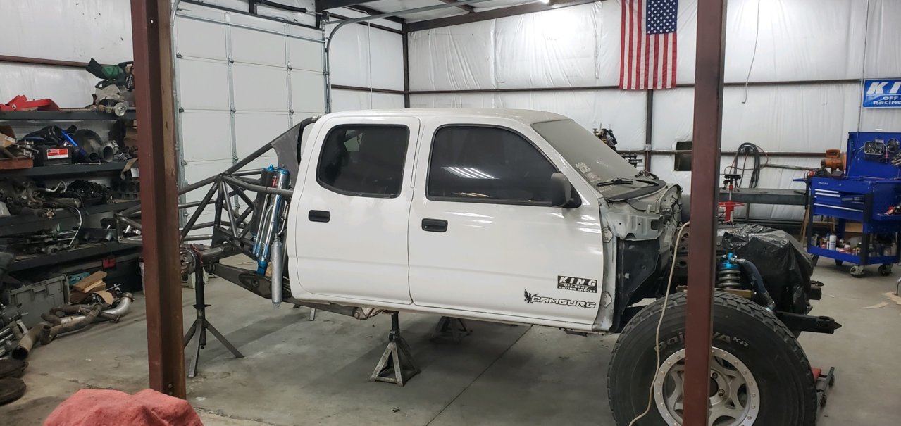

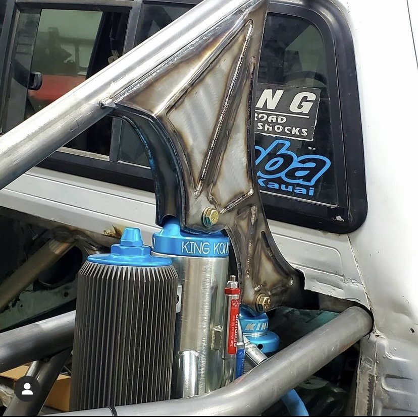

    Drooped out, just over 29" of travel
    Slashaar, jubei, TMFF and 5 others like this.

    Better quality of the pictures above
    Slashaar, T.Barn, jubei and 6 others like this.

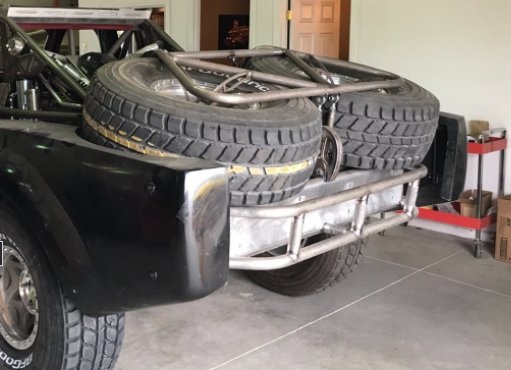

    Looks like there’ll be a trunk behind the rear axle under the spares.
    jubei and FlapJack935[OP] like this.

    Yea, rear area will be a trunk then two flat spares on top of the lid, temporary untill i have a custom 60 gal cell made for that area then transfer storage inside the cab for tools.
    image for reference of how the spares and trunk will be, and yes the lid will be on a actuator because im lazy lol
