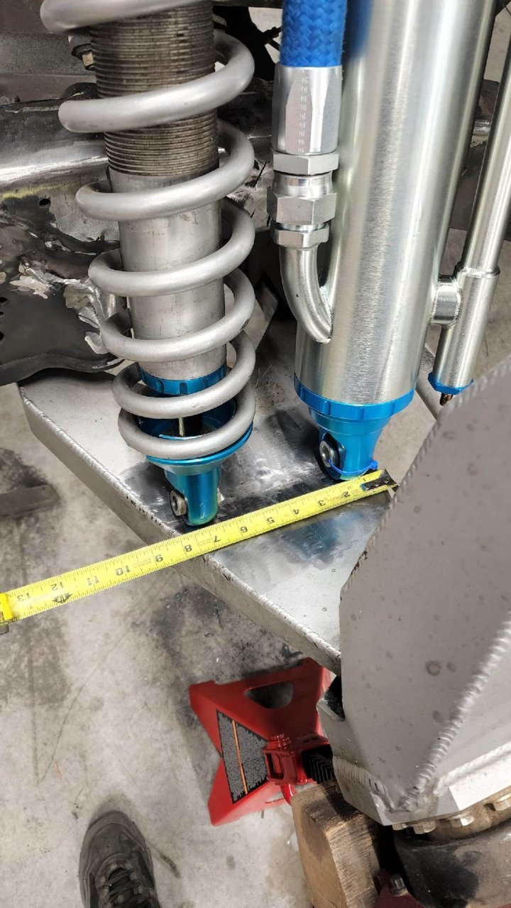

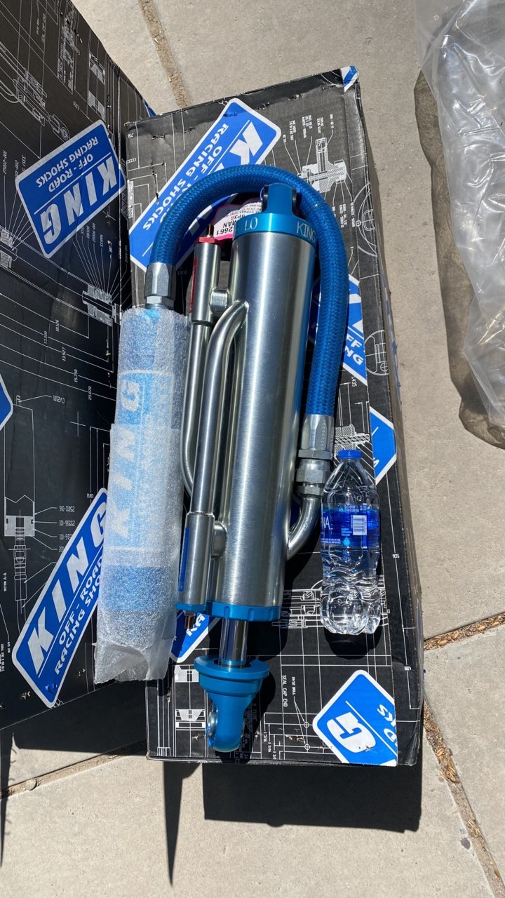

    Not much of an update but front bypasses ship next week, gonna clock the top caps 90* then leaves room for some more tubes in the future.
    Rear shock mounts are cut off the truck to be redone better. Then from there it’s just bump cans, bump pads, and fuel cell tie into the cage. Slow but other trucks have priority in his shop.

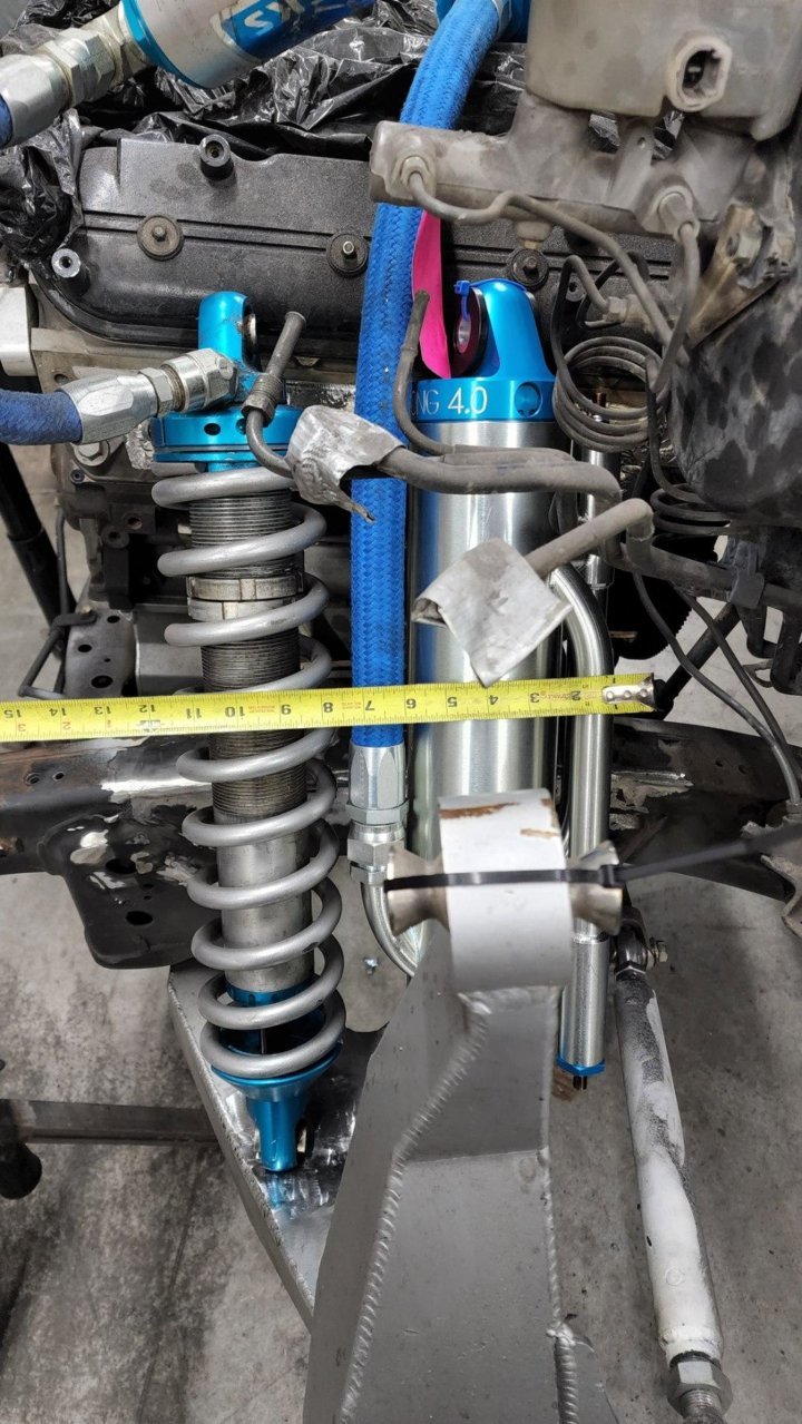

    full articulation one of the bypass tubes was about 1/4" from the frame rails and after thinking about it were gonna pull the tops of the shocks out more to give a little more room. tops of the shocks were leaned to the central of the truck about 3" like a class 1 buggy so theres some room to adjust. Everything else cycles good and ill probably never fully articulate it, but better to not have that be a problem later on

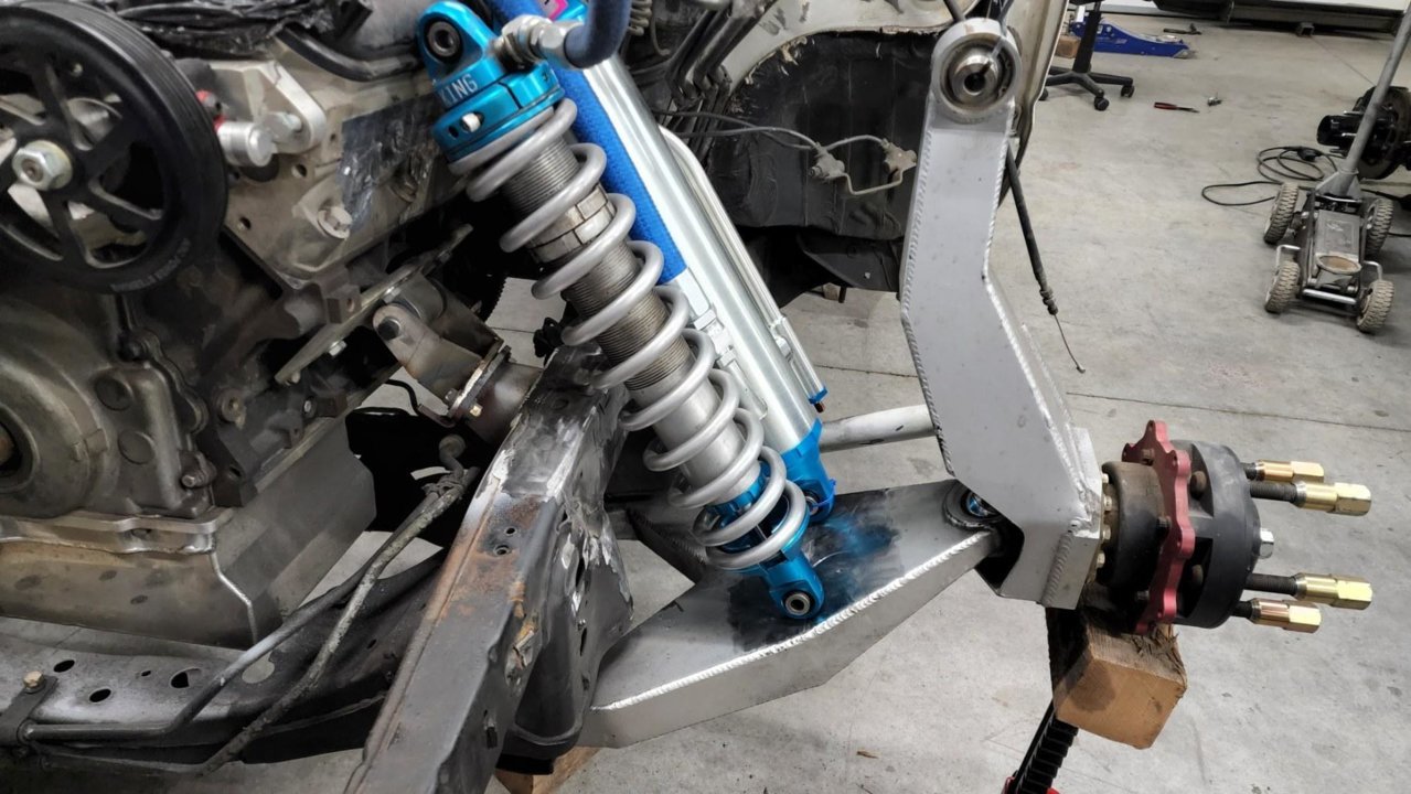

    Front shock towers cut off measuring for new upper arms for Tommy to build and ship.
    Truck will also be getting his new swing set steering kit once that is developed and available.
    Upper arm will have a 13” spread for plenty of room for activities.
    Unsure if the brake booster will stay or not. That’ll be an afterthought. Was thinking of running just dual wilwood masters and their pedal assemblies mounted inside the cab.
    Pics of current mock up for the front end.

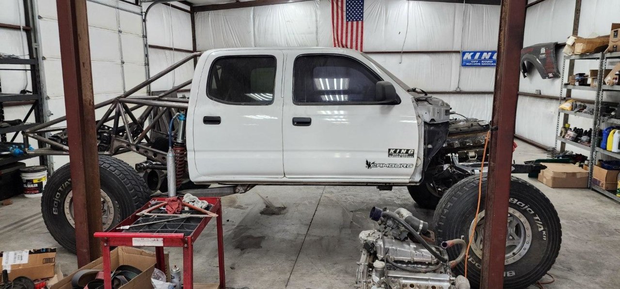

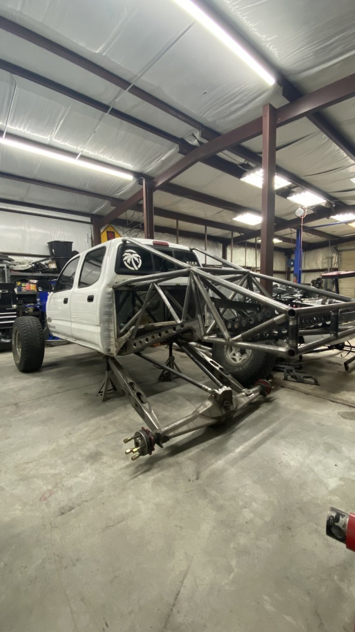

    Update, nothing much. Trucks prepped to be a roller to get moved to the new shop in Las Vegas where it'll continue. Front end is ready for engine cage and shock mounts. One off uppers are made for the 2.5/4.0 12" combo and mounted to the frame. Rear has temp mounts to get it to roll. Rear mounts were cut off to get redone to add more room between the bypass and frame rail. Once its in Vegas in Feb/March, things will move faster as its no longer probono/free time project for the fabricator. His new shop is where the old Shelby factory was by the speedway so if your in Vegas check him out. Pro UTV racer also with their new chassis they are building. Sims Motorworks.
