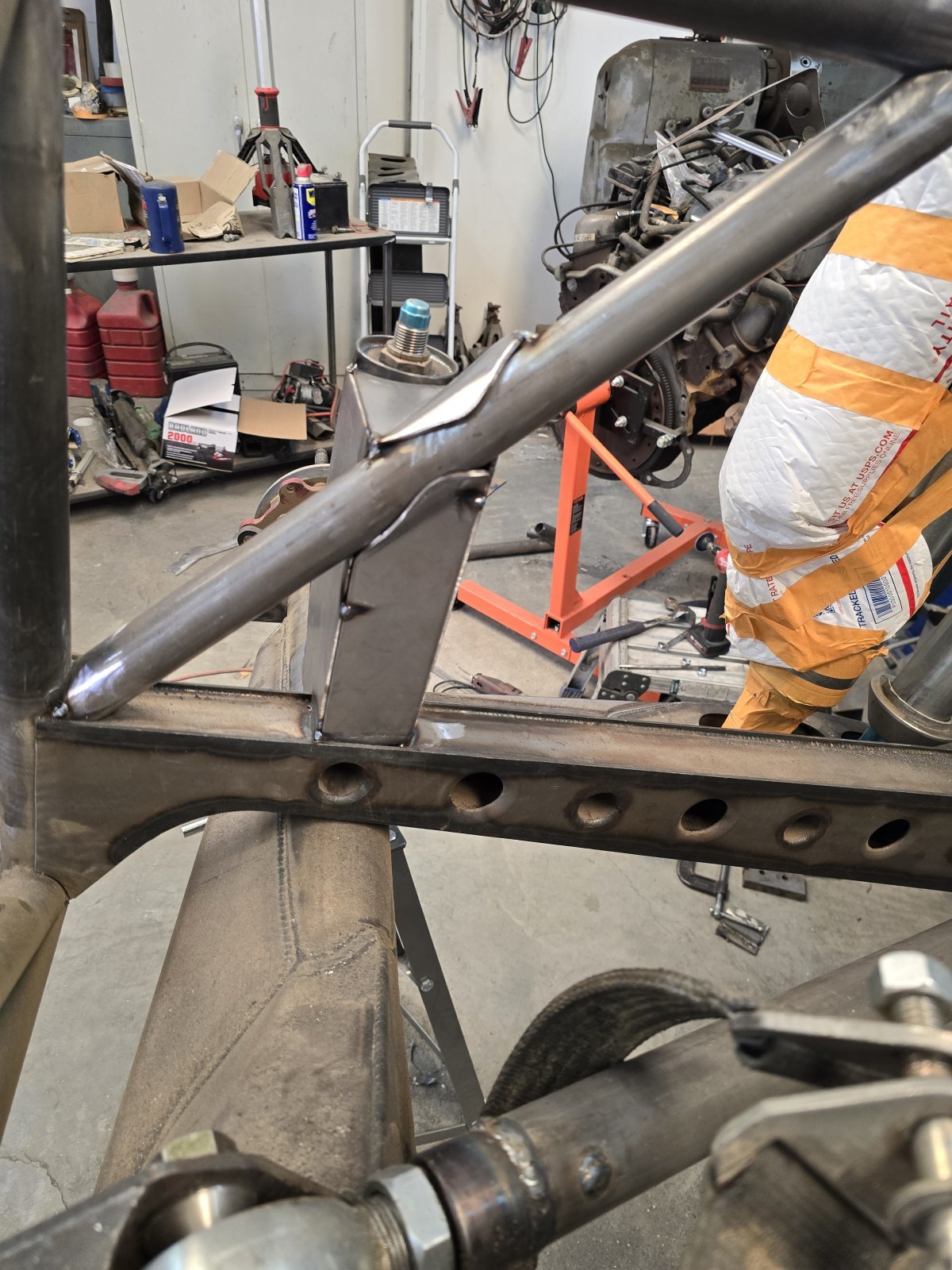

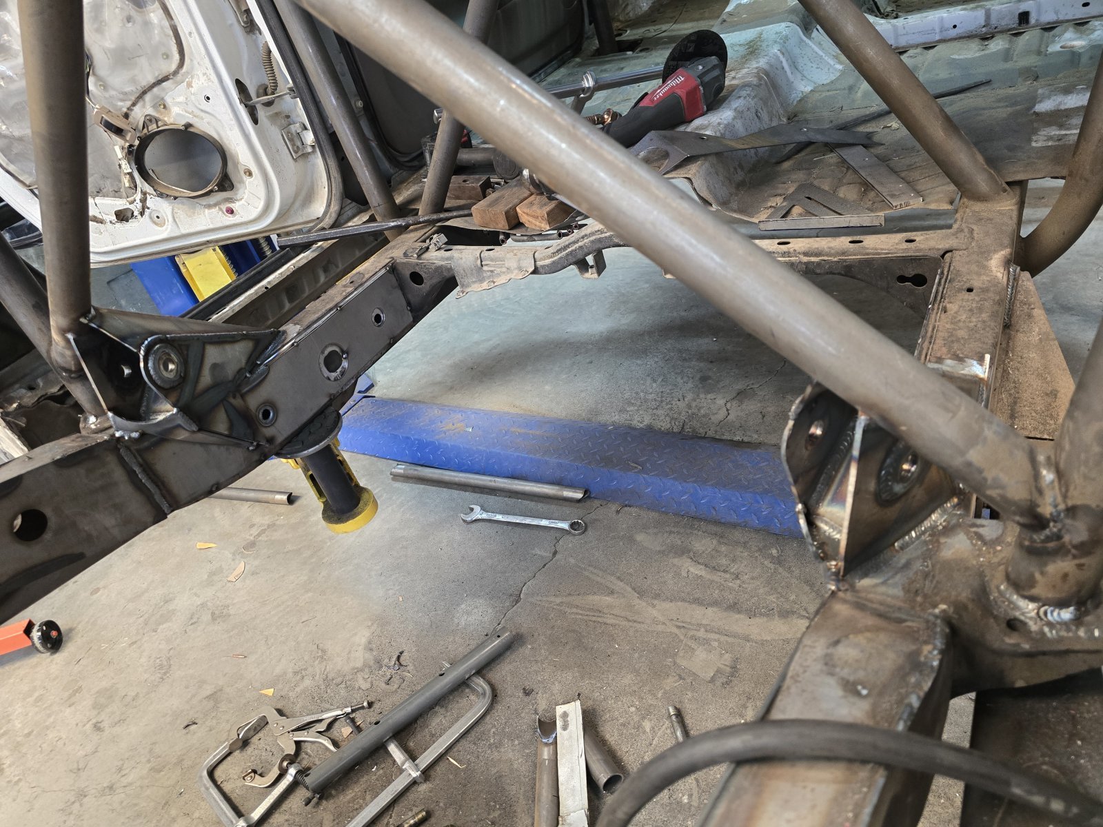

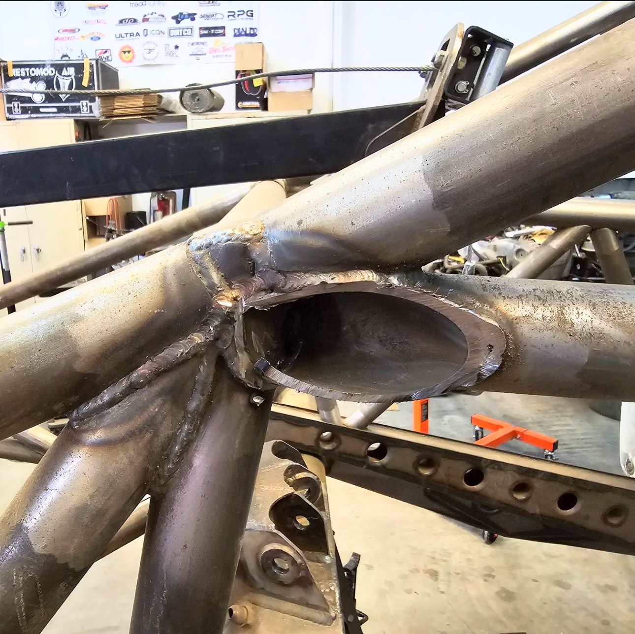

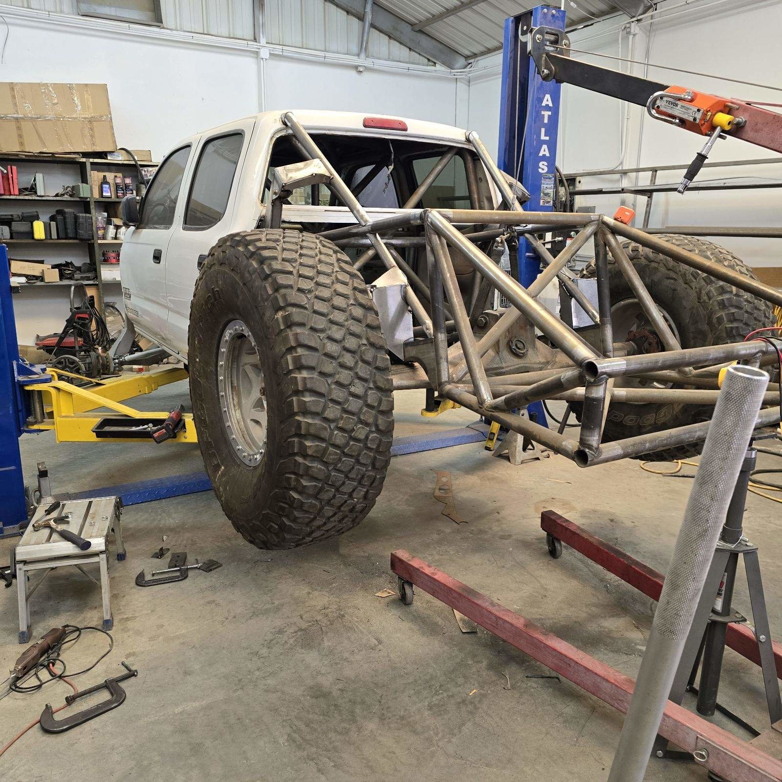

    Cut out that outside tube to realign shocks to be more vertical vs tilting inward (this also caused the bottom of the shocks to rub the frame rails since eveything was not pushed inward. No bueno)
    Would have been fine, but since the outside tube was ran and burned in first…. The inner tube (should have been ran out first) was coped to accommodate to the junction…
    So just cut everything out and start fresh with new tubes built around the shock mounts to assure nothing is hitting. Shock position is much more important than stringing tubes first.
    Tube layout will be the same, but outside tube that ran from the C pillar will no longer be there. Doesn’t give a benefit. Shock mounts and shocks will be prominent and then the interior tube structure will be replaced.

    Yup… would have been so easy to just cut that outter tube out to then push the tops of the shocks out more so they didn’t hit the tube… but then it just made 4 other problems..

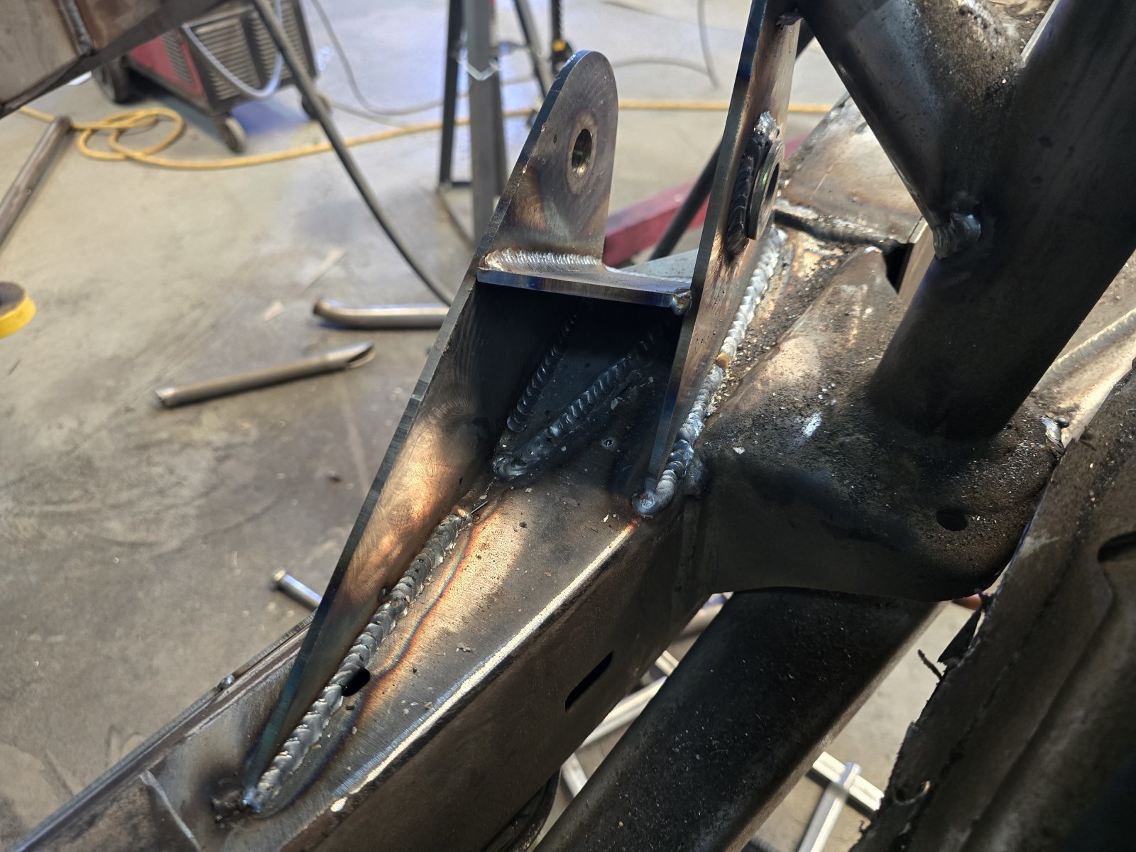

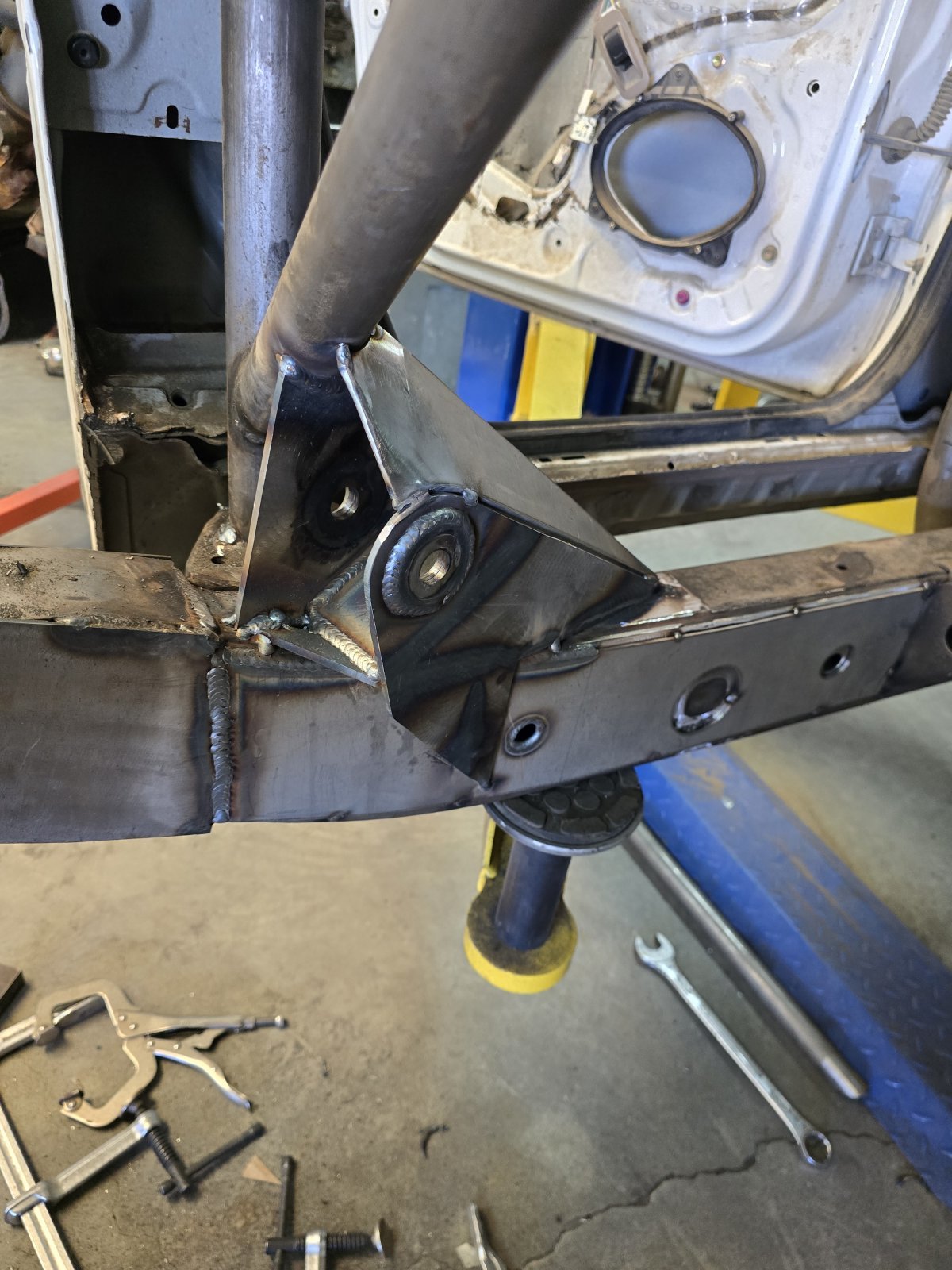

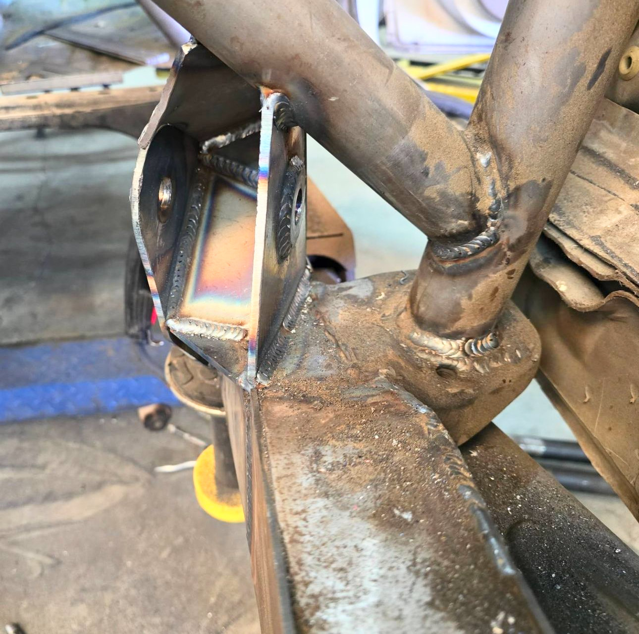

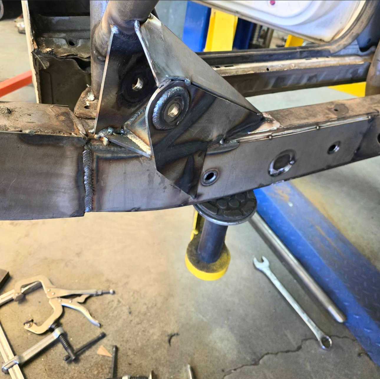

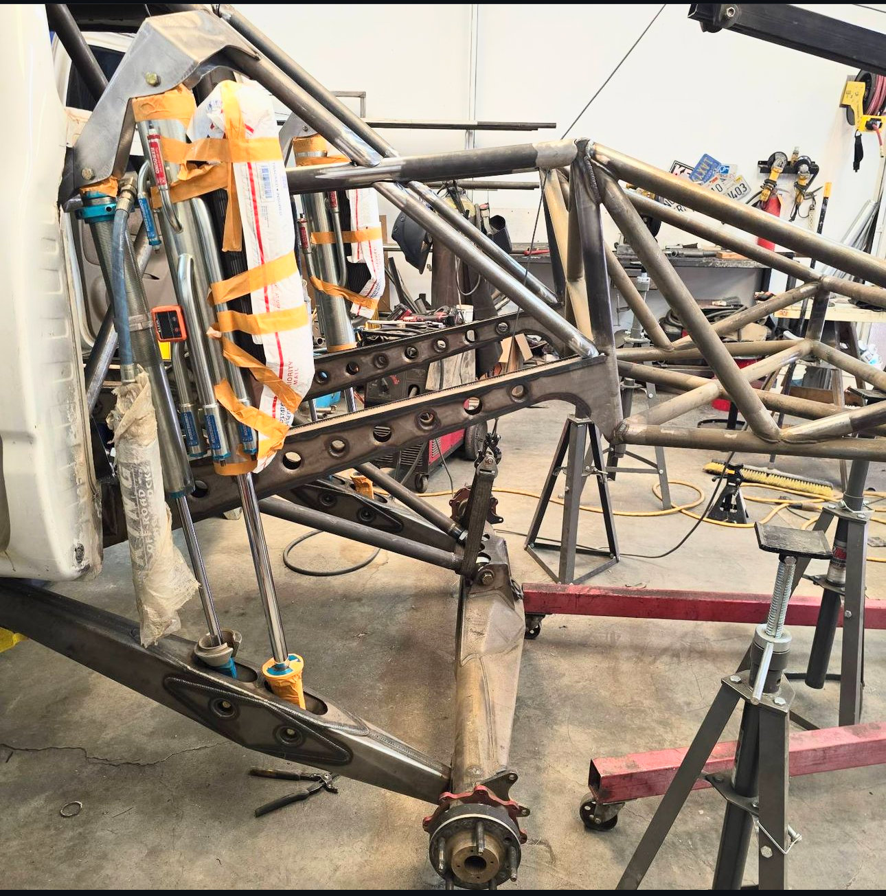

    Upper link mounts getting welded up

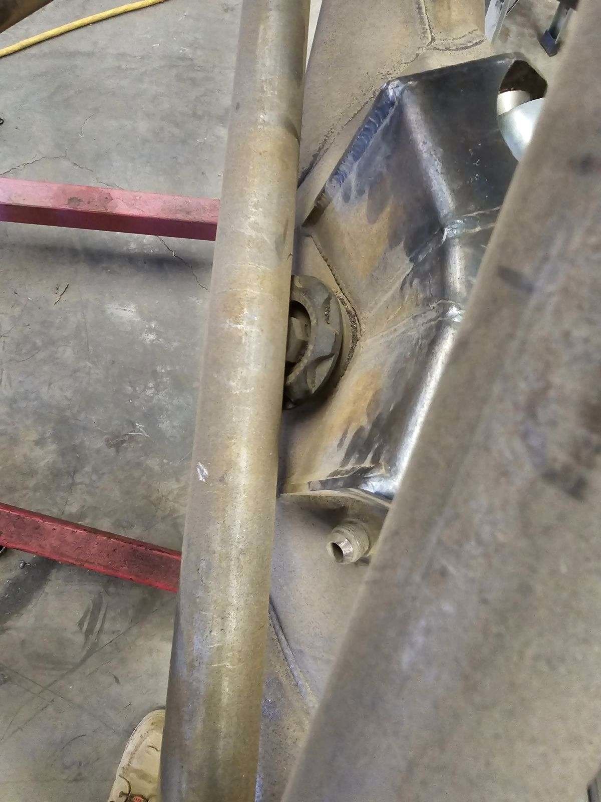

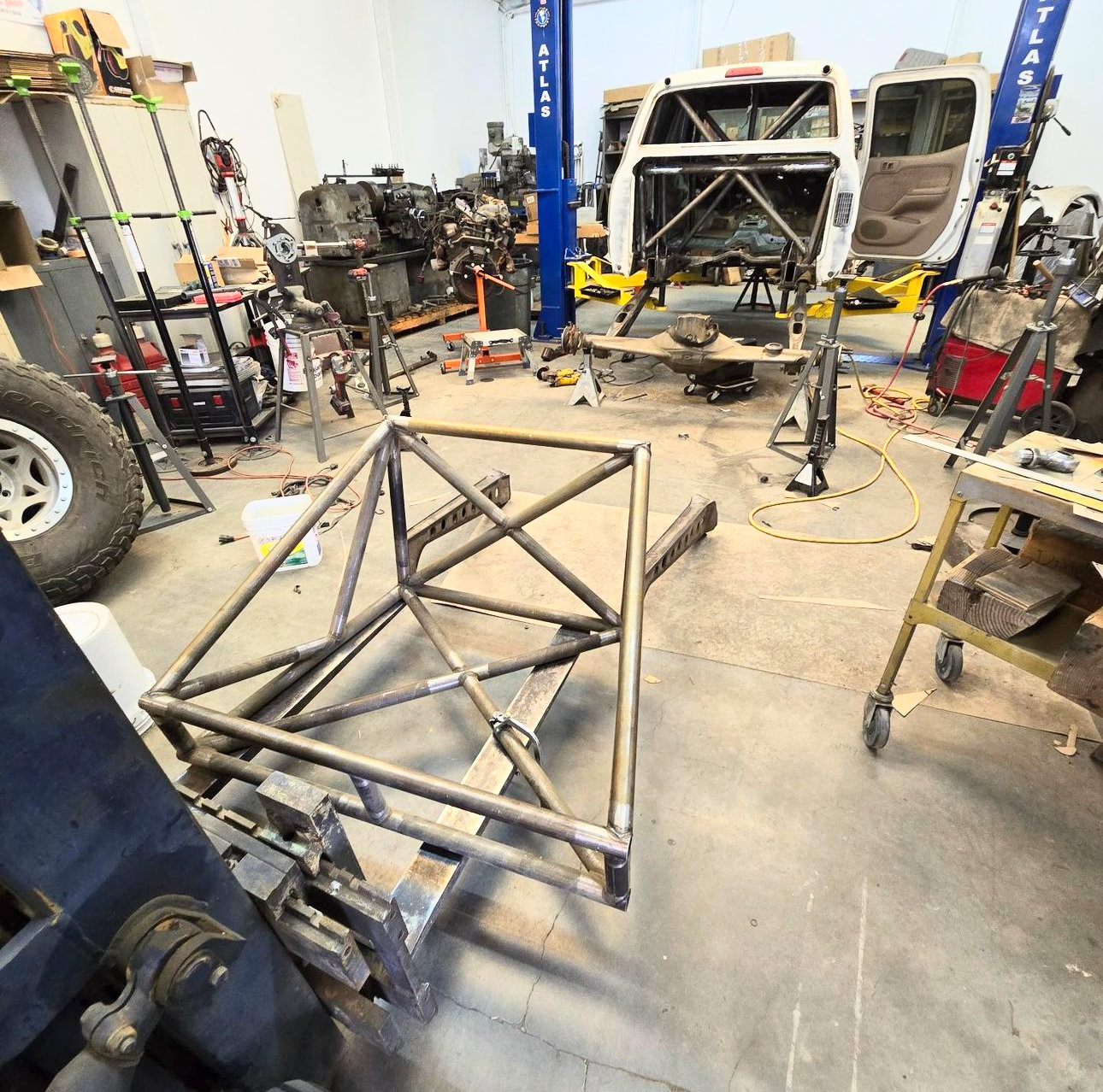

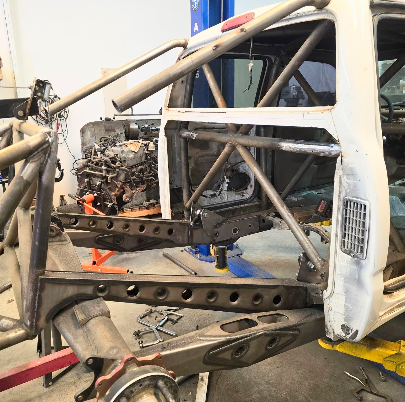

    Hits keep coming. Now that the suspension geometry is correct, with the pinion angle change the axle housing now hits the rear tube structure. Cutting the frame rails off and pushing them back an inch or two to allow clearance. Basically started all the way over at this point.

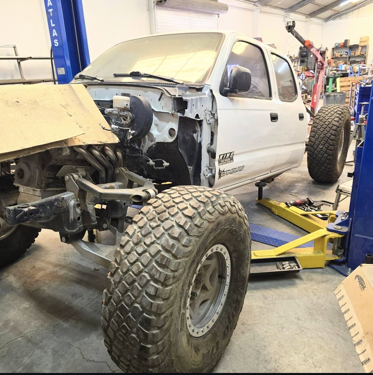

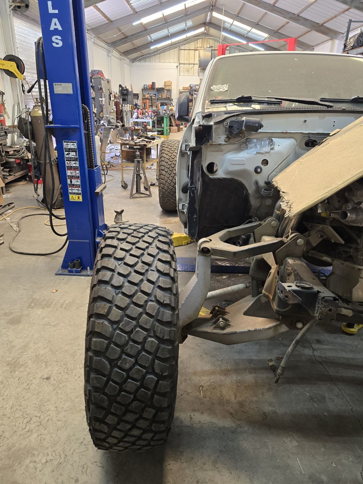

    Sneak peek of the new wheel tire combo to the left for yall.

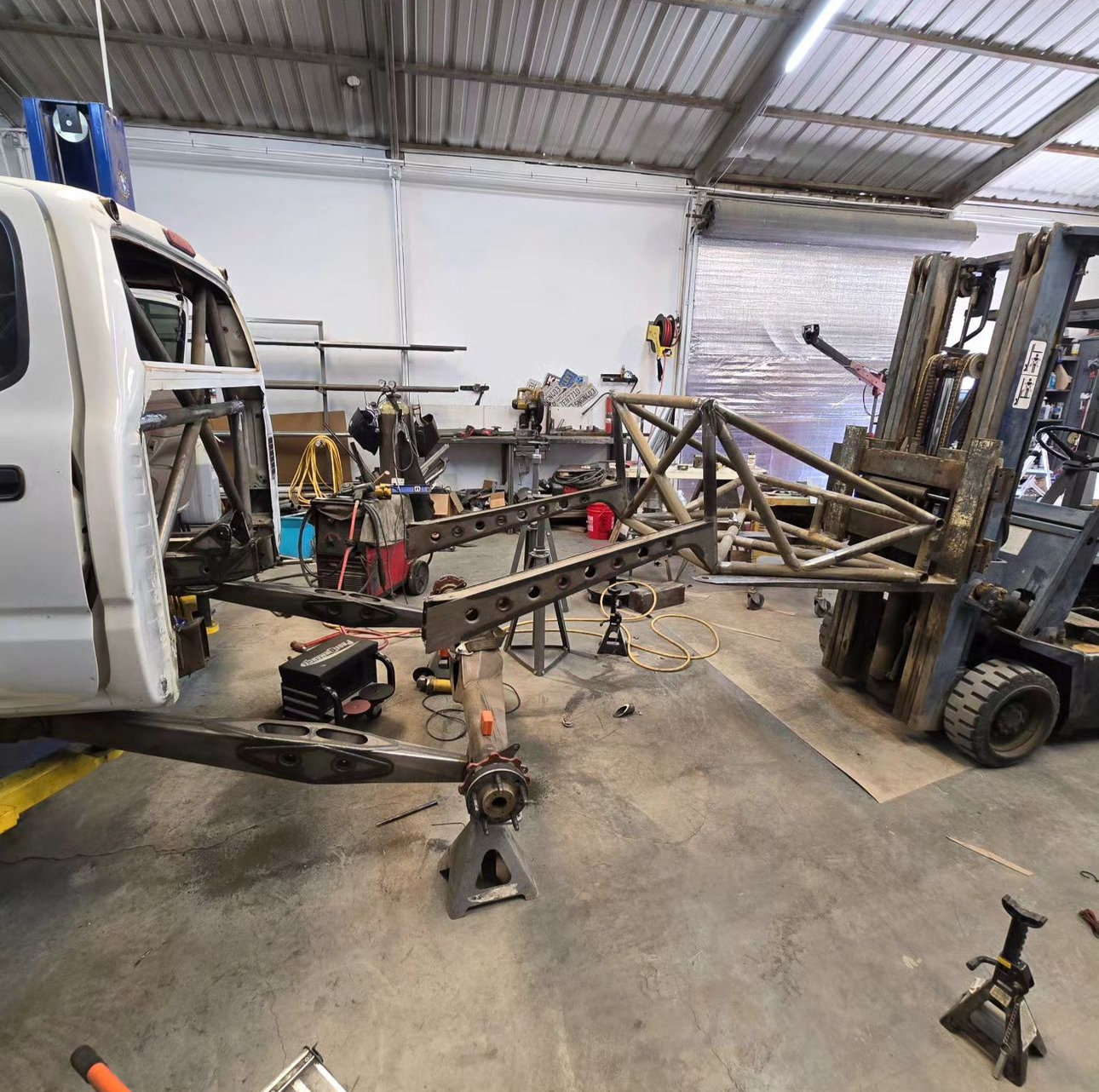

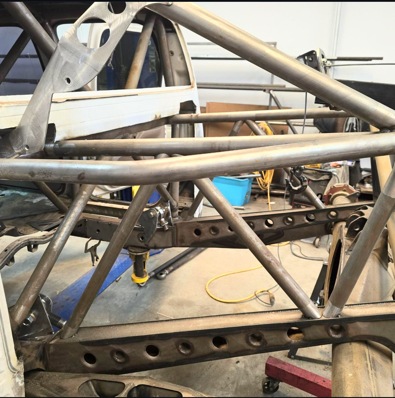

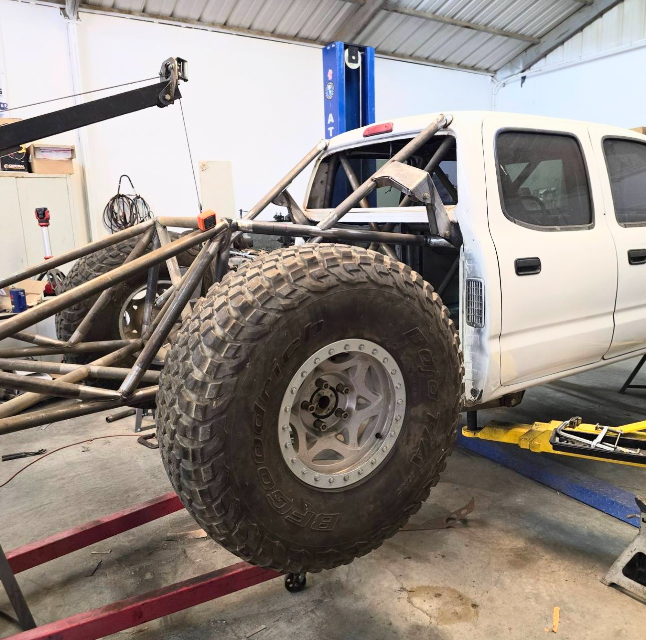

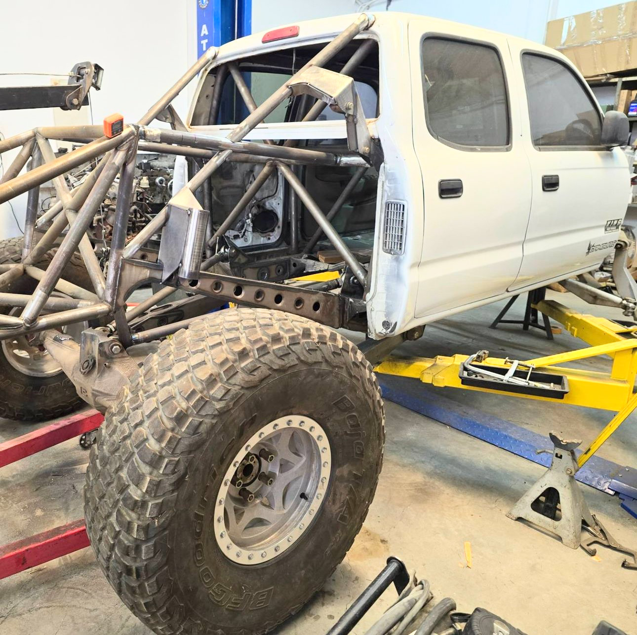

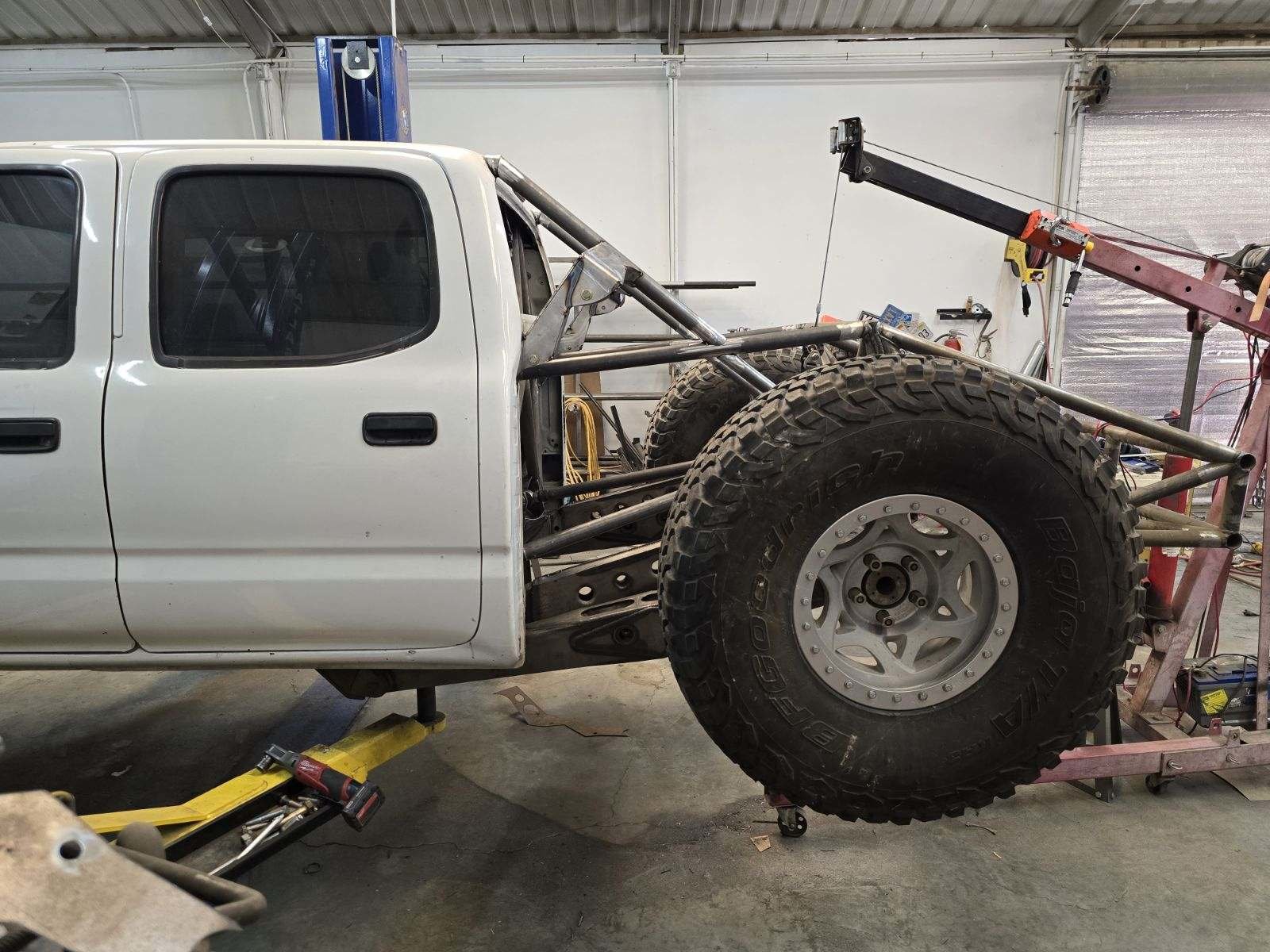

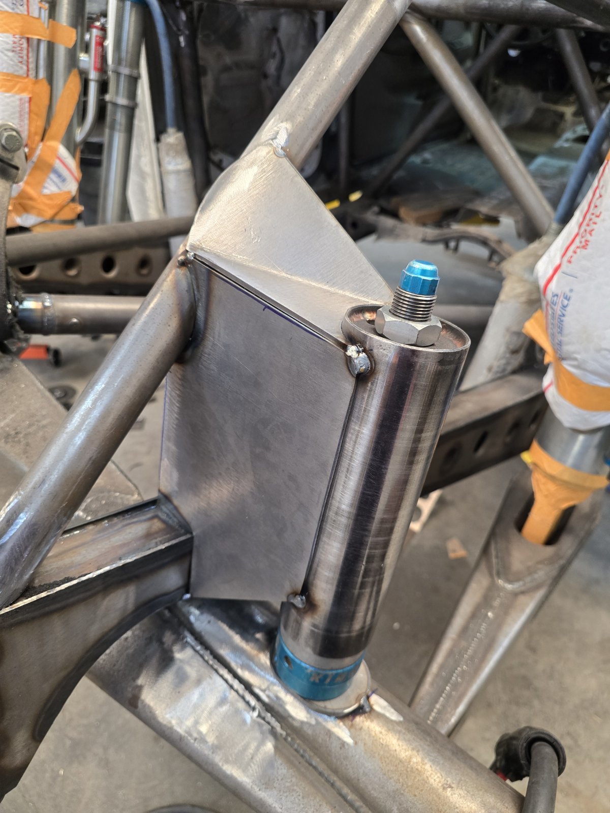

    Backhalf back on, down tubes ran, shock mounts getting started. 28.5” metal to metal.
    48” links, 16/18 shock combo.

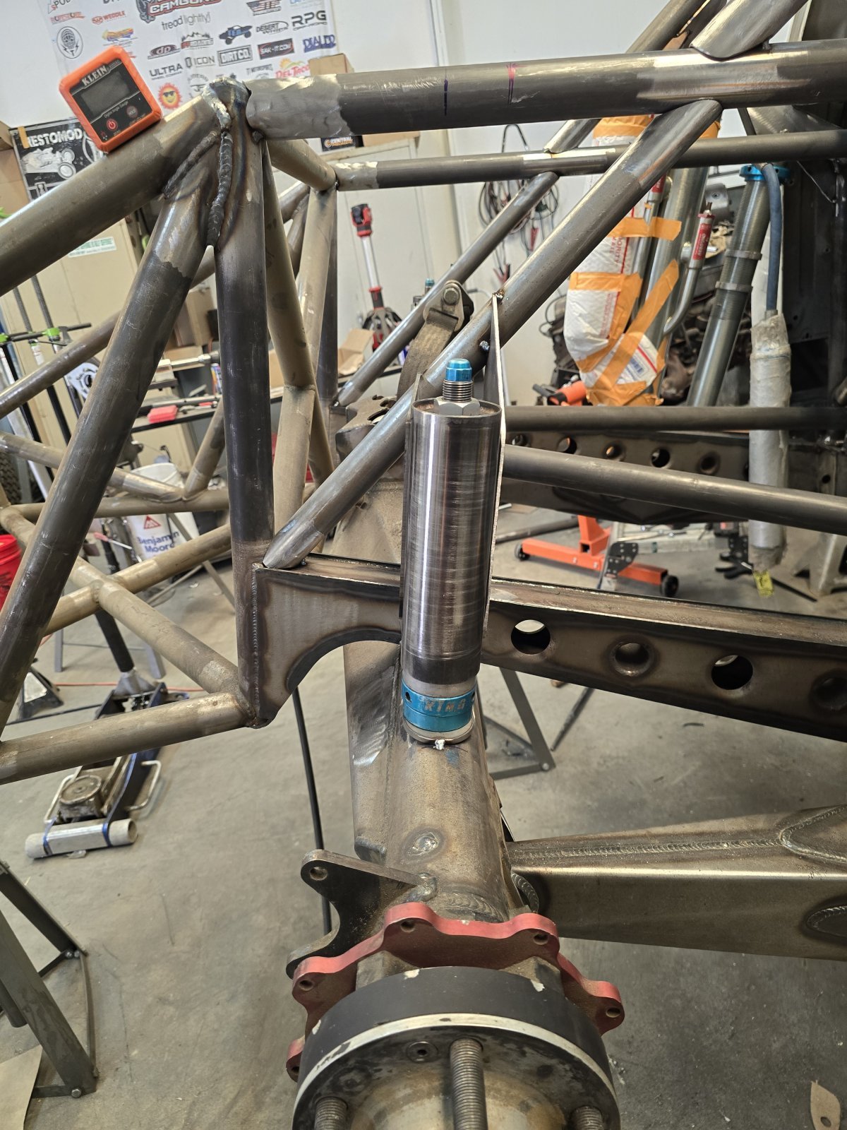

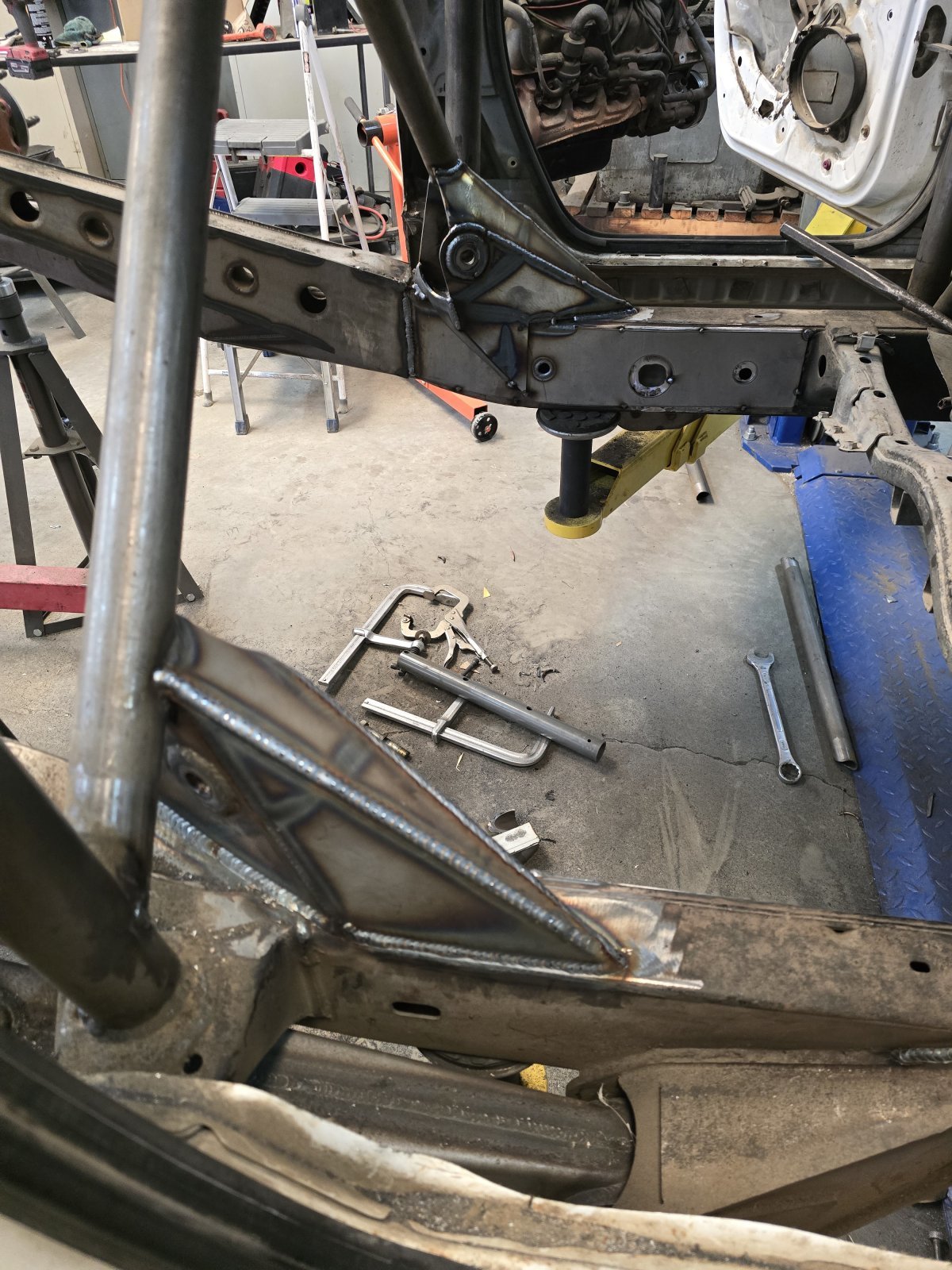

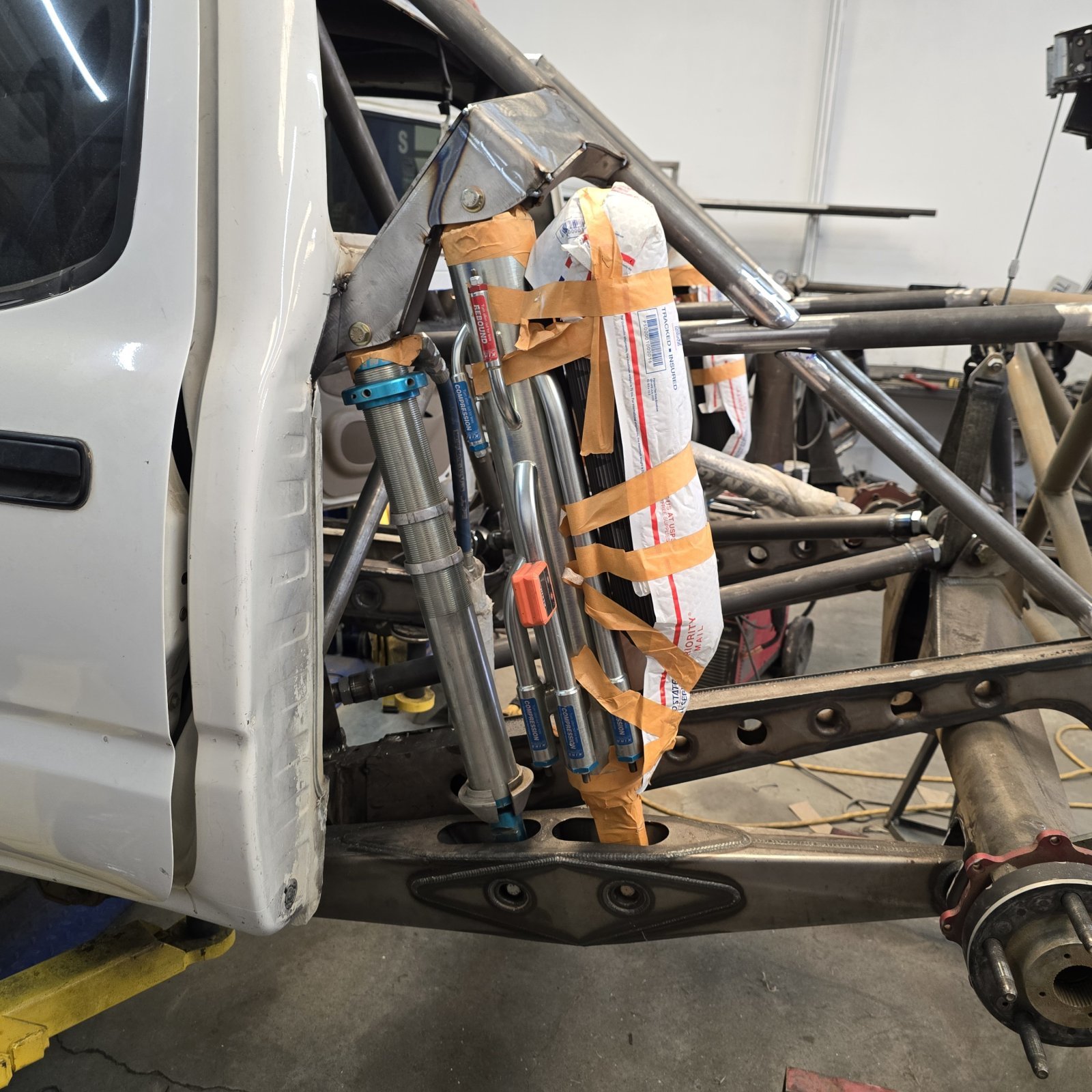

    Updates, Shocks mounted, bumps getting started, moving along. Wheels and tires get mounted next week then will have a 2 week break so he can work on a personal truck. After that, final welding, mounting rad and trans coolers, etc. Then on to the front.

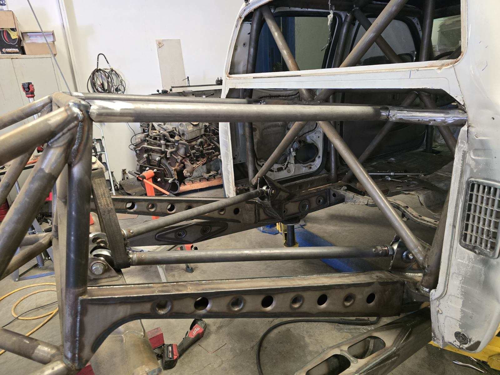

    Leave this here

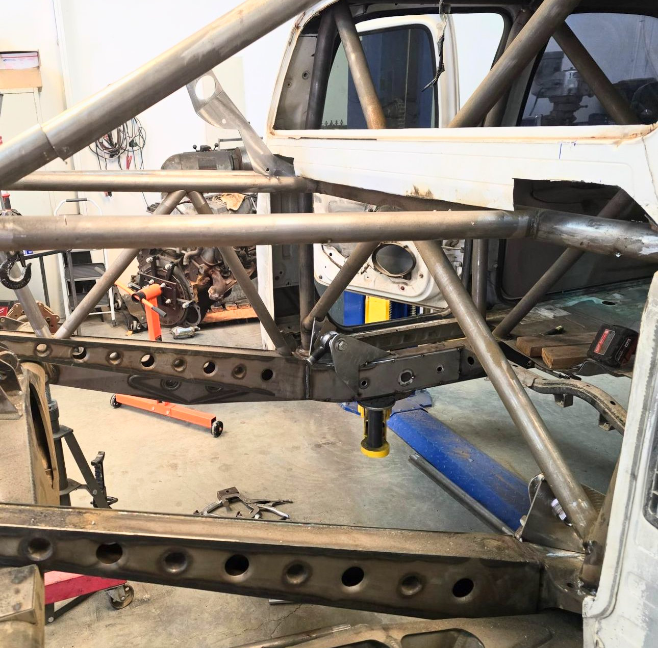

    Maybe a couple more

    Frame looks awesome
