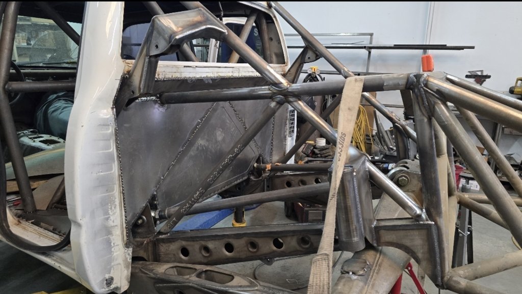

    Comin together. Rear end just needs final welding then panel in the firewall. Gonna get moved aside for a month so he can get his truck ready for desert season, and ill be on vacation till September so that works perfect.
    Next is turning it around, chop most of the frame off besides the main rails, plating the main rails, start running tubes for new crossmembers, mounts, etc.

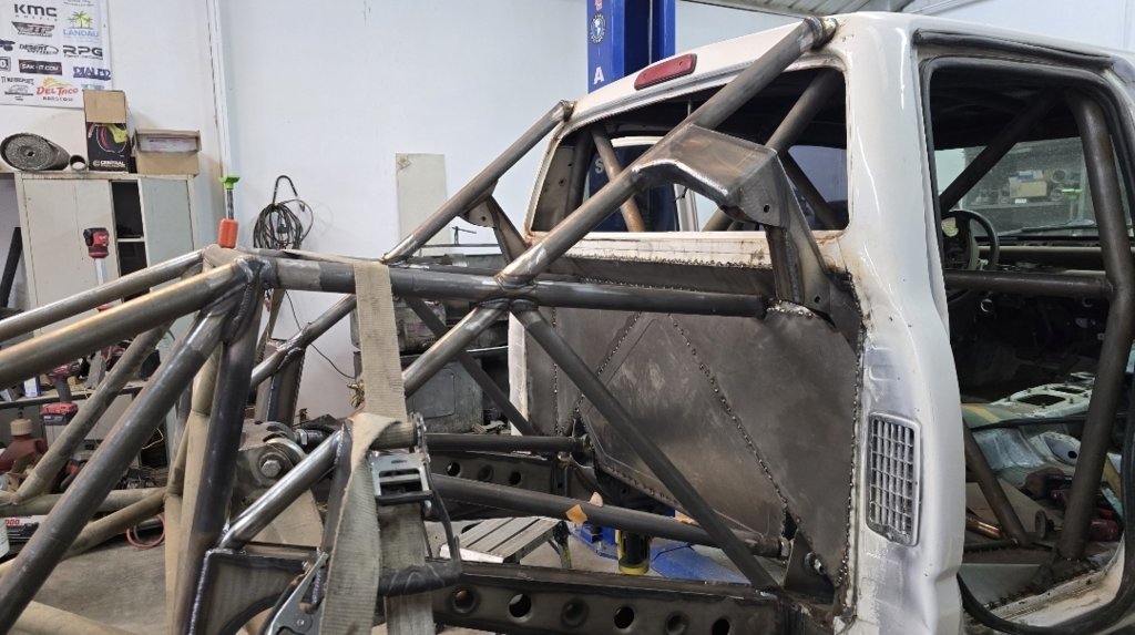

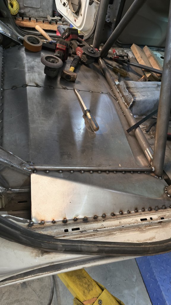

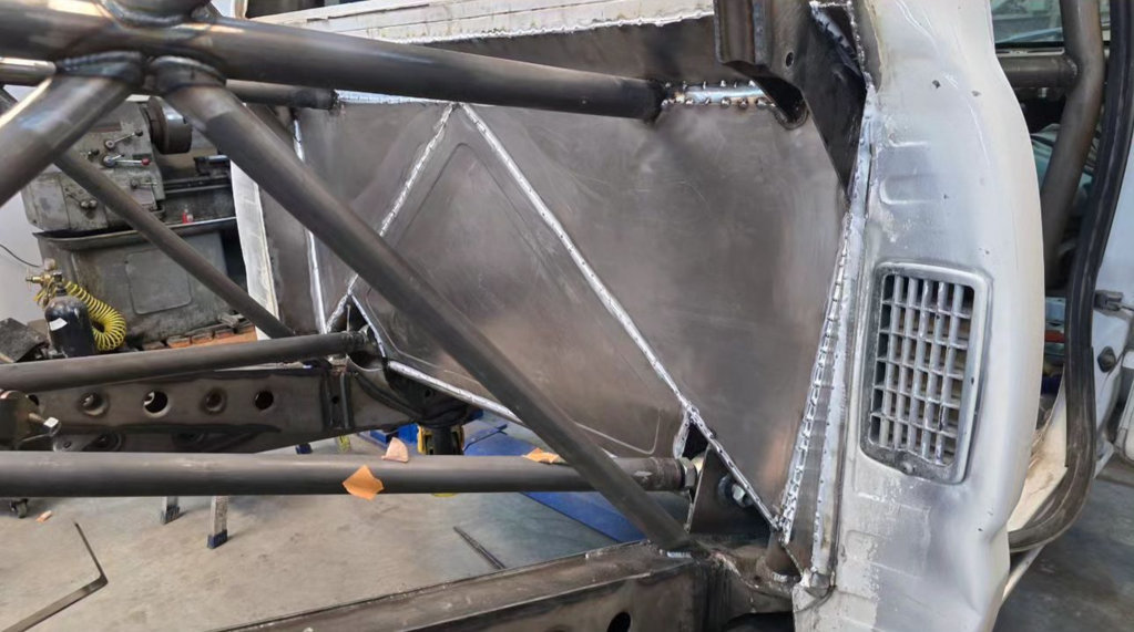

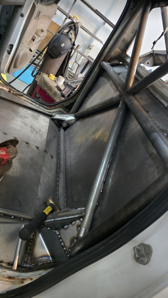

    Rear firewall going in.

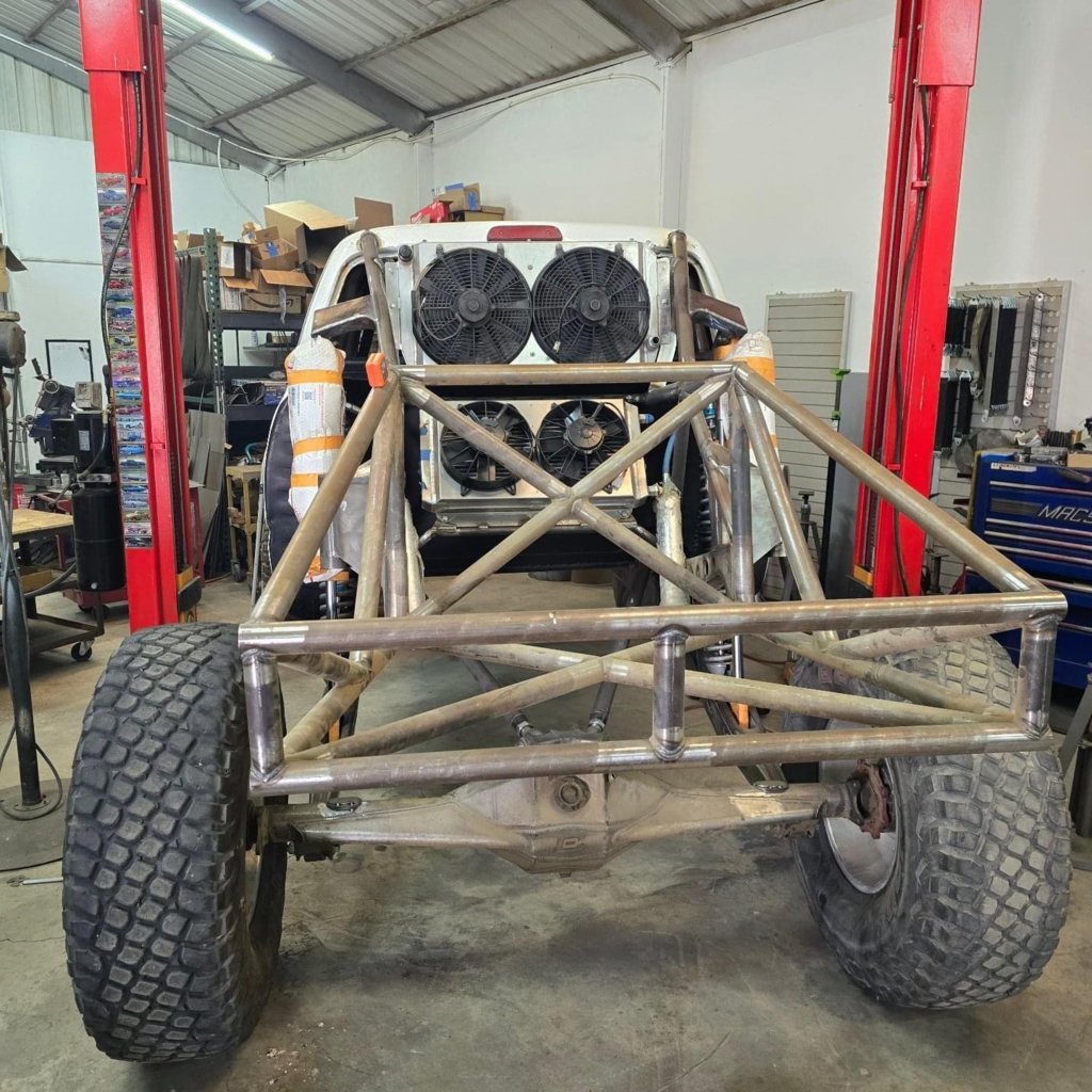

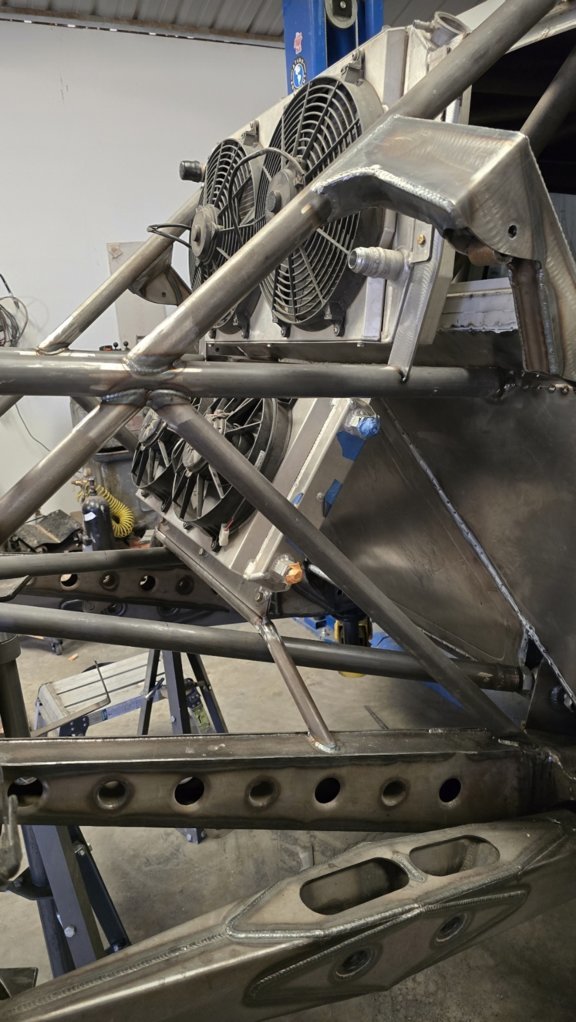

    Rear paneling getting final. Rear shock mounts and bumps are burned in. Next is rad mount and trans mount. Rolling along

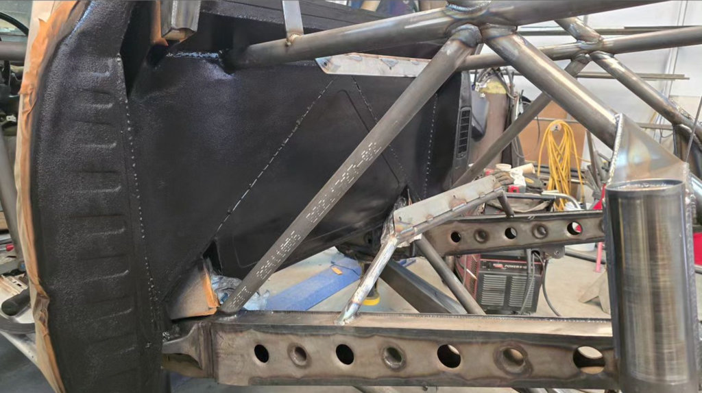

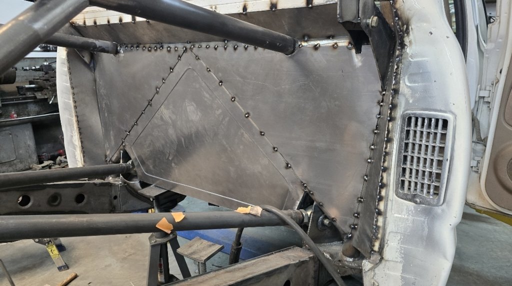

    Seam sealer going on. Won’t get painted till I get it back and we finalize any other tabs and brackets.

    Was it fully welded or just the tacs and then seam sealed?

    Tacs and seam sealed. Will get Line X’d once it’s back and final assembly.

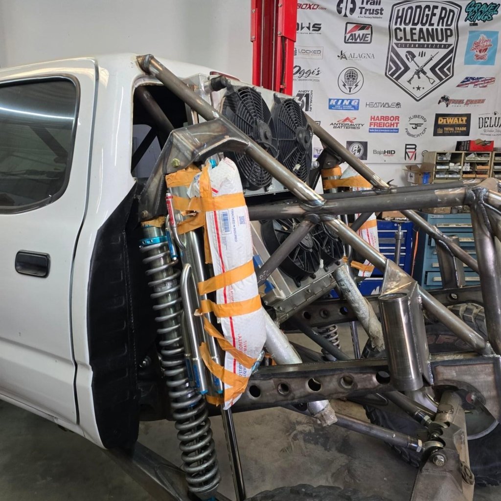

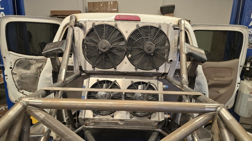

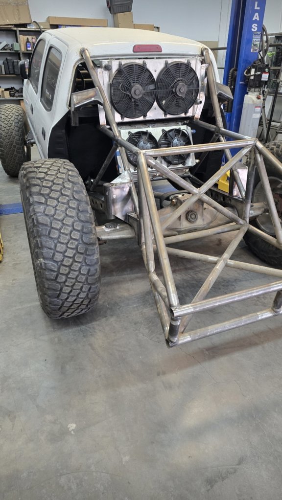

    Trans and rad coolers getting mounted

    Rear getting coated. Trans cooler and rad mounts welded in. Also have 4 link bolts shanked correctly.

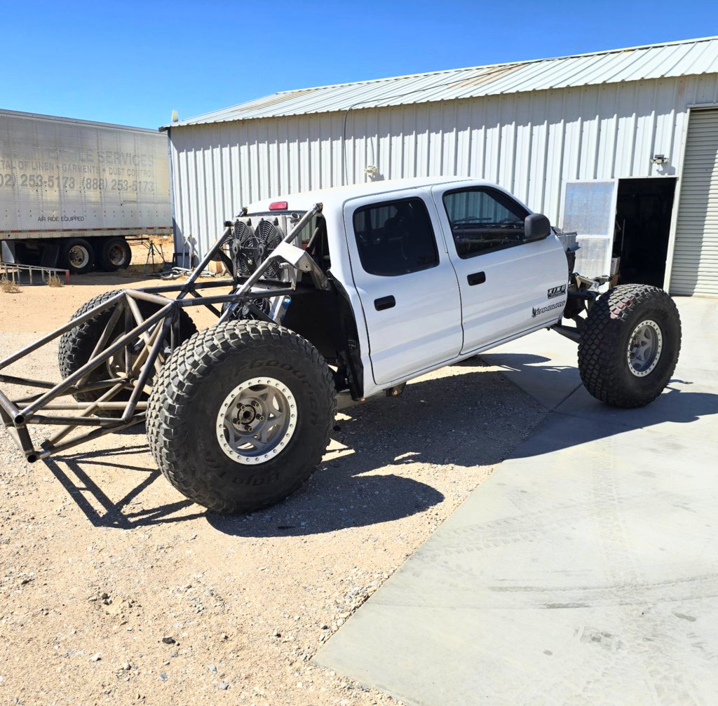

    Rear is complete. Shocks go on next week then it gets turned around to shave the frame down and get it plated and get the LS and turbo 400 mounted in. Then on to running tubes for the engine cage.

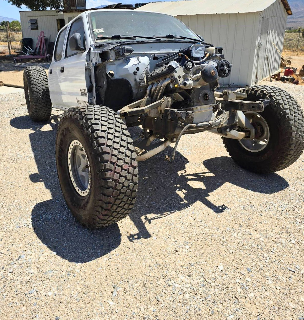

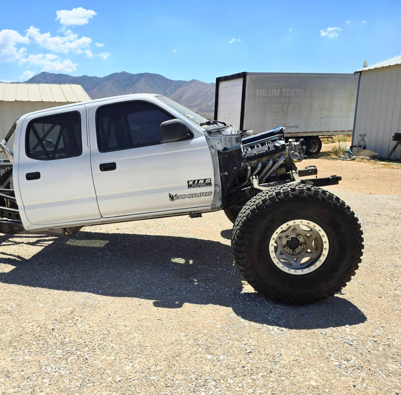

    Small update. Truck rear end is officially on its own weight and finished. Turned around to start on the front. Ride height needs some love but that can be addressed later.

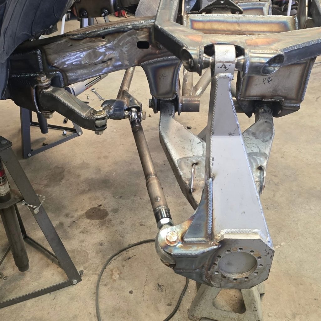

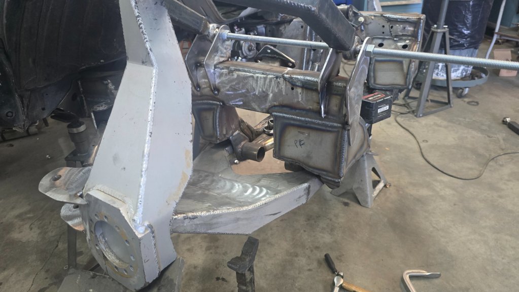

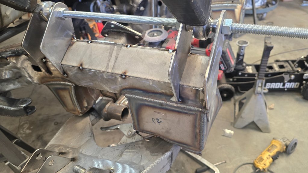

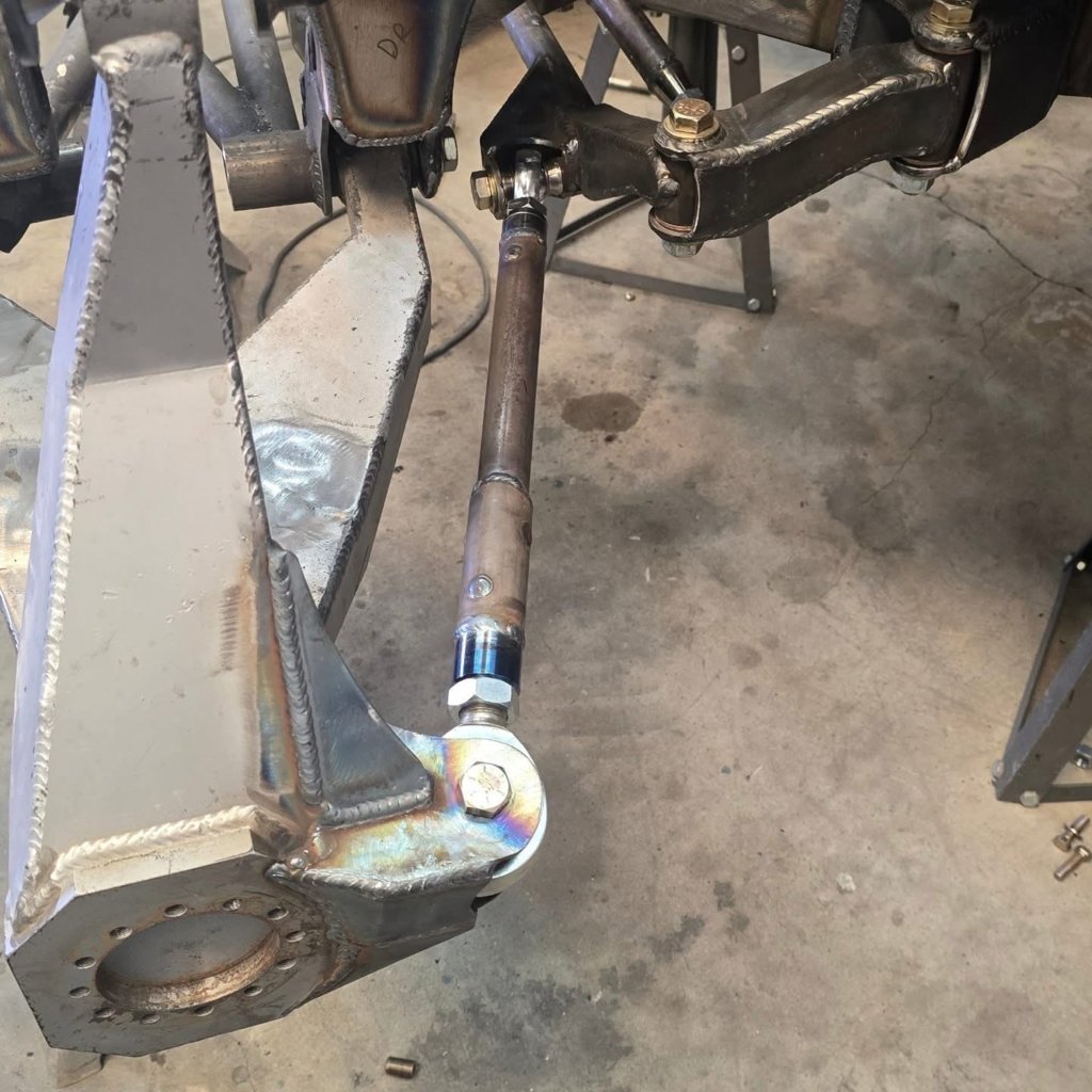

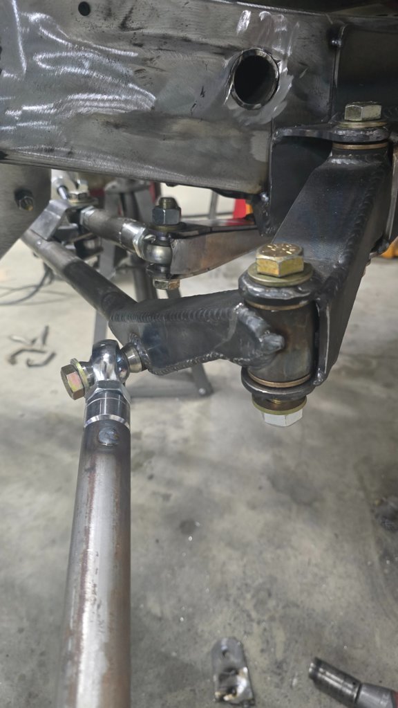

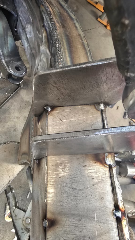

    Updates

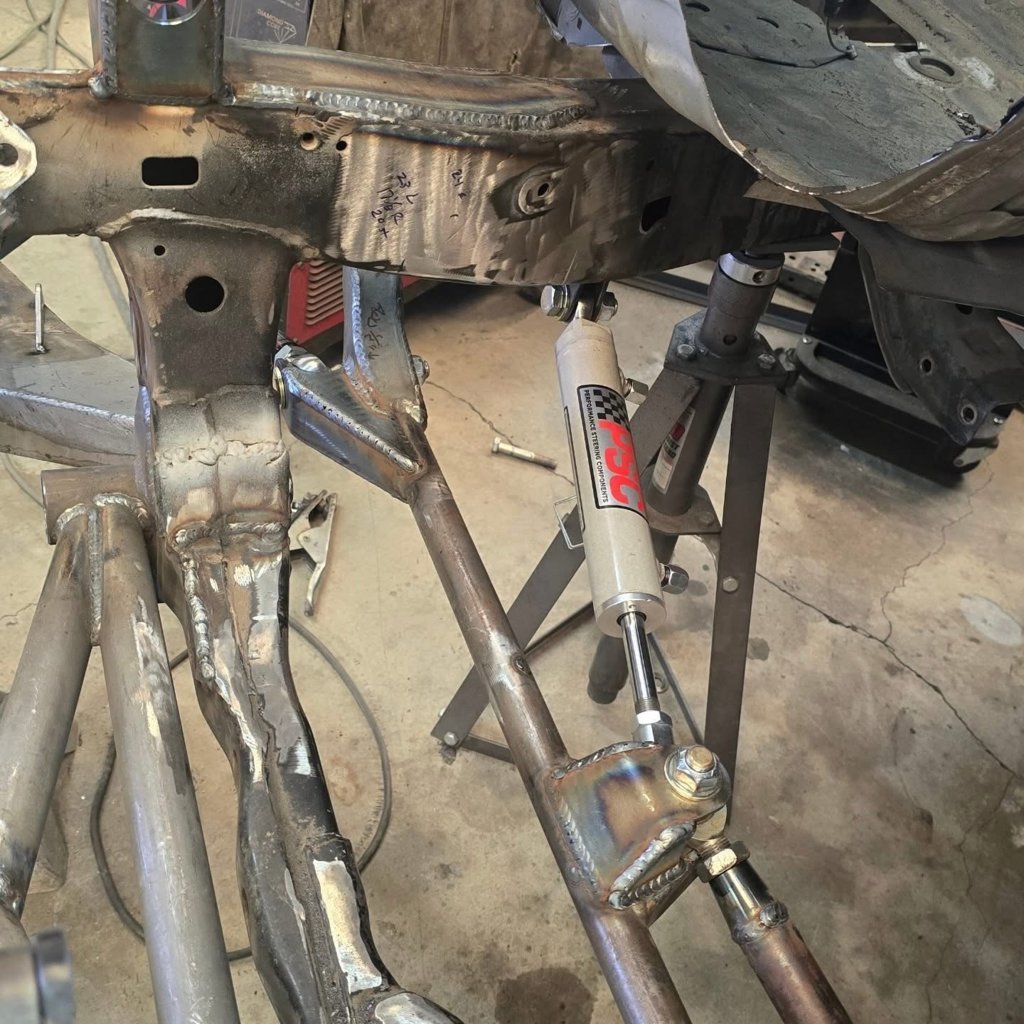

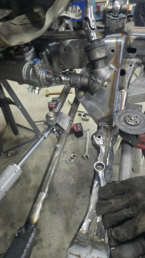

    "Ok back on the truck. Got motor and trans mounted up. Got steering figured out just need a few more parts final welded and inner tie rods double sheared.
    Bronze bushings for pivots, PSC C10 steering box w/ ram and Nissan pathfinder steering gear transfer. I also switched to a 1" Outer heim to get a little more travel out of this truck. Tube through frame above driver swinger is to access the upper steering box bolt as its close to the frame and can get the bolt in due to length and angle. This is a kit that i will offer as a rack delete swing steering kit for these 1st gen tacos/3rd gen 4runners.
    Motor and trans going back in so I can start on the engine cage and shock mounts after I do a little more clearance to achieve more travel since the truck has swing steering and getting 4.0s up front."

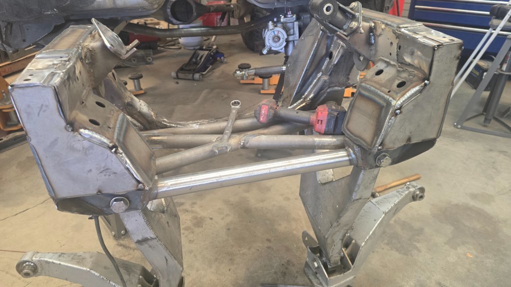

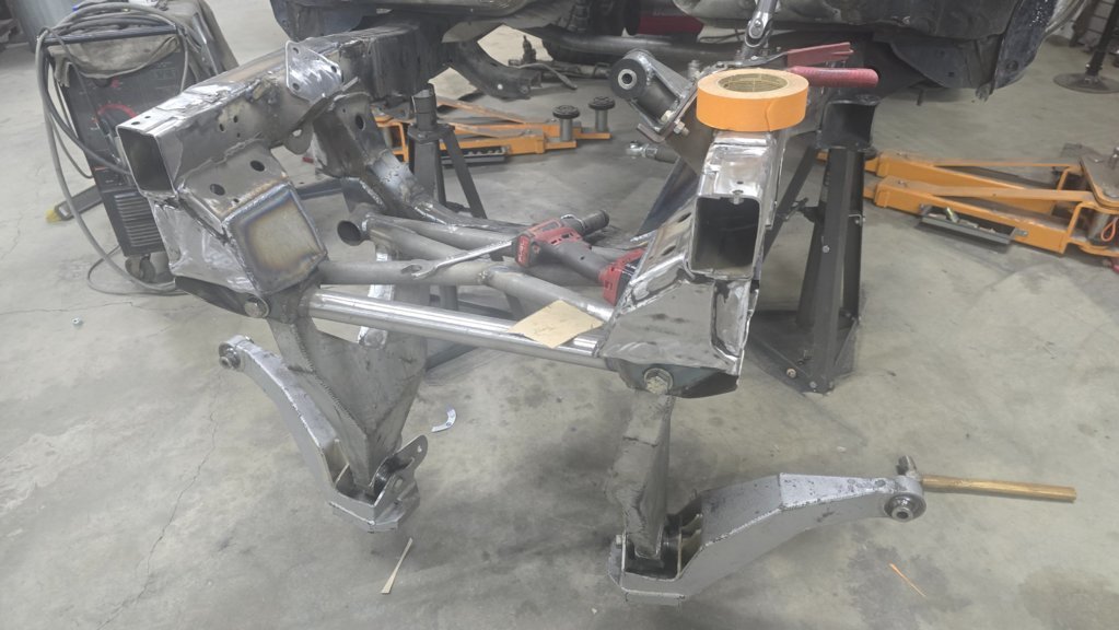

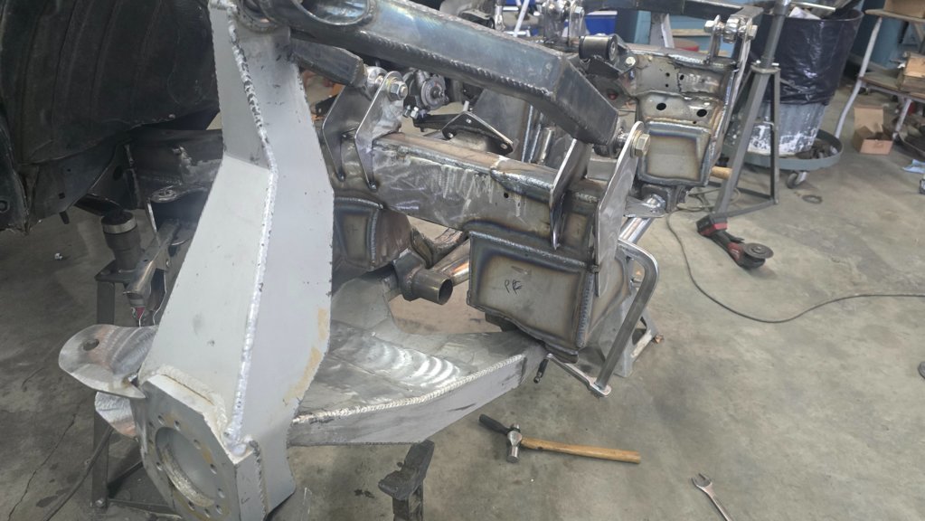

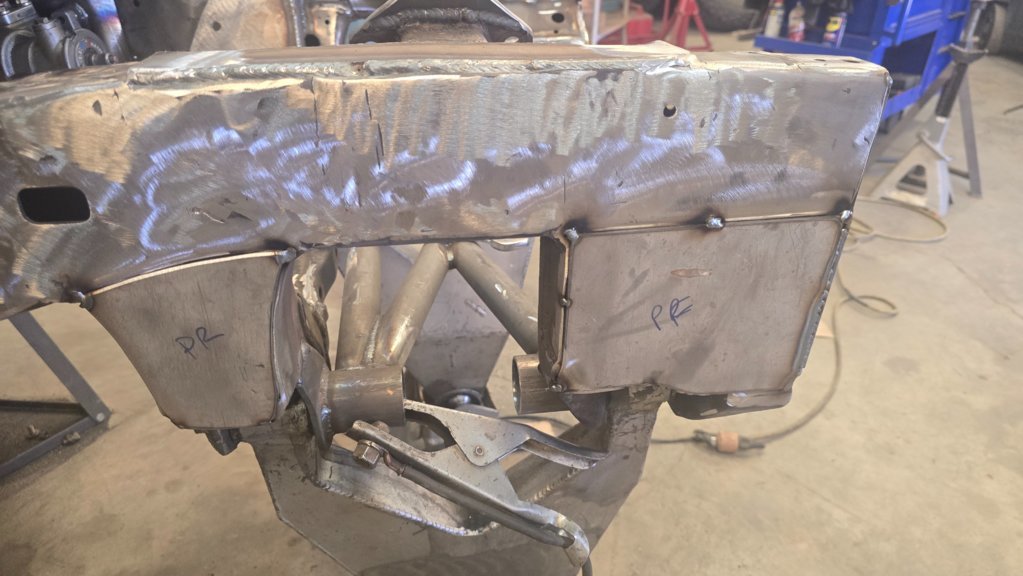

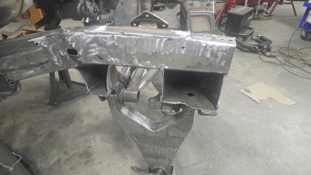

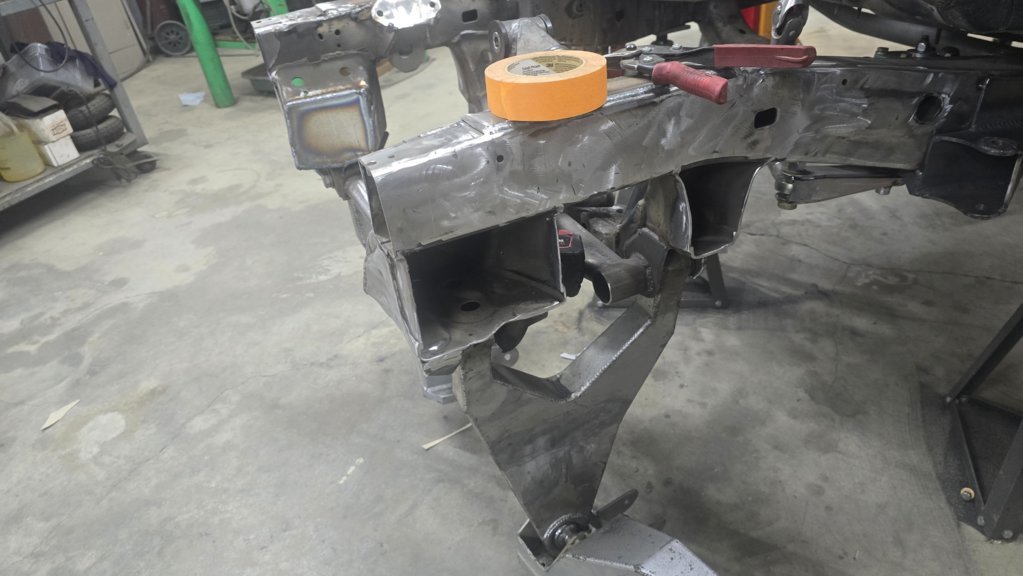

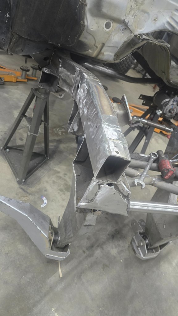

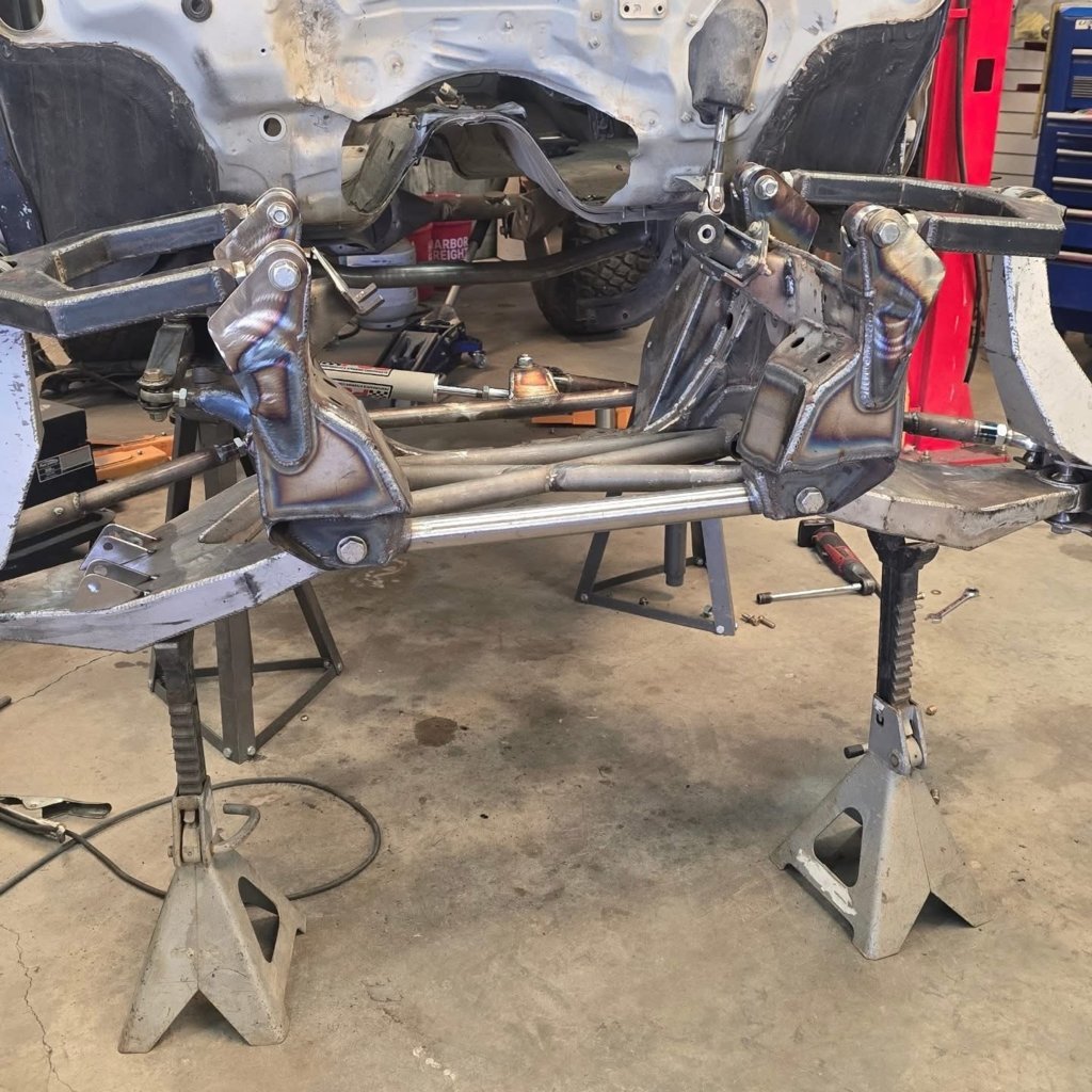

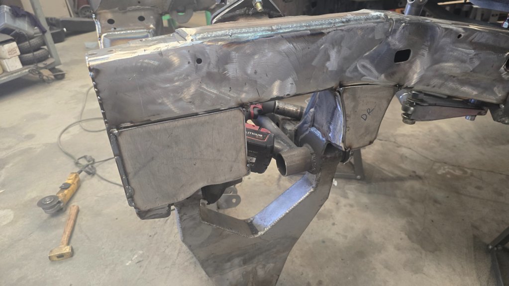

    Chop chop, shaving the frame down for clearance on everything then finalize upper arm mounts then start running tubes.

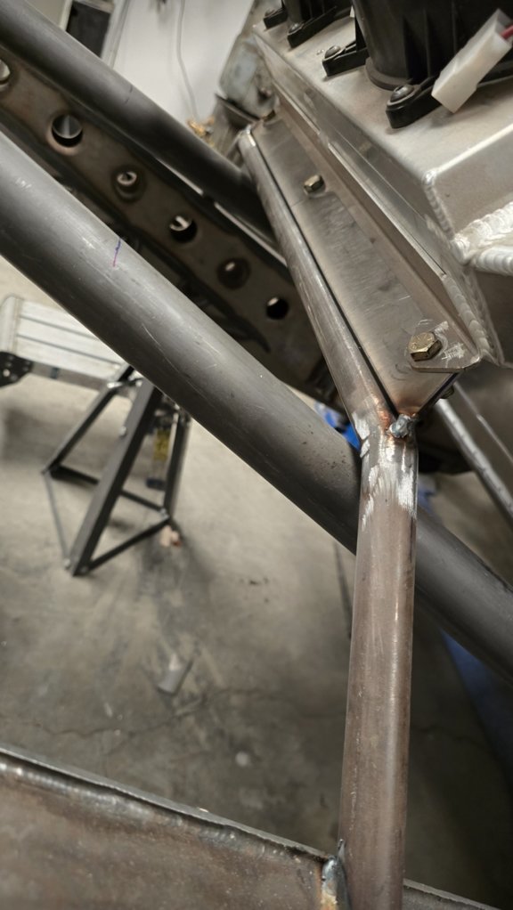

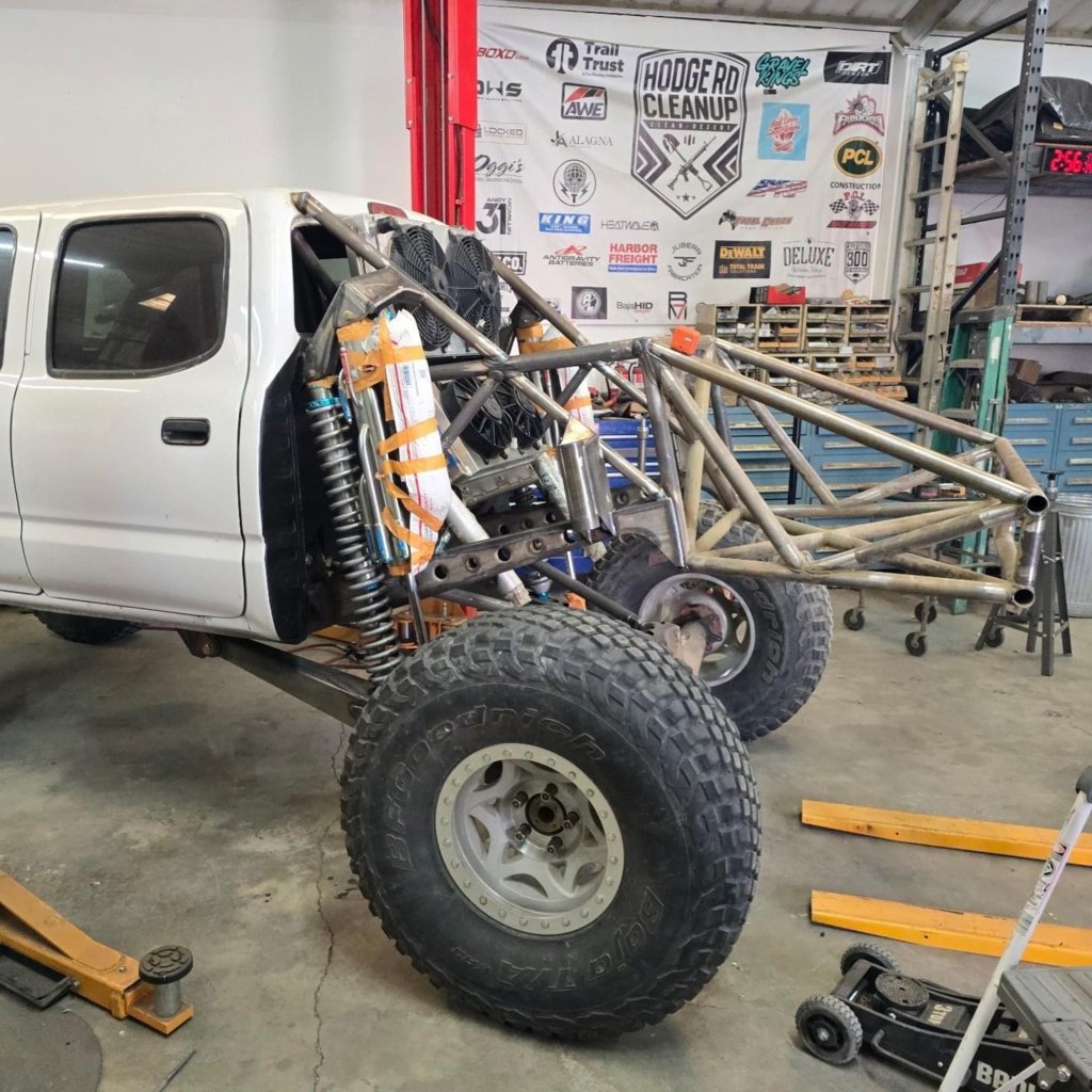

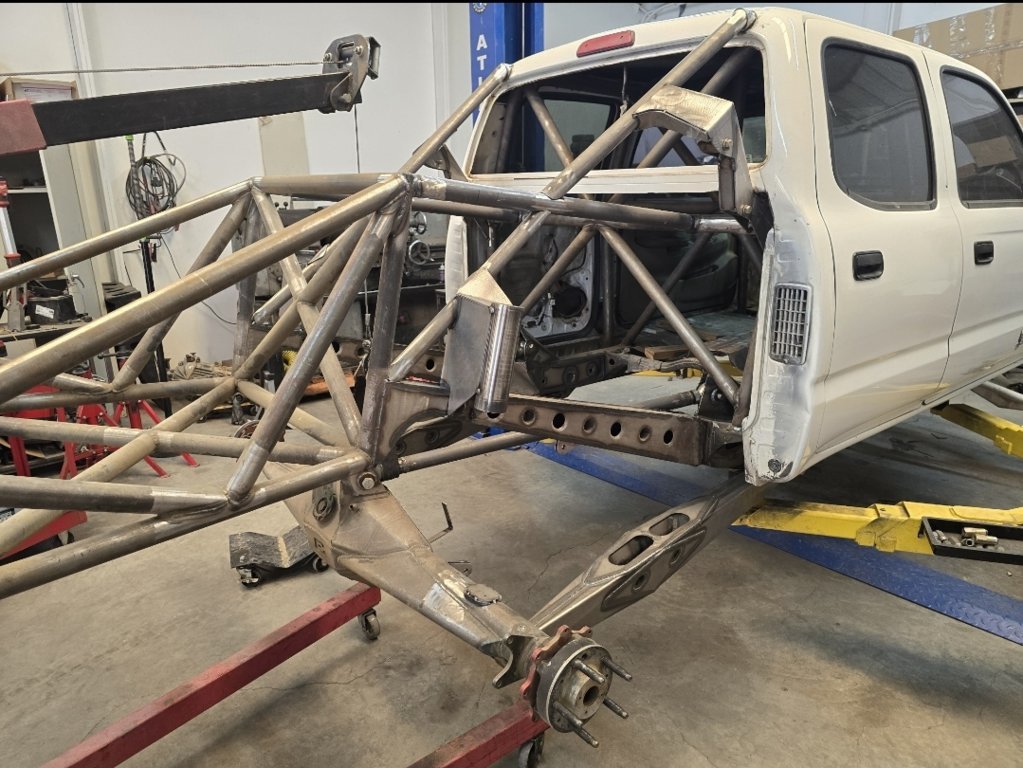

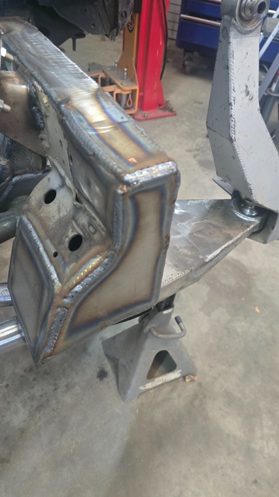

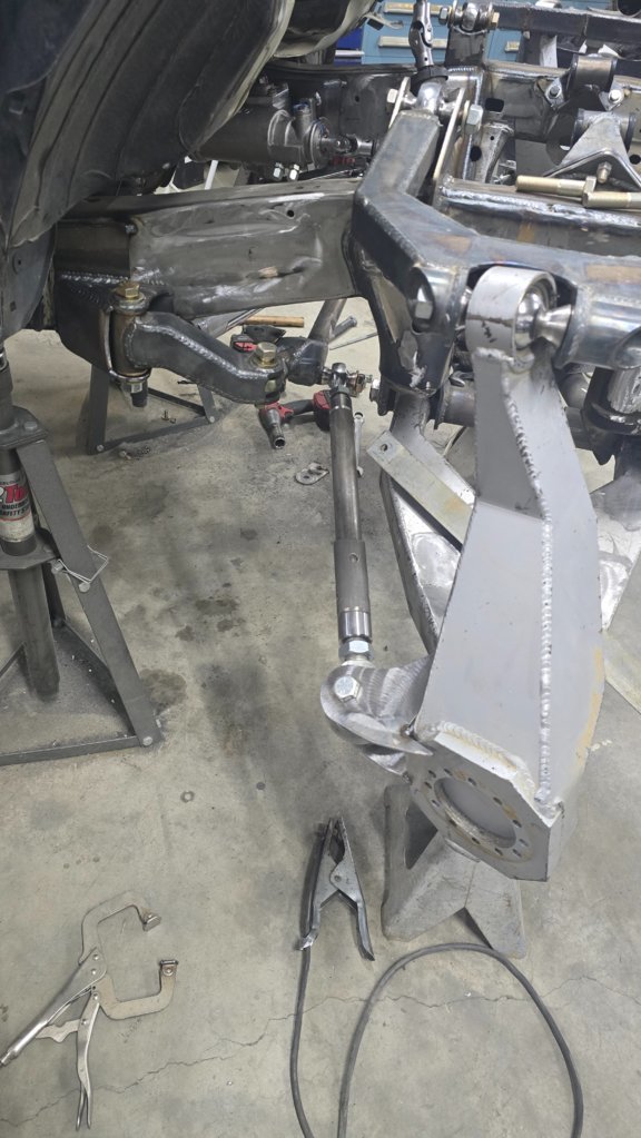

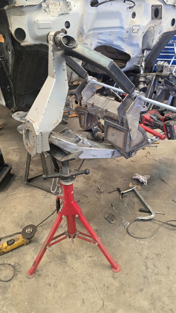

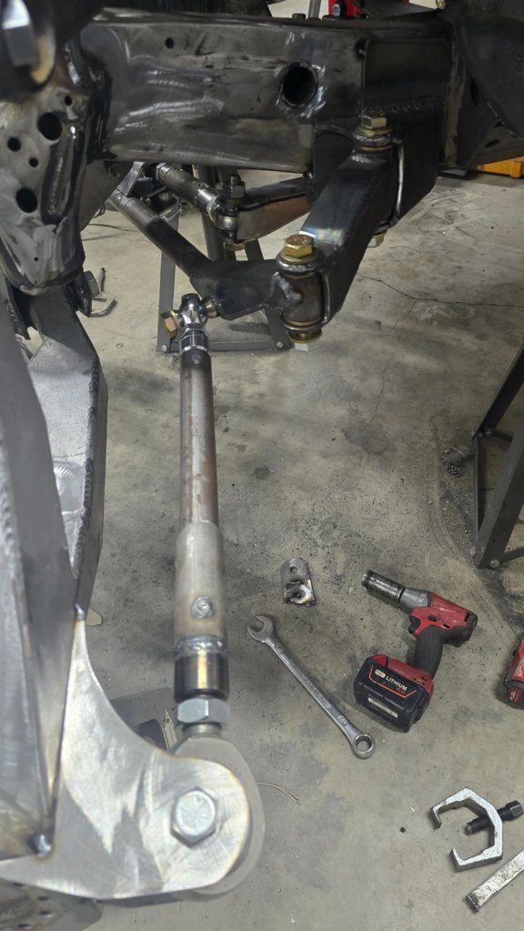

    Ok steering is done, besides gussets on steering tabs on knuckles. Just need to bolt it all back on.
    Notched the frame for plenty of clearance to uca at full droop where uniball stops it, so full metal droop. Plus I carried same angle and made new UCA tabs to land on new angled frame.
    Front end should be strapped at 20" travel with 10 up and 10 down so itll work awesome, once whole truck is tuned and shocks are dialed in. Tomorrow steering and engine back in, so I can confirm everything clears lock to lock bump to droop.

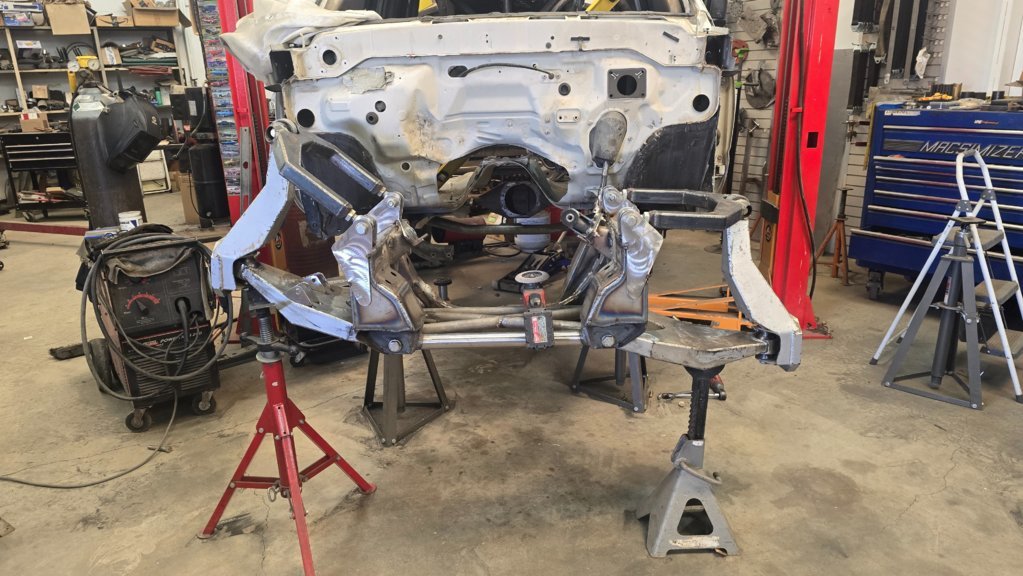

    Moar

  18. Jul 21, 2025 at 5:28 AM
    #678
    Bandido
    Bandido Engine...er
    Sep 4, 2017
    #229072
    2,365
    Alex
    Lexington, KY
    2003 Tacoma DC
    thats a serious swingset!
    what steering box are you using?
  19. Jul 21, 2025 at 9:48 AM
    #679
    FlapJack935
    FlapJack935 [OP] i member
    Nov 25, 2013
    #117294
    3,198
    Jack
    Abq New Mexico
    Wannabe Trophy Truck
    Sick Gnar Trophy Truck Tacoma and King Ranch Raptor Killer

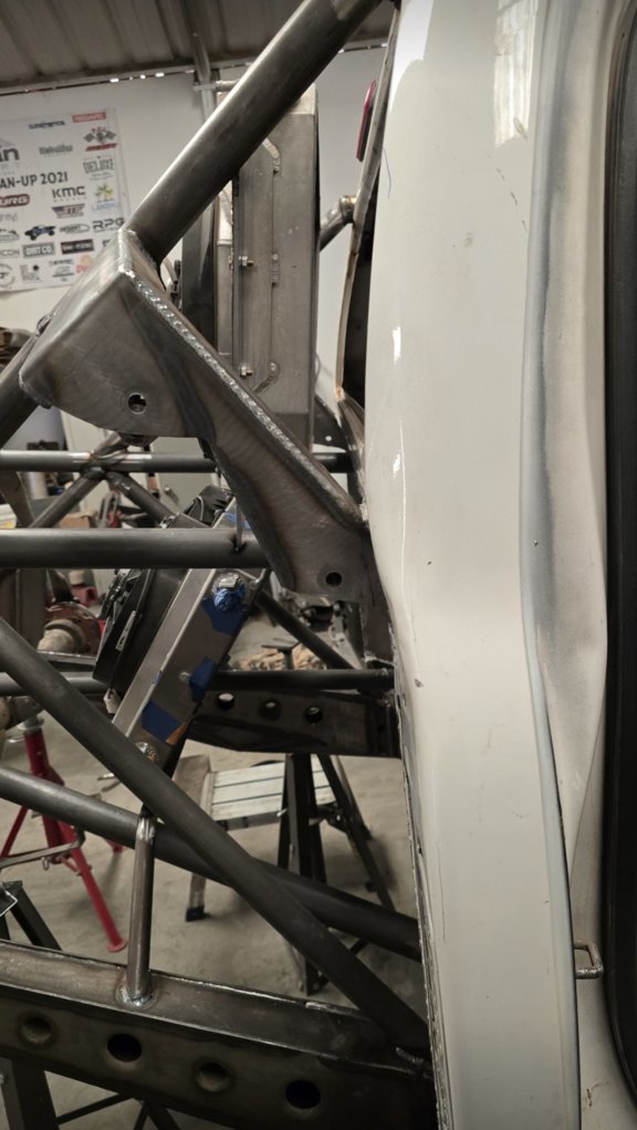

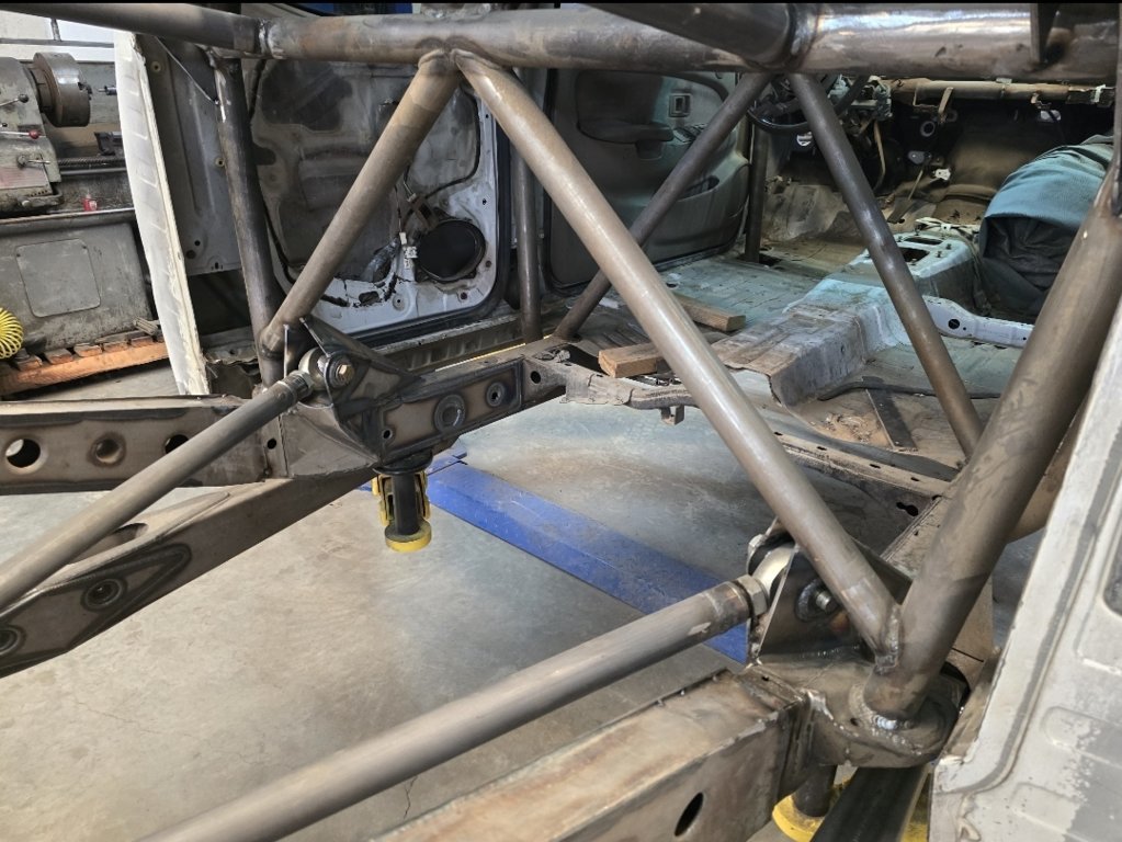

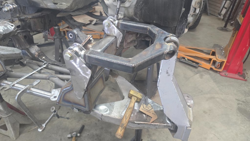

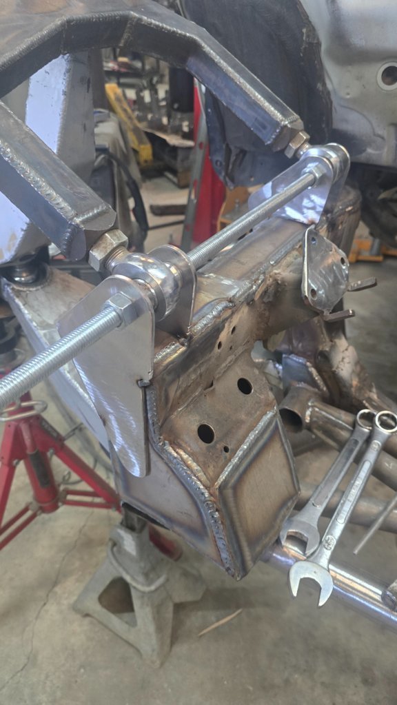

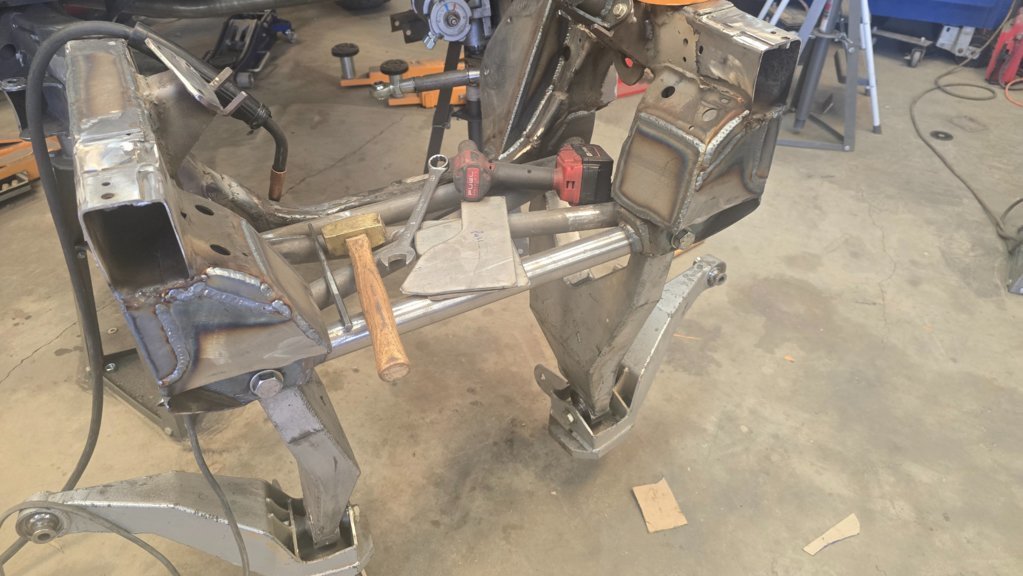

    Went J arm instead. Cycles over 20" but full bump and lock will be strapped at 19". Couple design changes on the J arm but its sorted. Shock mounts will run off engine cage so no need for shock towers. Perfect example of snowball when you wanna run big shocks and 40s
