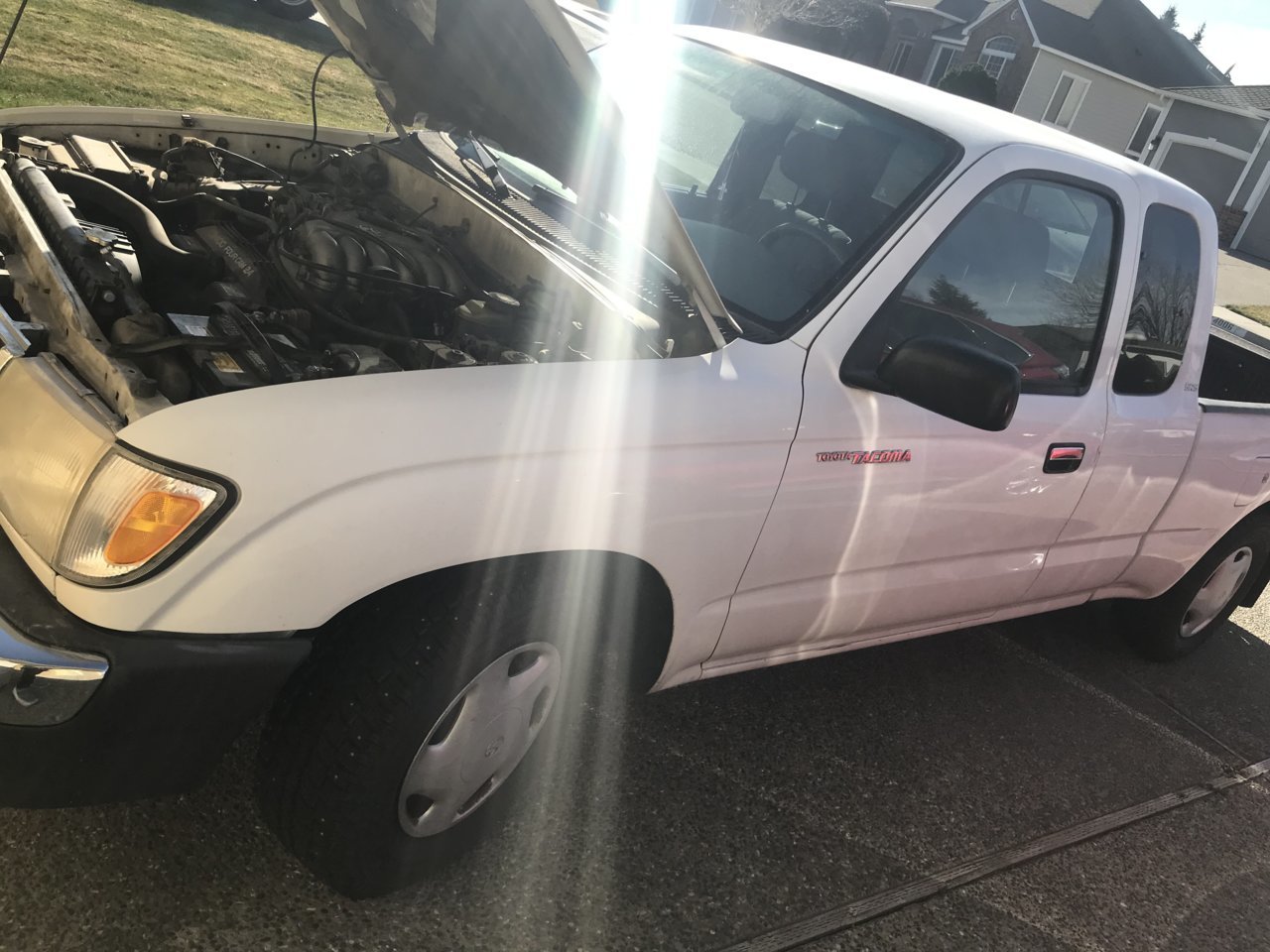

    What all should I do to make this a dependable street truck?upload_2020-7-14_16-11-55.jpg

    Ok here is how I would approach it!
    First before diving in I would check over the frame and make sure u don’t have any issues there!
    Next I would check the front end check your ball joints and such and make sure to get an alignment even if you don’t change anything (people think alignments las forever lol)
    Then depending on the mileage check and see if the timing belt service is due, if it’s been done check your hoses and belts and I would change all the fluids! And your good to go super reliable super dependable truck!
    Oh and just give the brakes a peek!

    Solid advice from Pikyone. Safety check and then move on from there. Truck looks nice.
