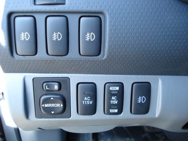

    just saw this. So if I wanted a second foglight switch to the right of my current one I couldnt do it. I was thinking about wiring the new grill light to a 2nd fog light switch ad mounting it in the stock location to make it all look clean

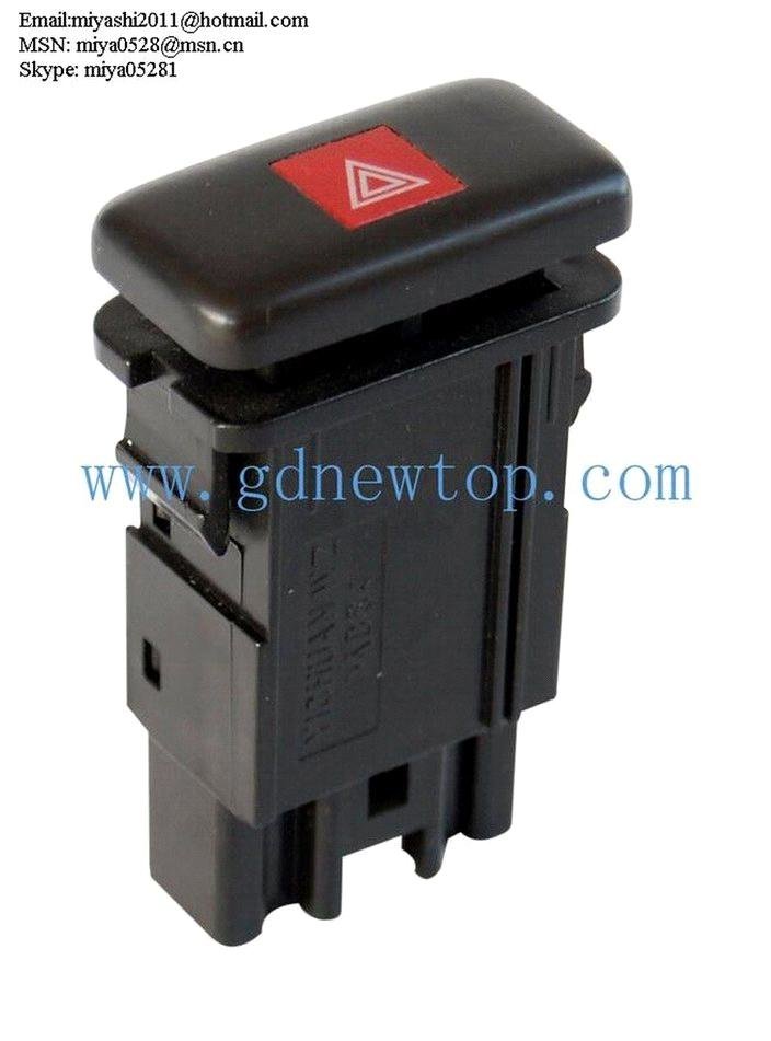

    Can't find the right photo. This switch obviously won't fit in the slot, but do you see the 2 (rails/lips/whatever you wanna call them) on the right hand side? Those are the rails that you wanna shave off with a razor blade.
    This is a pic from my '05 that I sold a while ago...
