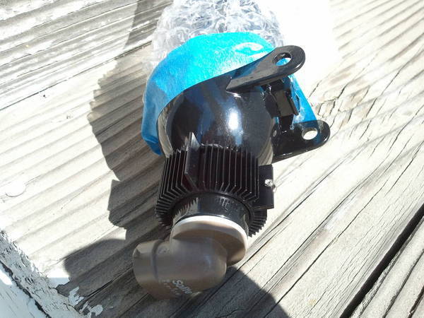

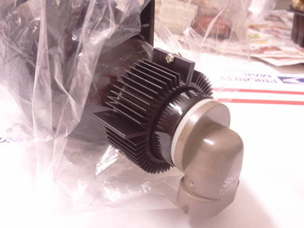

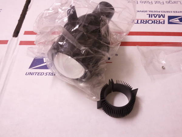

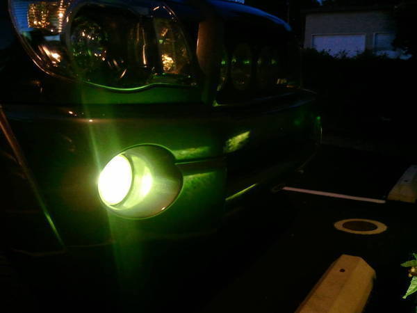

    So I pulled the trigger on this not too long ago. I've been lurking around "Yota Toy"s thread (http://www.tacomaworld.com/forum/lighting/171829-blazer-fogs-factory-fog-housing.html) and finally finished the Blazer Fog Light Retro. Thanks Yota Toy for answering some questions I had. His thread was very easy to follow.
    The kit was purchased from TRS and the heat sinks were purchased here:
    UPDATE: Just google SKU: GWACS021 and get your 28mm heatsinks there
    GWS Heat Sink for 28mm Inrunner type motors
    SKU Number:GWACS021
    He mentioned that he did the "Wire-Down Mod". That wire down mod can be found here: http://www.hidplanet.com/forums/sho...OEM-Reflector.&p=314211&viewfull=1#post314211

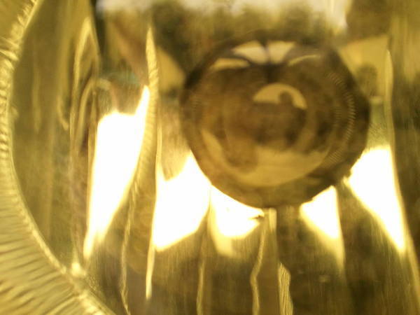

    Here are some pics. I have not done the wire done mod yet and I plan to do so during my time off for the Veteran's Day holiday. I also need to aim them a tad bit higher.
    That last pic is due to my camera on phone being unable to capture the true color + the HID was just warming up.
    Let me know what you guys think. I'll post up more pics after the 'wire-down mod'.
    -AnT

    looks good buddy hows the out put compared to those 460's? those things light up like 10 lanes across lol

    Haven't heard from your buddy man.. maybe you should poke him for me:boink:....
    I asked TRS "what happened to the S2Ks? I don't see them on your site"
    They replied "S2K-R, Meh! that's all I have to say, lol." so yea.....
    Dude... my 460s just washes out the fog lights.. LOL..but after looking at the wire down mod, i think it'll help... plus i need to aim the fogs a bit higher.

    if i can ever get the headlights figured out lol i'm putting in ap1 s2000 in my arb fogs for sure man bjorn has a bunch of them?
    either way that looks great man! i wanna see some out put shots the blazers are still fucking nice man i have seen a few in person but, they where the 4300k not the 3k.

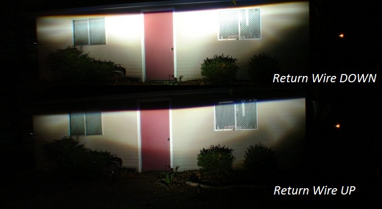

    Wire Down Mod as quoted from the HIDplanet thread
    "As far as blazers go when the bulb is installed in the socket it ends up with the return wire facing up...
    What you need to do is trim the stop tooth on the base of the bulb and that will allow you to rotate it 180° to where the return wire will face down and that will give you the following results.
    Capture_21bd116eca89e1de32476ccdab01c3269137c49a.jpg"

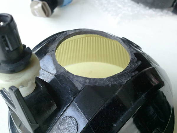

    How did you measure/hold the fog housings to drill into them?? This is the one thing I'm worried about doing this...but I'm getting VERY convinced that I want these.

    got you it produces some artifacts in the beam but, intensity is increased like 5 fold lol. you can do this with headlight projectors as well though the effects aren't as dramatic.

    With a 4300k bulb or higher i would understand that the return wire down mod may not be a good idea for the purpose of a fog light. But since im using 3k bulbs, the yellow would be more ideal to 'pierce' through the fogs ya? To me, the wire-down mod evens out the whole output out.
    i used a dremel because i didnt have a hole cutter for a drill. i set the fogs lens down on a cloth and held the dremel in one hand and the fog in the other (highly recommend using gloves for safety) and the circle came out nearly perfect.. i just took my time and used an air compressor to blow out all the debris each time before i test fitted the blazers... pretty simple and straight forward :)
