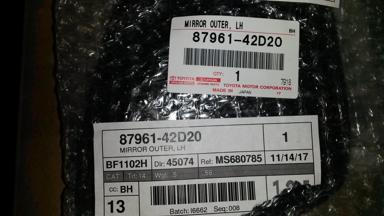

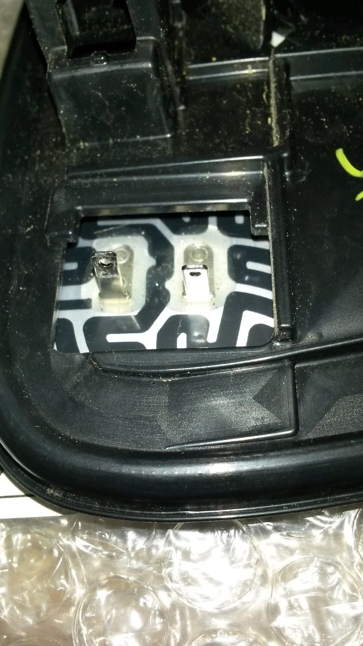

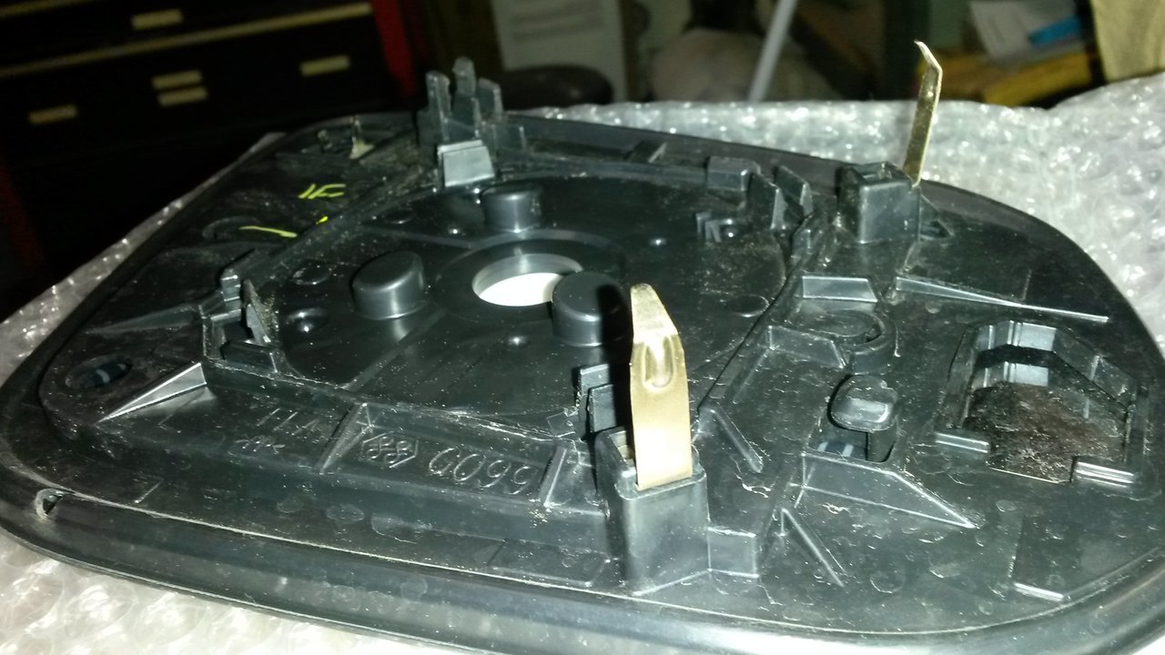

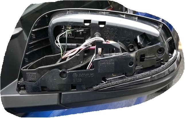

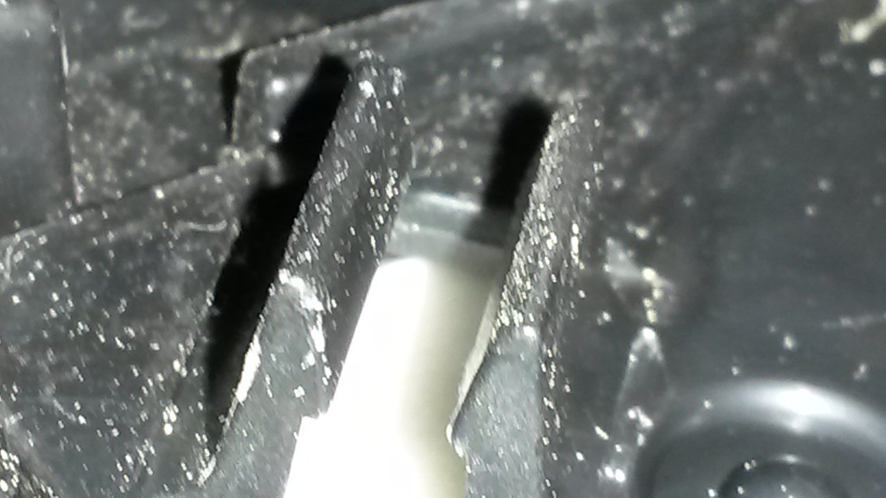

    OK I will attach pix at end. You simply remove the painted cap by standing on the forward side of mirror assembly, place 3 or 4 fingers at the top outer edge corner, then pull hard. The 1st clip releases. Then work inward towards door glass and apply same pressure. The cap is strong plastic and nobody has broken one doing this (yet). It is easier if you have someone stand on the glass side of mirror and hold mirror assembly from rotating. Once the cap is off you will see the 2 heater wires on the door glass end of the inside of the mirror. Carefully pull the 2 wires off the connection. Now stand on the glass side of mirror. Try to grab it close to the middle and pull hard. There are 4 plastic clip points in the center of mirror. After the clips release there are 2 metal springlike clips that are towards the outside of mirror. No real pressure on them. The new mirror simply snaps into the 4 points. Then connect heater wires and install the cap. Note last pic is not mine. Must have BSM because mine did not have as many wires.

    Yes from 2016 rav4 limited without BSM. Need to find passenger part number.

    Theres a picture near the top of this page

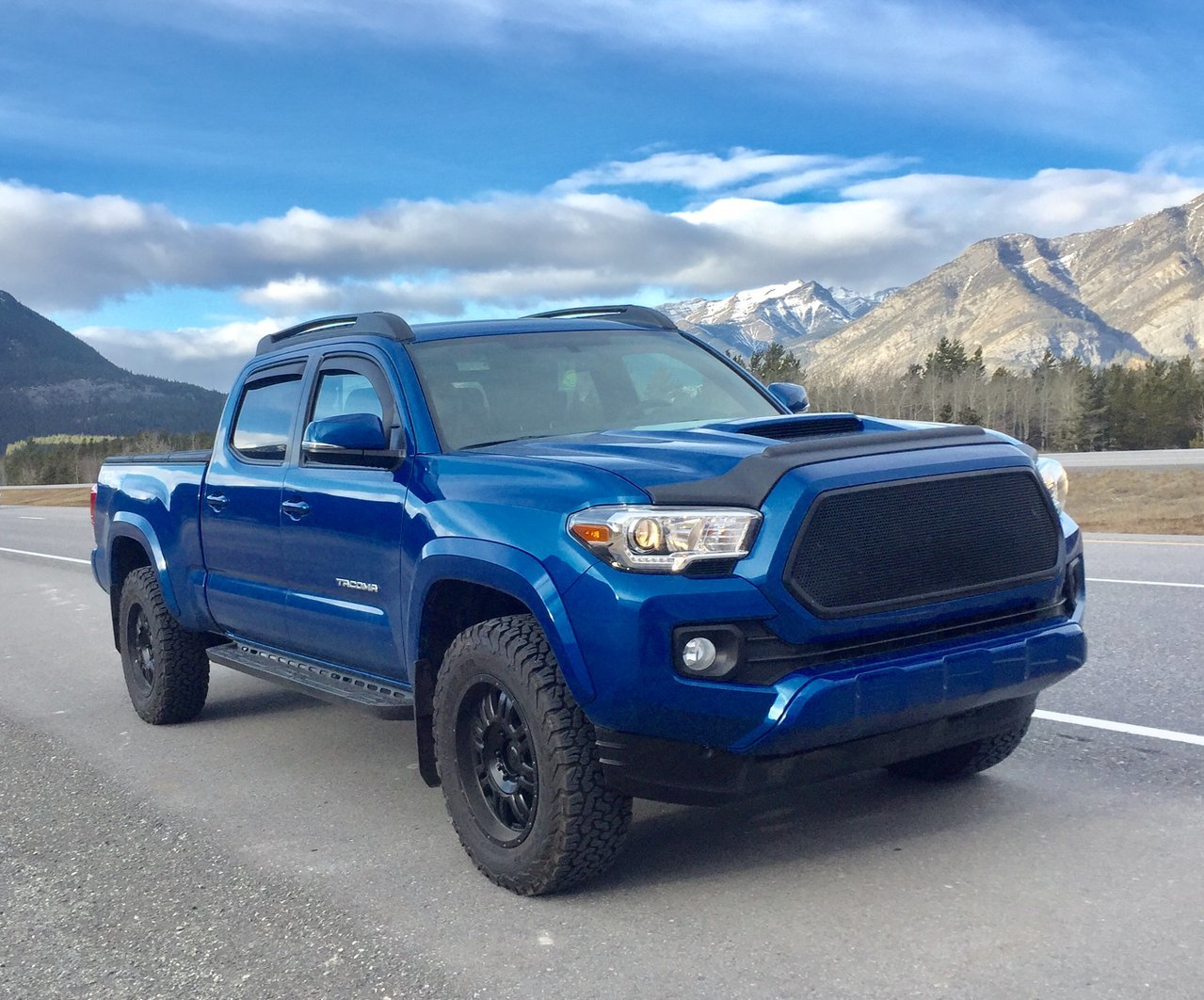

    Nice ride! What deflector is that?

    Thanks! The bug deflector is an avs aeroskin 2
