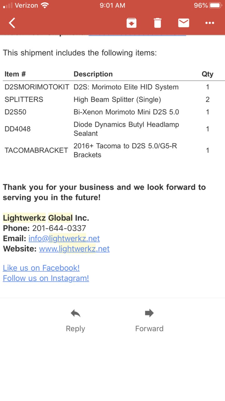

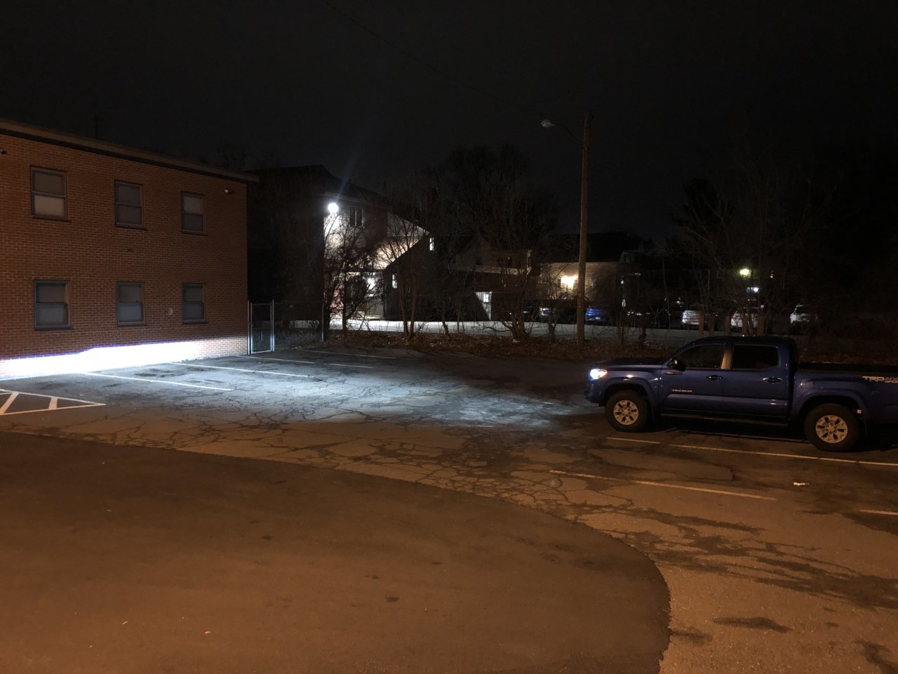

    What bulb and what ballast are you running? I have a set of 5.0's in mine and they arent that bright. I was actually kinda disappointed.

    TRD sport door badge, TRD coin bucket, D2S 5.0 HID projectors, XB5500K HID Morimoto Kit with Highbeam Splitter, DD SS3 PRO Yellow fog lights, TRD PRO Grill with TSS, MESO TRD PRO shift knob Stage 2 (ECT/Front Cam), Anytime F/R camera, 2020 TRD pro wheels.

    They all go to 80% after 200 hrs of use but boy oh boy it feels like I perform xray on people going over bumps lol

    Thanks for the info but that still doesn't show what color temp you went with.

    its 5500K. And these are not the brightest. The brightest would be 4300K i think. And its 35W balasts for bulb longevity

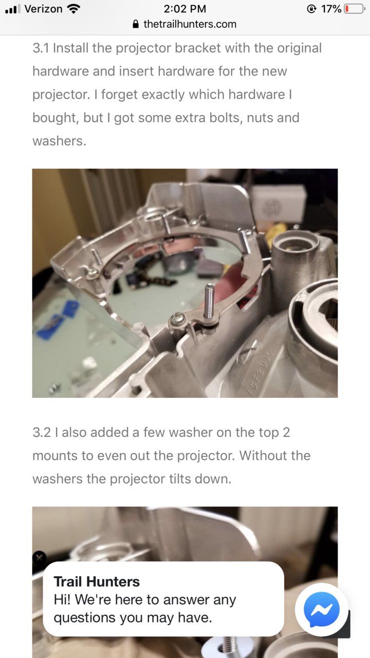

    Awesome. I'm running the morimoto 5500k bulbs as well. Do you get any projector bounce? Mine bounce over small bumps, I'm assuming it has to do with the two spring clips at the top that hold the projector mounting bracket in

    I never get any bounce. Mine was rock solid when I put it in. Did you do D2S 5.0 or RX350?
    I dont remember using any spring clips. Projector itself bolts onto the bazel.
    I did D2S and had to attach the projector to a conversion bracket. I used 4 tiny bolts with a thread locker.
    If you did d2s you may have a lose bracket.

    https://thetrailhunters.com/diy/toyota-tacoma-hid-projector-retrofit-and-bhlm-diy/
    The bolts in the pic would be the only source of bounce if you did morimoto d2s5.0
