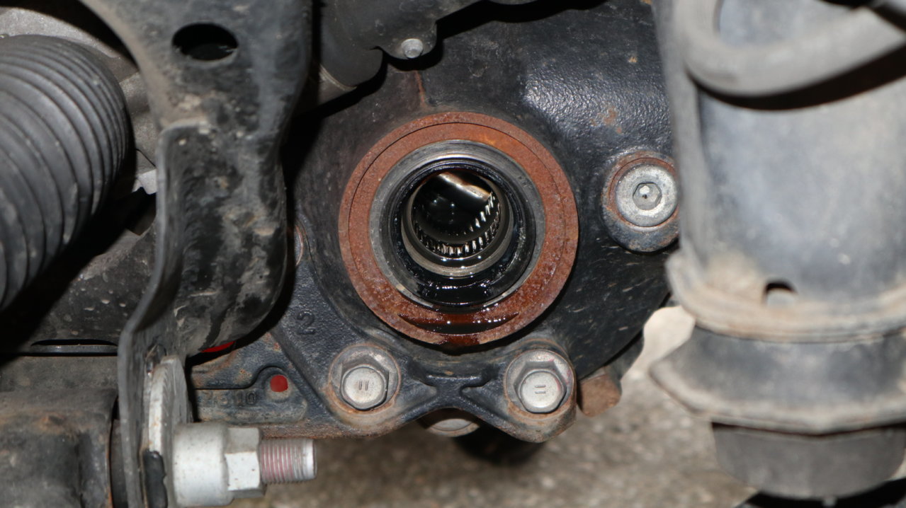

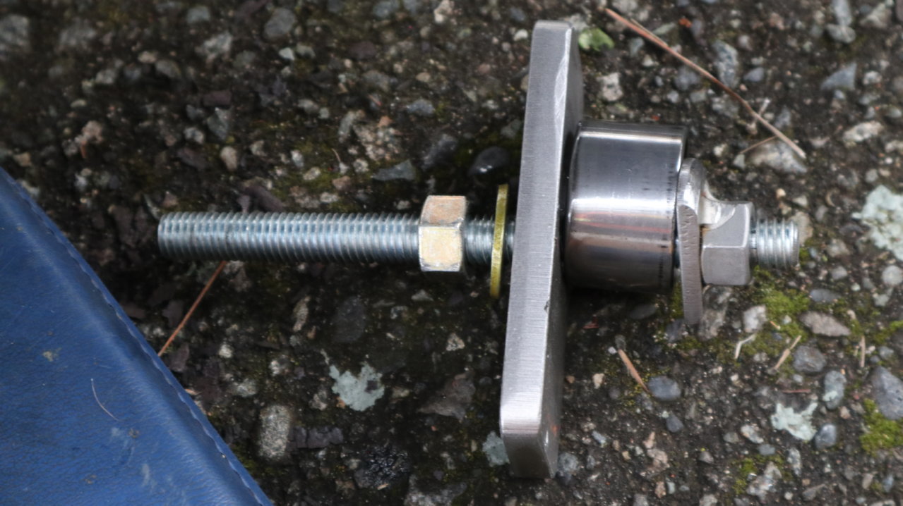

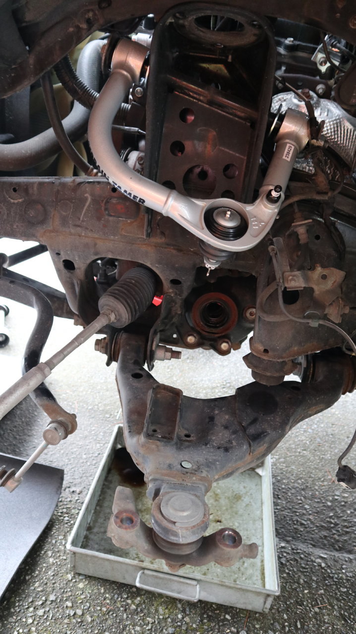

    The axle was the hardest part of the job. I did mine yesterday. I did a lift and upper control arms too. I just removed the spindle hub and axle as a unit to give me room to do the bushing. I didn't replace the seal. And before install, I threw the bushing in the freezer for several hours.
    Edit: I also had the left side up as high as I could go on a jack stand and a jack under the right control arm with the wheel off. I didn't lose a drop of fluid this way.

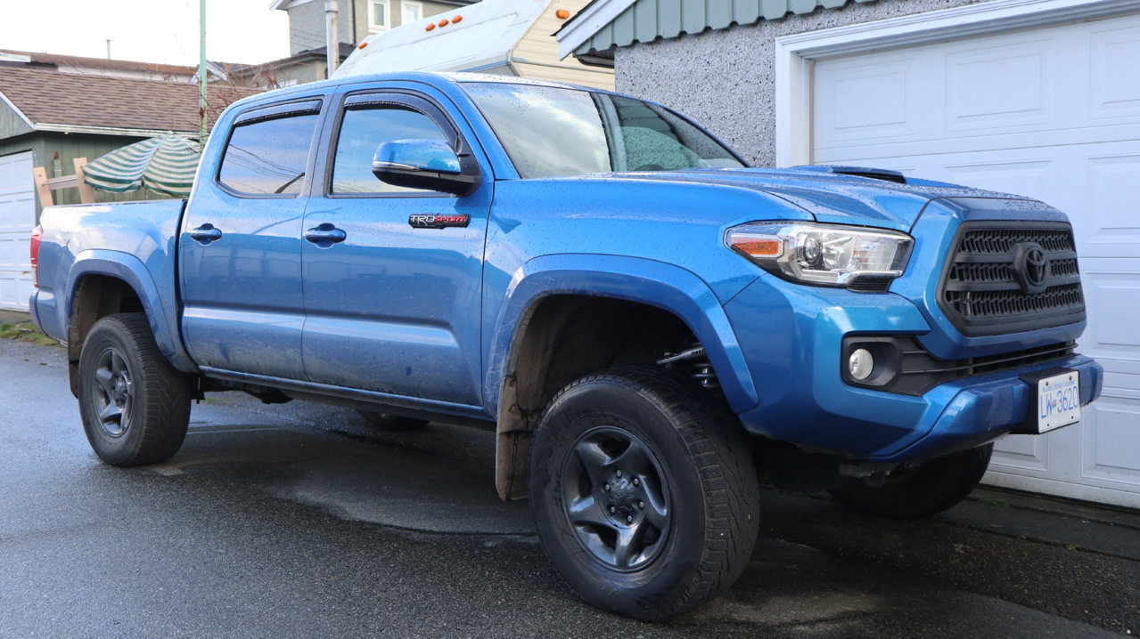

    And a quick pic after the lift install. New tires and wheels will go on Tuesday for the alignment. 20220303144721_IMG_0899.jpg

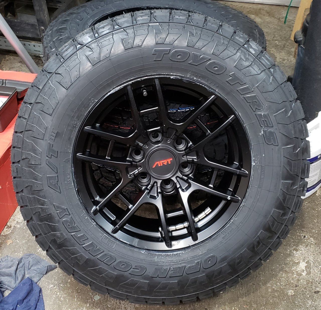

    Art Replica 237's 17x8 with +5 offset, wrapped in 265/70R17 Toyo Open Country ATIII's in SL.20211118_155412.jpg

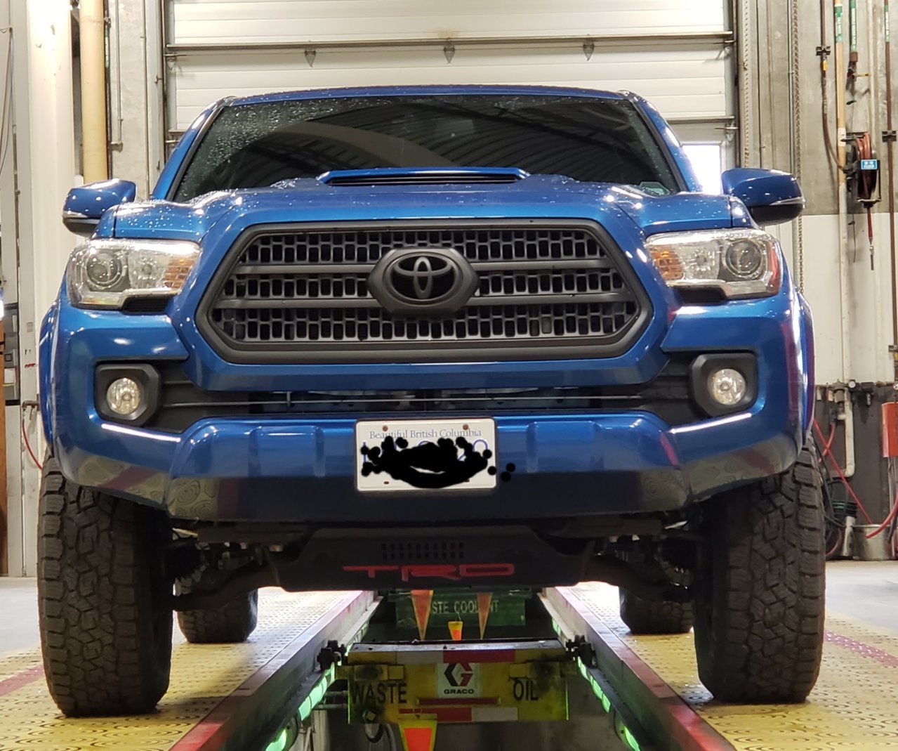

    I never posted a picture with the tires and wheels on...
    Also picked up a TRD skid plate and painted it a better colour.. 20220418_094213.jpg
