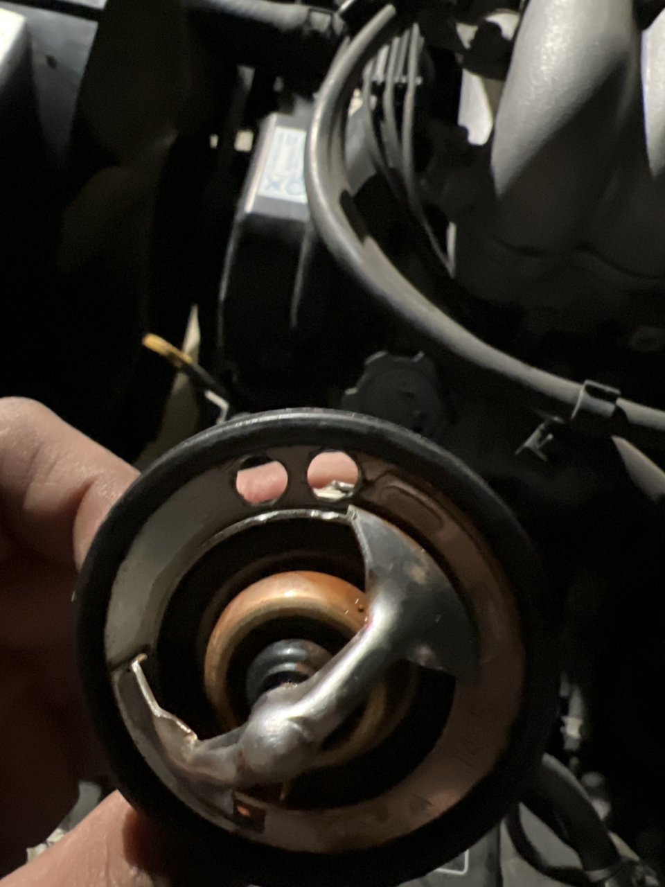

    Old thermostat had two holes in it, replaced with a new one down position, I try bleeding coolant system but temperature was too high thermostat wouldn’t open bottom hose is cold

    Thermostat won’t open

  12. Feb 10, 2022 at 10:47 AM
