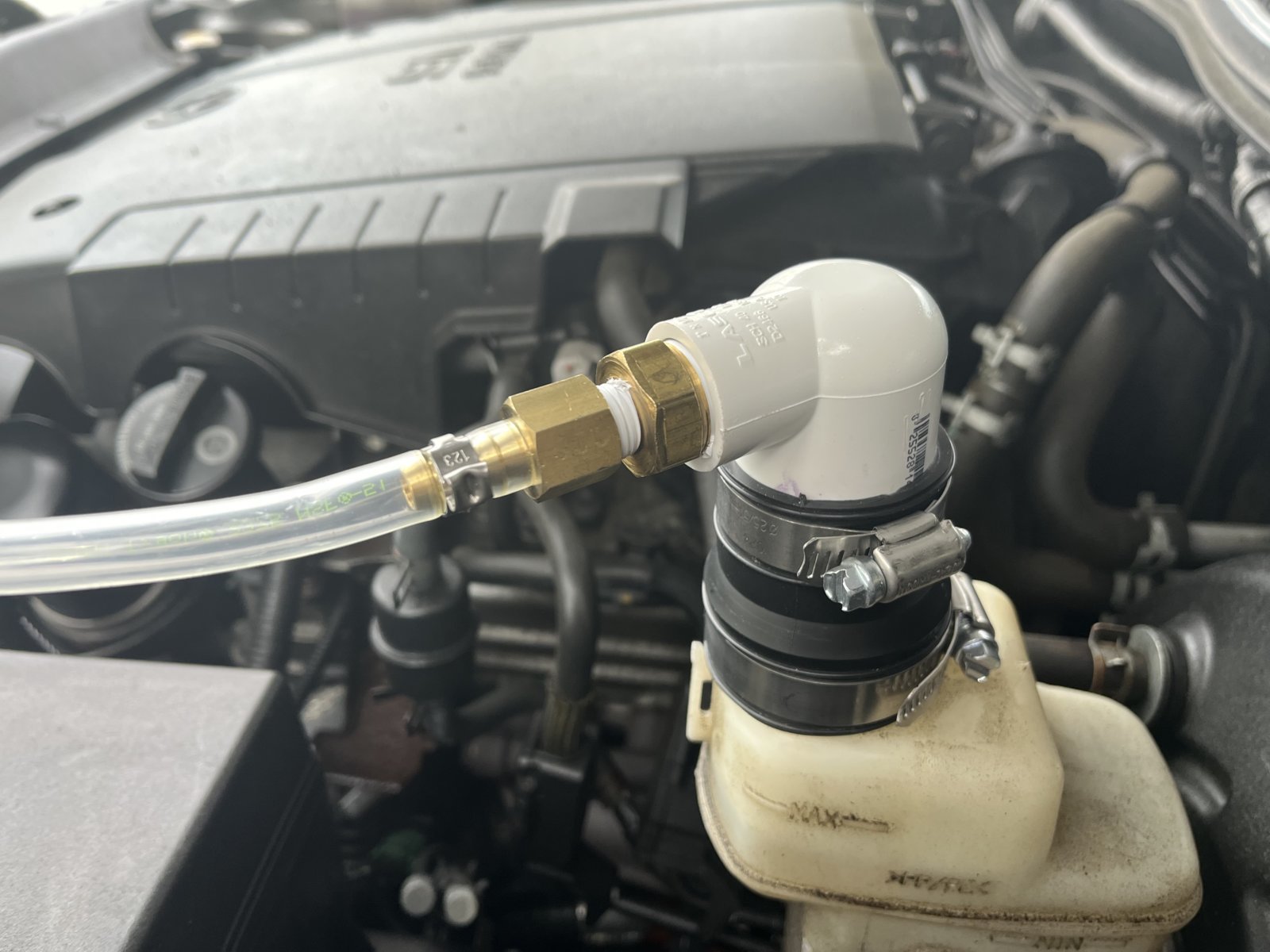

    BA10 adapter fits the reservoir. Tricky to use, requires install, pressurize, then tighten the clamps a little bit more again and watch for leak free holding.

    I use this homemade adapter:
    Rob MacRuger likes this.

    That beats paying $70 for the BA10 adapter.
