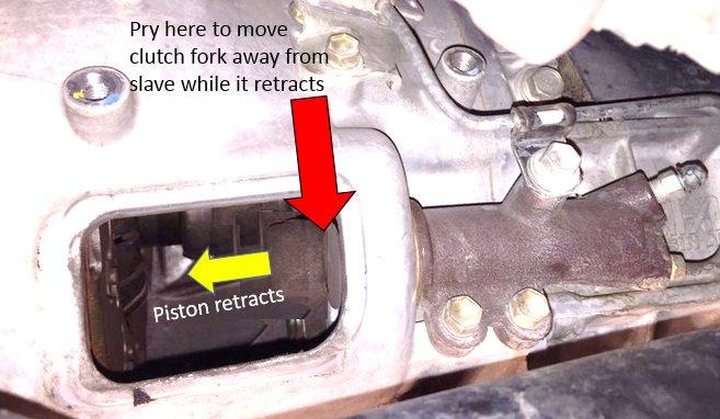

    Thought I would add to this thread as I had the same issue when replacing my slave the other day (6 speed).
    After many methods (two man bleed, vacuum bleed, gravity, tipping truck up, blocking the slave, etc), I could only get about 20% of pressure. What worked for me was reverse bleeding by compressing the slave by using the clutch fork. I pried the clutch fork off of the slave to allow the slave to completely retract. Doing this once gave me almost gave me almost all pressure back. A few more times and I had all my pressure.
    Might help if someone else runs into the same issue.
    Step 1
    Compress slave, force any air into reservoir
    Step 2
    Pry clutch fork off slave to allow piston to completely retract to allow fresh charge of fluid
