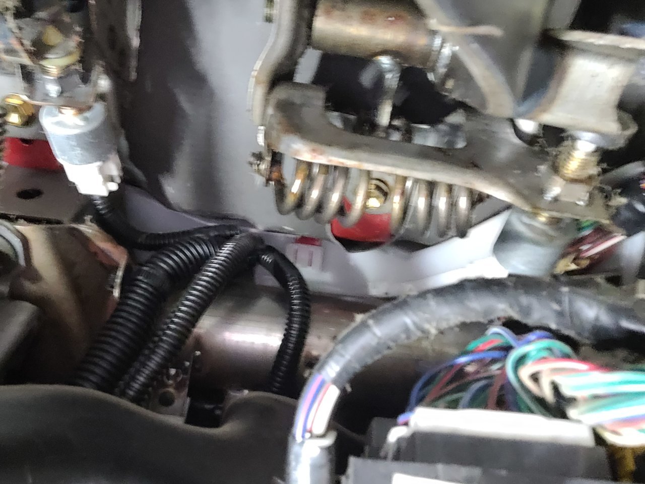

  12. Aug 9, 2022 at 1:28 PM
    #32
    Clydaho
    Clydaho Member
    Jun 25, 2022
    #400102
    10
    Clyde
    1999 Tacoma SR5
    Swapped out the master, bled system and adjusted pushrod length.
    Why does the pedal still not come all the way back up? It doesn't affect shifting, but it shouldn't stop 2" from the top.
    I use my toe to lift it up. It almost seems like it "cams over" and pops to the top. Make sense?
    I adjusted pushrod length both ways. No change.
    The spring isn't the type that hooks into the pushrod pin. It's a beefy looking thing that looks fine. I don't see anything that looks bent or tweaked.
    What am I missing?o_O

  14. Aug 10, 2022 at 5:59 AM
    #34
    Clydaho
    Clydaho Member
    Jun 25, 2022
    #400102
    10
    Clyde
    1999 Tacoma SR5
    Is that the spring under the dash?

    Please tell me more about the "linear spring mod" and where my worn bushing is.
  16. Aug 10, 2022 at 1:21 PM
    #36
    Clydaho
    Clydaho Member
    Jun 25, 2022
    #400102
    10
    Clyde
    1999 Tacoma SR5
    Ordered spring and bushings from Toyota dealer.
    Checked tightness of bolt, loosened it up and fixed the problem.
