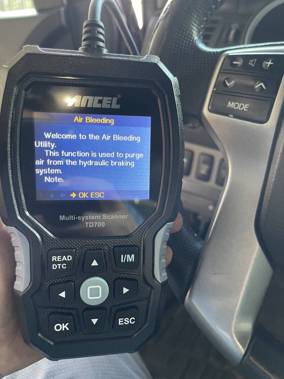

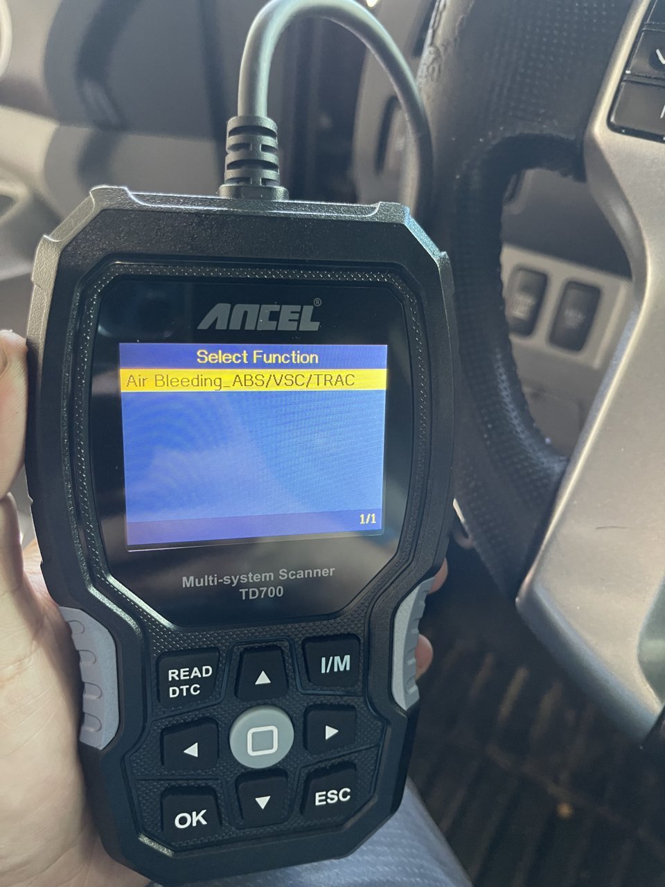

    Hello all
    Was recently put in a situation where I had all the fluid brake drain from the master cylinder. 2013 TRDOR with VSC system.
    After fixing the issue, refilled the brake fluid and did a conventional brake bleed on all 4 corners. I then tried to bleed the ABS using the “dirt road method” but I could tell I wasn’t 100% getting all the air out.
    Searched on the forums and couldn’t find a solid answer on what “relatively” cheap OBDII scanner could do the ABS/VSC bleed other than tech stream.
    I rolled the dice on this ANCEL TD700 from Amazon and happy to report back that it can perform the ABS bleed on these trucks. At 120 bucks I’d say it’s relatively cheap for what I needed it to do. Brake pedal is solid now.
    Thought I’d share on here for future reference.

    abs module bodies have lots of cavities that trap air and traditional bleeding will not clear it. The abs bleed routine activates each of the numerous solenoids in the abs module to get that air out of the module and moving down the lines. ALL abs units in every car are electronically actuated. abs, by definition is a computer controlled function. None of this is related to the booster.

    None of the ABS bleed routines are standardized. Most inexpensive scanners do not do the ABS bleed. Some of the mid priced units do it, but the vehicle coverage is hit or miss. If the OP was able to do it on his tacoma with the scanner he mentioned, the chances are very good it will also work on your truck.
    Generally, you manually bleed first (get air out of the lines before the abs), then do the ABS bleed to push the air out of the module and further downstream, then follow up with another manual bleed to get that air pushed out of the calipar. Some ABS bleed routines will push enough fluid so that the last step is not required, but don't know the toyota routine, so can't advise whether that step is necessary or not, so suggest doing it. Don't forget to refill the MC after each individual bleed step (LF, RF, etc.), lest you have to start all over again

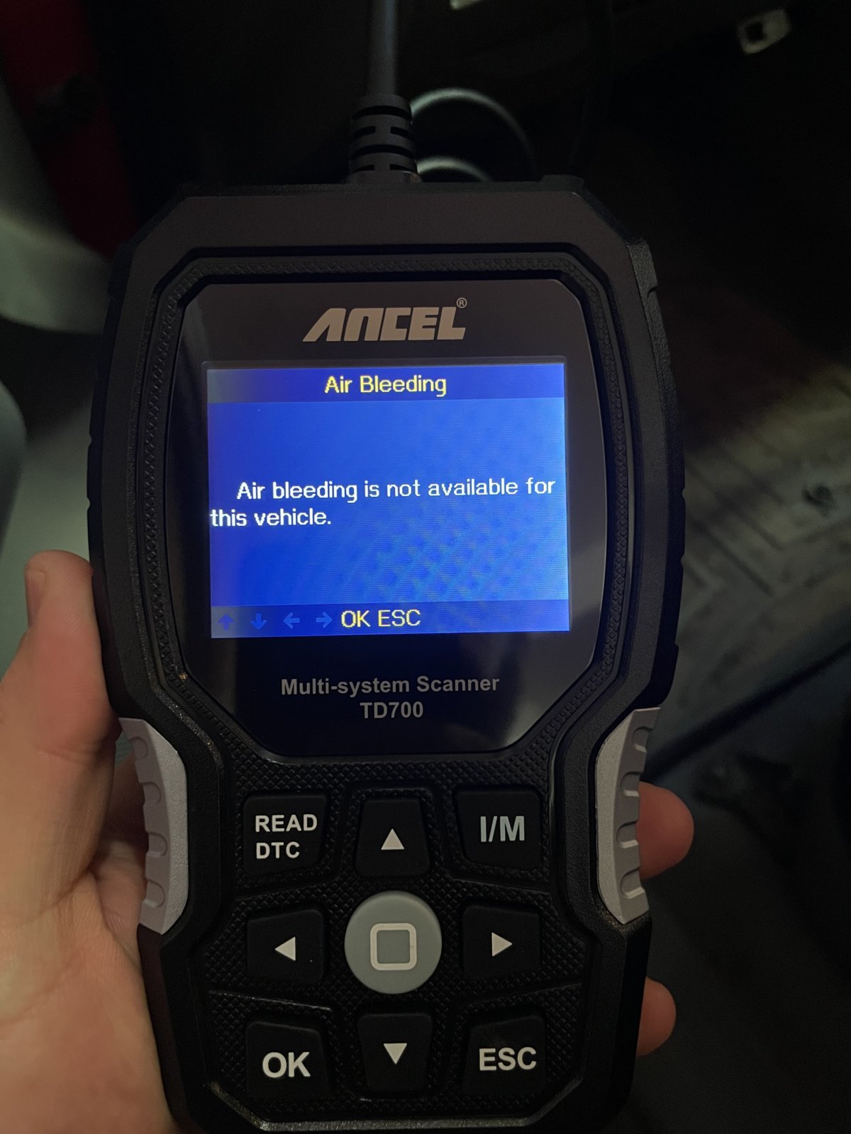

    Anyone know if this works with 3rd gen ORs?

    If you have an OR or Pro all you need is the ignition on but not the engine running. Other trims you shouldn't even need the ignition on when doing just the lines.
    My question was kind of vague. I'm asking if that scanner linked to above if the software works with 3rd gen ORs to bleed the "master cylinder solenoid" (ABS). I have read the manual and it does say to bleed the lines and the ABS with techstream (or scanner).
