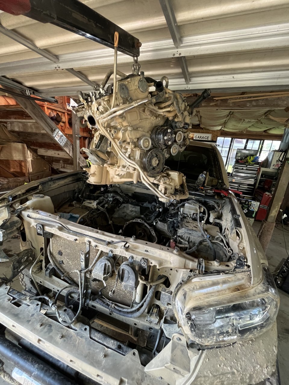

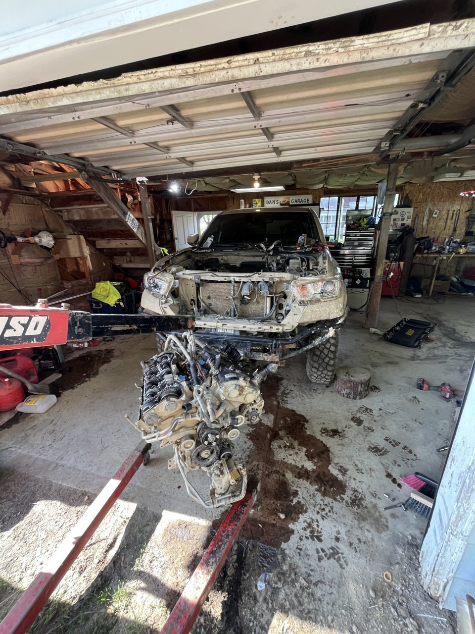

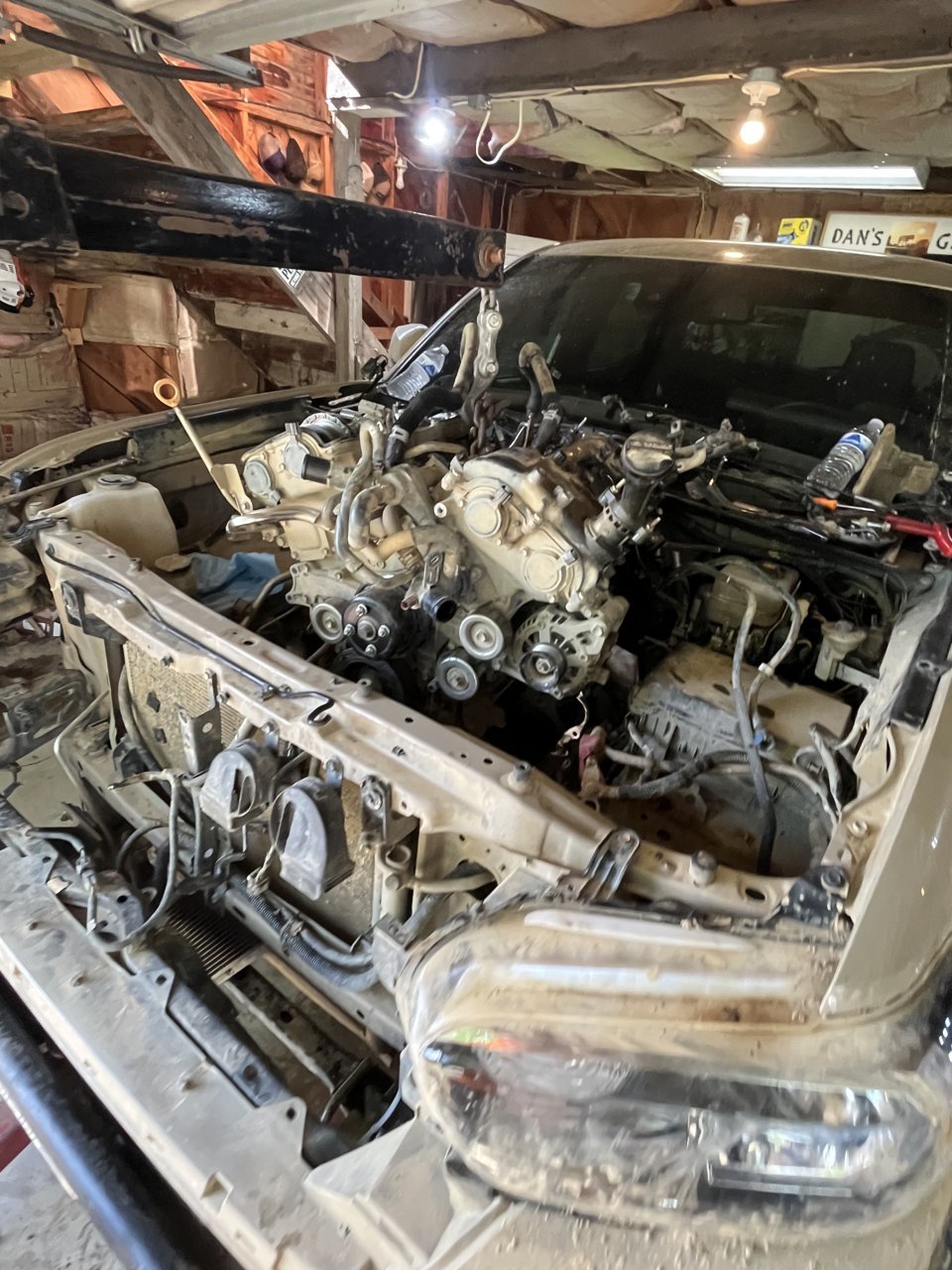

    258501D1-7EC3-4FC7-A52B-59ED3307AB1C.jpg 358CB6B7-117F-4216-9453-D86983DB3261.jpg E9F02A0D-F923-4F39-99E5-5747AF791405.jpg

    You decide what you're replacing it with?

    Wow, this is turning into a very interesting thread. Thanks for sharing the photos of the removal. Looking forward to what you are going to do next. Just curious, is the truck paid off? also, do you have a budget for whatever you are planning to replace the HL engine with?

    OP has achieved beast mode here! I am a pretty experienced wrench turner, but have never gotten to the experience level where I could swap out a motor. Mazel Tov OP!

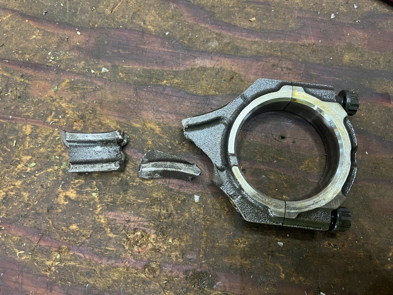

    It’s gonna be a few weeks before another update but to close out this chapter, this was the fatal blow. Not discovered till I had the motor out and starter off today. The crankshaft counter weights and bottom of the cylinder bore is chewed up pretty badly as well, even without the hole the bottom end would still be unsalvageable.

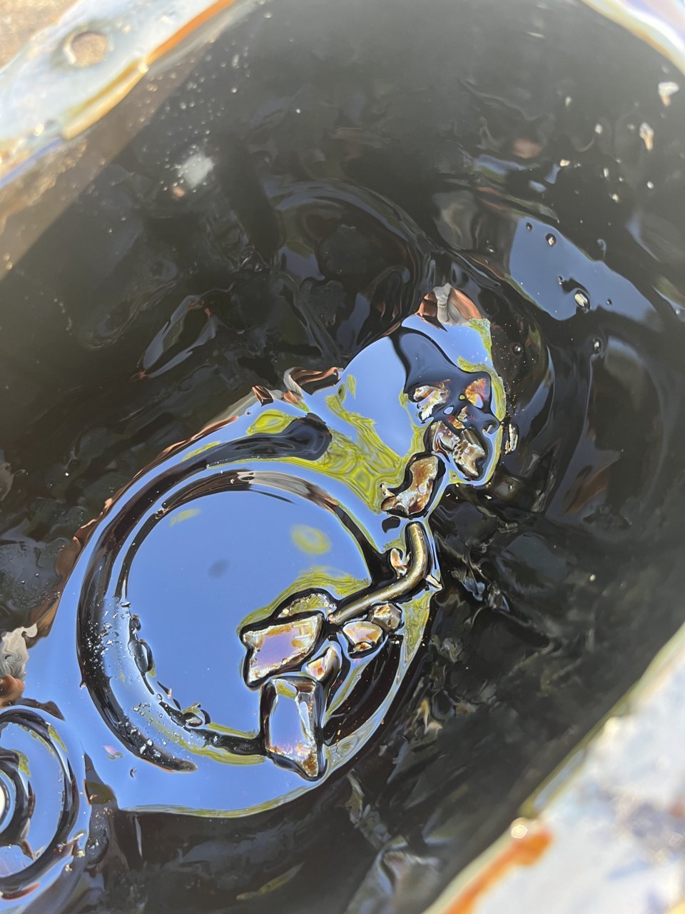

    Got the engine further apart today. Bearings all look fine which means it was probably never even oil starved.

    Think its a good choice of sticking with a stock replacement. So much easier. Maybe in the future just run breathers when you're going to be offroad? This way you can't drink the oil and hyrdolock the engine again?
    Maybe one like this? You can still run the catch can and operate like normal on the road. When offroad run a breather in the passenger side valve cover and cap the catch can off so it's venting to the atmosphere and not back into the engine?
