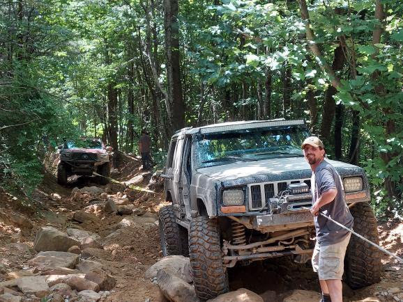

    Oh yeah several have.
    I'm draggin' this stock no catchcan 3rd gen off a trail.

    FIFY
