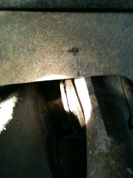

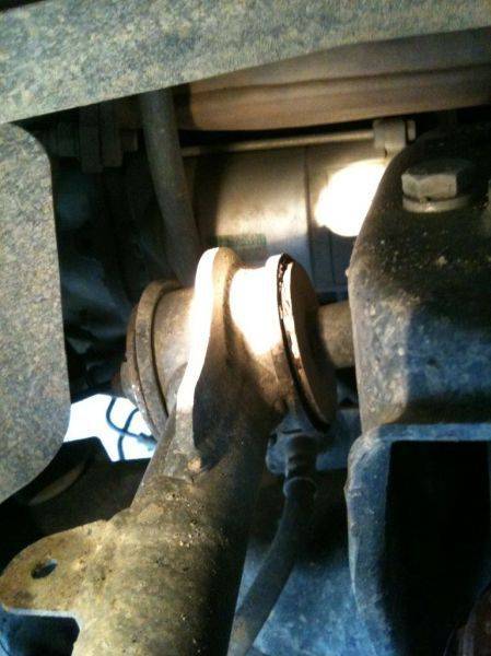

    I have the Camburg Uni ball UCA. I have been good abut greasing them and hat not. I started to hear a clanking noise. I looked around for some time and finally found out it is a bushing that is blown on my UCA.
    I want to know what can cause this? I have had them on my truck for about 1 year... I also called Camburg 2 times now and left a message but no reply? Maybe cause of the holidays?:confused:

    Over greasing can cause them to blow out, and fail. They dont need alot of grease, and should only get a couple pumps of grease every 6 months or so...

    I think that is what might of happend... i let my friend do the other side and i think he put way to much in.... :rolleyes: i am off to get a pic.

    Over greasing them.

    BAD BUSHING.....
    GOOD BUSHING...

    Mushroomed, probably from overgreasing.
