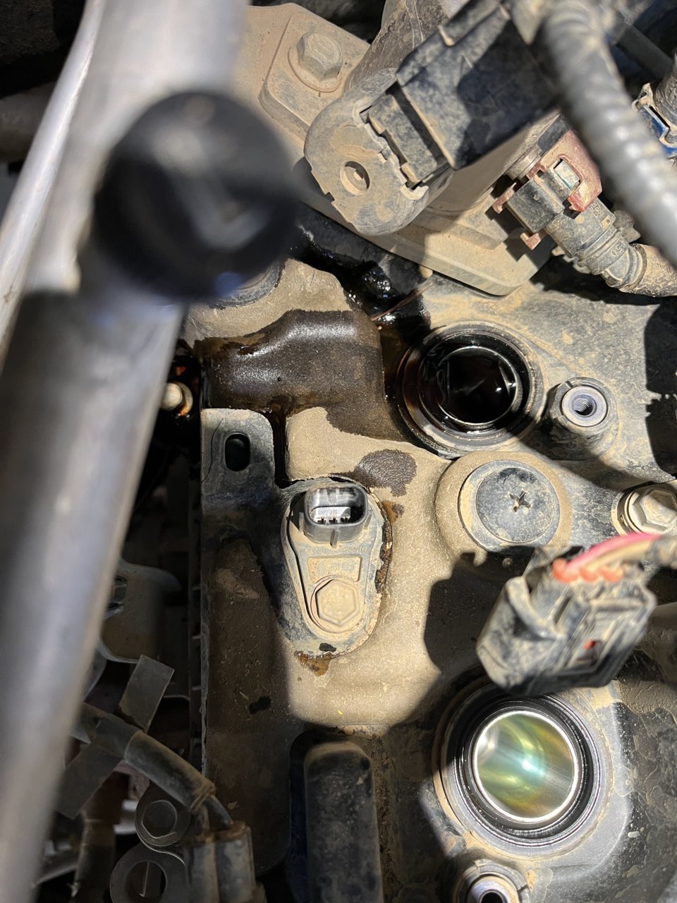

    Did the motor in last night. I was on an off camber climb out from the river and apparently my oil catch can filled up and pulled oil through that into the engine, filled the #5 cylinder and hydrolocked. Not sure the extent of the damage but with the plugs removed I’m unable to turn the motor over by hand (with a huge breaker bar) at all so I’m guessing either bent rod or worst. What’s promising is there’s no metal in the oil or filter.
    The # 5 plug just happens to be the last one I pulled and when I did oil just started pouring out the plug hole (that’s what the pic is of)
    Gonna do some thinking now if I want to rebuild this one or swap something else into it (like an LS) but won’t even be at the decision phase till I’ve got this motor pulled apart. The one thing I’m not doing is buying another 2GR for it, if this one isn’t rebuildable it’s swap time. Whoever put that PCV valve in that location is an idiot.
    Pic shows the number 3 plugwell clean and dry with number 5 behind it oozing oil. When I pulled that plug it was like I tapped a well, it just poured out.

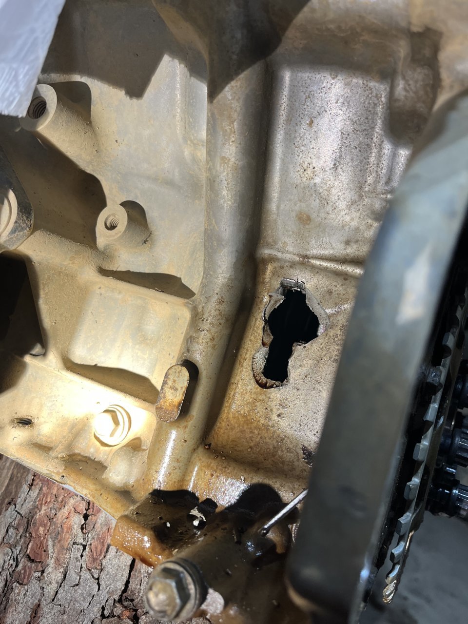

    Edit: feel free to read the whole thread but here’s the final pic. I didn’t find this till I had the motor pulled today and took the starter off. The counterweight on the crank and the bottom of the cylinder bore were hammered pretty bad, even without the hole the bottom end would still be toast and isn’t even rebuildable.

    I'll venture a guess that the piston broke and is jammed in the cylinder. Rod probably bent and maybe even the crank. Sucks.

    The catch filled up because oil was coming out of the PCV valve at a high rate. That oil would've gone into the intake whether the catch can was there or not.
    The stock 2GR isn't alone in this by the way. Jeep's 3.6L Pentastar does the same, and there are catch can kits for those.
