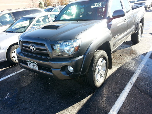

    I plan on pretty much following http://www.tacomaworld.com/forum/lighting/212064-hid-retrofit-2009-tacoma-extended-cab.html
    I think I have everything all figured out, except for second guessing my plan of doing everything (halogen bowl, all chrome trim & shrouds) in low gloss black.
    Metallic grey Tacoma
    I'm slowly starting to stealth it up & have some low gloss black rims about to get snow tires on em.
    Any suggestions on what to do color wise?
    • Go all low gloss black
    • Low gloss black on everything but leave the shrouds chrome
    • Low gloss black on everything but metallic grey the shrouds
    • Something else slightly stealthy?
    Any flaws in my parts list & plan? Plan on pulling the trigger before the TRS Black Friday deal expires on Monday. I'd successfully talked myself out of doing this as I had a perfectly working truck & use daily for commuting... then the drivers side headlight burned out 2-3 days later & the wife is flying out of town for a couple weeks so I'll have a spare vehicle.
