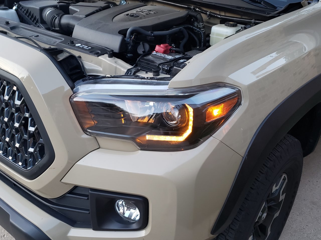

    Do iiiiiit OP - it's fun to add your own little touches, if you're so inclined. For me, that was amber DRLs, among other things.
    Oh and if you do go through with it, go ahead and snag some color matching @MESO headlight trim plates...it's the details that complete mods like this.

    They look deadly bro!! Deffo doing it now.
    I'll have to snag some off of him for sure.
