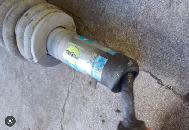

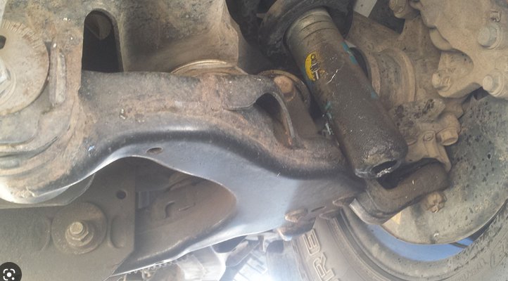

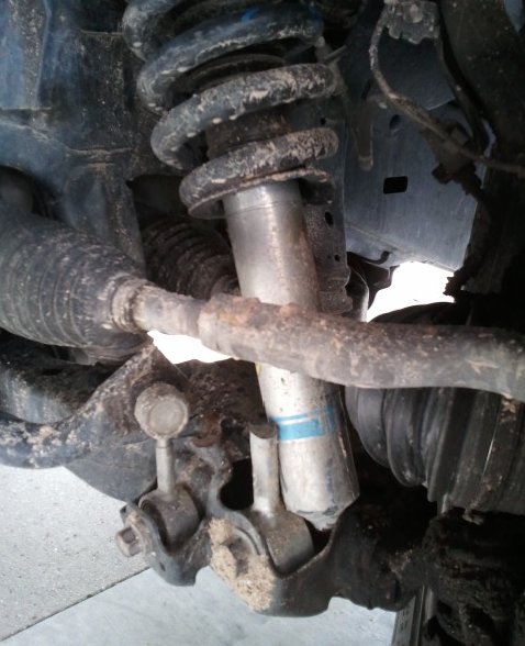

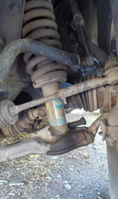

    Everyone asking for 5100 reviews...here ya' go - It is nothing but an OE replacement that allows for some height adjustment and it is a very low end low performance shock. A few years ago there was a test of low end CO's on YT and the 5100's over heated and puked after 30 minutes on washboard...well and then there are the 100's of images like this where the lower stalk caves in or breaks lol
    upload_2023-4-28_12-54-43.jpg upload_2023-4-28_12-55-32.jpg upload_2023-4-28_12-56-8.jpg upload_2023-4-28_12-57-45.jpg

    Preloading these beyond the first ring on a stock weight truck is a terrible idea and sometimes ends badly. If you don't let the shock be a shock, something is gonna give.

    the oe shocks do the same thing so preload is not the problem the problem is thinking that a stick of cheap metal the size of a sharpie with a horrible weld to a thin hollow tube holding up your truck is a good idea

    They do, but preloading too much just makes the damper/shock take the brunt of the force until the spring can start to give and let the damper do its job. It doesn't matter if they are 5100's or 2.5's, they have a job to do and that job isn't to support the truck like a rigid stick. That's what you are doing when you preload them without adding weight to match the spring rate and preload. Preloading springs just for lift without adding the proper weight is just a terrible idea and results in poor performance all around.
