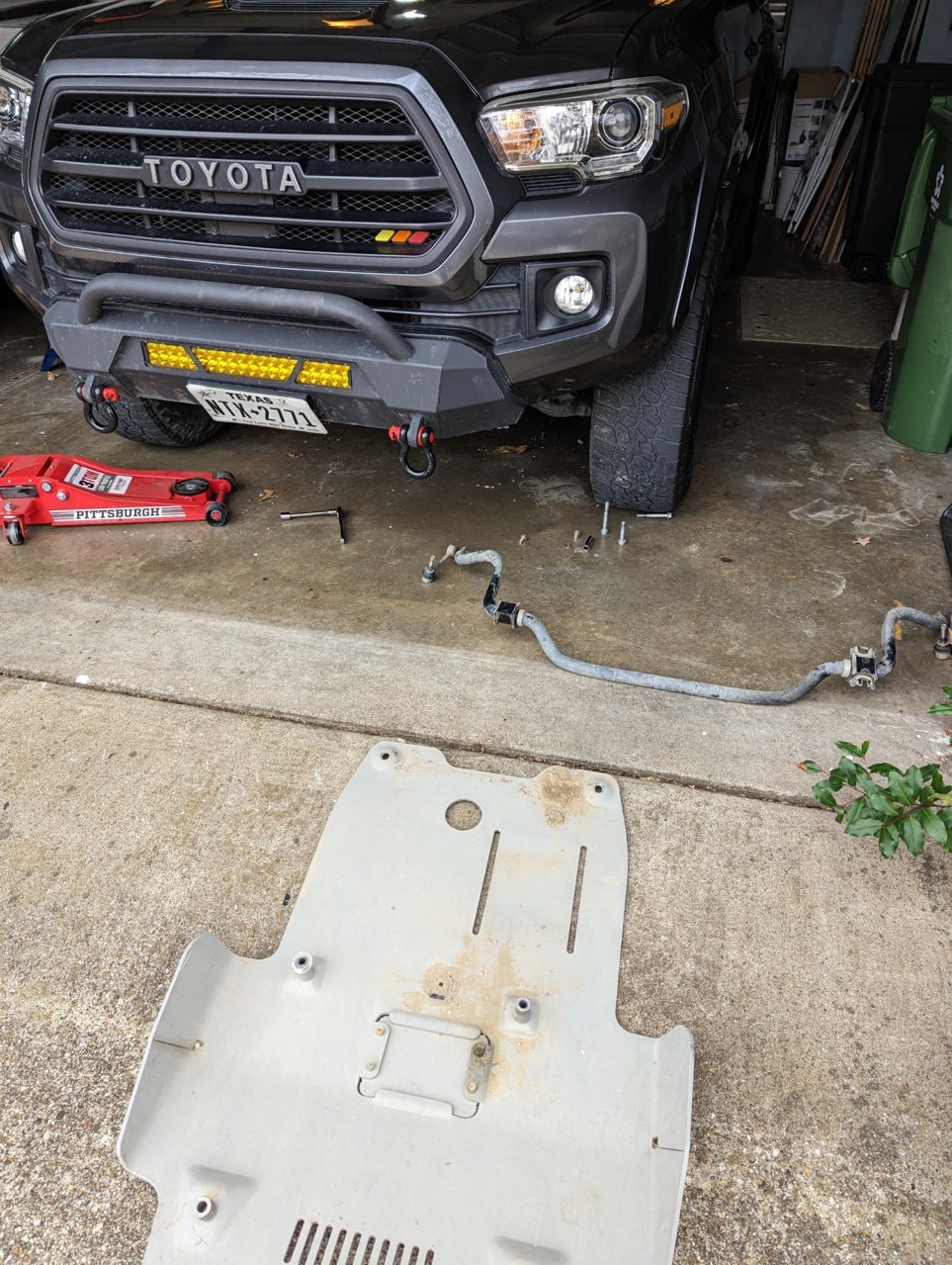

    IMG_4077.jpg Lol I removed my sway bar as well just last week after years of reading about it and being scared to do it. Finally did it and I won’t be putting it back on. Love the trucks handling and ride comfort now. I’m about to sale my two sets of overland custom design end links as well. As far as ride.. It rolls slightly more in turns at higher speeds but no where near enough that I find it scary. It doesn’t sway much at all for me or definitely nothing that makes me uncomfortable going 70mph and turning the wheels back and forth to test…
    Fwiw I’m running the 8112s/8100 combo on Bilsteins shipped height or 2.2” with the 600# springs(650lb soon to get rid of rake after going up to stage 2 on leafs) and 255/80/r17 Toyo Open Country AT3s, rxt leaf springs stage 2 and hammer hangers.
