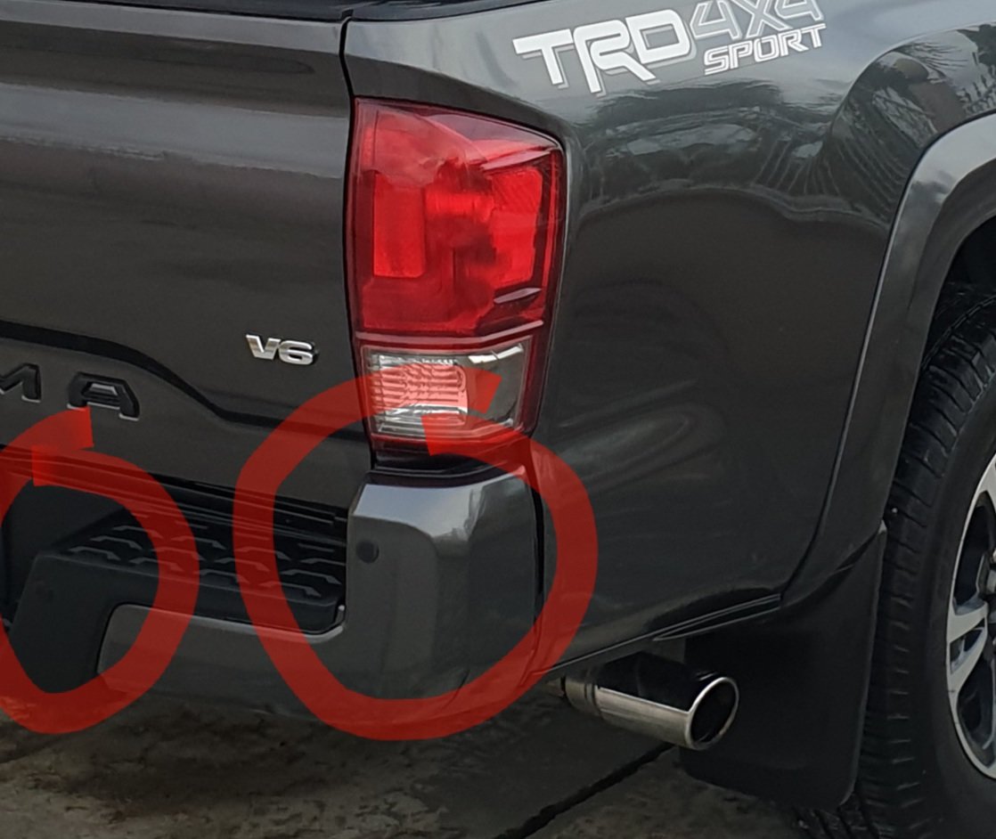

  19. Apr 18, 2021 at 6:02 PM
    #19
    chettytac
    chettytac Well-Known Member
    Jul 30, 2016
    #193308
    113
    chet
    2009 Toyota Tacoma Access Cab v6 4wd
    See attached
