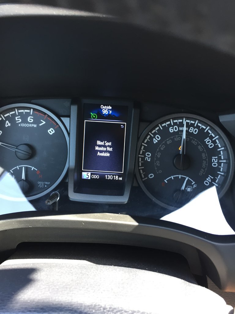

    First time seeing this for me. 2 hours into trip from Sacramento to LA. 96 degrees outside, no water. I'll take it to the dealer next week when I get home. I hope they exceed my expectations and actually pull codes.IMG_9459.jpgThey'll probably tell me SSP did it.
