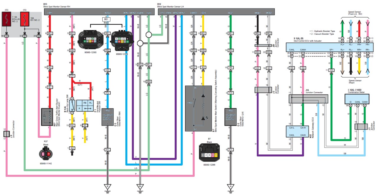

    That is excellent! Is that in the fsm? I was looking for a system schematic but could only find schematics for individual components, not the entire system. Thank you
  10. Nov 12, 2020 at 10:13 AM
    caribe makaira
    caribe makaira Well-Known Member
    Feb 13, 2011
    #51121
    11,765
    Caribbean, Puerto Rico
    05 PreRunner TRD Offroad AutoTrans
    Hood Struts, My version Fogs always ON, Map & Overhead Light Mod,
    That one is "stitched".

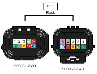

    Reviving old thread. @caribe makaira , thanks for posting the diagrams. What is chance that a 2022, Sport with Safety Sense, Nav head unit, Premium Sport Package but no BSM nor RCTA has the wiring harness in place to add BSM and RCTA?

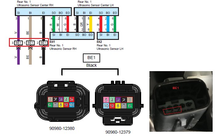

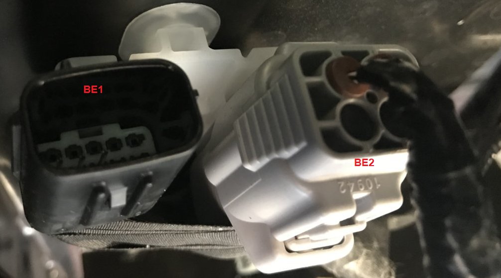

    Not an easy install, it requires TECHSTREAM skills. If the harness to the rear bumper is lacking the terminals pins inside the connector in order to add the sensors, it would be VERY expensive. Plain jane version Taco only has 3 terminals for the missing sonar sensor (parking) and no cover.

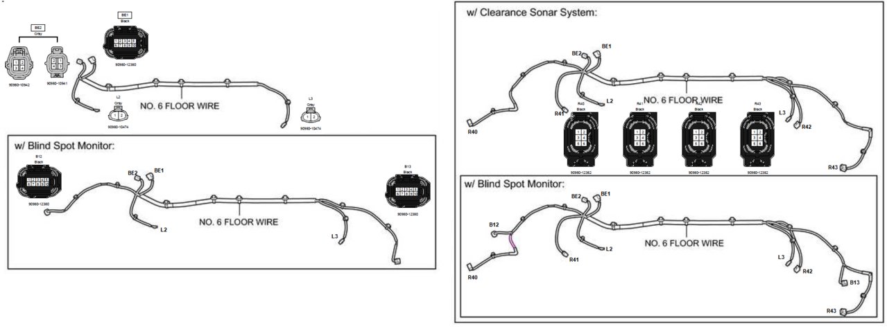

    Thanks again, I assumed I’d be looking for a connector with an end plug and no wire leading off.
    Your diagram shows four sensors instead of the two in your earlier diagrams. I thought BSM only used 2 sensors but you need 4 sensors for backup assist.
    Salesman said they can install BSM for $1500 which suggest the wiring harness is already there, but they wanted another $1500 for rear parking assist - but your diagram shows all four sensors in series so don’t know how they could offer BSM without rear parking assist if they use same sensors?

    Yes, the Cross traffic sensors go with the parking sensors.

    These are the various types of bumper harnesses, but they won't work with the cable going to the bumper that has only 3 terminals in its connector (BE1)[For the BSMS system]
