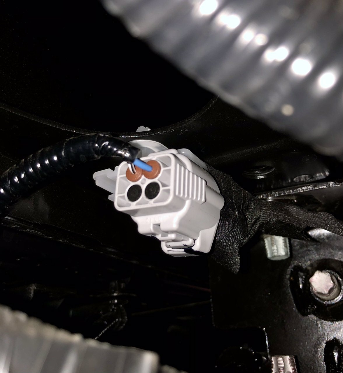

    Thanks again. I think I got it now. BE1 will have a wiring harness attach regardless of options so need to disconnect BE1 to verify positions 1, 2 & 3 have pins on the truck side. Bumper harness needs to be replaced to one designed for BSMS or replaced with a different harness to add BSMS with parking sonar.

    BSMS sensors are behind the plastic corners of the bumper.
    You could always drill the locations for the parking sensors.
    Most versions without any features just have BE1 with the 3 pins and no cover.
    The main issue would be a replacement harness from the cab to engine room to frame to rear bumper area with all the missing terminals available And paying someone (dealer) to TechStream it in and calibrate. And, of course, the mirrors with the cross traffic indicators, the BSMS computer, activation switch, etc.

    As followup, got under the truck today and looks like I have a BE2 but no BE1
