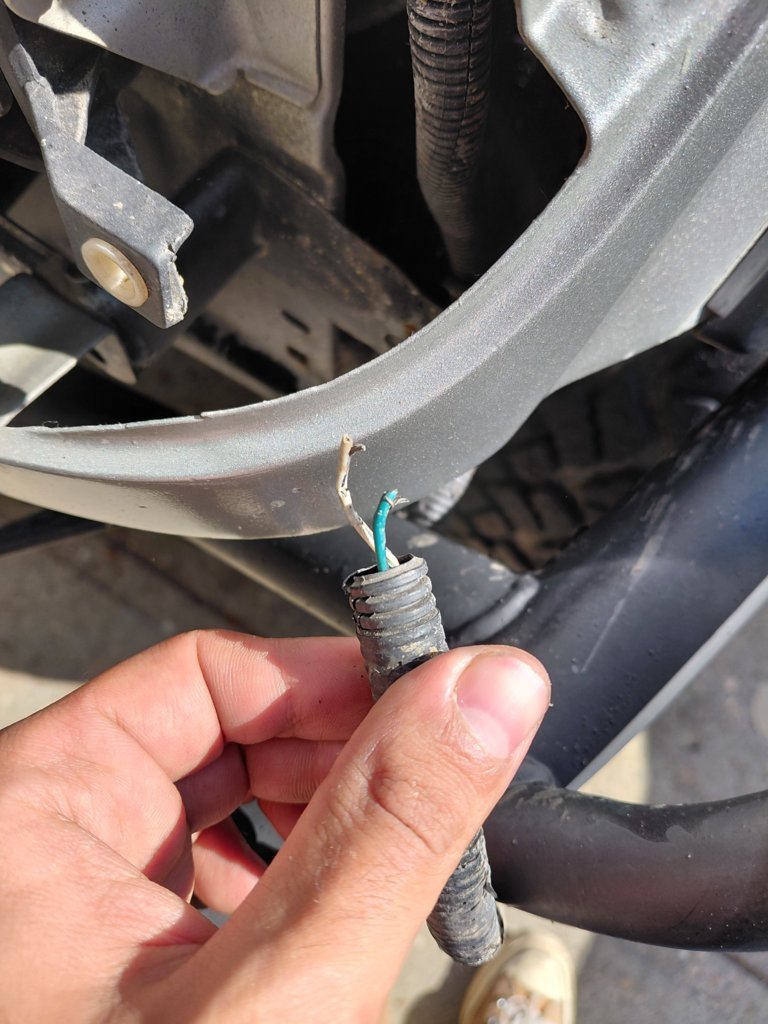

    Ok update, its simply just not there.
    I thought the bulb that is in the same housing was also doing the blinker, its not until I took off the working side blinker housing I figured out what happened,
    Photo attached is the wire I found

    Is it possible rodent damage?

    Probably mudding, also I live in the only place in the world without rats and I terrorize all the squirrels out of my neighborhood when I was a kid

    The good thing is you found it quickly.

    HugeLoad[QUOTED][OP] likes this.

    Ya but there just road under the light so it definitely fell off
