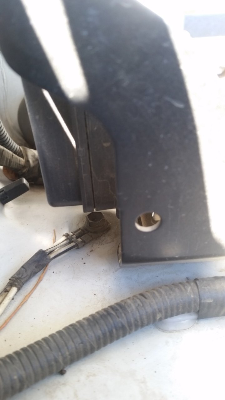

    This might be it. Passenger side fender well. In the service manual is says EC ground.

    So I cleaned the ground in the picture above and the chassis ground. disconnected the MAS, started the truck, got the P100 and P110 codes. turned off the truck and reconnected the MAS and drove around for 10 minutes until it stalled again. Afterward the P100 and P110 codes remained. Got it to started drove home and the CEL light is still on.

    No, Toyota just labels the ground points with 2 letters. First letter, E=Engine compartment, I=Interior, B=Body. EA, EB, EC, etc.
    I would guess the ECU ground is brown(?) and attached to the engine block somewhere, maybe under the intake manifold.
