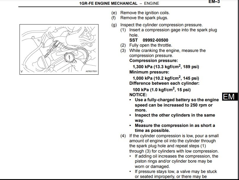

    According to the FSM 145 psi is the minimum specified compression, standard is 189 psi, low compression would definitely cause driveablity issues at low RPM.
    Since the engine was overheated you may want to do a leakdown test and see where the compression is leaking off to.
    Also you said the engine seems "constipated" I would pull the O2 sensors and do a backpressure check on both banks to make sure you don't have a plugged catyletic converter.

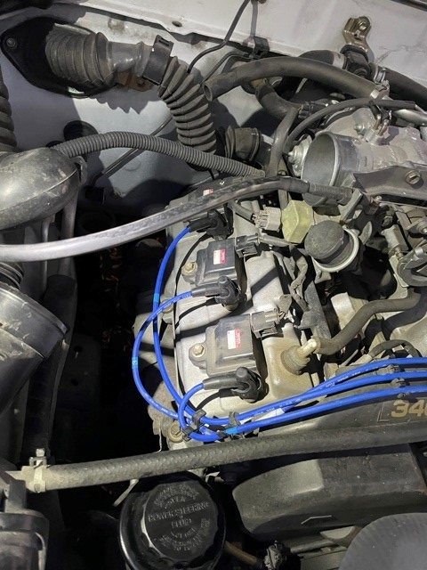

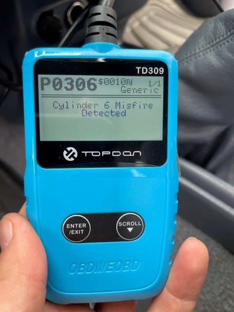

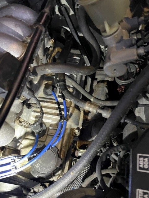

    Purely FWIW: I ran into the P0306 code yesterday morning when my 2000 V6 started having the same issues described here (shudder, misfire, shaking, rough idle). Figured it was over my head so I made an appointment with a mechanic but he didn't have openings 'till later this week so decided to just replace the 6th cylinder spark plug. That didn't do anything. So figured what the heck I'll replace the wires since mechanic not available for a couple days. Miraculously that cured it--I cleared the code and it didn't come back, smooth running engine again. That may not be helpful since it looks like your wires have already been replaced, but just noting here in case someone else can find useful (this particular thread has the most hits when you search for the P0306 code on TW).

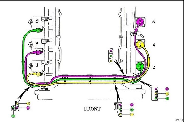

    Open to feedback on the routing for the wires--could figure out the tidiest way to do it so went with a diagram from YotaTech. I can see why people do the NGK wires--the color contrast is pretty sick.
