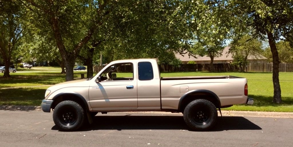

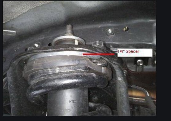

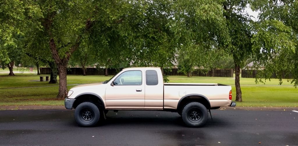

    1999 Tacoma PreRunner TRD
    Everything but the driveshaft. B03A - 410
    Are you 4x4? If not OME 2880s do provide lift for the lighter front suspension with a Prerunner.
    Also note there is a 1/4 inch spacer for the driver side to compensate for the Taco Tilt.
    Before 2880s and 5100s.
    After 2880s (lowest setting) and 5100s.
