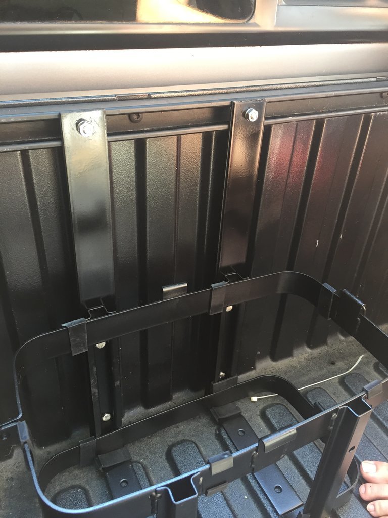

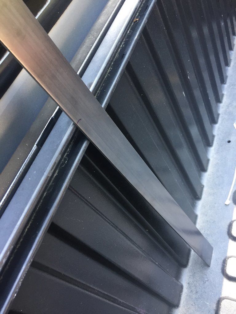

    I bought a locking smittybilt Jerrycan mount ($40) for my wavian can, then cut 4 pieces of flat iron and used 6 bolts and washers to lock to the bed rail. All in all $20 to mount smittybilt mount to the bed rail.

    It's been 6 years so I think the OP figured something out but clean install on yours.
