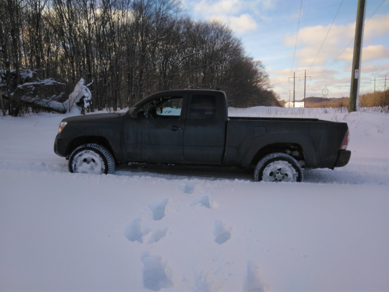

    I have not wheeled the Bizzak's specifically, but I did have Nokian Hakkapeliitta R2 265/70/16 for a dedicated winter tire, the first 2 winters I had the truck.
    This is the most they could snow wheel in and they got stuck in this easy. Aired down, not aired down. They just could not do it in deep snow. Then if there was mud from early or late season, forget it. They just cant do mud, or sand. Anything but snow they just fail.
    Now I run Cooper Discoverer S/T Maxx 255/80/R17 E rated all year round, and the difference is unbelievable. These things get better and better the more you air them down. I run 5 ~ 6 PSI all day sometimes for snow wheeling.
    I find they do great on snow in town to get out to the wheeling, as my truck is just dedicated to wheeling now. I have no issues with my Cooper ST MAXX around town and such. Sure a set of studded ones would be 100% better. Studd's are the next level of awesome.

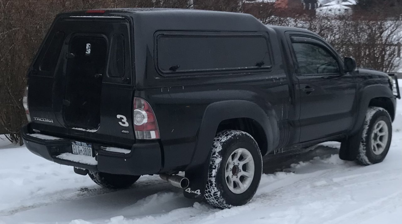

    Well, I’ve gone Mastercraft Stratus AP 245/75/16, this time around. Almost forgot what having fuel economy was likeC0B152ED-0DEB-452D-9F40-9583C11AEED4.jpg.
