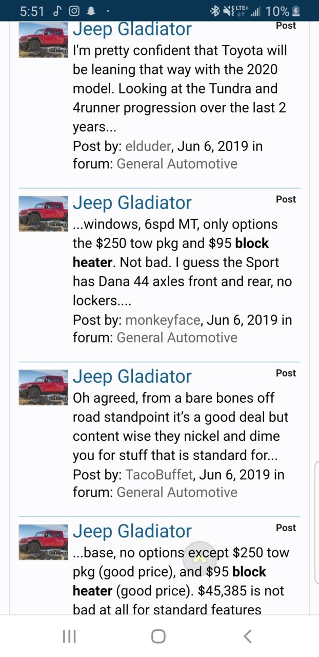

    Do you think that's not the first thing I tried? Below are my search results.
    Thank you for the links but telling someone to search on the internet is not helping you look any better. I'm asking for help for a reason and it's not because I didn't search, also I want to speak to people who have these conditions I requested.

    Unlike some other forums, the TW search works VERY well.
    Of coarse searching Google for just the terms block & heater is going to return a zillion results. I'll bet if you google searched for "block heater" Tacoma "4.0" you would find a lot of useful results. Or you could even google search for "block heater" and site:tacomaworld.com
    Just because you failed to search properly, there's no reason to get pissy at someone that does a proper search for you and provided the link.

    Nope, I didn’t think you searched because you 1) didn’t say you searched and
    2) started a new thread when there are two pages of threads on the same subject.
    BTW, I didn’t tell you to search, I provided the suggestion to search and spoon fed you the results from searching here. I’m sure there’s plenty of insight, like you asked for, if you take the time to read through them. OR you could sit back, wait and cross your fingers people will respond.
